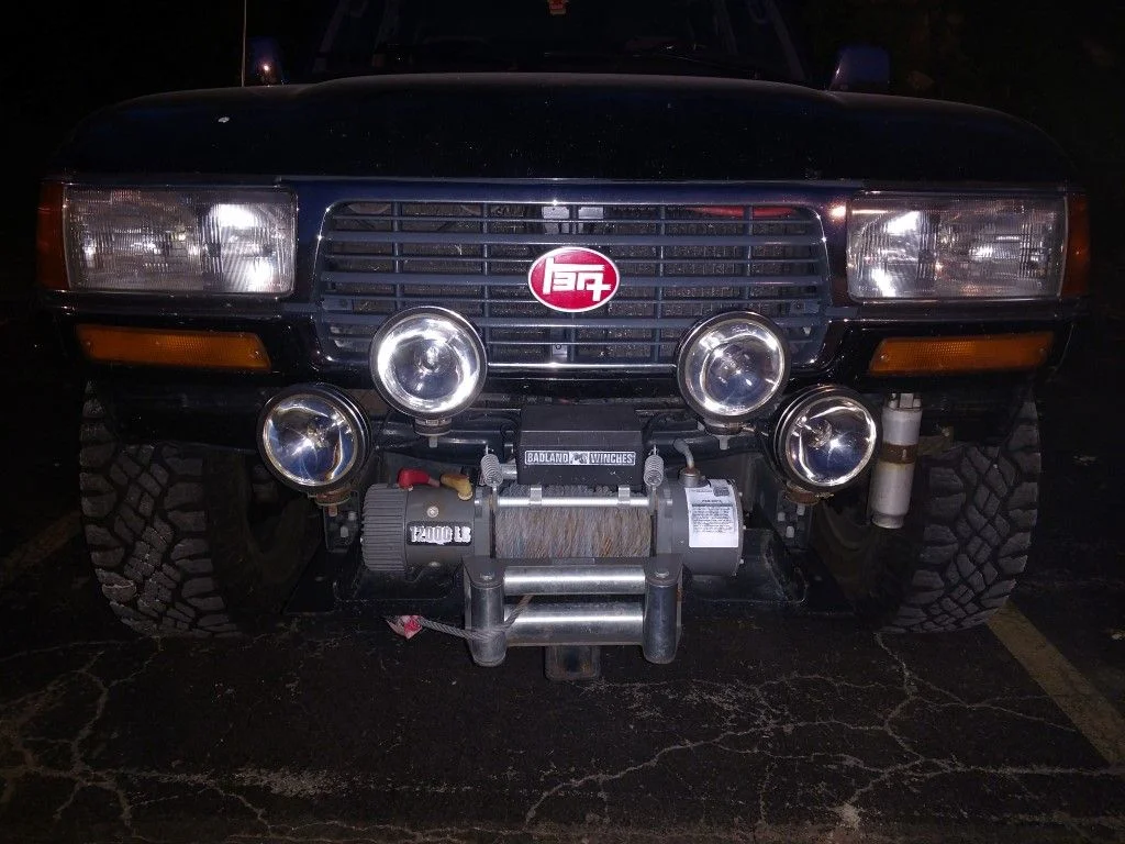

I painted the center part of my grille with Plastidip gray in 9/2017 and it is still holding up well. This is the pic from when I did it. The TEQ badge is really rock chipped now, but the Plastidip part looks almost as good as the day I did it.
But I did LOTS of sanding and prepping to get it to stick and stay stuck.
I like my chrome, so I'm sticking with that part.
