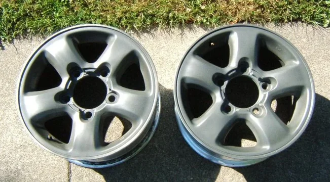

Bringing back an old thread from the dead. I finally painted my wheels last week. Had them mounted this morning. Whole process took a few hours. I just sanded the rims, primered a few times, and shot them with 3 coats of Dupli-Color Wheel Coating in graphite and 2 in clear. I like the results. Hopefully it will hold up.

Are you using enamel? It only lasts about 1.5 yrs in a high UV environment until it fades and turns chalky. The enamel takes about a month to cure, too. There's a water-based metal paint that lasts about 2.5 yrs, less curing time, but not as hard. Hard anodizing would probably hold up better.
