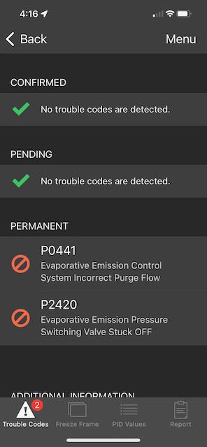

The P2420 came back again. Cleared it. While driving today, I filled the main tank from the remaining 1/2 tank in LRA. Emptied the LRA. Then got the check engine light while driving shortly after.
Got home and connected with OBD Fusion. In addition to P2420, I also got the P0441 code you referenced.
Fuel tank cap was tightened, one click. Can't think of anything else that would have triggered these codes all the sudden.

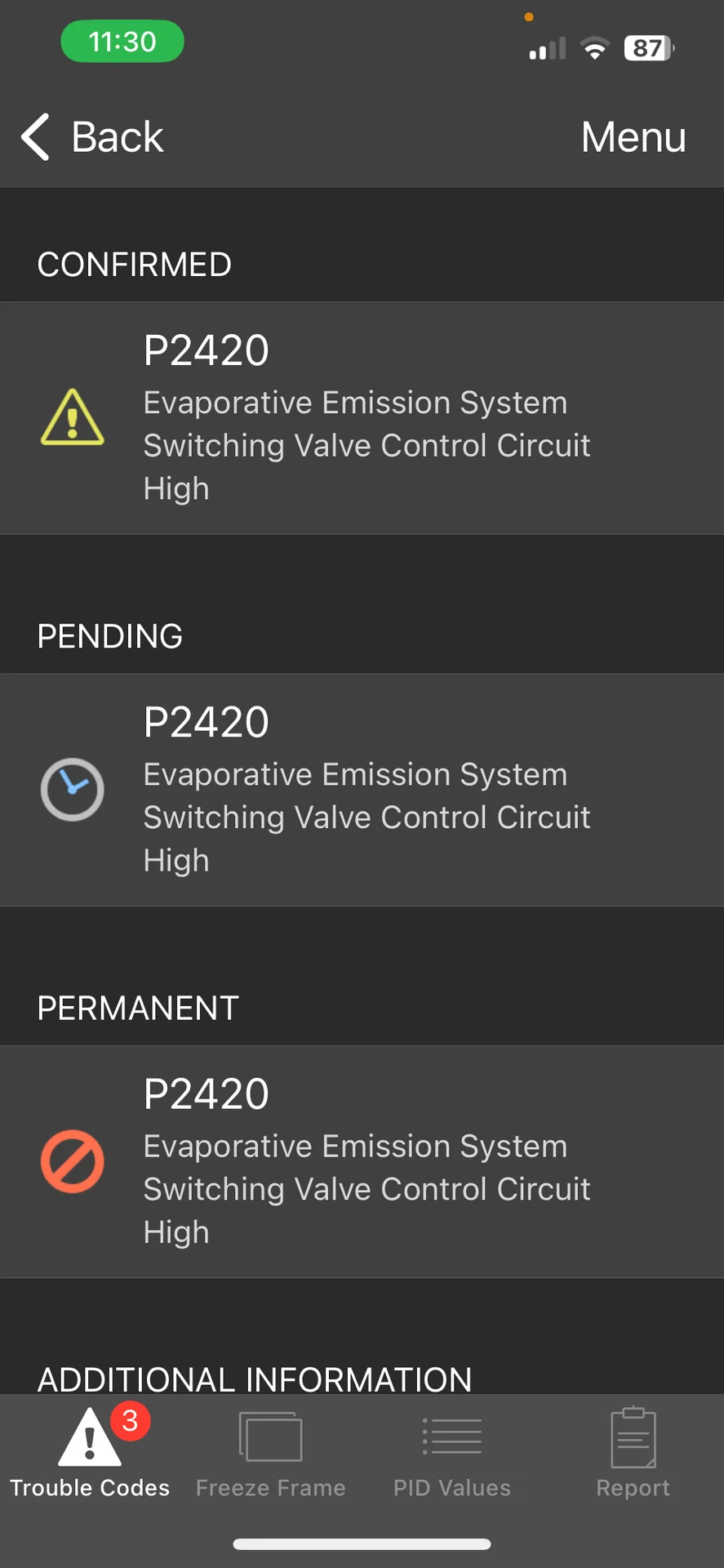

Darn P2420 came back again. 56k miles. I've had to clear codes about half dozen times over the past month. Cleared again on Wed. Status yesterday.
Seems to have started with cold weather. We got a warm front come thru last night. Outside temp (where the truck lives) was ~ 60F degrees this AM. Started truck, no errors. Scanned with OBD Fusion and permanent code now gone. EVAP system ran thru a successful cycle. I have not done anything else to try and remediate. Weather related?
I ordered a new gas cap earlier in the week. Thought I would start with the easy option and I have read where it resolved P2420 with other Toyota's. The other ones I came across were wiring related from ECM to the charcoal canister pump.
Strange one. Will see if it comes back when the temp drops back down. I would like to better troubleshoot this but need access to the charcoal canister and it's blocked by the LRA 24.5 aux tank. Not in a hurry this winter but will add to my Spring to-do list.

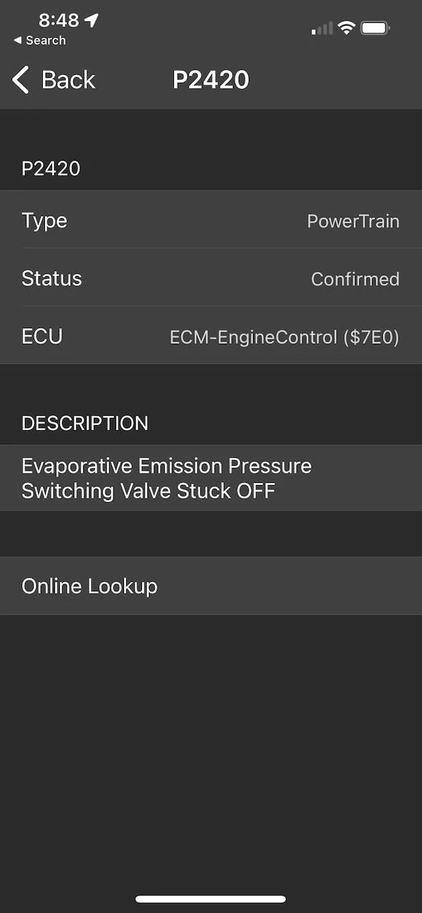

Following as I just got the P2420 code this AM. first time. Removed and reinstalled gas cap (one click as always) and cleared the code. Hopefully that's it.

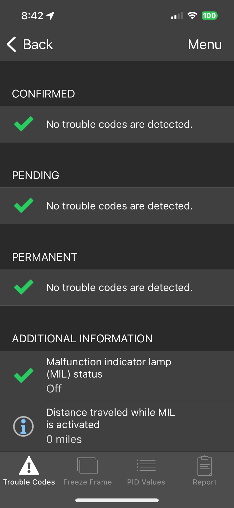

Have not had code come back. No permanent code stored either. Warmer weather ???
