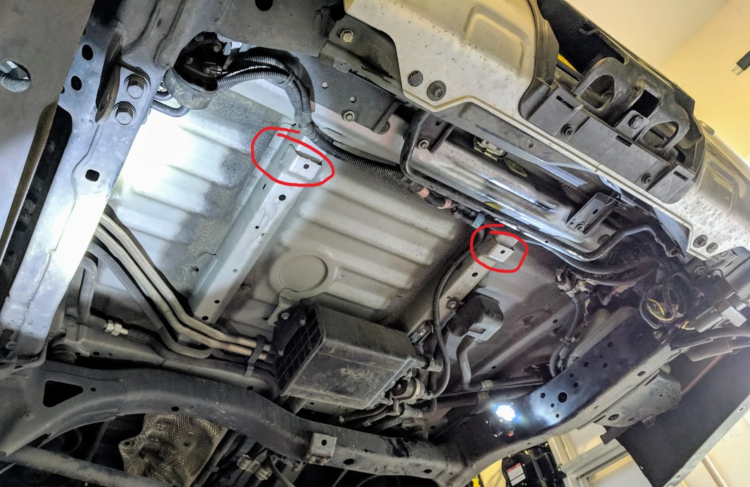

Rubber strips came today so I installed the tank. I put it on where Ed suggested
I put strips along those entire sections. I forgot to take a picture before I put the tank back in. Since the Evap canister fit and worked well for 6almost 7 years, I did not modify the mounting for it. I saw no signs of interference on the old tank. My only issue was the connector that broke I posted earlier. Make sure that is moved out of the way

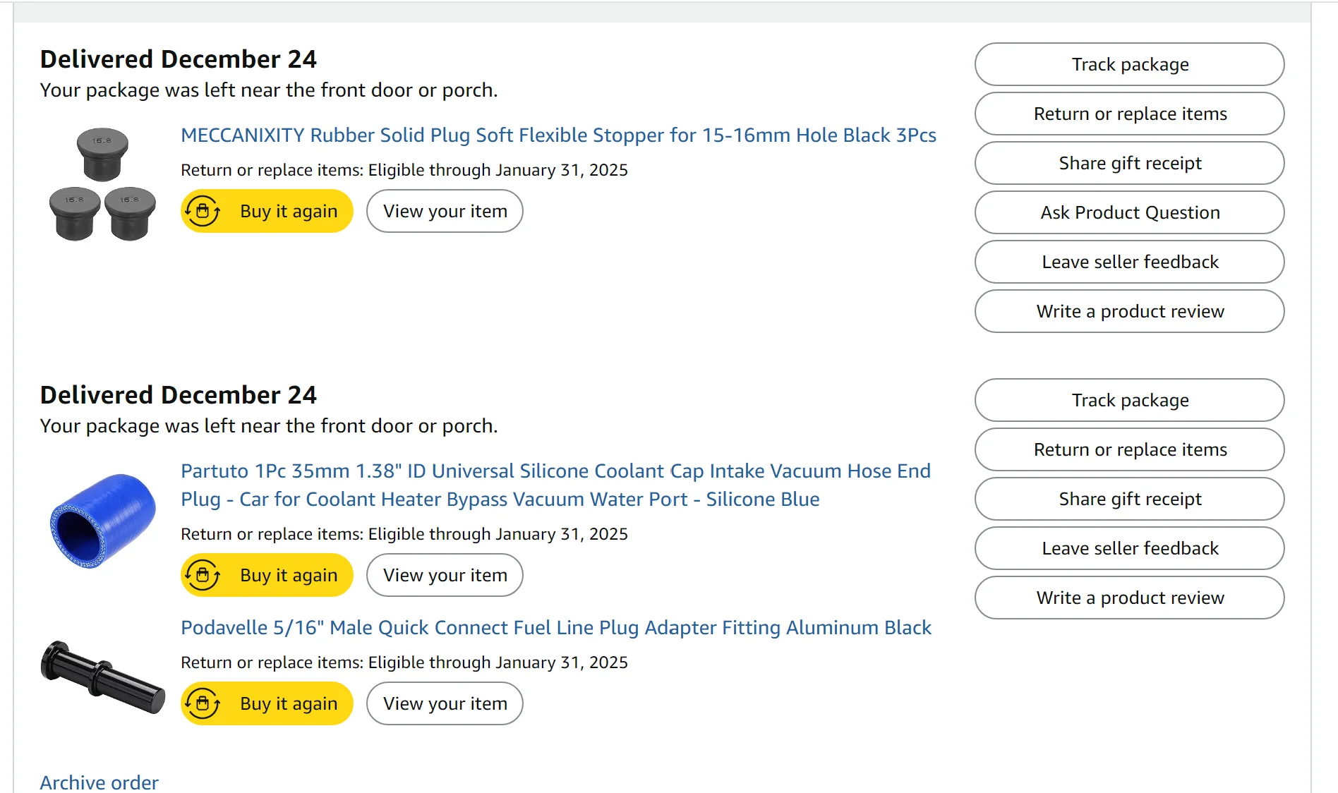

Suggestion is removing the Aux tank to replace the canister is to have these to verify it works before you put the tank in. These worked great ffor me and allowed me to make sure it worked by sealing the fuel system up without the tank

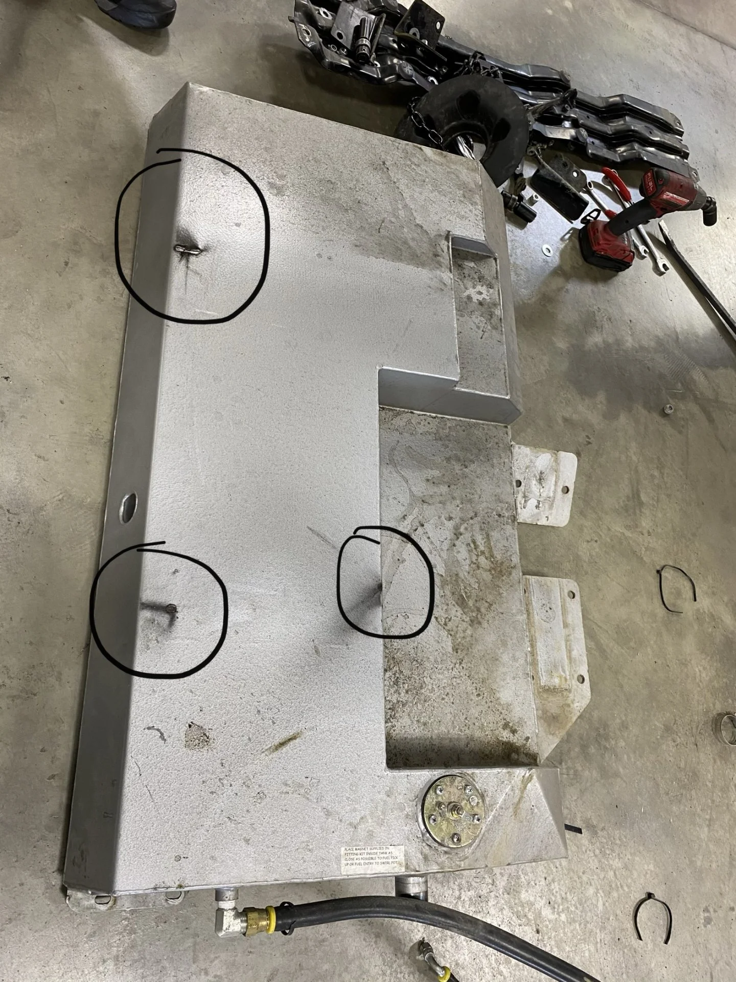

This witness marks on the tank could suggest they didn't remove the two bracket for the stock aux tank? Or maybe they did and your setup just has a tight fitting tank against the cab.
I am glad to be wrong about the sender. I had the tank on its side so the sender must have gotten into the full position. A minute of driving and it showed empty. Put 6 gallons into it and read correctly and then verified transfer pump was working
New Exhaust pipe out behind rear driver tire and passed emissions
Don't know what to say
That wasnt a picture of my tank. I just put the rubber were that showed. That photo is from Ed Martin from your install thread
Mine fit much easier this time being the 3rd time I installed it. With the 1/8" rubber strip there has to be more clearance for the Canister. There was no scruf marks on the old canister so don't think there was any interference or tolerance issues.

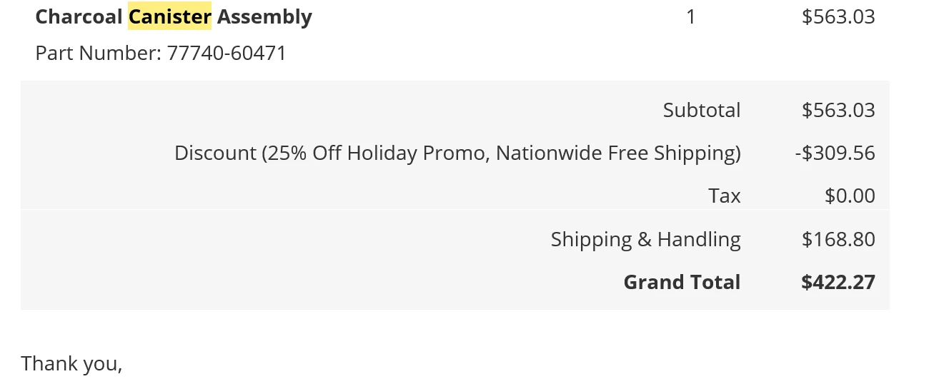

Thank you for this timely thread. After 4.5 trouble free years with the LRA 12.5 tank I started getting the EVAP codes a couple weeks ago. I changed the vent tube filter and switched to 5/8" line hoping that would fix it. Reset the codes and all was well until the next fuel fill up. The CEL seems to correspond with filling up the tank.
I'm pretty sure I will need to replace the vapor canister. They seem to run between $5-$600 online. Where did you source your canister?
