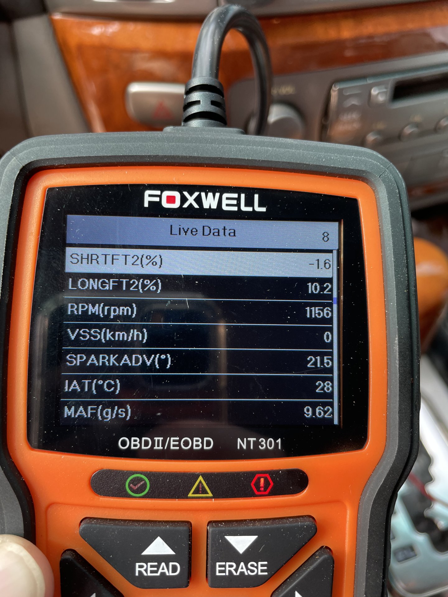

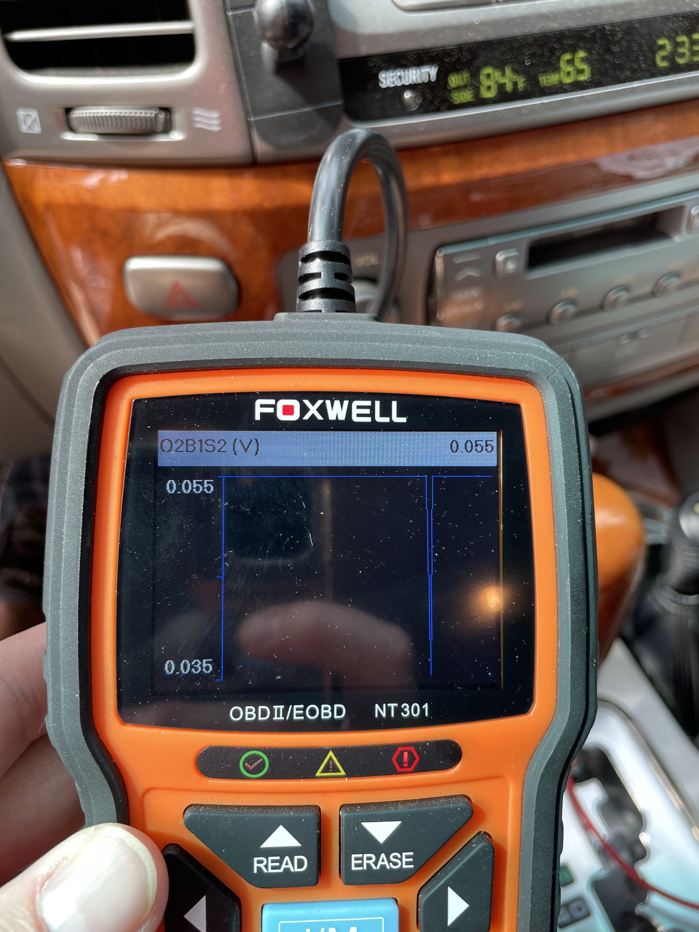

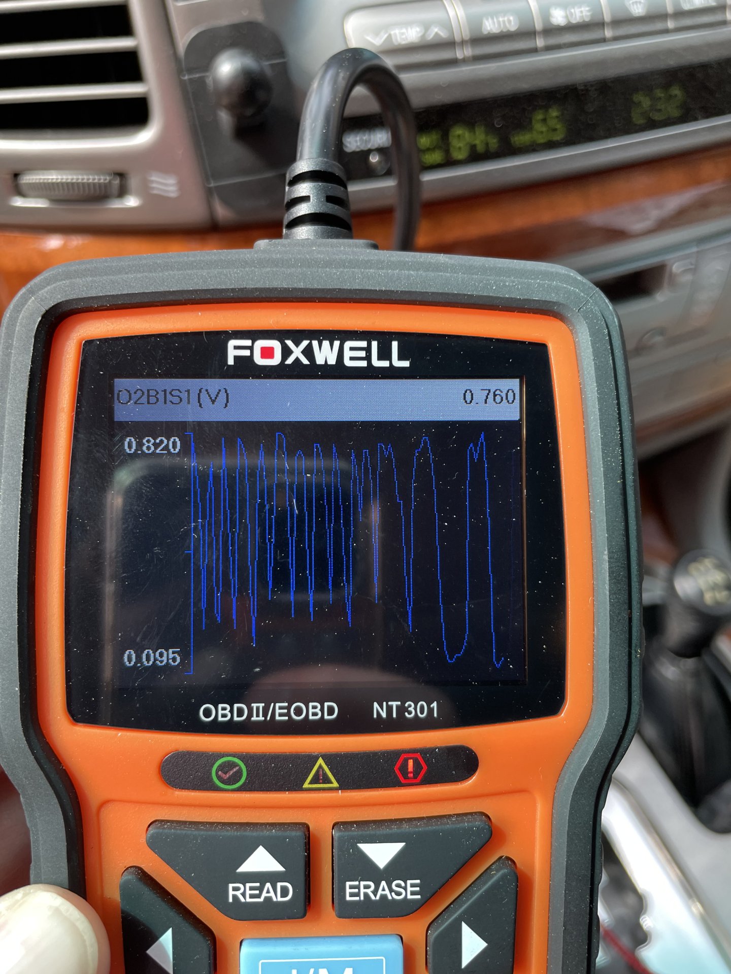

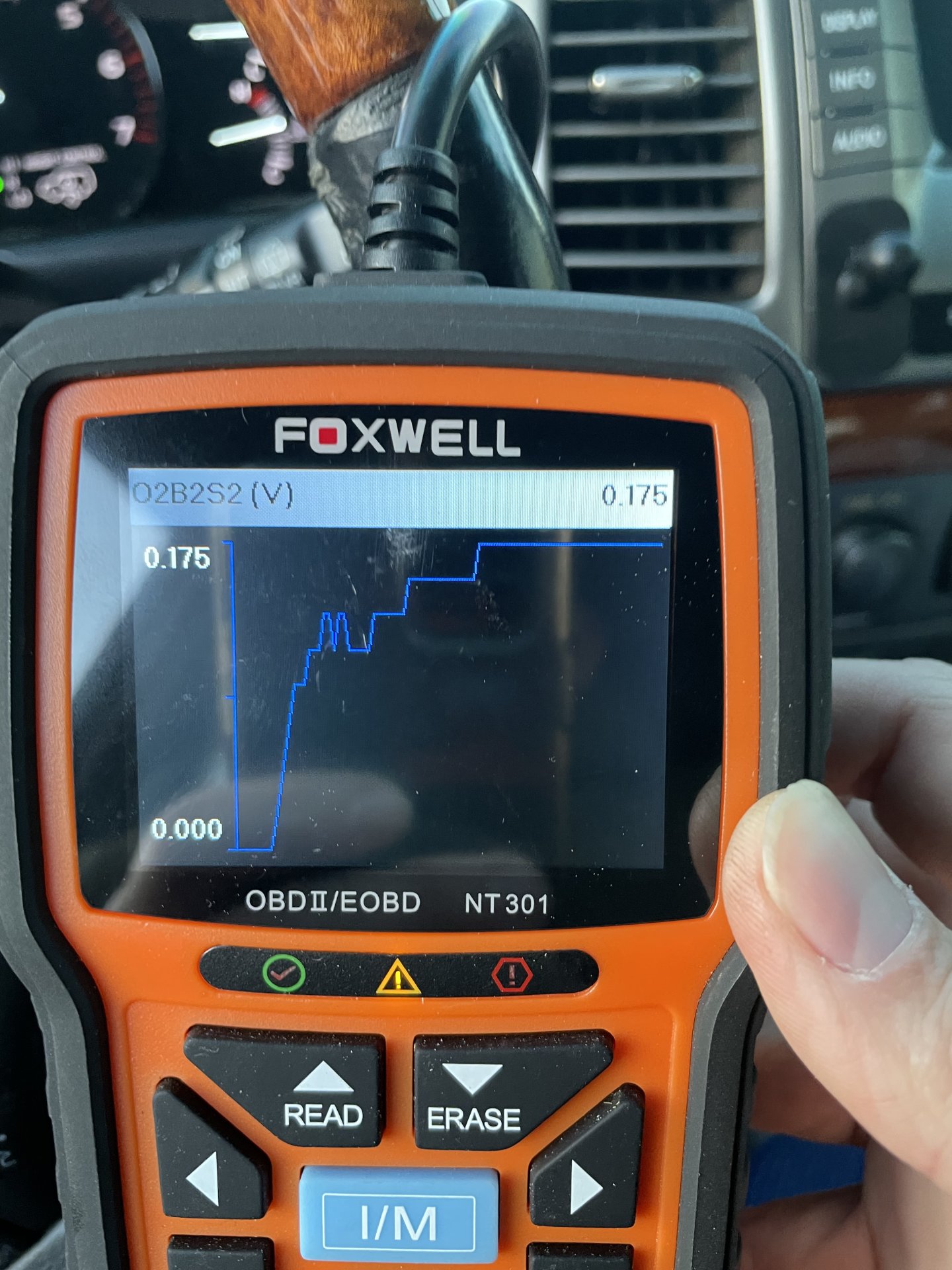

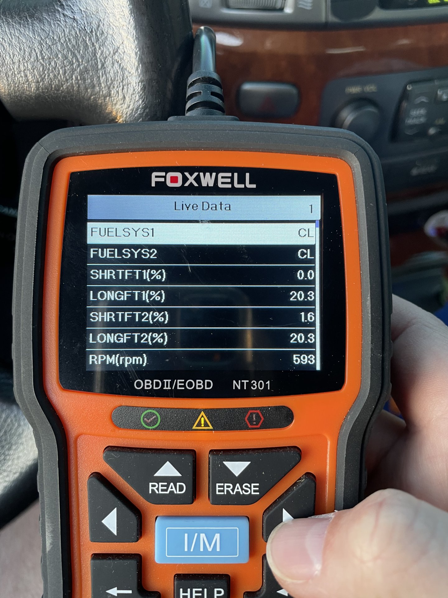

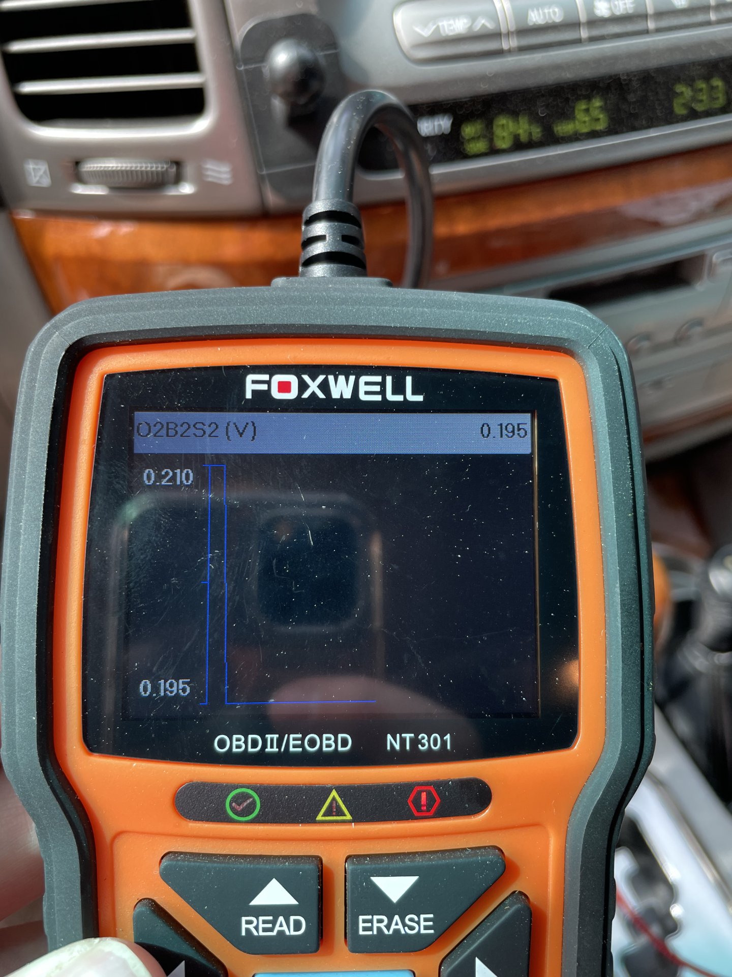

Reading live data from scanner bank 1 sensor 1 is reading between .095 and .820. Bank 2 senor 1 is between .100 and .820.
Bank 1 sensor 2 is between .035 and .055 and bank2 sensor 2 is .195 and .210.
All of those readings are at idle. I have photos of readings/graphs if that helps.

the waveform from the first picture looks appropriate. The next pics, not so much. Idle or load doesn't matter.
The two rears look bad. As long as the time detail was the same in the last pics as the first.
Buy one more new one and swap in one side and read that one compared to the other side without the peaks and valleys.

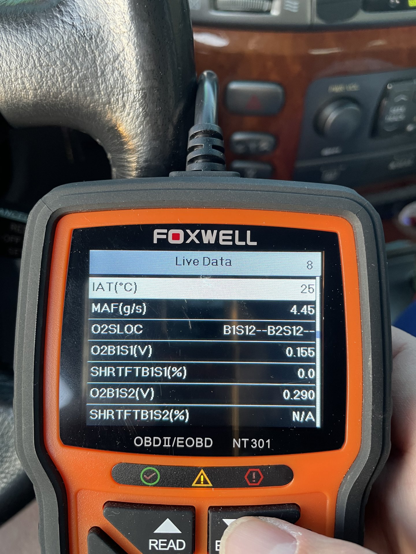

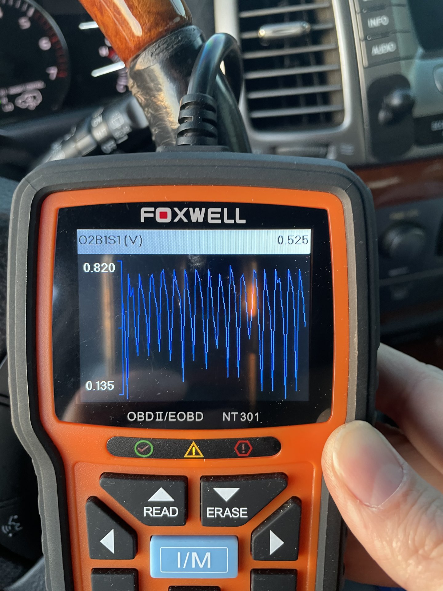

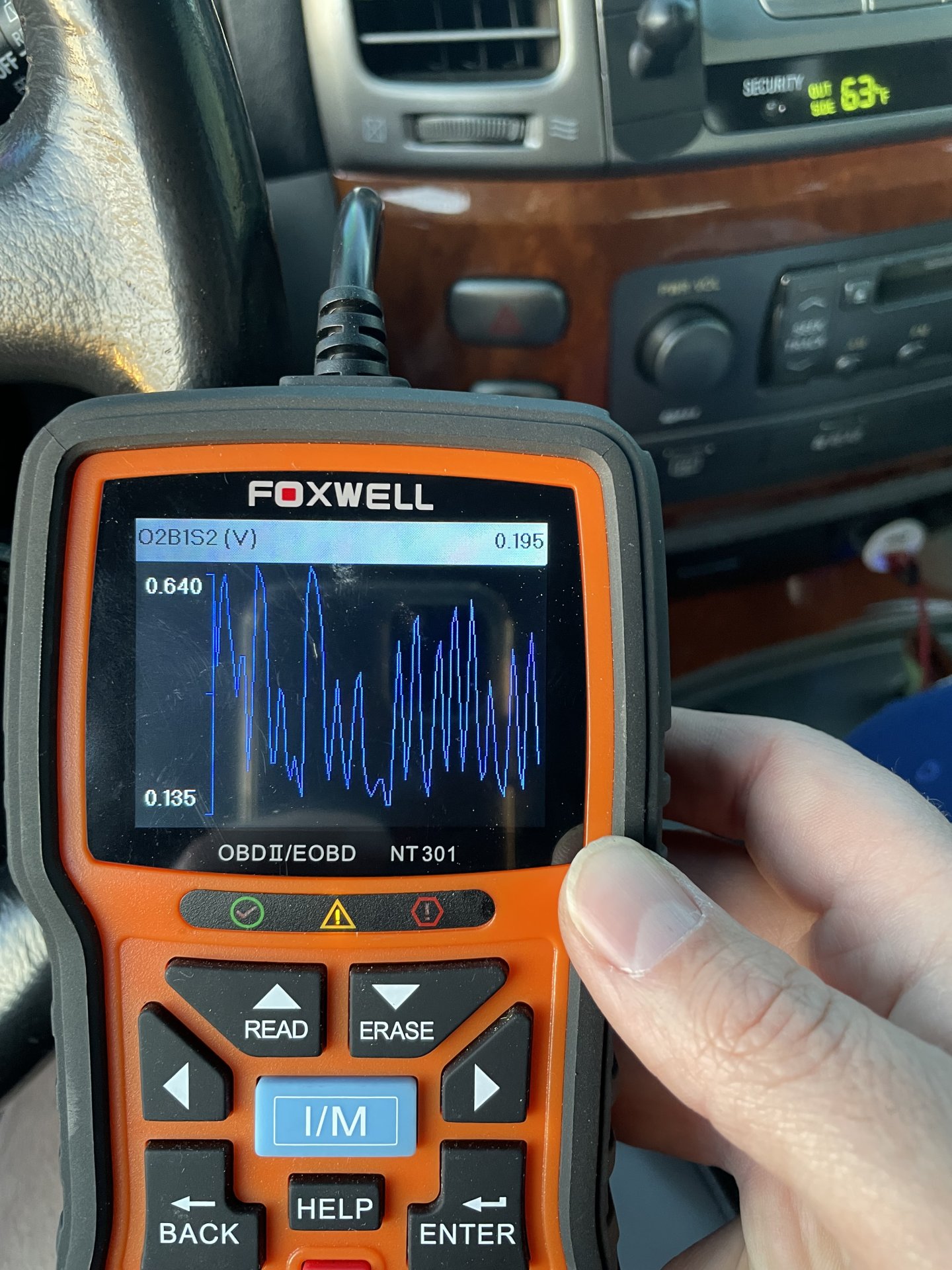

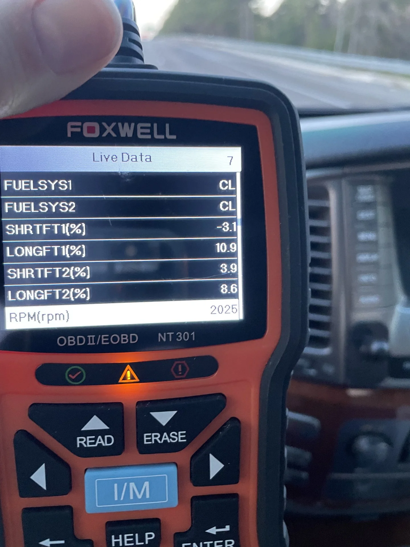

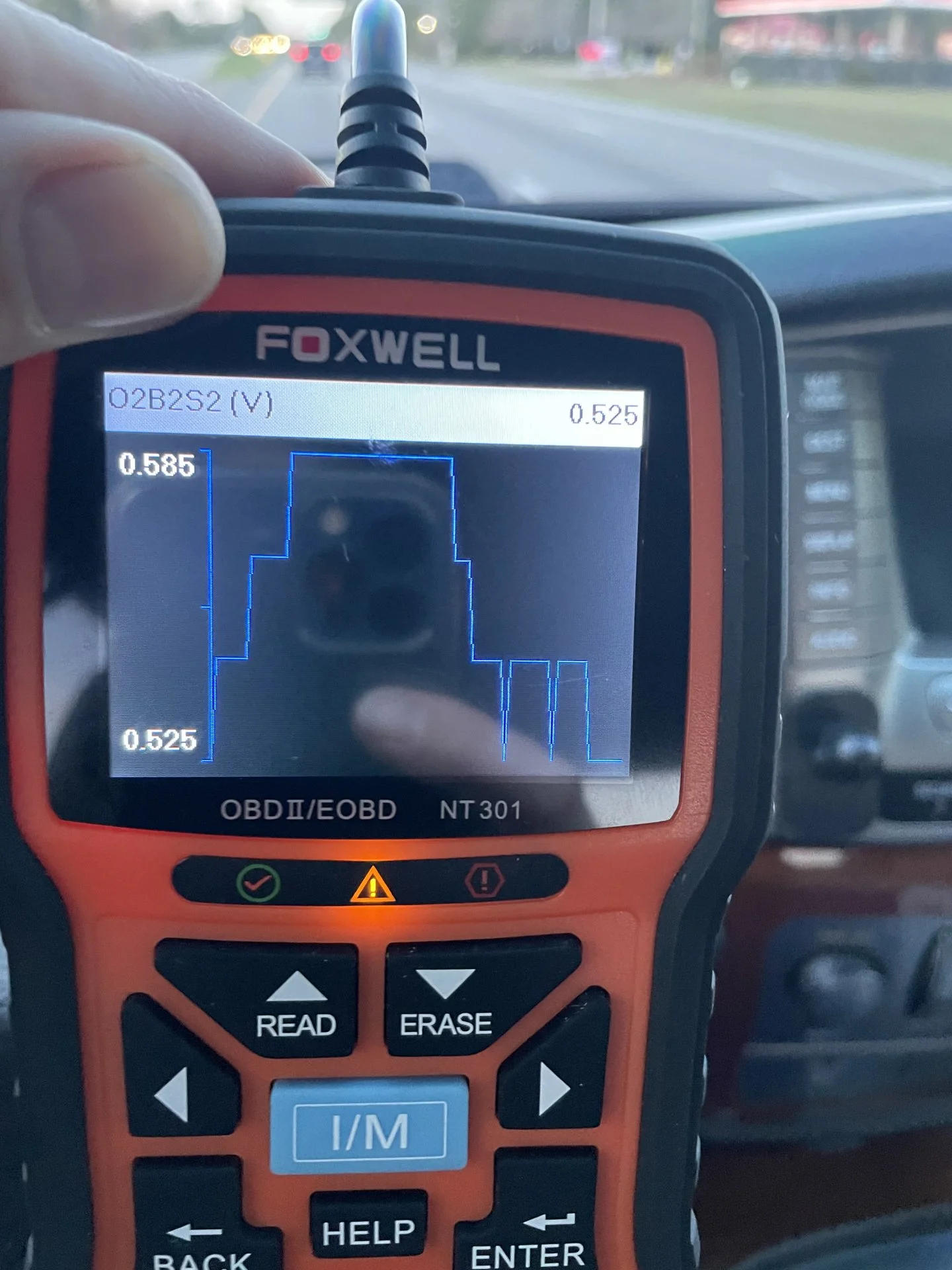

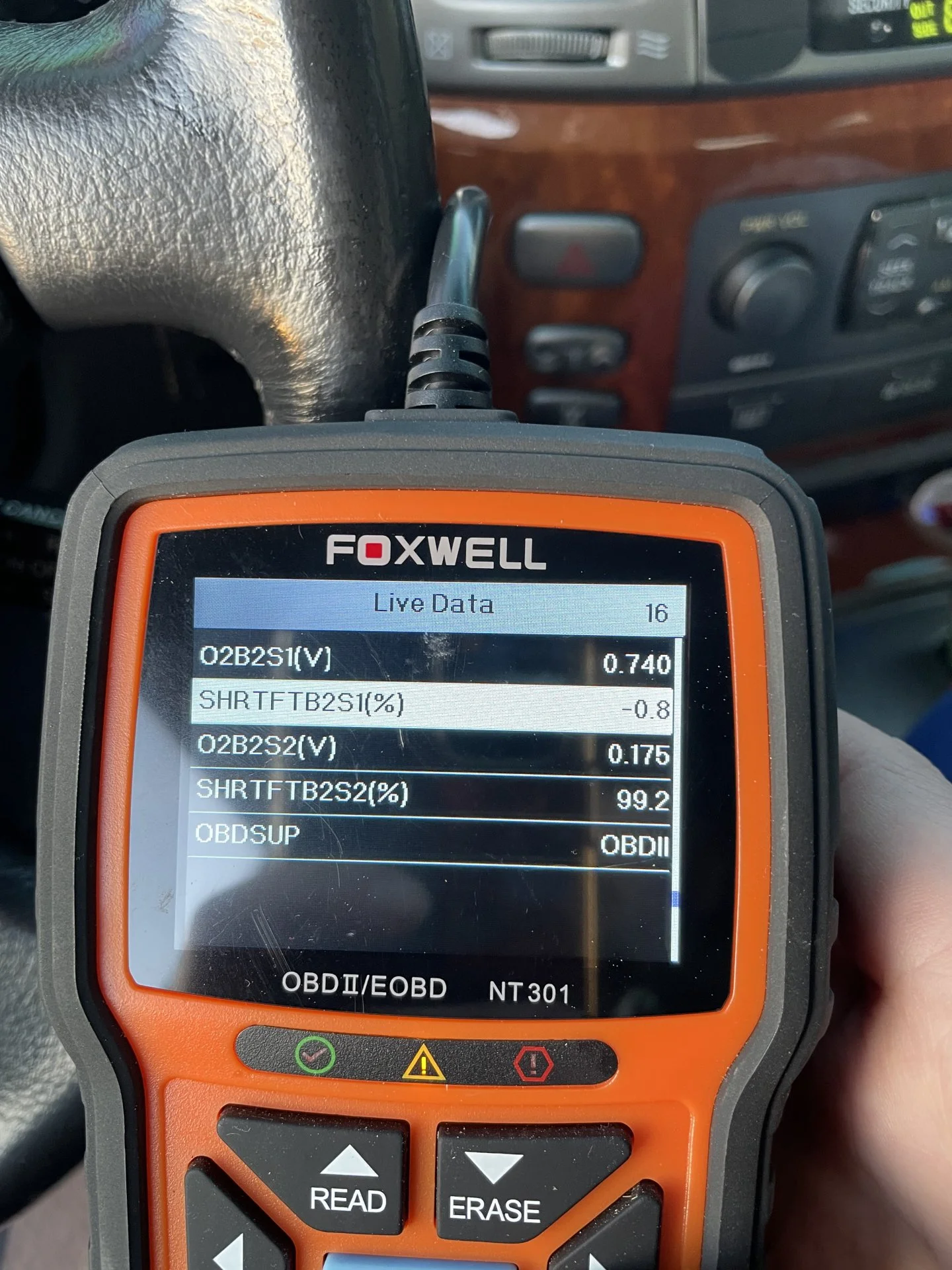

Went for a little drive to get some snap shots. The first set is at idle. The second will be at 50ish mph. I def see that bank2 senor 2 is not like the others. Wouldn’t that cause me to throw p0430 and not 420?
lol, those are different now.
b2s2 looks like it should, in the last pic.
b2s2 in the pic above the last pic looks bad.
b2s2 in the third pic from the bottom looks bad.
all those look a little bit odd except the last.
low = lean, voltage wise.
rears sensors should really just fluctuate a tiny bit about .45vdc at steady throttle
