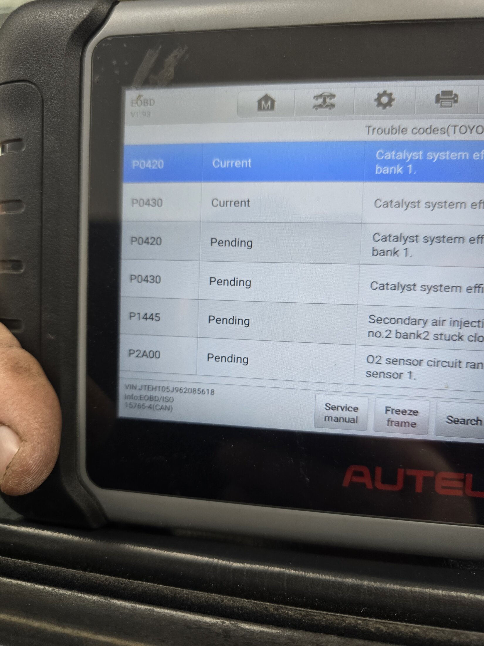

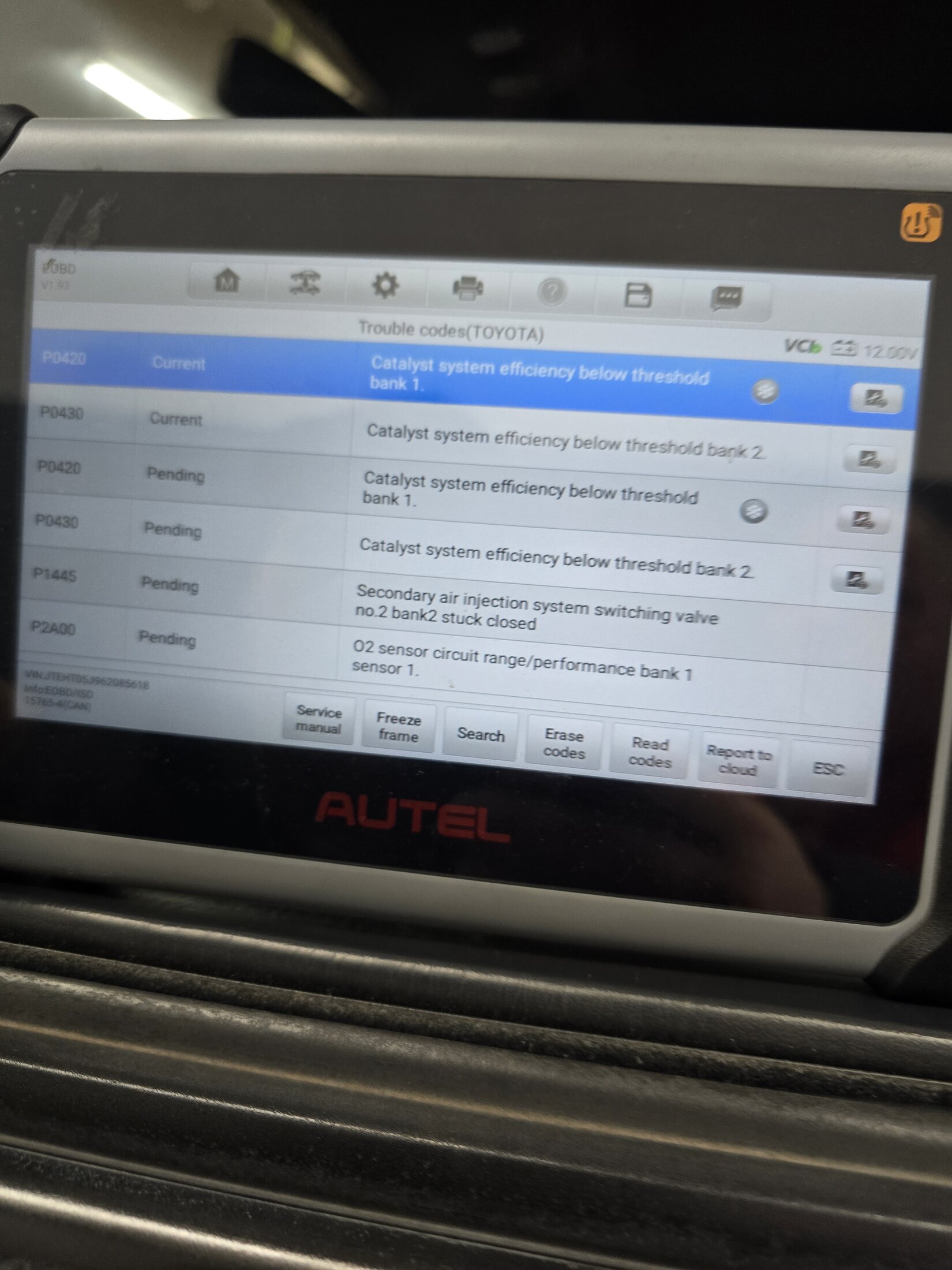

Help p0430, p0420
Hi. First thank you to both of you. It's a lot to take in.
1. In following your steps starting with number 2 does it need to be techstream or could I use my autel scanner?
2. Could I buy cheap coils as temporary fix to see if it fixes the misfires?
3. Pretty confident I've fixed all vacuum leaks. I've replaced almost all hoses.
4. I've lost confidence in my dealership so is a. Compression test something I can do at home? Same with the borescope?
5 how can I check fuel pump to confirm/ eliminate it as issue? I saw where you said it can be wonky.
6. On the sai if it's the issue how do you feel about the blockout plate fix? I'm almost 5k into this fix and I don't have much room left to wiggle.
Once again thank you. I can't thank you enough.i assumed this was an easier issue to resolve and the dealership would be able to handle it. That was the beginning of my demise lol.

Yes and yes. Borescope on Amazon $100 w/8mm directional camera. You can look back at valves. I've a 360 degree 6mm directionly. They self explanatory on use, plug and play.
Compression test is easy! But must follow FSM. Fuel off, t-body wide open, engine at operating temp, RPM 250 or better. So be ready and fast.

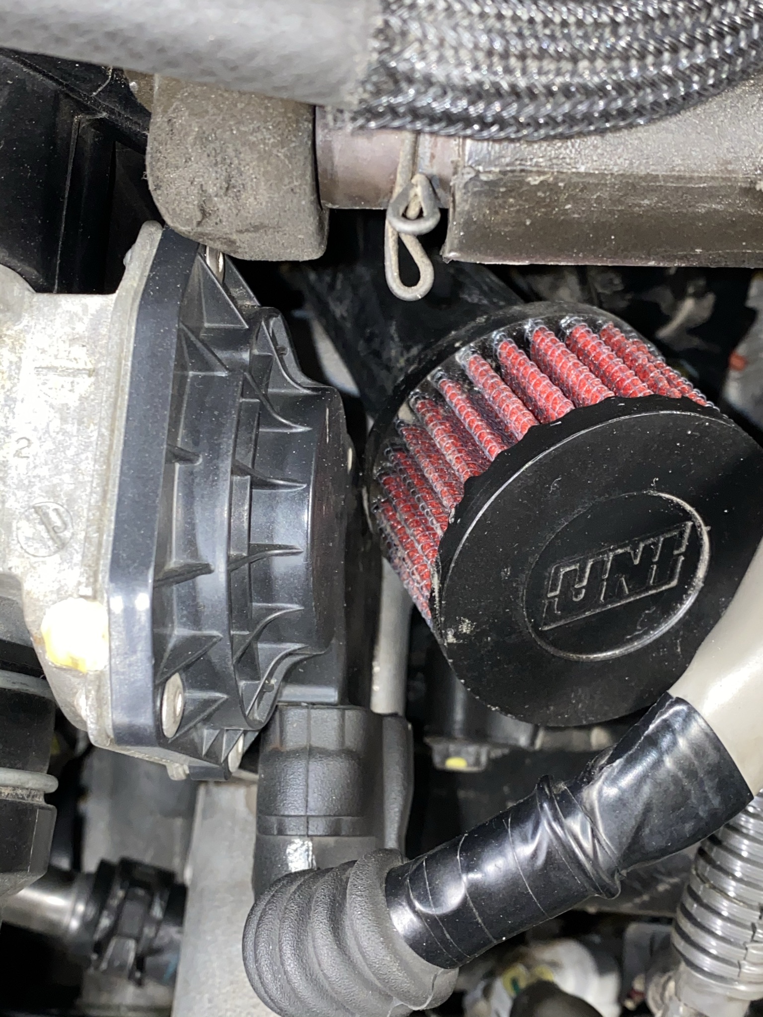

If you install a block off instead of my S.A.I filter mod or replace S.A.I pump periodically. You'll not be street legal drive on public roads, HWY, steerts.
I can't express enough. How much I'm against block-off kits. I also, see issue coming to me with them installed. Owner must remove, to get into my shop. Unless he trialer in and has no plates
Why block off SAI. I've written up free to the world. A step by step solution. That I've back tested over last 5 years now. Works perfectly. Which keeps, all emissions equipment as factory intend, just better and reduces long term cost.
Some, say my state doesn't check emissions. Good for them. But are they living on different blue ball then us. Or just one of those, that will do whatever they can get away with. Please leave me alone, than. Sure it is small thing, but it does help. I hate those coming in mud justifying block-off kits.

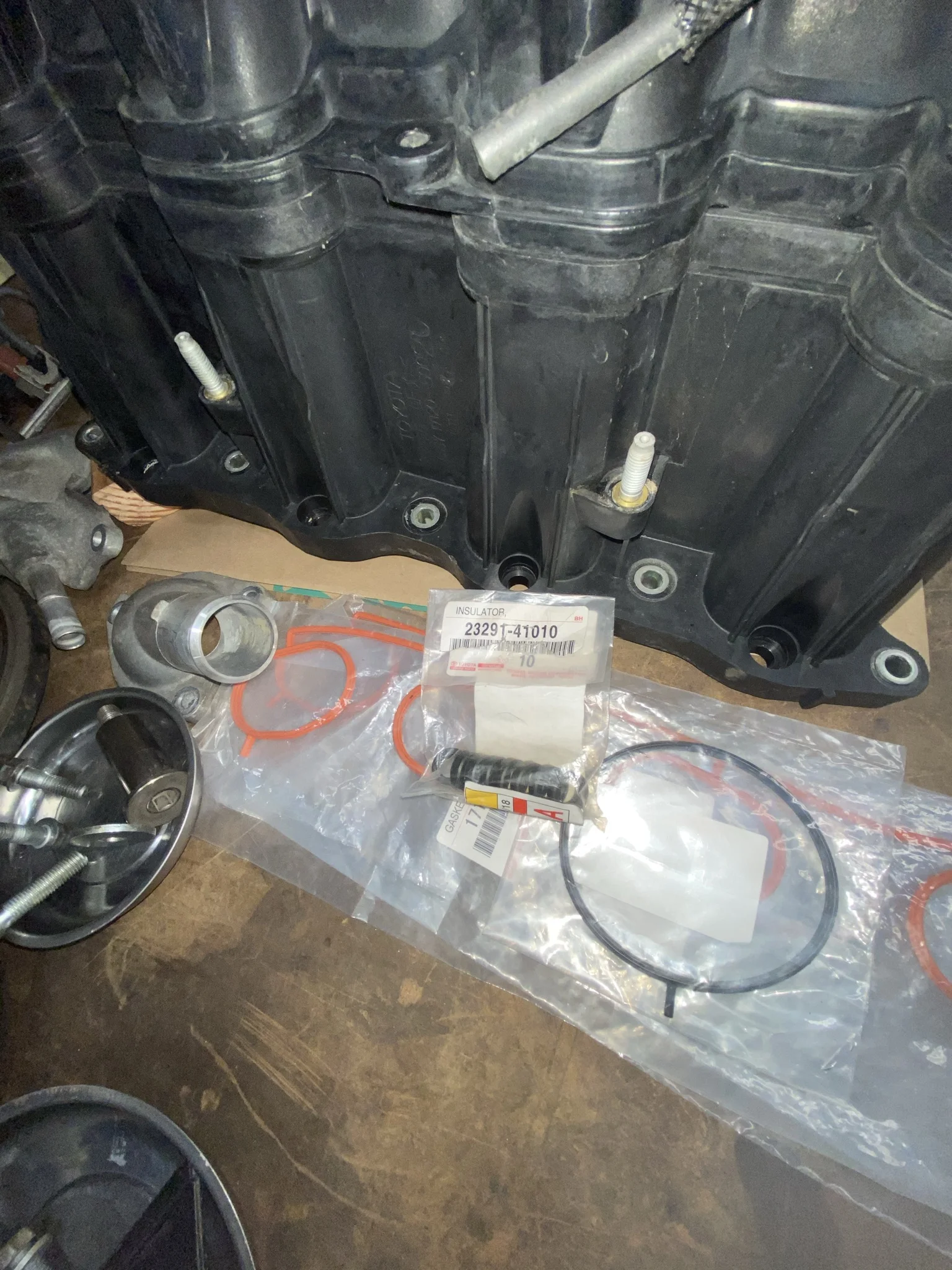

Additionally the starter can be done, and added benefit intake gaskets replaced. Which rubber gasket are shrinking with time. These can, produce a vacuum leaks.
Takes 3 second and $20 to replace my S.A.I. filter. Sure takes work to install. But once in, it's cake.

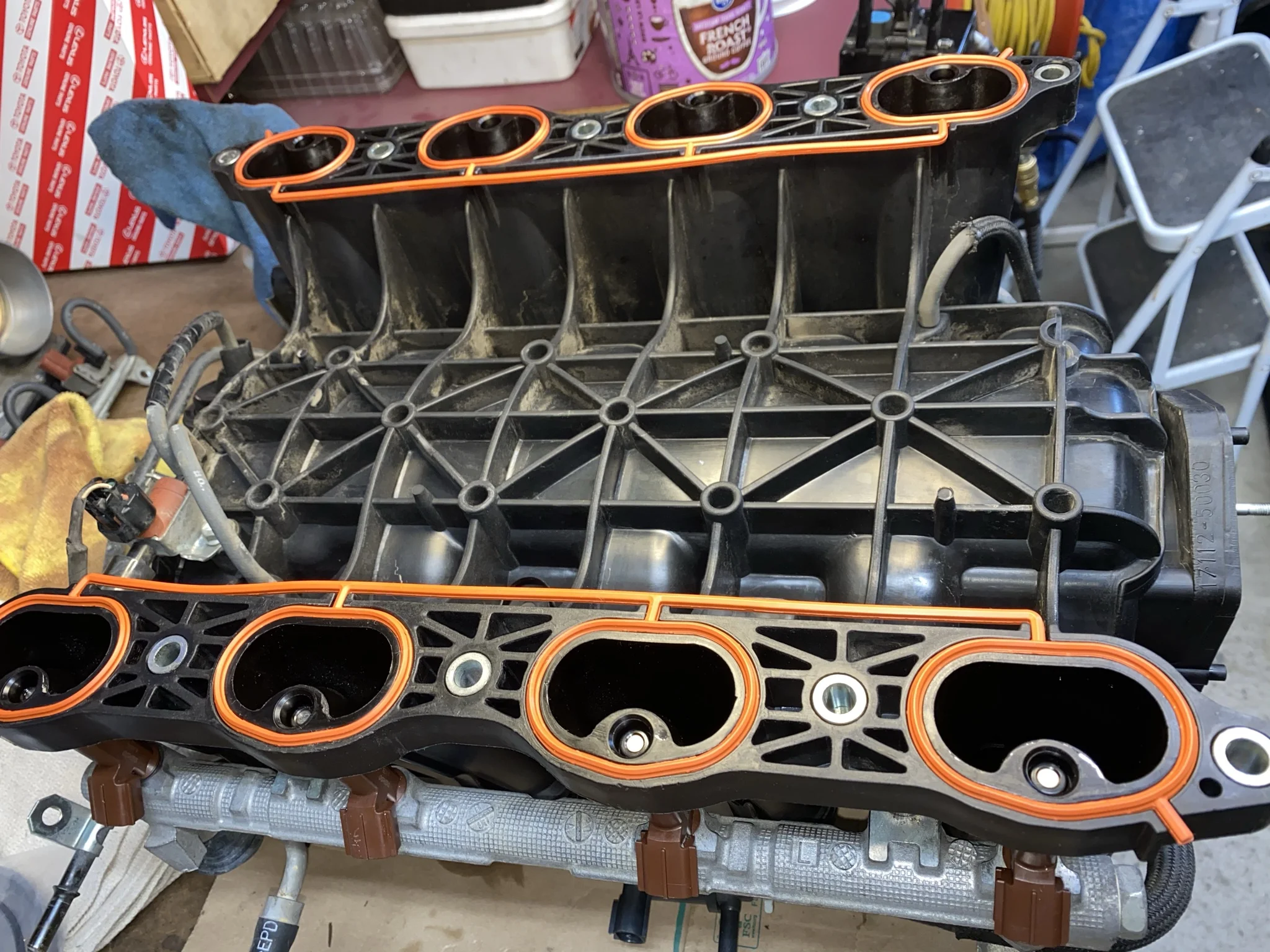

I had a leak on my intake manifold gasket(17171-50020) that was missed in a smoke test and extremely difficult to find. It was giving me like +30 fuel trims
17171-50020 Used in the 98-05 4.7L 2UZ-fe. Is the hard gasket laid on head, for install. We usually don't have issue with, them. Provided proper (PP) procedures used whenever intake manifold R&R.
PP:
New gasket.
White tabs up.
Clean surface
Proper torque technique. Working down in tightening pattern, a little at a time.
1717-50030 Used in 06-07 4.7L 2UZ-fe VVti. Being rubber gaskets, used for VVTi intake manifold (IM). Is very easy to damage, during install. Since we imbed then in IM, rather than laid in place on the heads. One little bump on hard metal, like the engine hoist hooks or studds. While placing the IM, back on heads. They get busted/split. To reduce risk of damaging the rubber gasket. I bend, engine hooks outward a little, to give a little more room. If, I think, I did bump a gasket. I'll pull IM back out, check for any split in rubber gasket.
So today I got the exhaust leaks fixed and once they were done with that they brought the truck around to show me and we were going to clear the codes upon clearing the codes this is what popped up so what do you think I need to do or go from here
So go back to post #10, and the link I posted there.
If your S.A.I. pump has not been replaced. Then there's 98% chance the filter is no longer in position. That it has been out of position, for some time. This little filter missing, can result in a lot of damage. The BK1S1 DTC pending. Is a the LH forward A/F sensor (not actually 02 in VVTi). Which if I recall, you stated 4 new OEM 02 sensors replaced.
If you brought to me. I'd first check a few things.
  1. Look over engine and exhaust.
  2. Check for vacuum leaks
  3. Borescope S.A.I. pump, for filter.
  4. Compression test. I be getting look at spark plugs at same time.
  5. Scope cylinders.
