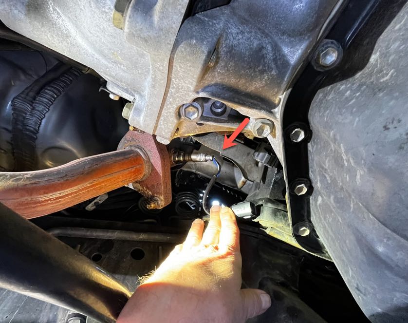

On the driver’s side, there is interference which makes it impossible to use a half-inch socket wrench and tricky to use the 1” wrench end on the removal socket. See arrow, below:

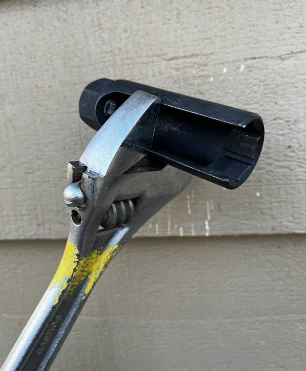

To loosen this side, I put the O2 socket on the sensor, and then used a large adjustable wrench around the body of the socket. I didn’t have enough hands to take a picture under the truck, but here’s the idea:
When I did this job previously on my 2001 LX, the driver’s side was really hard to loosen. I ended up using a cheater bar to get more leverage (basically a 2-inch square pipe over the end of the adjustable wrench).

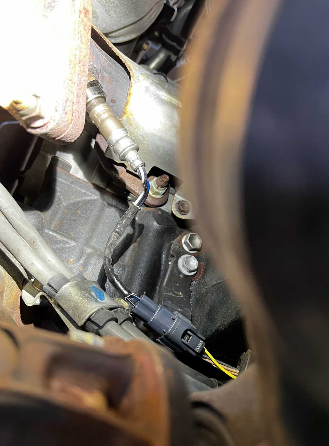

I’ve read that some people remove the RF wheel and fender liner to access this sensor, but I actually found this one easier to remove than the driver’s side sensor from under the truck. Here’s the view from below:

Because there is no interference on the passenger side, I was able to use a flex-head socket wrench with the O2 removal socket:

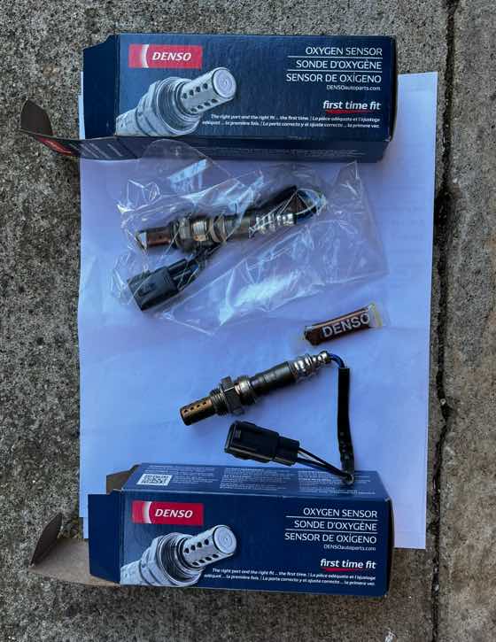

The Denso sensors came with some anti-seize thread goo that I applied before reinstalling:
