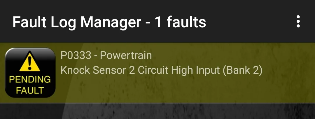

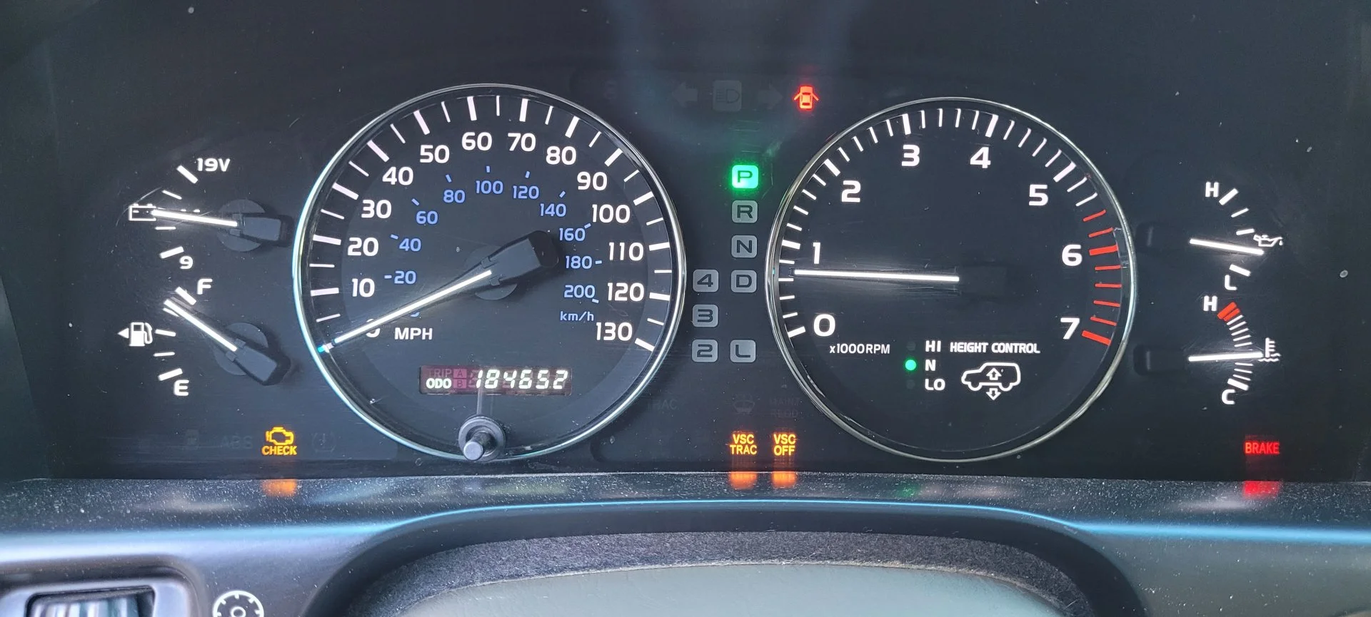

Picked up a nice 2006 LX470 few months back. Finally got around to baselining diff fluids this week. Did rear diff Sunday, test drive - no issues. t-case yesterday, test drive and she's throwing CEL P0333, trac/vgrs are off (as in pic below). I believe the truck is now in "safe mode"? Tried clearing the fault several times, it just comes right back.

"Po333" Most times knock sensor failure is do to rodents living under intake manifold. They love chewing the knock sensor wire. With a drain snake camera, it's possible to see under intake manifold of VVT engine.

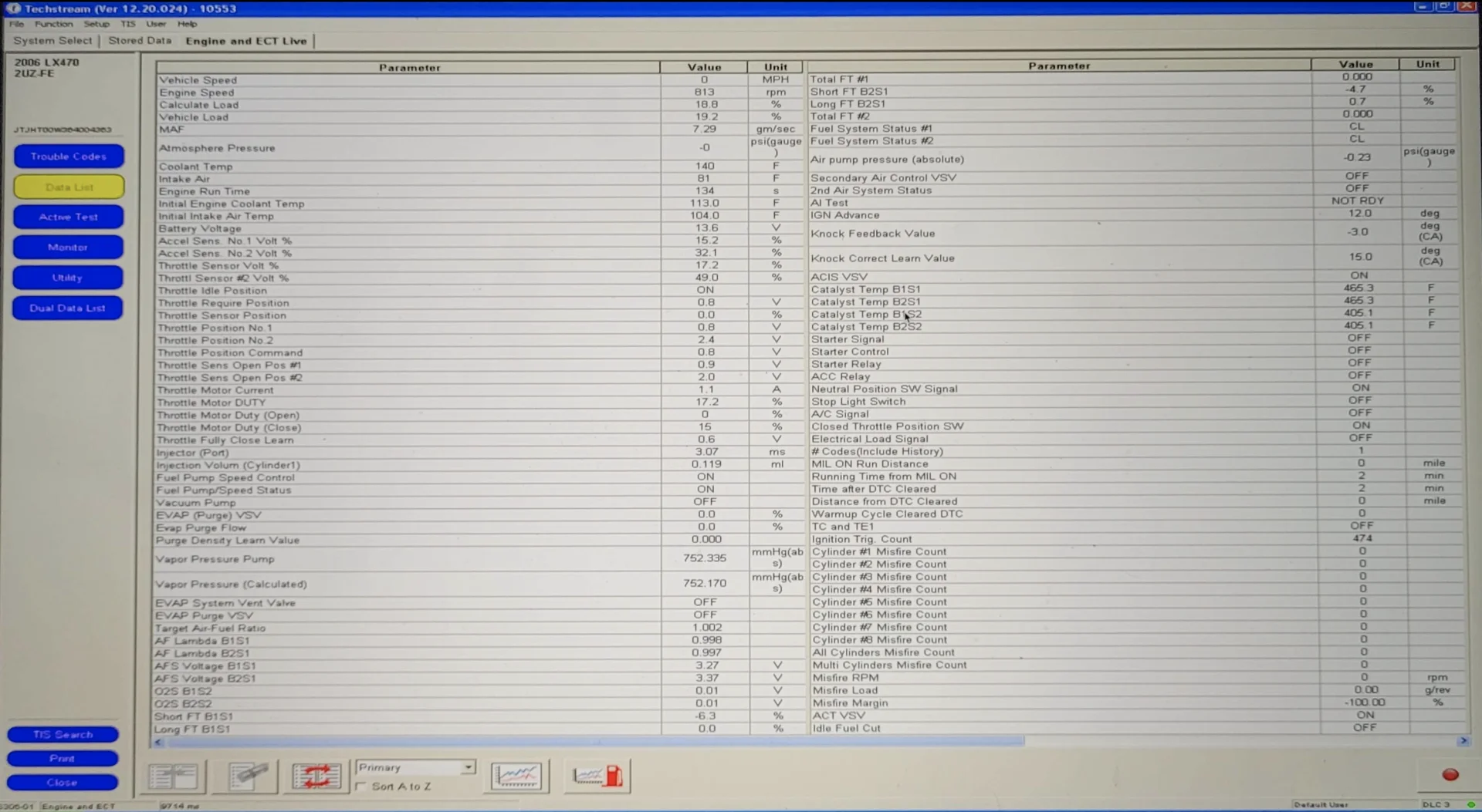

the 3 knock values in your techstream shot look like normal numbers after a reset/ battery pull.
I have never looked to see what the numbers look like while the 0333 is current.
The safe mode effect is that brake drag, no torque feeling. It's ignition related and it's suppose to feel like that.
I figured as much, thanks for confirming.

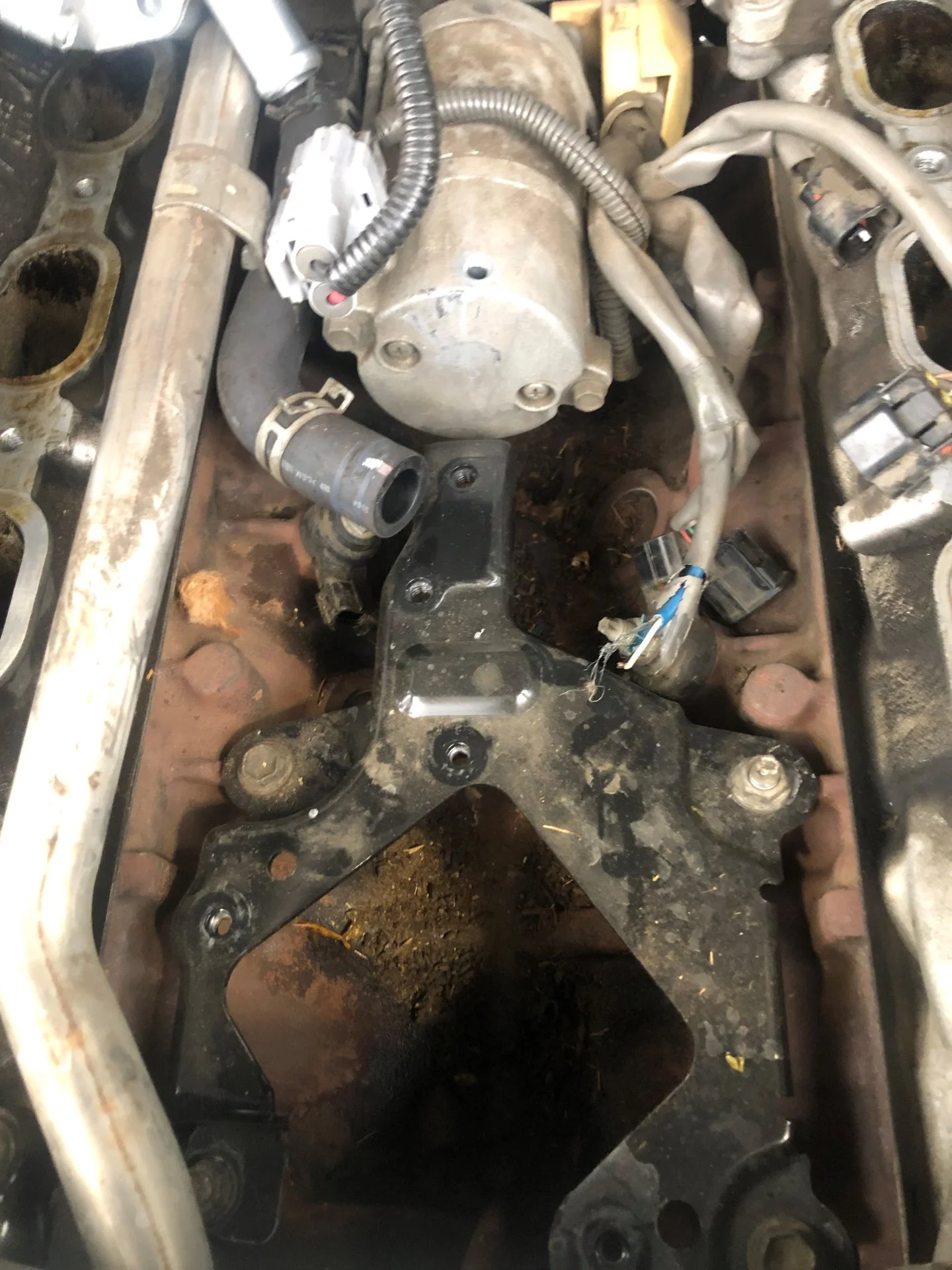

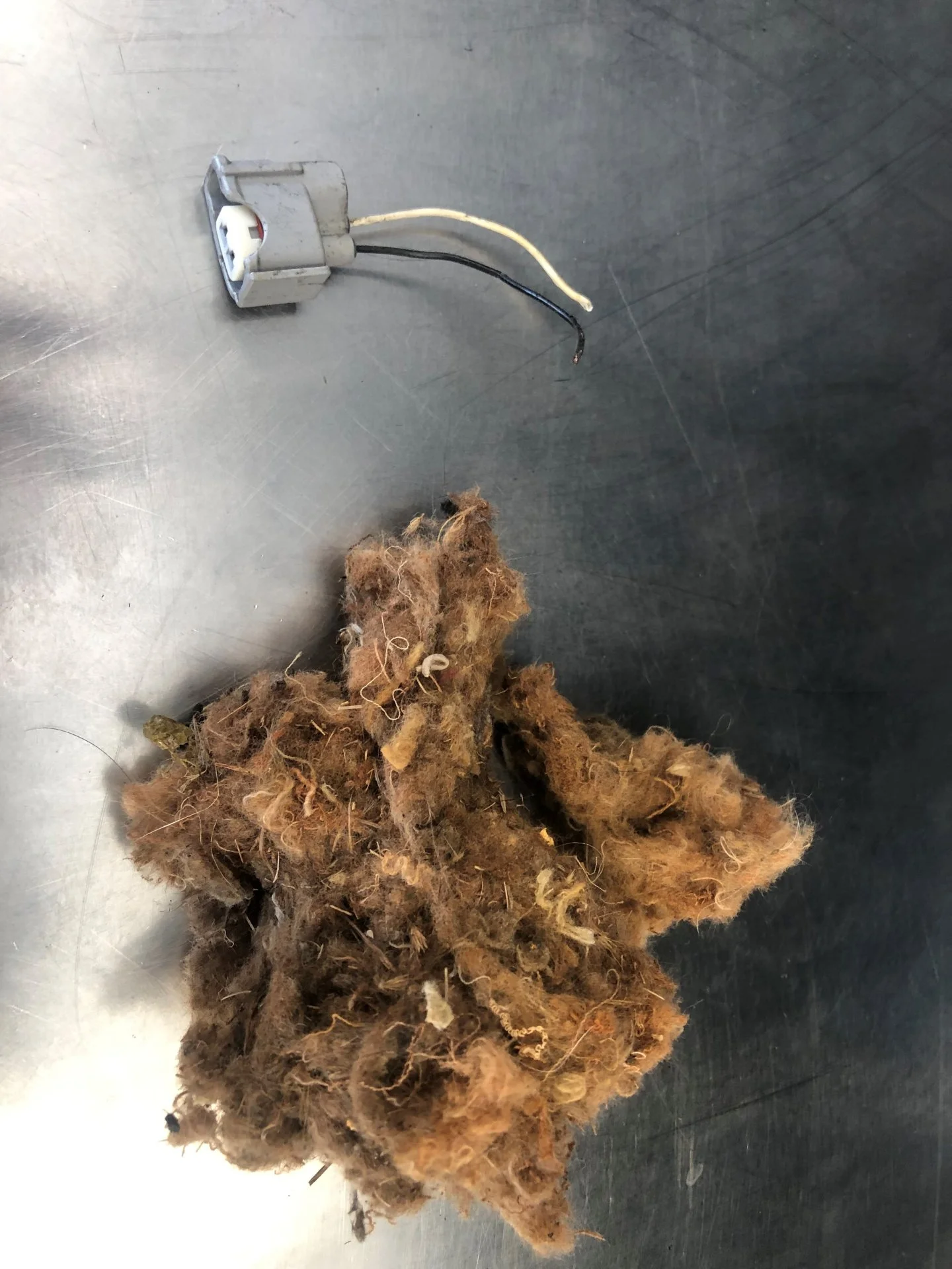

Turns out dealership manager is stand-up guy and he had the truck towed to his service center for inspection. They are removing the intake manifold today to look for rodent/wire damage to sensors/harness and he seems to indicate they will replace knock sensors/harness or whatever is needed.

OO that makes me shiver. Ask for pics of the wiring repair and any part numbers they use.
I'd like to watch a used car lot jump starting guy get the intake off.
I'm praying for you
This is what they said they found. And now they want me to pay $1,418.13 with parts, tax, and labor.
they sort of got you don't they. It doesn't look that bad. That's probably mostly labor I'm guessing. Odd they'd sell a unit that couldn't pass inspection/emissions.
Being shady like that would make me tow it to my house and finish it.
They probably aren't even going to really clean out the intake either.
I'd watch them like a hawk if you pay them.

With nest like that I don't know if that can happen in 3 short months. But from their perspective, if damage was done sooner (while they owned it), wouldn't I have gotten the P0333 CEL sooner?

Are those exposed holes valves? Shouldn't they be covered with a rag or something to keep debris dirt and other crap falling in?

yes they should be covered.
