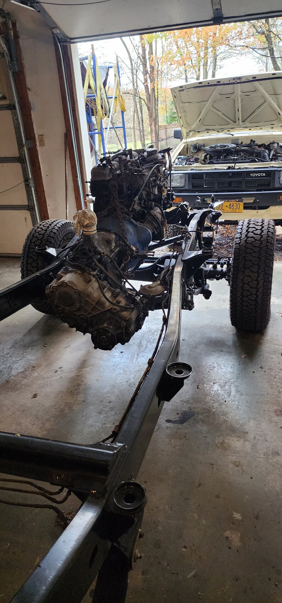

Cut the old 62 mounts off, gett8ng ready to weld in my mounts in place so that the motor can be dropped in.. gotta get the bottom of the cab cleaned and undercoating in some fashion. Lots of work still.
Finally got the motor mounts and tranny cross member welded. Now I gotta address a few things with motor.
Ok, so I finished messing with my pickup. Perhaps a couple things left to do, but for now, will focus on the 60. Motor is in. Ready to start getting this thing back together. I wanted to replace the seal between the t case and tranny, but by the looks of the fsm, I might need some pullers? Is that correct, or will the gear trains come off easily?

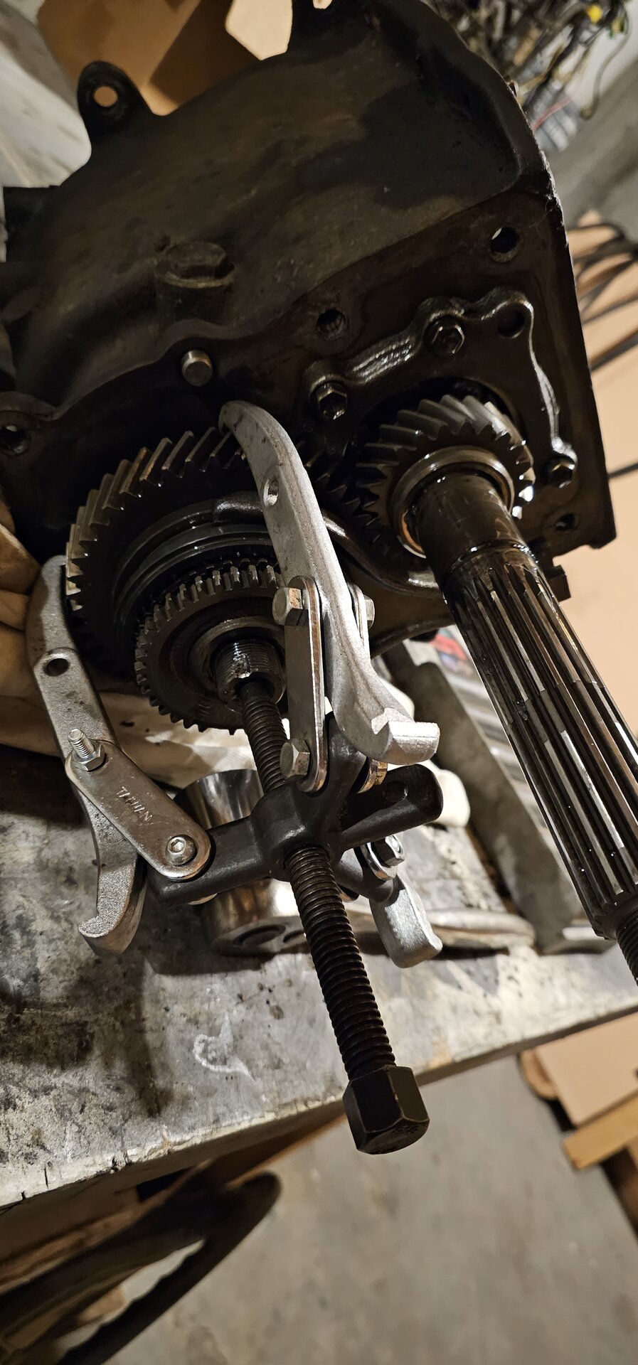

I have at least 6 bearing puller types, and I still don't have enough to do this job!! Sheesh, I still have to buy more. wtf!!
Trying to get the tranny rebuilt.
Not yet, I am hitting road blocks due to lack of tools! And I have tools, no kidding. Again, need skinny jaw bearing pullers. I might grind some of mine down. Once past that, I can continue dismantling. This is also my first time taking down an H55F.
Guys, can anyone share a part number or a brand of a puller with really skinny legs and at least 11" of reach? This transmission is a damn puzzle, I tell u that. I finally got the input shaft out, with some make shift pullers, but then I tried removing the outputshaft bearing, again with makeshiftpullers, and it won't budge.

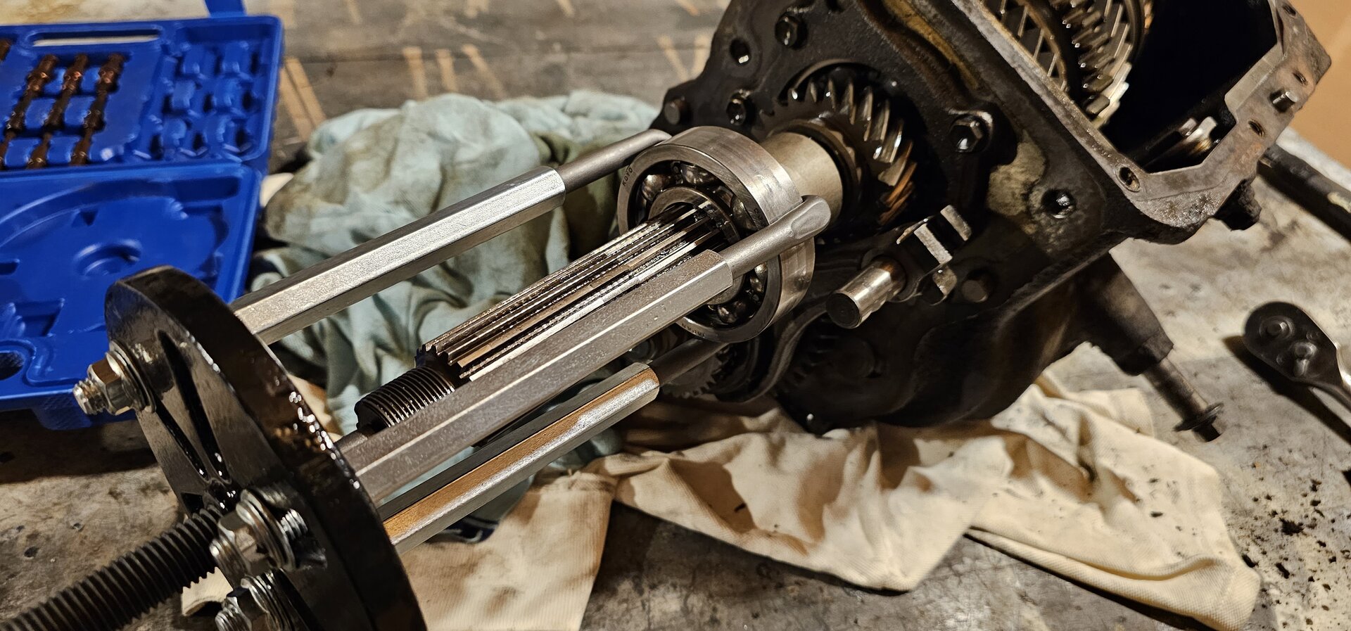

I made some really skinny legged pullers out of some metal I had laying around, added some weld beads on both sides of legs to try to aneal the metal and add strength. It just won't work. Can someone recommend a puller? I'm bout to throw this thing away and buy new!
Oh, and I forgot to mention, the output shaft bearing is the one that has crunch in it! I'm thinking that there lies the problem. There is excessive play and crunching when spinning the shaft.
Looks like I managed. Made some pullers, worked well but I had to really work to get that bearing out.
