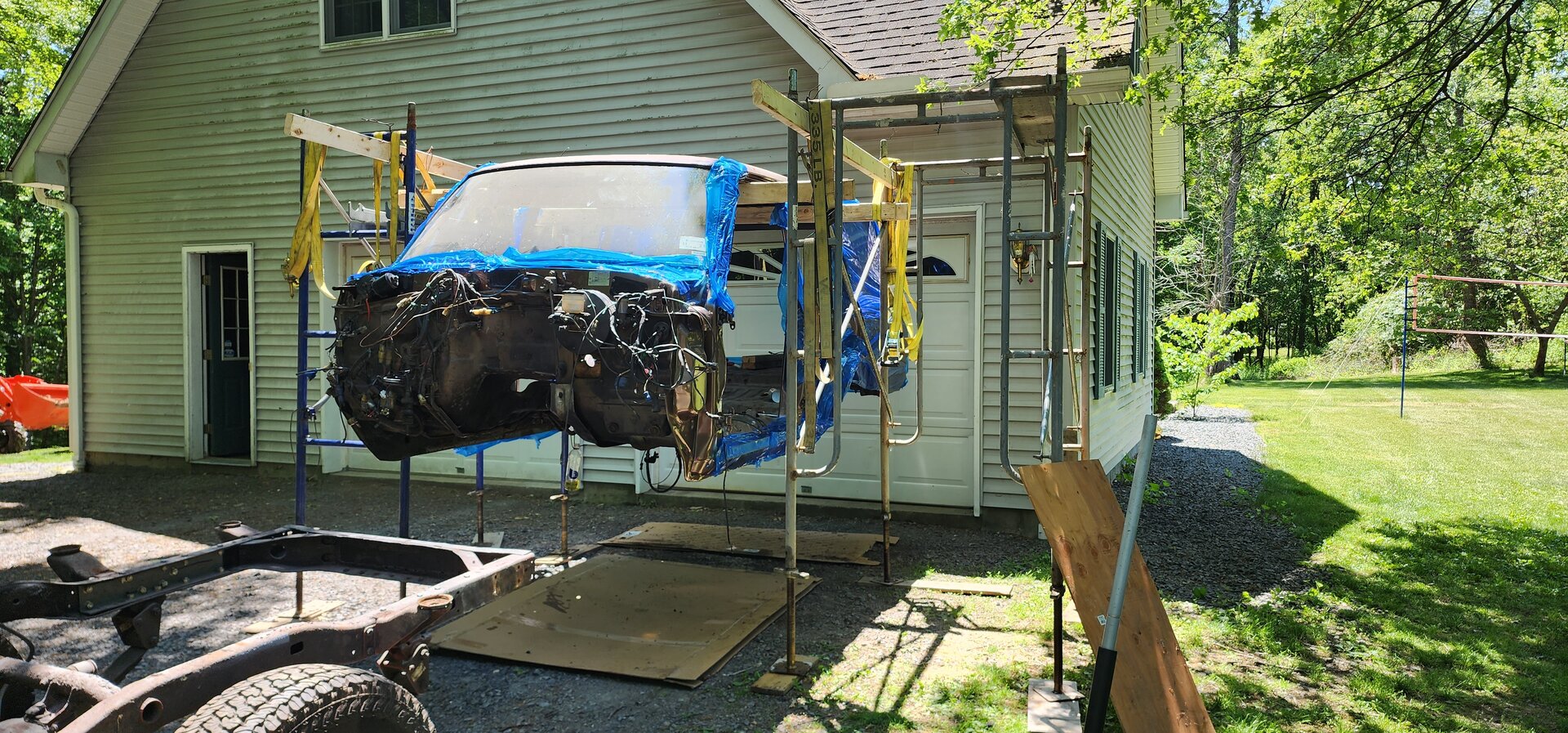

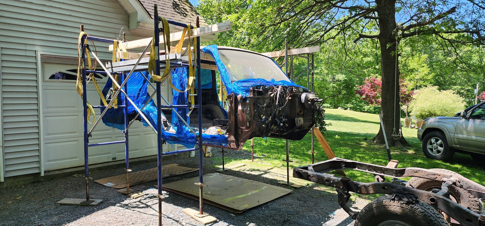

Jerry rigged some scaffold to raise the body. Used the screw jack to raise it off the frame. Worked a charm. Stripped the motor some, got the turbo off in one piece.
Motor mounts have to be moved forward one inch, the transmission mounts have to move up by a staggering 14.75 inches. That powder coat job's about to get ruined in some places.

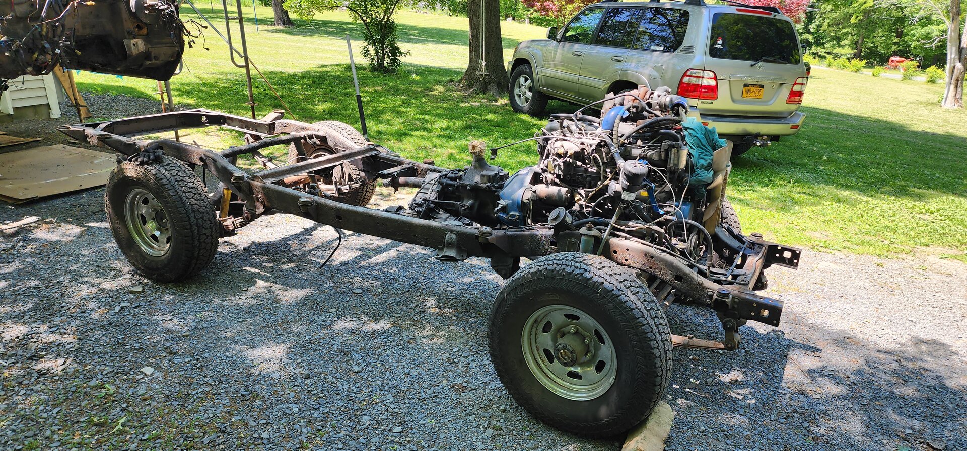

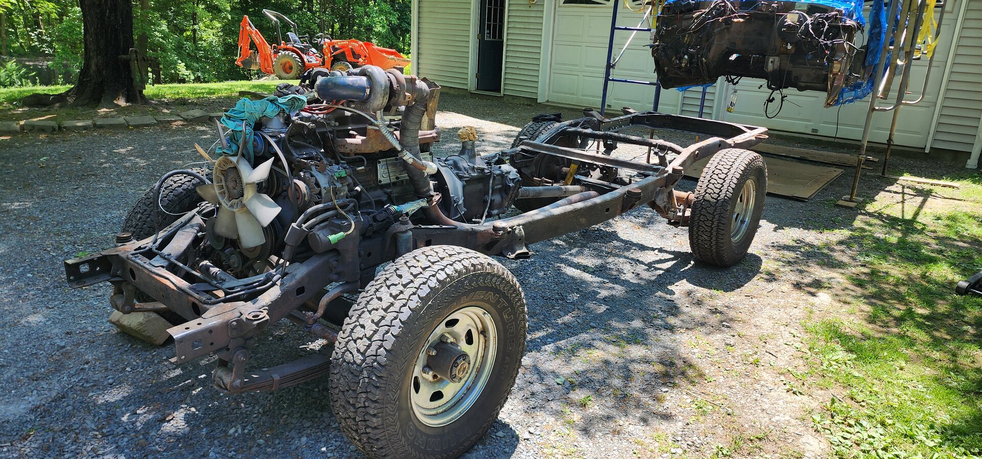

Now, motor's ready to come off. I am toying with the idea of an engine rebuild again. This time blueprinting everything and taking my time. Also want to rebuild tcase and tranny. Got some new spiders laying around for the drive shafts too.
Question is, should the turbo go back on, or leave it be NA so she run forever? I sourced a 12ht exhaust manifold a ways back to get the setup to look cleaner.
