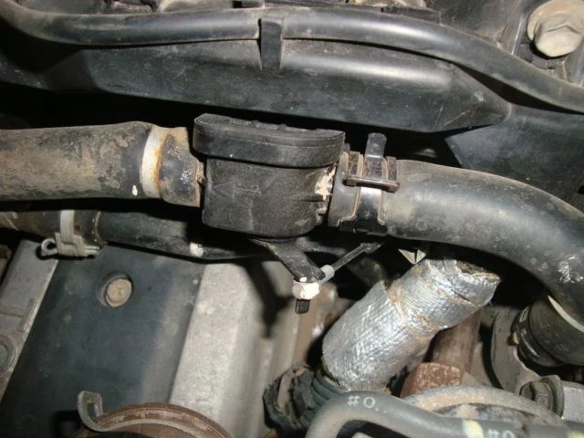

I would bypass the heater core, as you mentioned earlier and see if this improves your temps... I have a feeling it will.
Just get a U shaped heater hose the same diameter and attach it with clamps, and then just cap the heater core tubes at firewall.
That would isolate the problem and also fix it temporarily until winter arrives. :D

I would bypass the heater core, as you mentioned earlier and see if this improves your temps... I have a feeling it will. Just get a U shaped heater hose the same diameter and attach it with clamps, and then just cap the heater core tubes at firewall.
OK, where exactly are you thinking (image below):

That's what I and others keep coming back to. I will be plugging the heater line and see.
