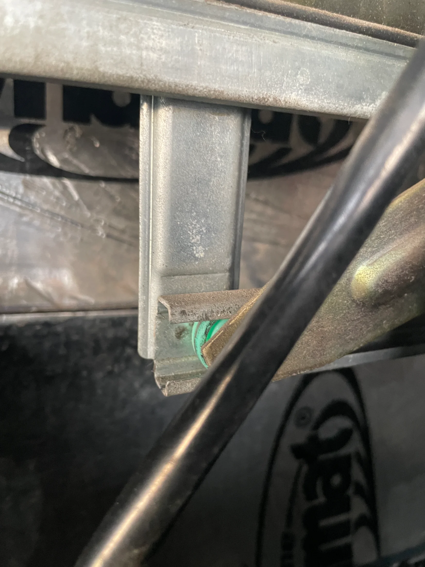

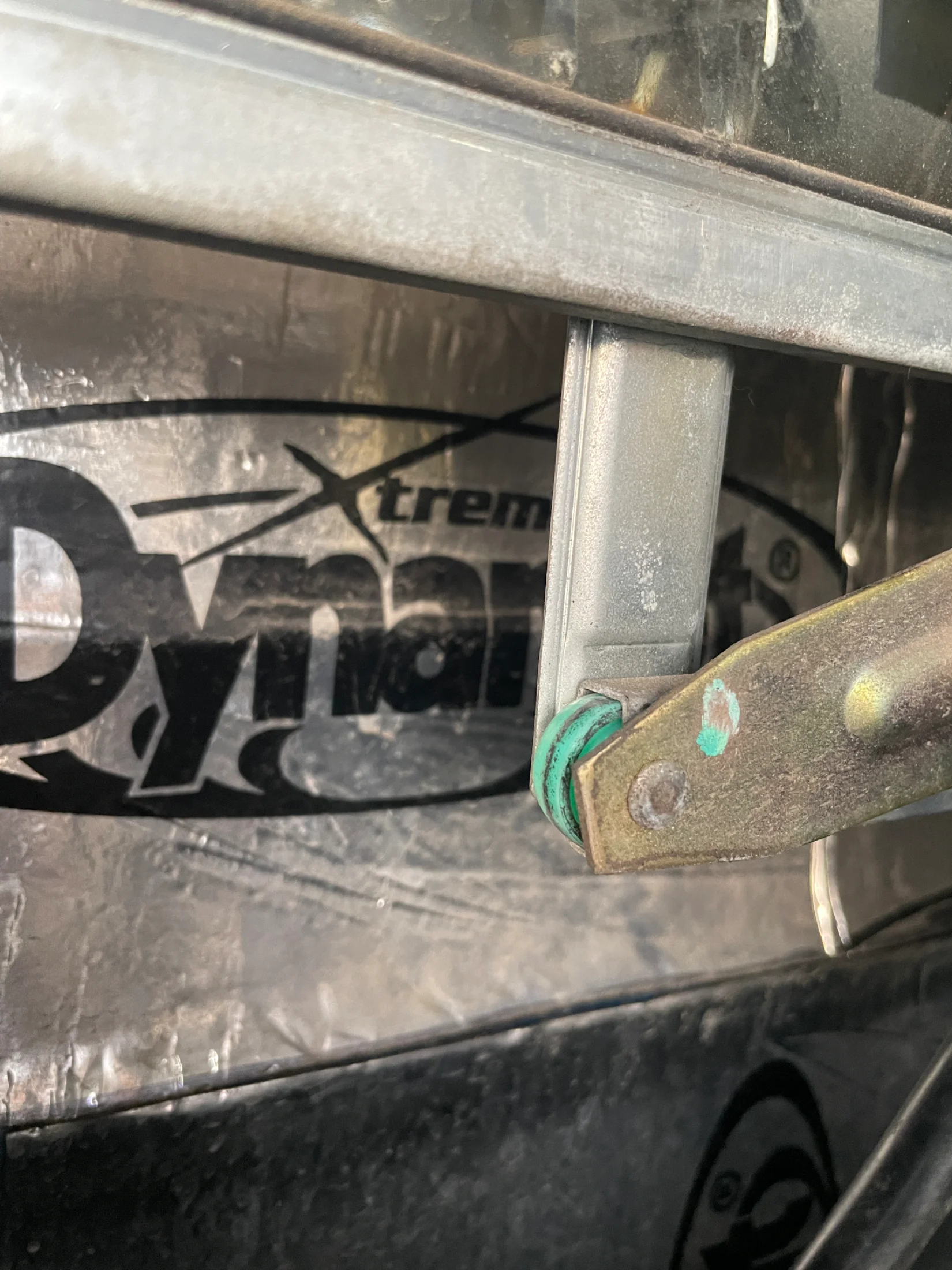

What would cause this green roller to jump out of the window roller channel? The symptom of this was that the window wouldn’t roll all the way up. Once I got into the door, I was able to put this roller back into the channel and the window work rolled all the way up.
I’m sure this will happen again if I don’t fix something. What is that something that caused this roller to jump out of the channel?

I had this happen on mine. The glass can rotate enough in the tracks and the slide can shift to the right enough for it to come off track.
I ended up using toyota fipg to re-adhere the slide to the glass and greased the track the wheel rides in and solved the issue.

I did all that you mentioned above. I don't see anything obvious of why that roller would come out of the channel other than the channel needs to be moved ro the right as mentioned above. Thanks for your response.

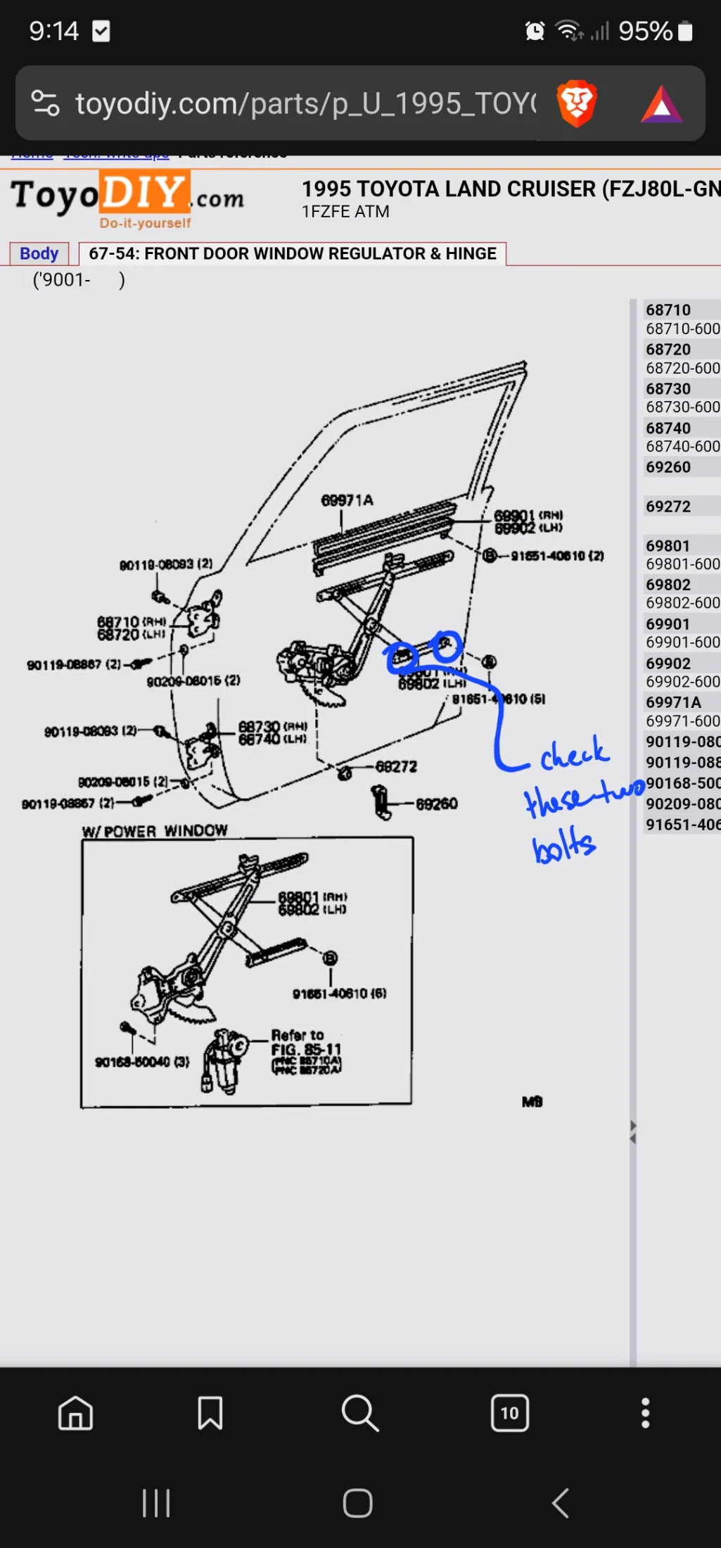

Also check these two bolts on the inner door skin.
If these are loose, or shifted, the regulator can twist/tilt inside the door. The window glass will tilt, the glass won't follow the rear edge of the door frame, and the front roller can come out of the guide channel
That's something that hasn't been mentioned yet. I will check that out. Thank you.
