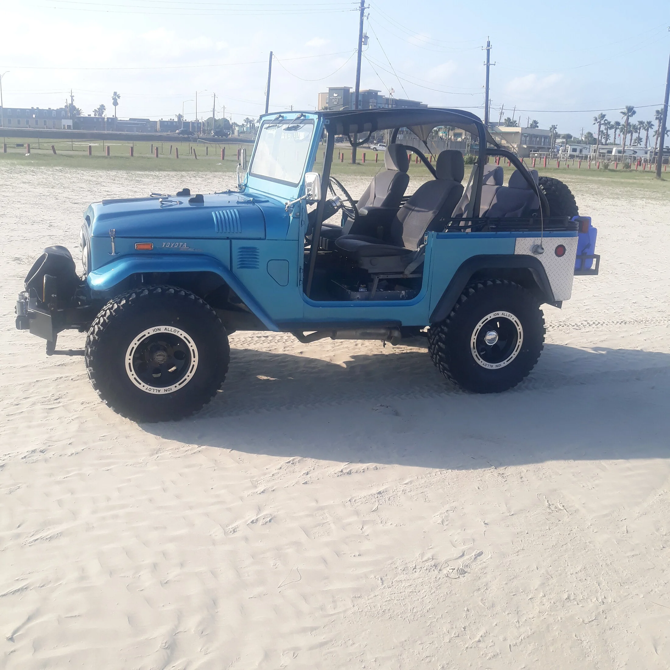

Anyone know or have a set of original steel wheels for a 72 FJ40 but in a "deep dish" (10" deep) finish? Not worried about the color as I can have them powder coated. Any info is greatly appreciated.

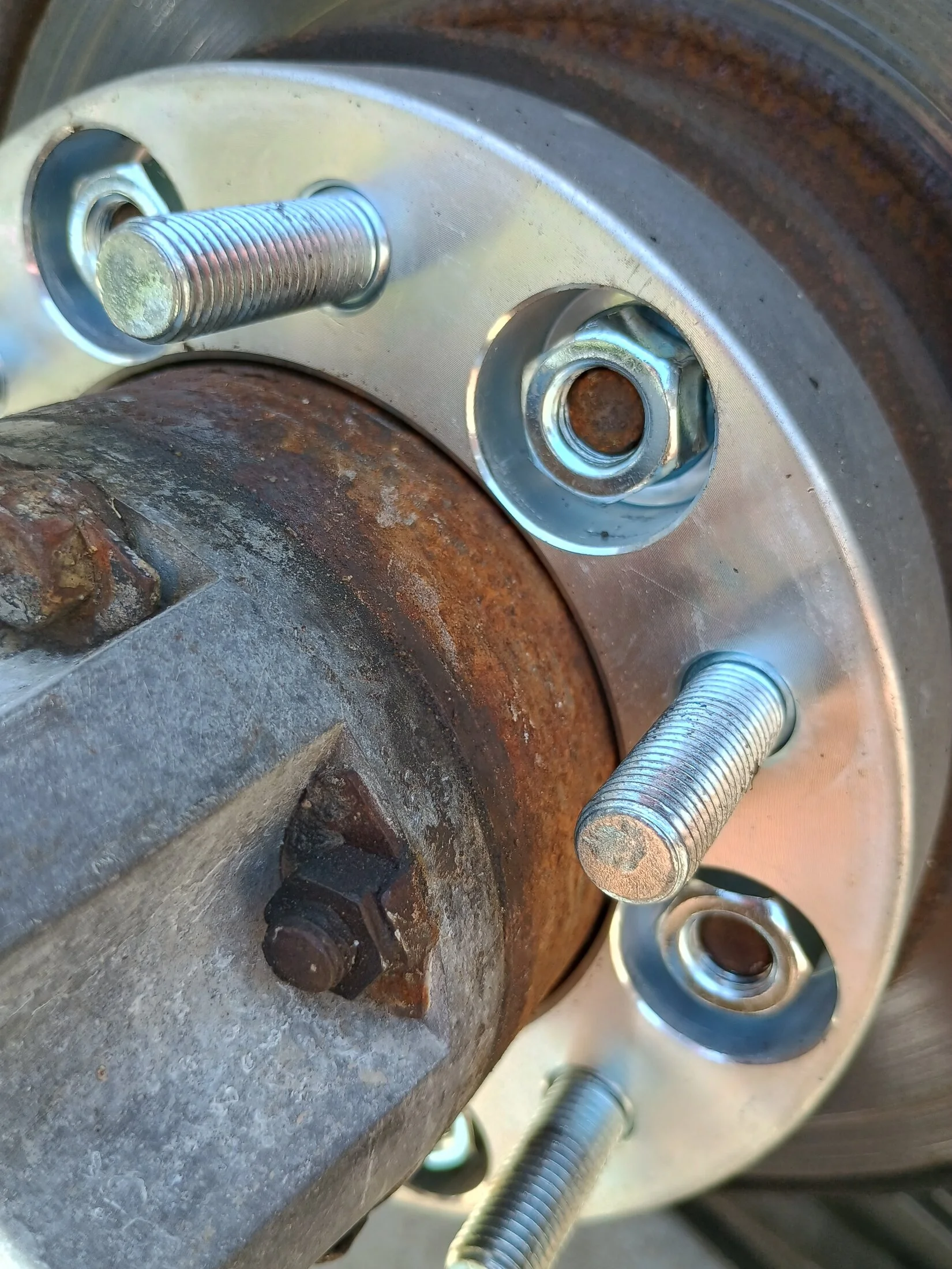

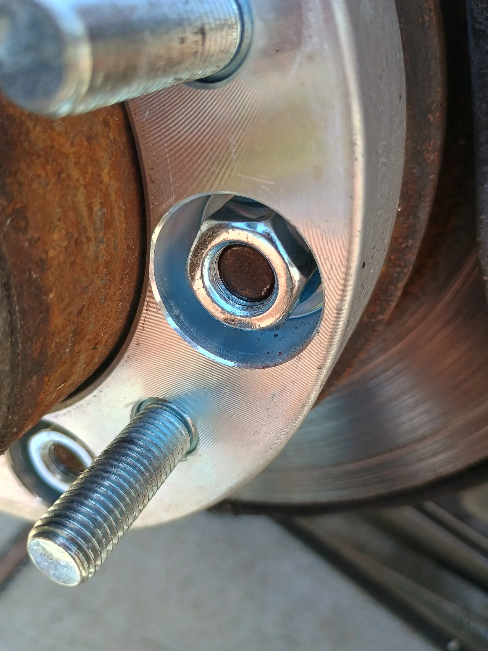

Here's what I'm contending with (see pics below). The nuts that hold the spacer onto the hats are only engaging 50% and not fully. I checked the torque on them today and they have not backed out nor loosened. I just don't like the thought that only 1/2 a nut is engaged instead of a full nuts worth. What have y'all done? I know the next thing I can do is get the correct rim for the vehicle, but I just don't like the 5" wide rim, make the rig look whimpy (in my opinion). I would like a stock wheel in a 10" width. Anyone have some they want to part with?
Can't you remove the spacers and knock out the factory studs, then replace them with longer ones? I think all you need to clear the calipers is .25" spacer unless that won't work with your wheels offset. I think I would source longer studs if you intend to keep those bolt on spacers. If they're too long, cut them flush once the spacer is re-installed.
