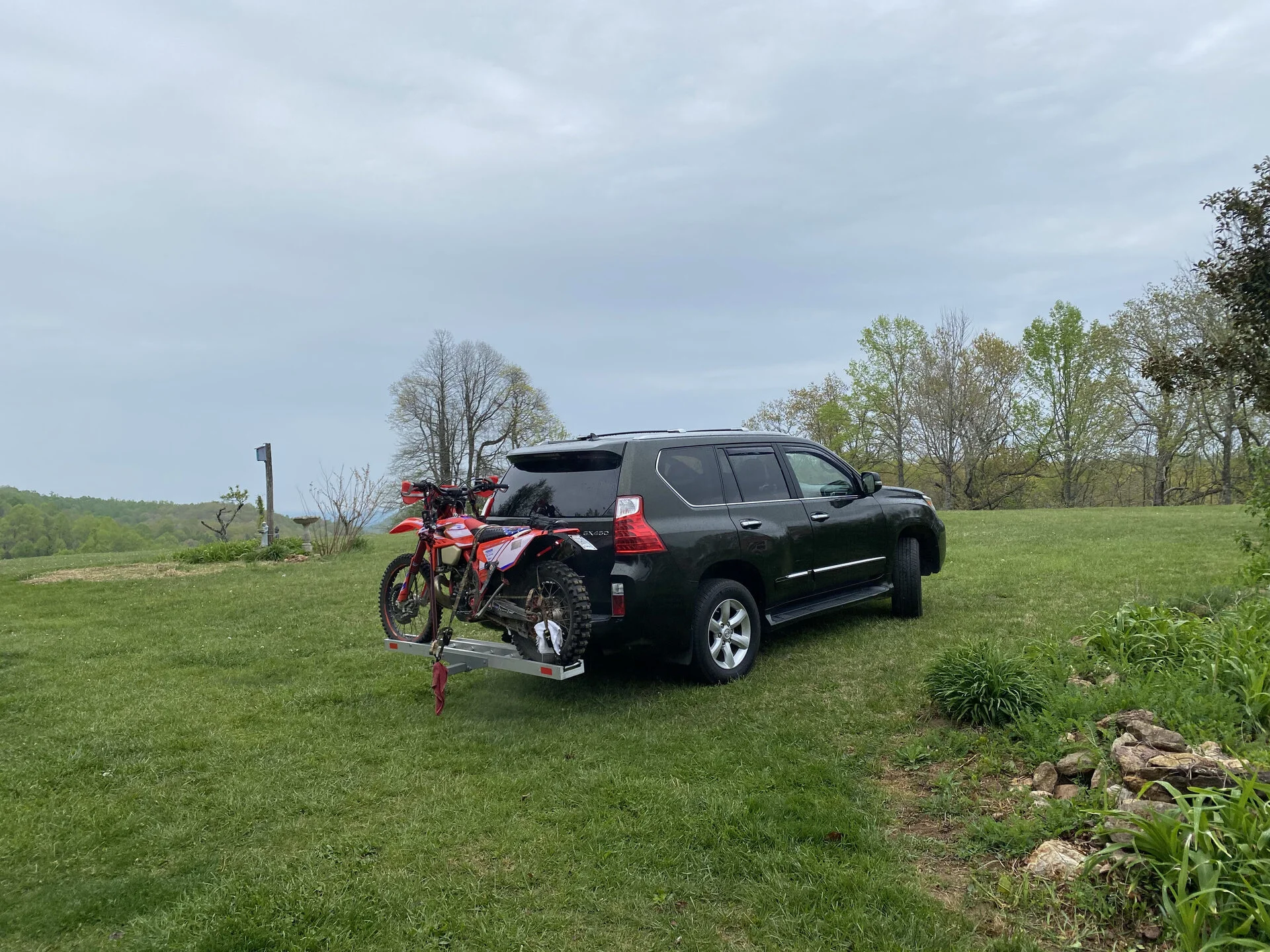

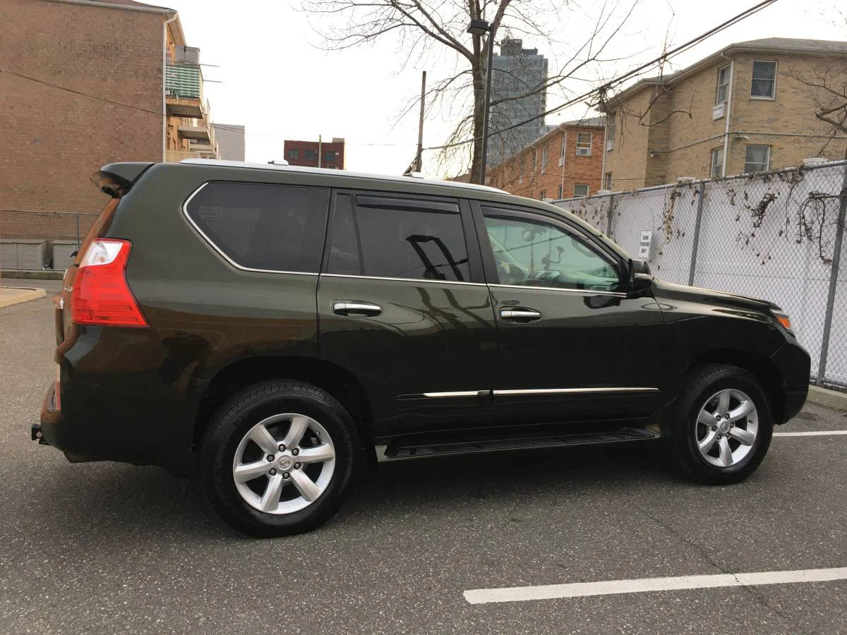

I have a 2010 GX460 with 155K miles on it. I have owned it since 2020 and I love it. Emerald green with a black interior, It is whatever the fully loaded version is (with airbag suspension and AVS).
I often haul motorcycles on a hitch rack on the back, so I really like the auto leveling air suspension in the back.
It is almost time for a new set of tires, and I would like to replace the stock wheels and tires with something that looks slightly more utilitarian, and give myself a touch more heigh, and perhaps slightly larger tires. And I would love to do this while keeping the airbag and AVS functionality.
Not looking for anything crazy, and my off roading is limited to dirt / fire roads usually to get to dirt bike trails. So I do not need an aggressive articulating suspension. I am also very happy with the ride currently and would prefer not to impact it too much.
I have read a bit that you can add a simple spacer to the front suspension in one of those "front leveling" kits - was thinking of going this route. And have found some questionable information about adding spacers to the airbags in the back. Alternatively I could do the rear airbag sensor washer trick.
Questions follow:
- for what I am looking for do the front spacers make sense?
- is there a brand that is liked?
- what size should I look at?
- what is the best approach for the rear.
- What are some recommended tires to pair with the 17" TRD (or TRD style) wheels that perform well in city/highway conditions?
Thank you all in advance!
here are a few pics for attention

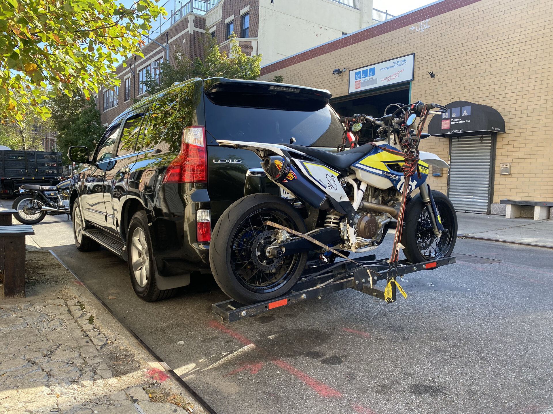

Ezra, is that a Beta in the first pic? I had a couple of their trials bikes. Nice XS650 too.
At 155K your OEM shocks, although they might seem to ride OK, are probably near the end of their lives. So it may be counterproductive to go through the effort of installing a spacer lift up front (which comes with it's own issues - as mentioned by others) only to have the front shocks start leaking 10K from now. So it may be worth looking in to a lower-cost lift kit (such as a Bilstein 5100 kit which is a common lower-cost option for these rigs).
Yessir, betta 300rr2t race edition and a husqavarna FE501 that has been Supermoto converter. ✌️
I had the term backwards - whichever the term is where the shock hits max compression before the rest of the suspension/bump stops do. Now that I'm rereading my comment, I see the connection lol.
Oh, I think that is an XR650 in front of my car...not mine. It's a community moto garage I used to keep my bikes at here in Brooklyn.
