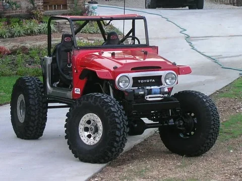

Anyone ever put an Aqualu FJ45 body on a 40 frame? It looks like for around $6000 I could get about everything but the frame. i think I could use my frame, engine, springs, drivelines, axels, and so on. Not sure which body would work best for the 40 frame. Thoughts????
Im thinking I may do this. It would be a great build project, however, it may go slow due to money, or the lust for it anyway. Im getting over my respitory crap and all these extra days in the house has told me to build a 45 with my 40 stuff.
Maybe put the 45 cab and front clip on the 40 frame and build a flatbed for the rear. I saw a truck built like that in crawl magazine a while back and it looked great and wheeled amazingly well.
