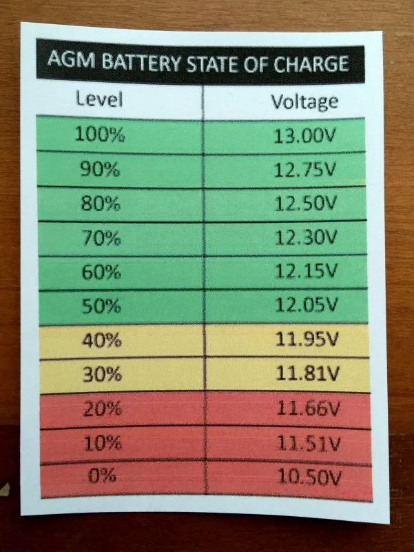

Question is; what is the minimum voltage I should allow this yellow to drop to? Is there any standardly accepted min voltage before battery damage occurs?
And then… when camping, any thoughts on how long I would need to run the engine each day to top the aux battery off? Or maybe a voltage I should take it back up to?

The Ecoflow delta is 80Ah. The Optima is 48Ah. The Ecoflow can be discharged down to near zero without any damage, but the Optima shouldn't be cycled to more than ~50%. (30% in a pinch).

Any thoughts on what voltage I should watch for to make sure I don’t go below 50%?

For the optima you just have to watch the voltage when unloaded. I used to plan to stop when I hit 12V, and around 11.8V was my floor. Even still I used to kill AGM batteries every 3 years or so, though I was recharging with solar on my trailer every day so it was a lot of cycles.
Perfect! Thank you!
I googled on the World Wide Web and couldn’t find anything as succinct.
