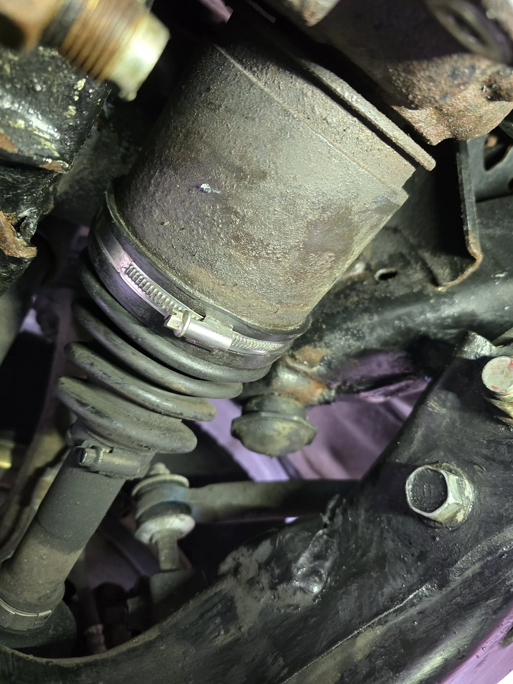

I'm using the mcmaster carr smooth edge/narrow clamps to address leaks until I reboot or replace. You can see one on the small end of the boot that i put on 4 years ago. Just put one on the large end of my leaking boot last night.
You can loosen and rotate the clap and retighten and see if it works
