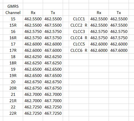

I agree with having a CHIRP file with a basic, simple format (the older I get the simpler it needs to get :( ) with just the GMRS simplex and repeater freqs. Makes the B'feng the equivalent of a blister pack GMRS radio. The second option, for those who know comms and the inner workings of the radio, might be to have a CHIRP file with the duplicate freqs with GMRS & CLCC names for those who want to avoid using the chart and/or maybe add the MURS, ham and weather freqs too???? The user can then customize the file as needed. The B'fengs have over 200 channels so space is not a concern. Plus, I'm sure the hams will want to customize theirs to include the local and Moab ham repeater freqs, as well.
The blister pack GMRS radios can only do simplex or repeater on any of the 8 channels. The user has to select if the channel is to operate as a repeater or simplex channel. So a total of 8 channels. I agree, the programmable B'feng type radios should get programmed with the simplex channels and the repeater channels for a total of 16 channels (8 simplex and 8 repeater). Going into the menu of the B'feng to change from simplex to a repeater offset freq is a royal pain. It is much easier to just switch channels from 15 to 15R.
Thoughts?
Ed
Yup, I like it. This is the best and simplest plan for non ham bands IMHO.

If our goal is to encourage Ham adoption (or better yet, DIScourage CB use) I think we should change our freqs to what the commercial GMRS radios are using. Make it easier for others to join the party. It will definitely be an undertaking to switch over all our radios but it's not like we don't have the capability to do that. How long does it take to reprogram the Motorolas Ed? Assuming we had 50 out there is this a 2 hour exercise or 20?

Each Motorla will take approximately 15-20 minutes to reprogram, and there are only two individuals who are set-up to program these radios, but that isn't the real issue.
CLCC Motorolas and Midland radios are already programmed to use the same GMRS Freqs and Codes as specified in Ed's table. Only the channel numbers vary between manufacturers so no need to reprogram Motorolas unless we are going to standardize on a different set of GMRS frequencies and/or codes. Keep in mind that Motorola HTs are limited to Channels 1 thru 16 so you are proposing that we standardize on Midland channels 1-16 for all radios. That creates a problem for the Motorola owners because there is no repeater "mode" option selectable by radio controls. Motorolas require a dedicated talkaround/repeater channel.
If we were to go that route, we will likely lose the use of the repeaters for all but one channel (15R) because the expensive parts of the repeater are limited to a narrow range of frequencies. This is why we only have repeater pairs for 3 channels (2-4-6) operating off the same repeater. We would have to fund and field more repeaters to cover the proposed spectrum if we standardized on the Midland channels.
Bottomline: If you want to use Midland's preprogrammed GMRS channels exclusively to avoid reading a sticker mounted to your radio, go buy a new GMRS radio.
With regards to Motorola users, if you like your radio, you can keep your radio. That's a promise that will be kept.
