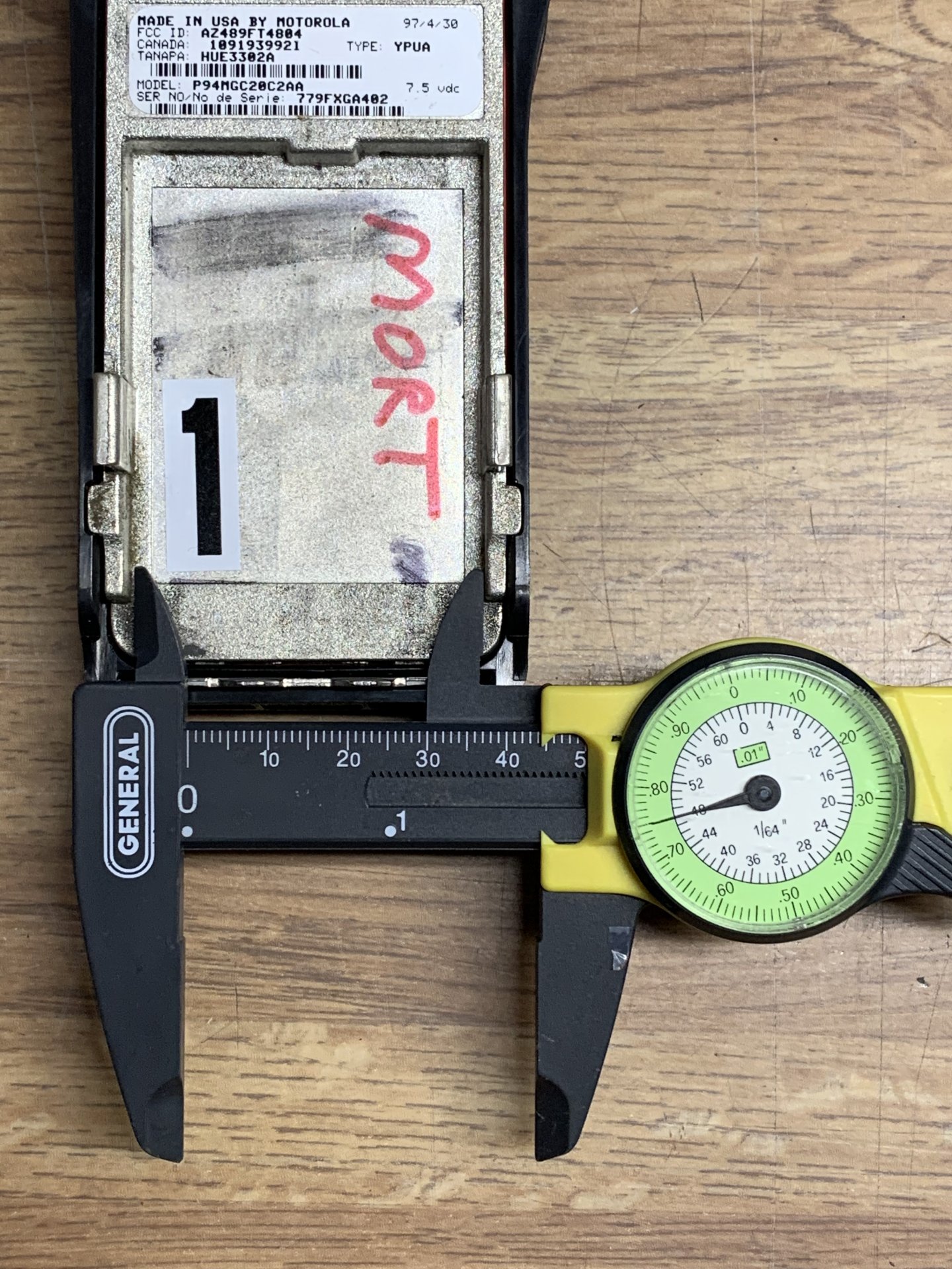

USER=10584]@emorth[/USER] I really like this idea! Can you or someone that has one get me the size of the spot on the Motorola radio and a rough count and I can get a sticker made with the Frequencies. I will be getting extras for Us Bofang guys also.

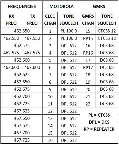

Motorola radios: print a small version of this chart, remove the battery from the radio and paste the chart to the radio. This way you have an accessible cross reference between the CLCC channels and the GMRS channels. If you are really cool, laminate the chart.
View attachment 2929493 View attachment 2929494

Midland privacy code No.68 = DPL code 612, so yes, Motorola radio users on CLCC channel 1 (using DPL 612) can hear and talk to Midland users on channel 15 (using privacy code 68).
Conversion chart available at the link below.
And "PRIVACY CODE" is misleading. It only prevents nearby users from eavesdropping if they are using a different privacy code. Anyone using no tone squelch can listen in on any conversation because FCC rules prevent encryption on RF except when Uncle Sam or his minions do it.
So that's an oversight. Doesn't make sense to have two channels in the chirp file that can hear and (especially) talk to each other.

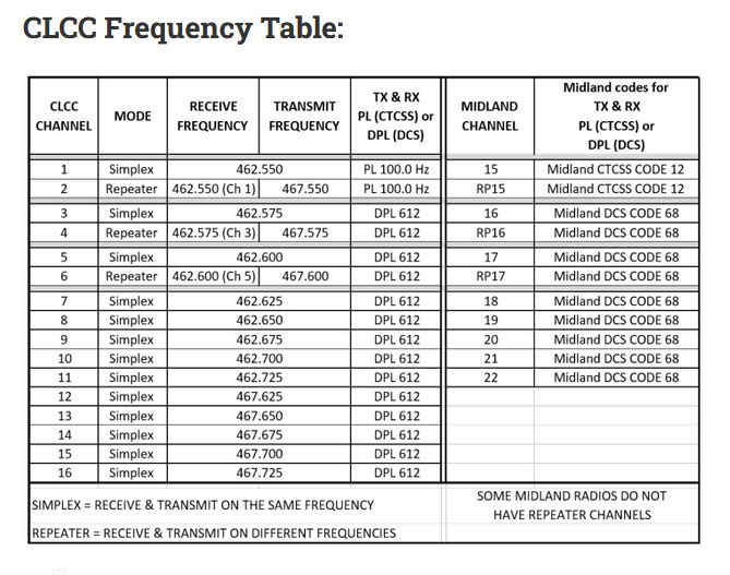

The chart is a channel & squelch code cross reference between the CLCC's Motorola channel configuration and the commercial GMRS radios.
For example: channel 10 on the Motorola radio with squelch code 612 is the same frequency as channel 21 with code 68 on the GMRS. They will talk to each other.
Same freqs just different channel numbers and same squelch codes just different numbers
Analogy: 6:00PM and 1800 hours. Same time just different numbers.
Does this help???

To make it easy to select the channel. If someone says I'm on CLCC channel 10, you select CLCC ch 10 on your radio. If someone says I'm on GMRS channel 21, you select GMRS ch 21 on your radio. Yes, redundant. Same freqs and tone codes, yes. But that way you don't have to have the chart to convert from CLCC to GMRS channels.
For example: Oh, his GMRS radio is on channel 19. Now I'm going to have to find my chart to see what CLCC channel is the same freq so I can talk to him.
The CLCC Motorola radios only have 16 channels and no display. The B'feng GMRS radios have a gazillion channels. So a duplicate freq pair is no big deal.
