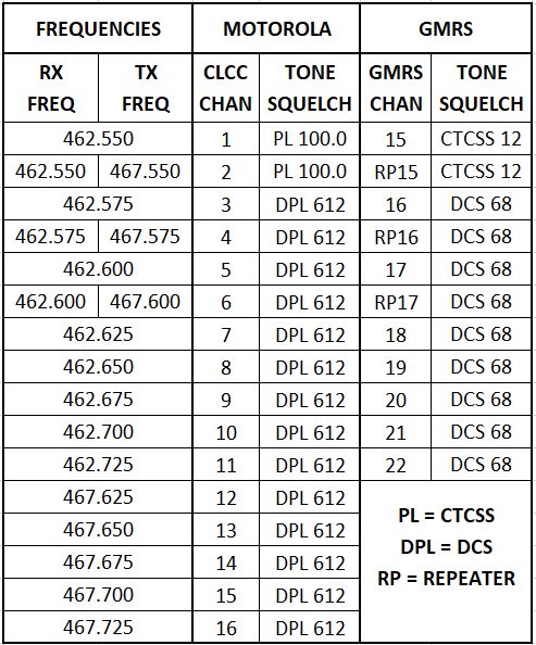

@Von Hayek What does "Print lots of CLCC to other radio channel configuration charts" mean?
This is the chart that shows the CLCC and Midland (and others) compatible channels.

So, here is a suggestion:

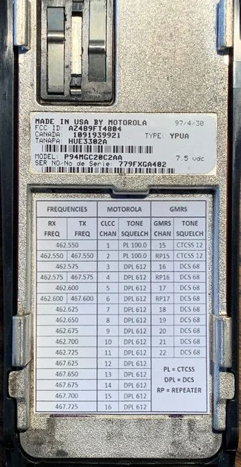

Motorola radios: print a small version of this chart, remove the battery from the radio and paste the chart to the radio. This way you have an accessible cross reference between the CLCC channels and the GMRS channels. If you are really cool, laminate the chart.

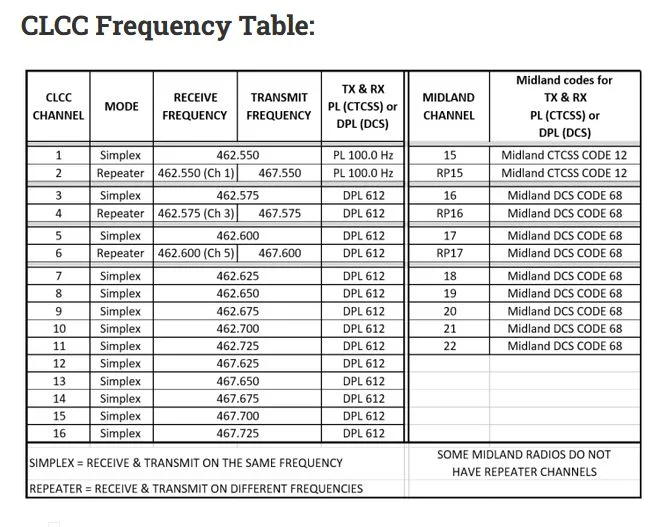

Baeofeng radios: Since these radios have a bunch of available channels, program both the CLCC channels and the GMRS channels (yes, somewhat redundant) into the radio so you can select either a GMRS channel or a CLCC channel. Set the radio's display to show the channel name rather than the frequency. This way you can select CLCC channel 5 or GMRS channel 23 depending upon which group you are with, even though they are the same frequency. This way you don't need the chart to see that 5 & 23 are the same freq. Thanks to @SeanLX from ONSC for the suggestion.
Something like this:

I like it. So looking at the chart, our Motorola radios can be me made to work with GMRS radios on GMRS channels 15-22? Seems like problem that isn't a problem.
And let the Baoefeng owners program frequencies for both.
Correct. Not a technical problem. Just operational confusion.
