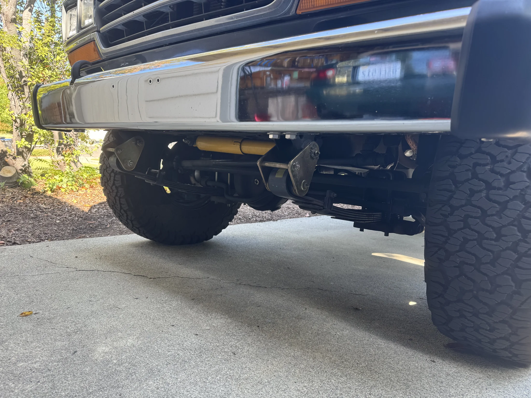

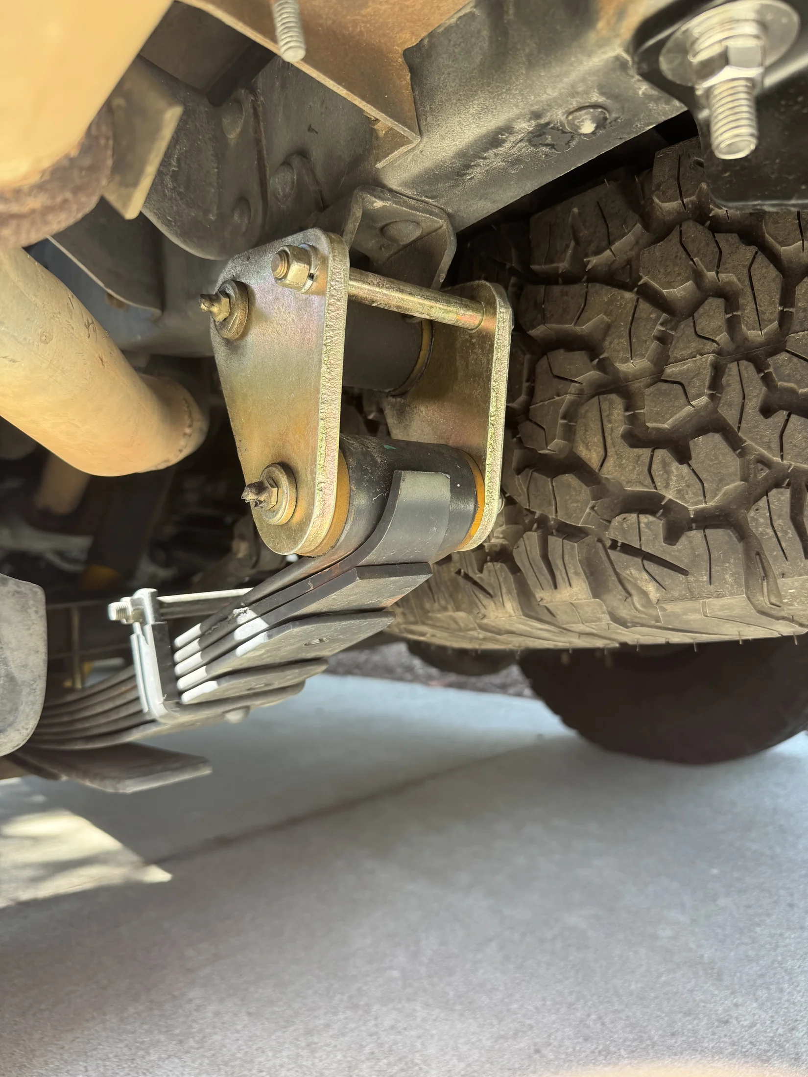

The shop that installed my OME lift put the shackles on incorrect. What is the proper orientation for the anti inversion shackles? Pics please!

And I hate say it but I believe your front springs are on backwards. Looks like the military wrap end with the yellow rectangle is installed on the shackle, should be on the fixed frame pin end...your rear spring looks to be orientated correctly.
But hey at least on the rear they only got the shackles backwards, on the front they got 'em backwards and upside down. o_O
Man good catch.... Sad
Go back to the shop and ask them to re-do correctly.
If they didn't know or weren't sure, they could have and should have asked.
WOW, just so many things not done correctly in the few pics posted
DAMN, look like mine are backward too!!! Think I got messed up by the arrow on the leaf spring , tought it was pointing toward the front .
that wrap was also backward on my other springs then lol
no big deal turning them , but thx for pointing this out too!
I’d take a good look at U bolt torques when they get home too.
Backwards and upside down. Go over everything carefully.

wouldn't seem it rode very well back to CA. the rear springs couldn't flex very well without being stopped by the anti inversion bolt
