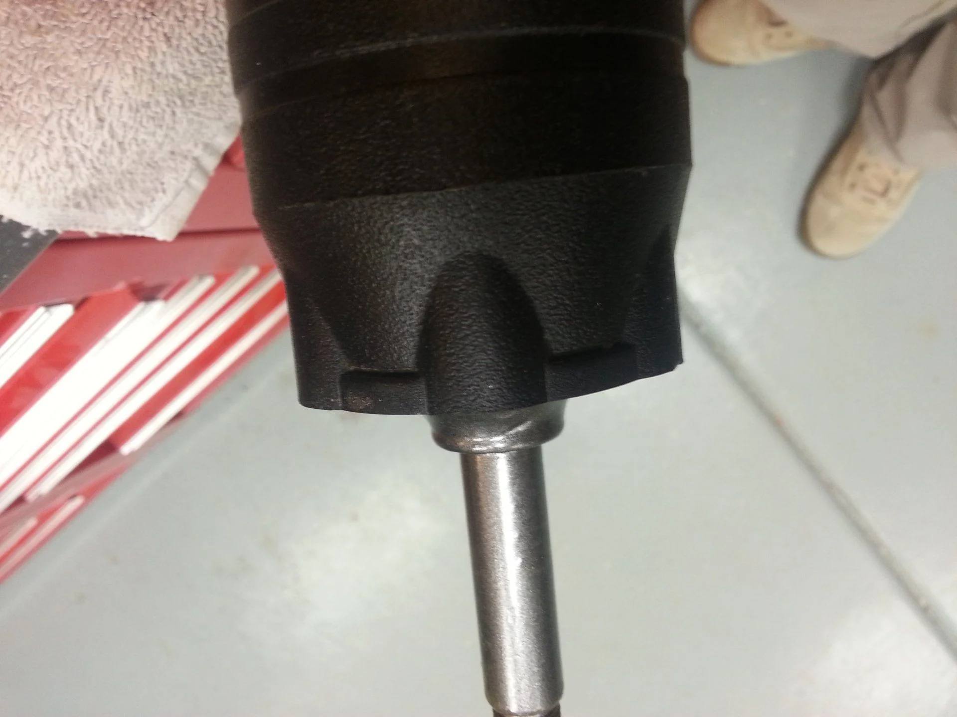

Well my newly acquired lift came with OME NitroCharger Sport shocks and while they have limited miles, they did look a little worse-for-wear.
Can't install them looking like this:

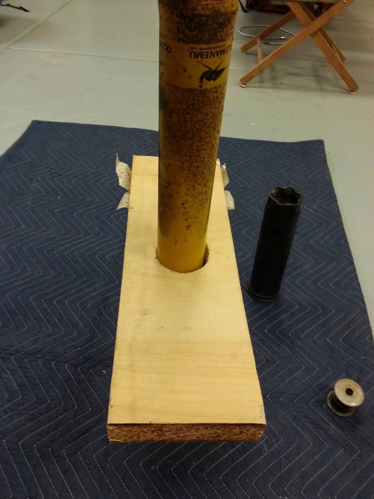

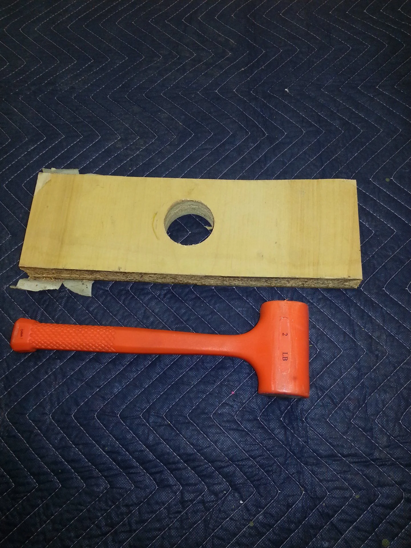

Plan begins with finding a bit of scrap wood and drilling a 2 3/8" hole in it. This is big enough to fit over the shock body but tight enough to evenly rest on the plastic boot. Next, find my 2lb. dead blow hammer and lay things out for the operation.

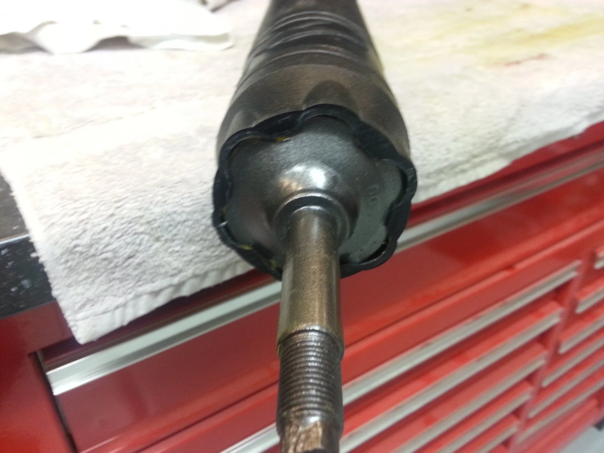

Place the shock with the stem down and the open end of the dust boot that surrounds the shock body facing up. Slide the newly mads tool over the shock body and place the stem on a block of wood or other semi soft surface. Hold one side of the new tool and whack the other side in close to the shock body with the dead blow hammer. Dont be gentle, one solid, committed blow is all it takes so don't peck at it with small taps. Off it comes.
No damage to the stem or the stem ring and ready for paint.
Old Man Emu (OME) plastic shock boot removal tools
The tools for this job are a dead blow hammer and a piece of sturdy scrap with a 2 3/8" hole in it.
Ready, Set...whack
Just slide the newly mad dust cap removal tool over the shock, place the nutted end on a semi...
