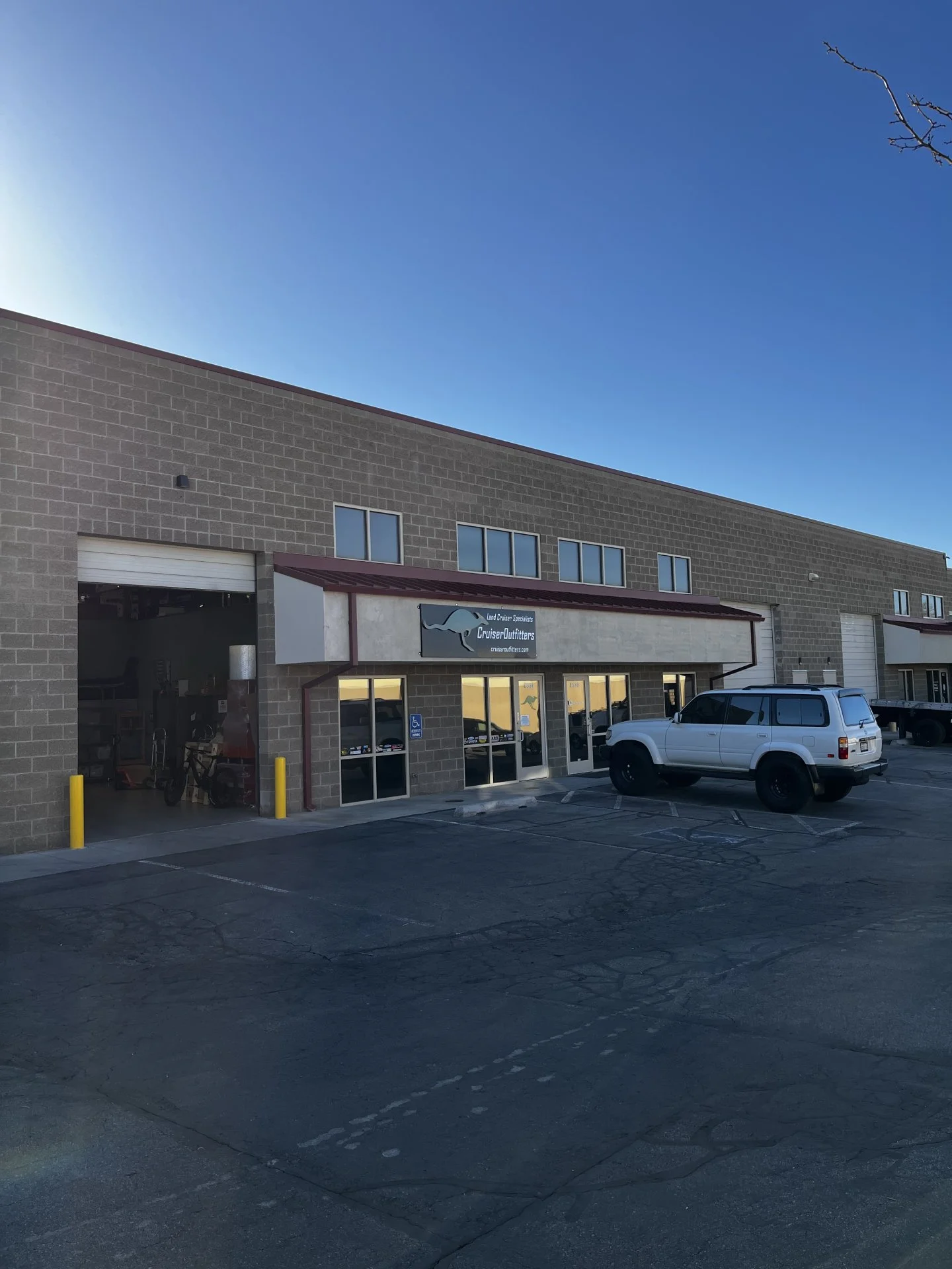

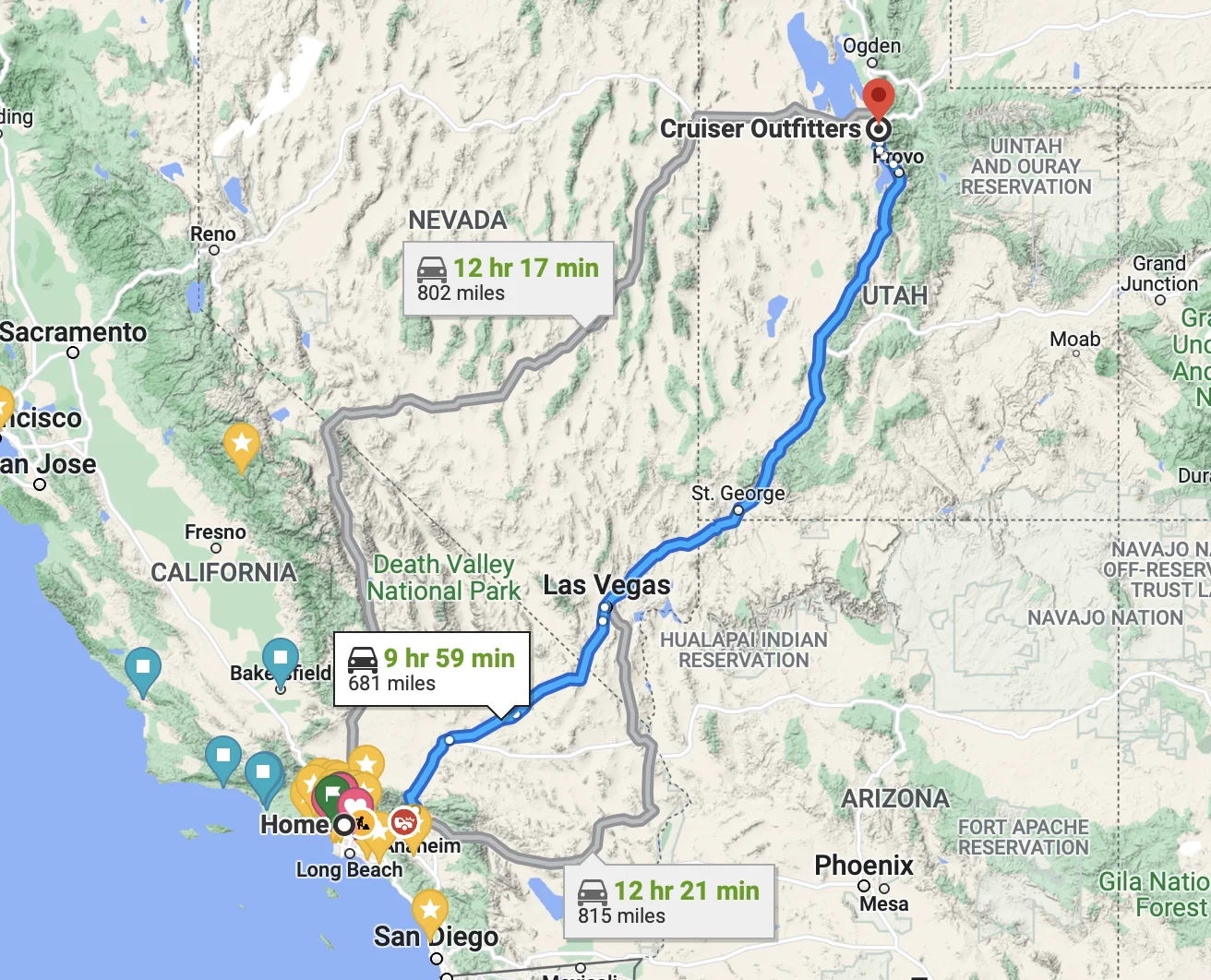

Update:
4YR/50K miles logged on the OME Nitrochargers + medium OME springs with 700 of these piled on in a one day bomb NE from SoCal to Salt Lake City.
I bought and installed the OME BP-51s at Cruiser Outfitters. Thanks for the t-shirt. SLC is beautiful.
My $.50 (reused the medium springs; only mod on my 80 is 37x12.5r17 tires)
