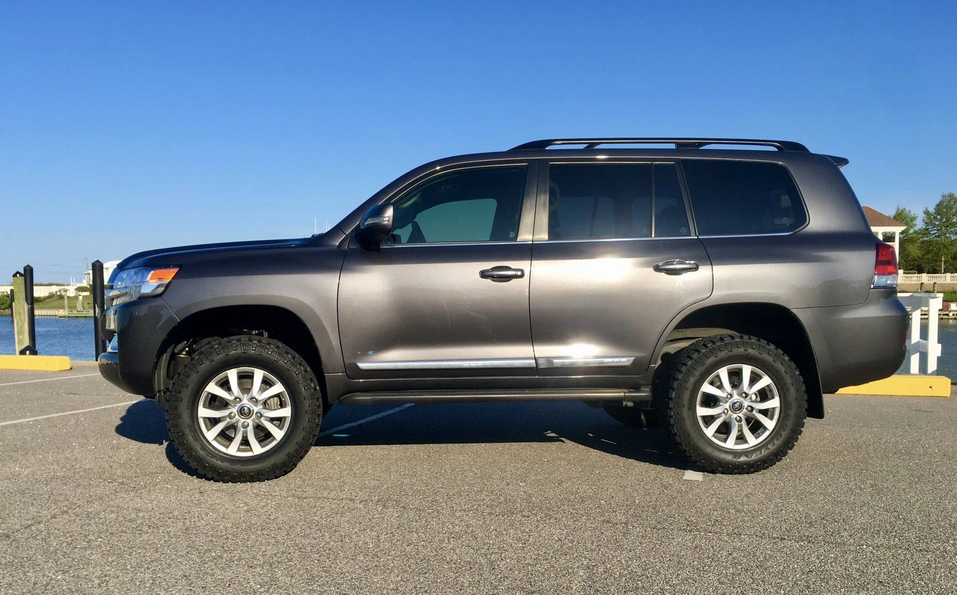

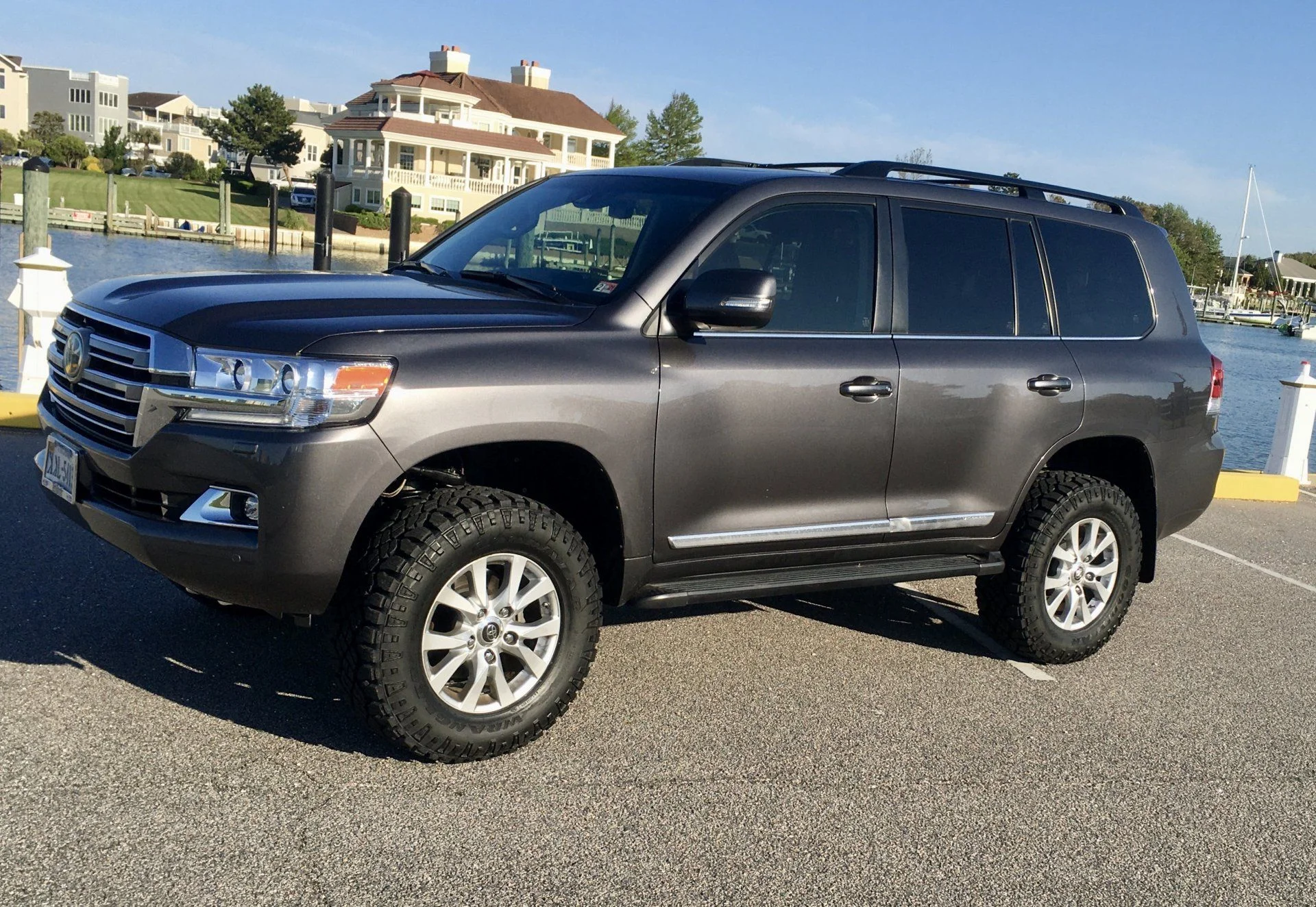

Thank you for your reply and opinion. I looked all week at stuff the while playing with a tire calculator, i put in a number i never put in before and sure as crap, the tire i desire showed up . I m gunna buy 5 tomorrow and they will be here the folling day
So my entire lift showed up today
Old Man EMU BP51
and SPC upper control arms. Install is tomorrow morning then alignment and
if theres still time in the day I will head to Discount tires for my new tires to be installed
wish me luck LOL
Looks well thought out. You do need those SPC UCA's with the 33+.
Is that an Albemarle? Looks similar to my Henriques.

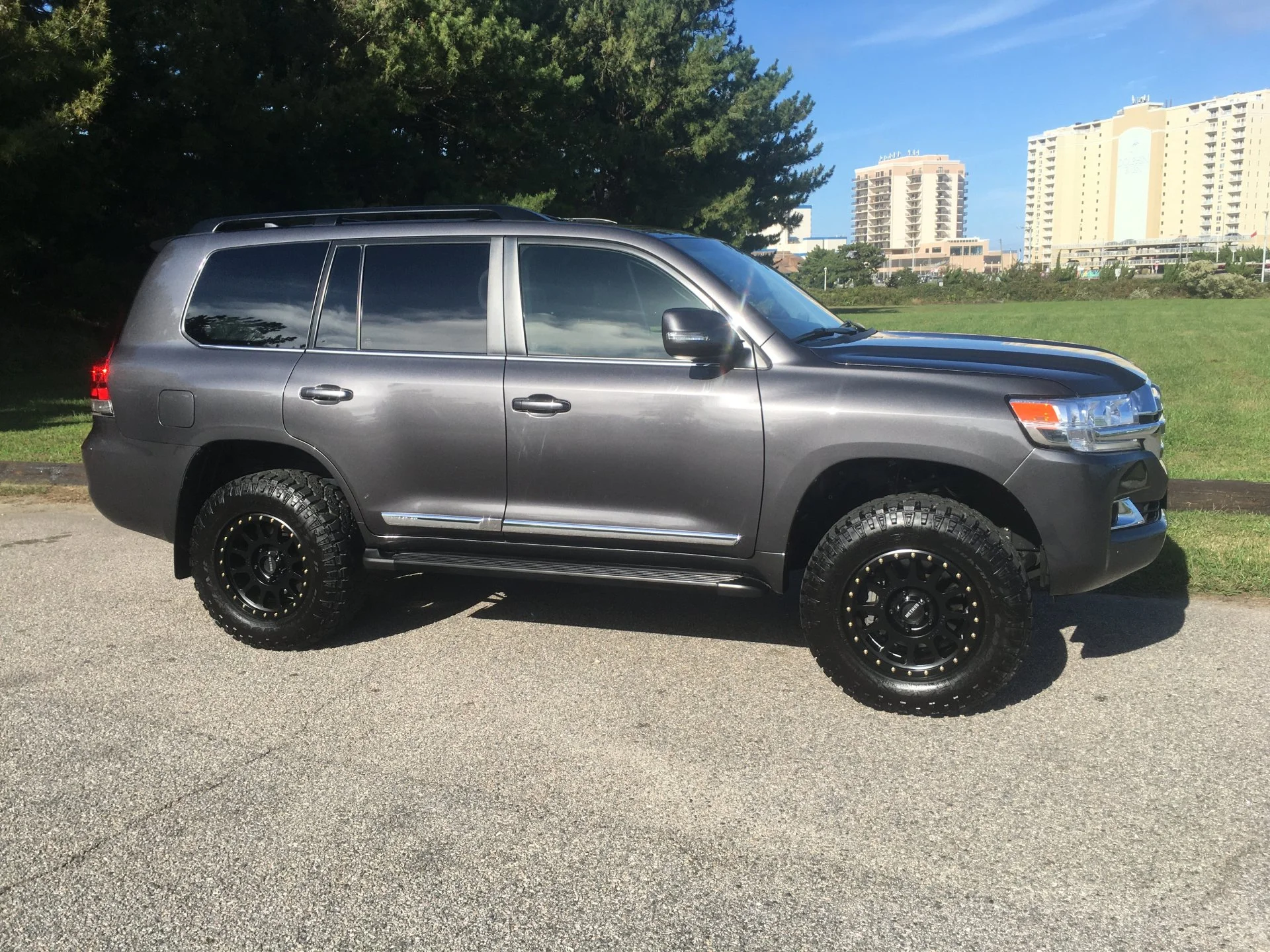

Old Man EMU BP51
wish me luck LOL

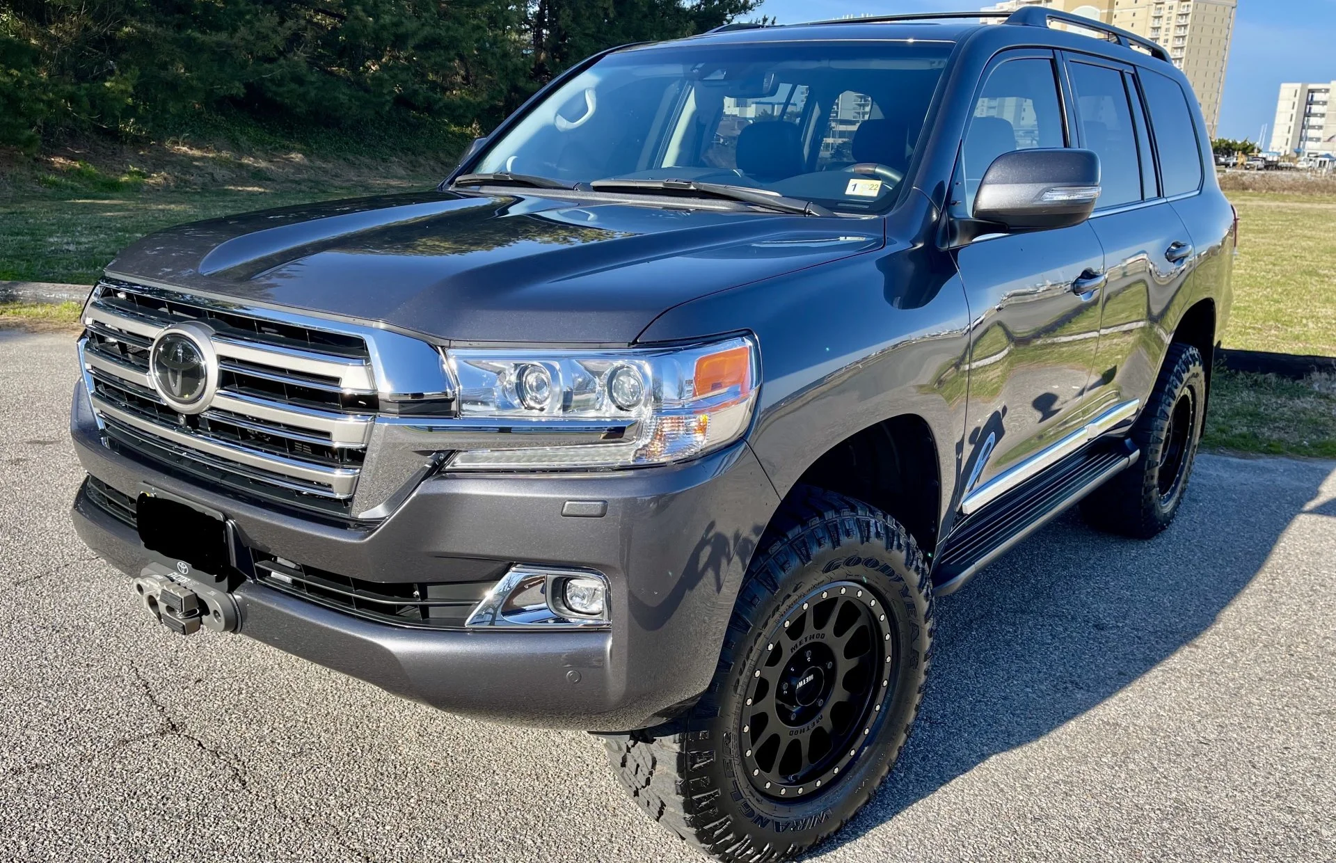

did you have to do anything with the panhard bar with this set up? I'm about to venture down this same path with my 18 as well, just doing different wheels then stock ones.
I did not. I have put 5000 miles on her now and ZERO issues, tire wear is spot on ! If I had to do it again, I would.
Has your lift settled at all? I’m about to do the same exact lift. Looking at your pics, it looks a touch higher than what I’m shooting for. How much preload do you have up front and how do you find the ride of the 2722? Thanks!
