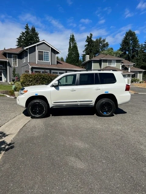

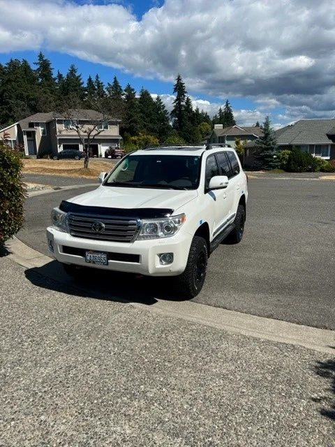

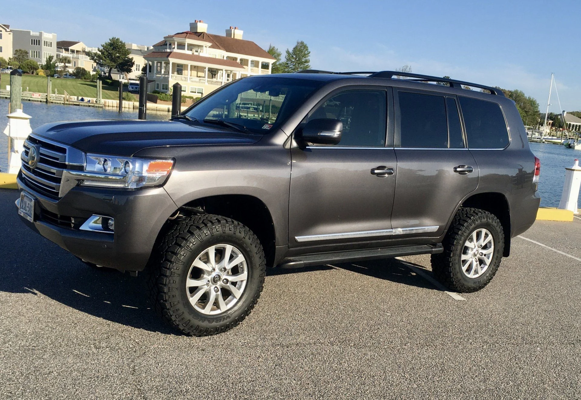

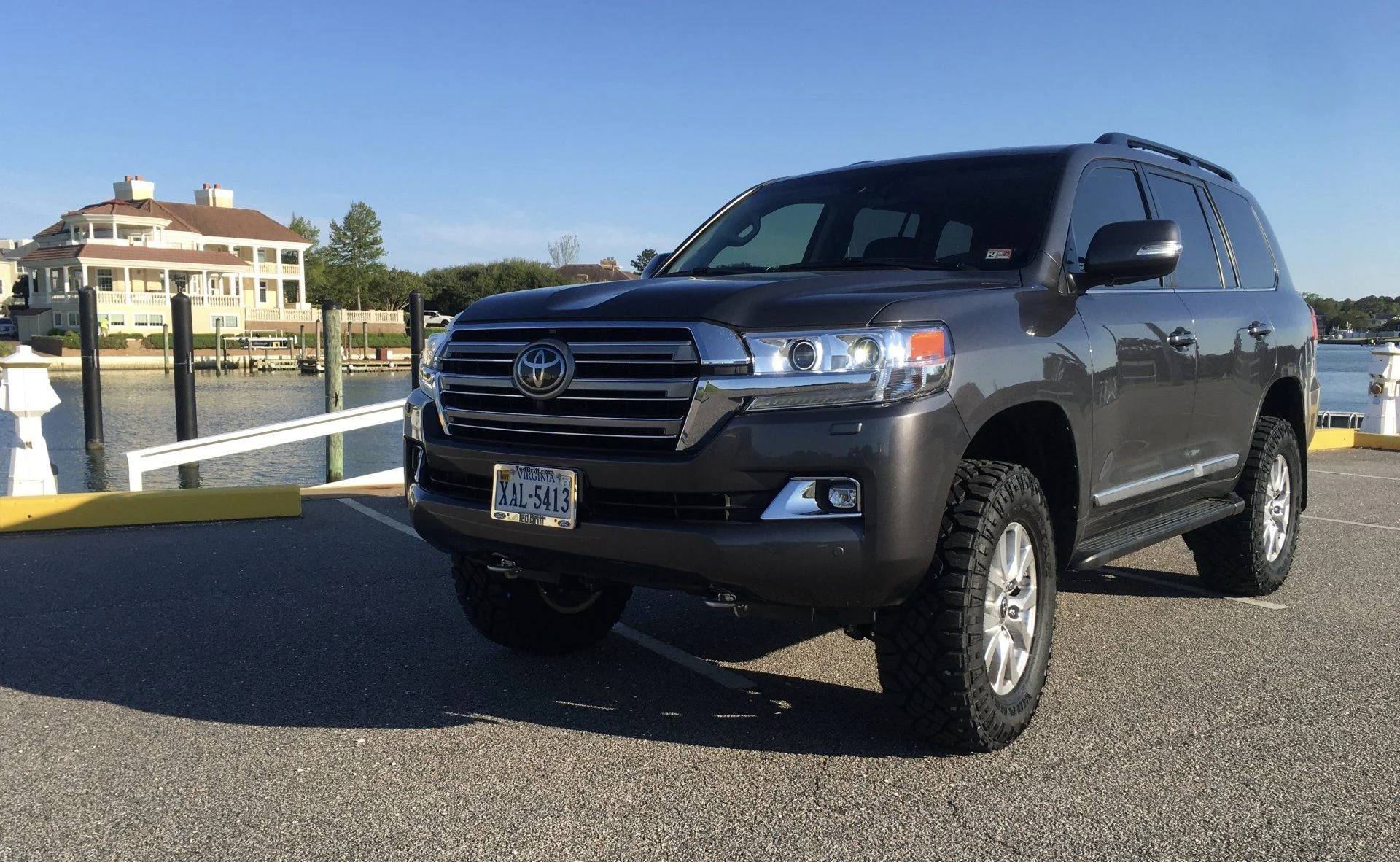

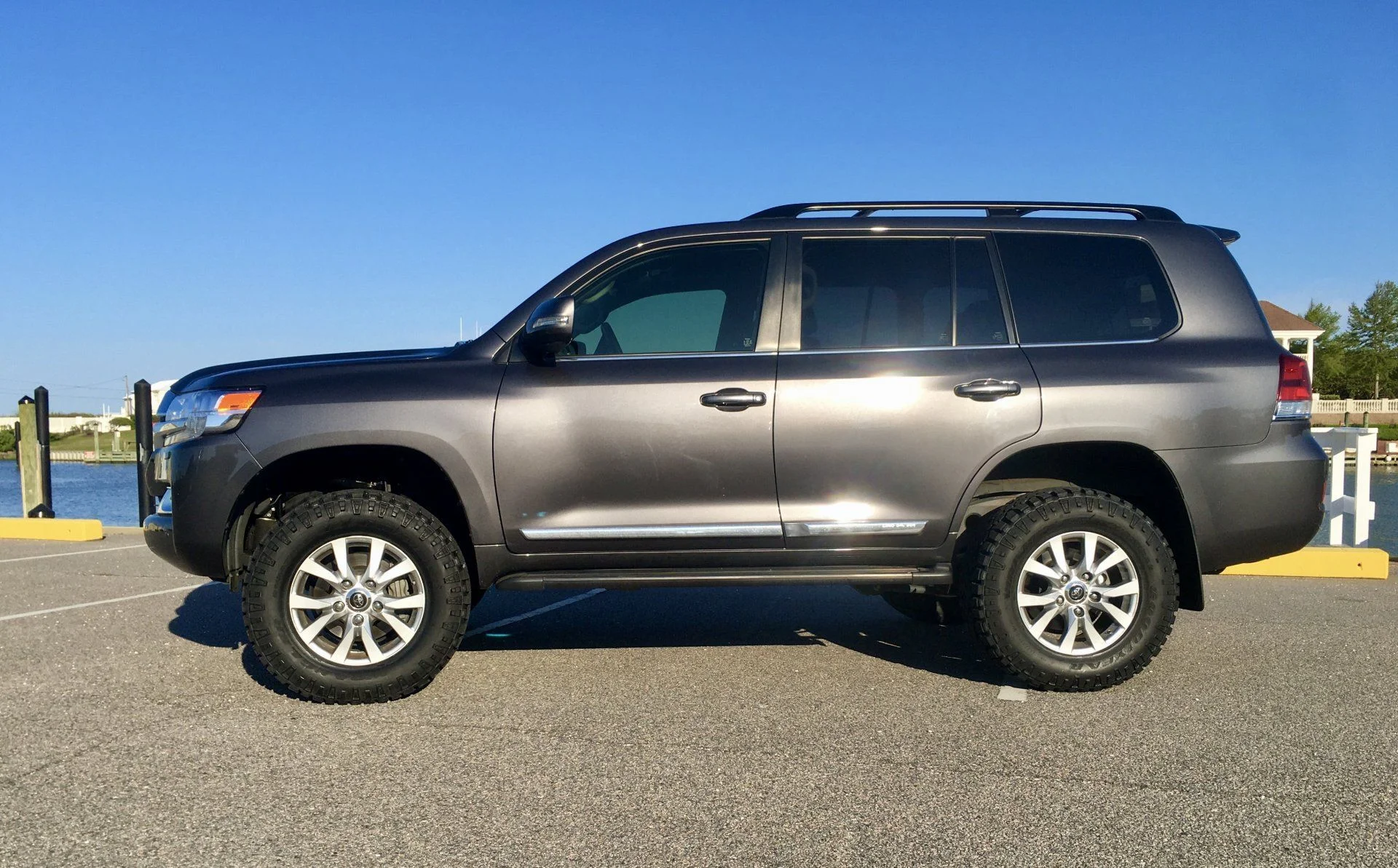

Install done. Wanted to add to the thread for others who may look to go this route. Again, went with 295/65/18s duratracs as well. Only did 1” spacers (bora). The BP51 install included new OME UCAs. Little rubbing on front flaps but heating them up and molding did the trick. Very happy with ride. Took decibel reading. Both at 35 and 70 only 2-2.5 db higher, but nothing noticeable other than a vey little hum from the more aggressive tread.
Drive over to Budbuilt in next few weeks to get step sliders installed.

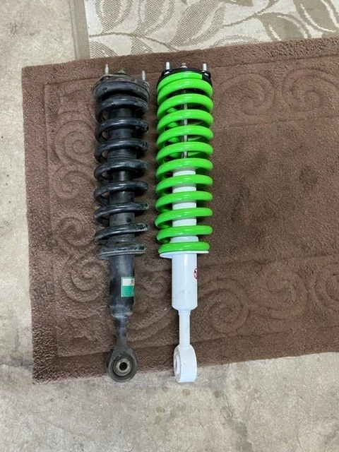

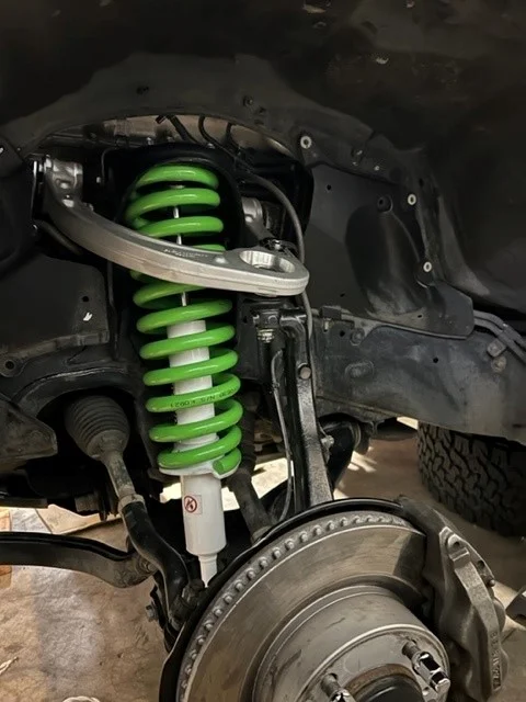

I immediately purchased Old man EMU BP51 with SPC UCA's and 2722 springs and 1.25 spidertrax wheel spacers because of the tires choices im thinking of.

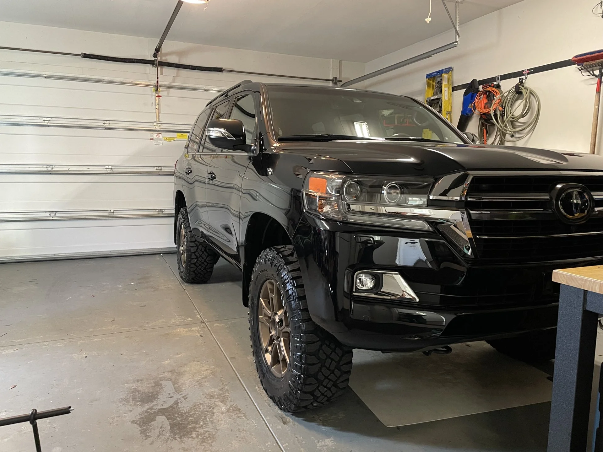

Thank you! I just did a Ironman 4x4 2" lift on my LC over the weekend, That's the measurement that I have after the lift with 285/60/18. Looking to get some new tires and I came across this threads, And your rig inspired me to get 295/65/18.
