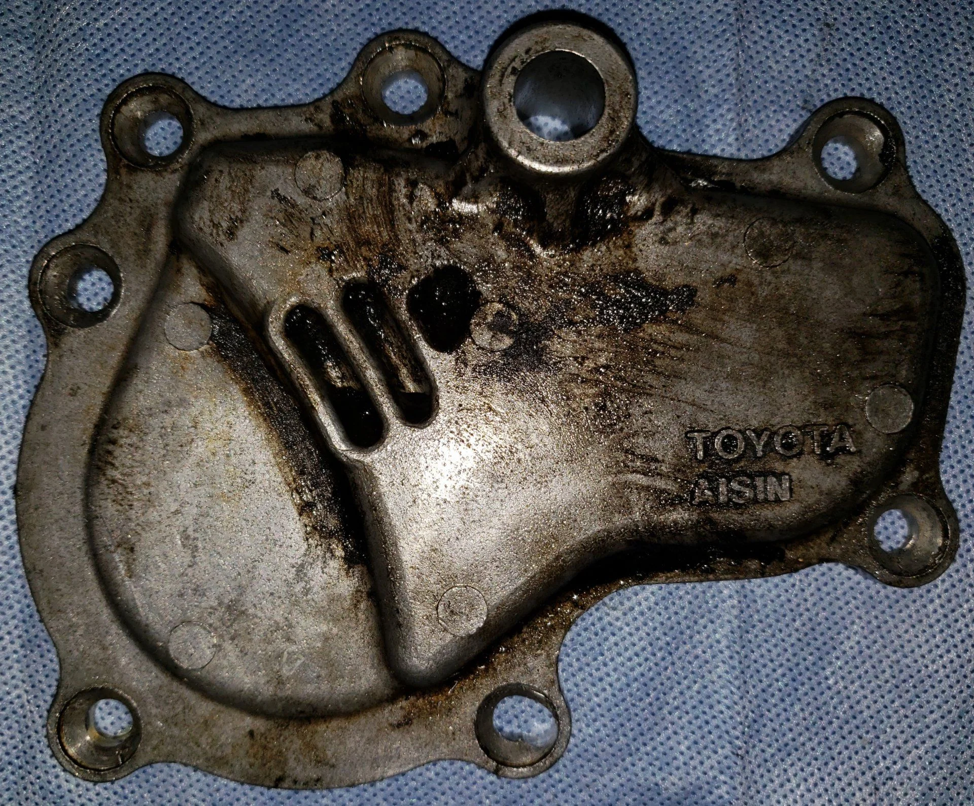

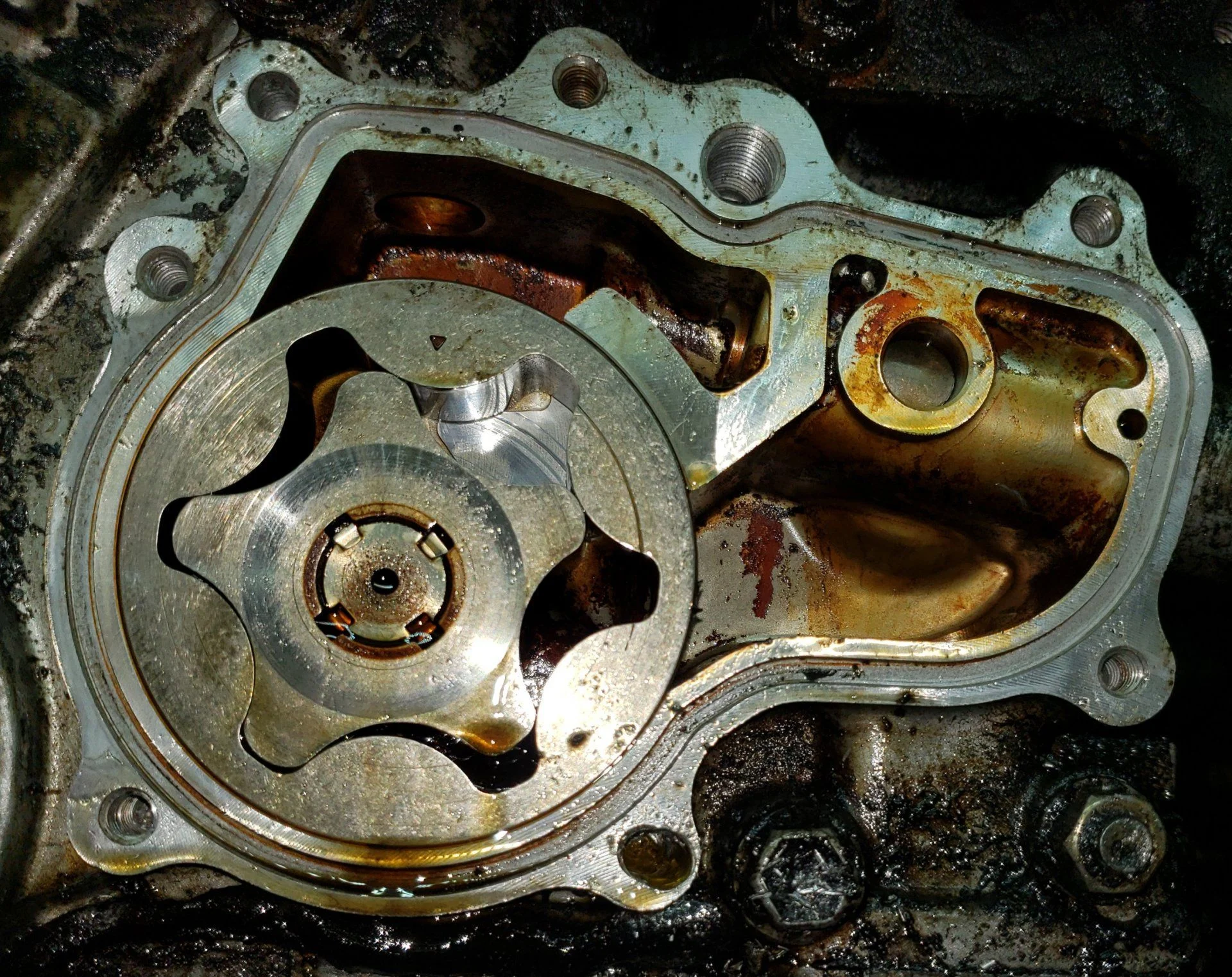

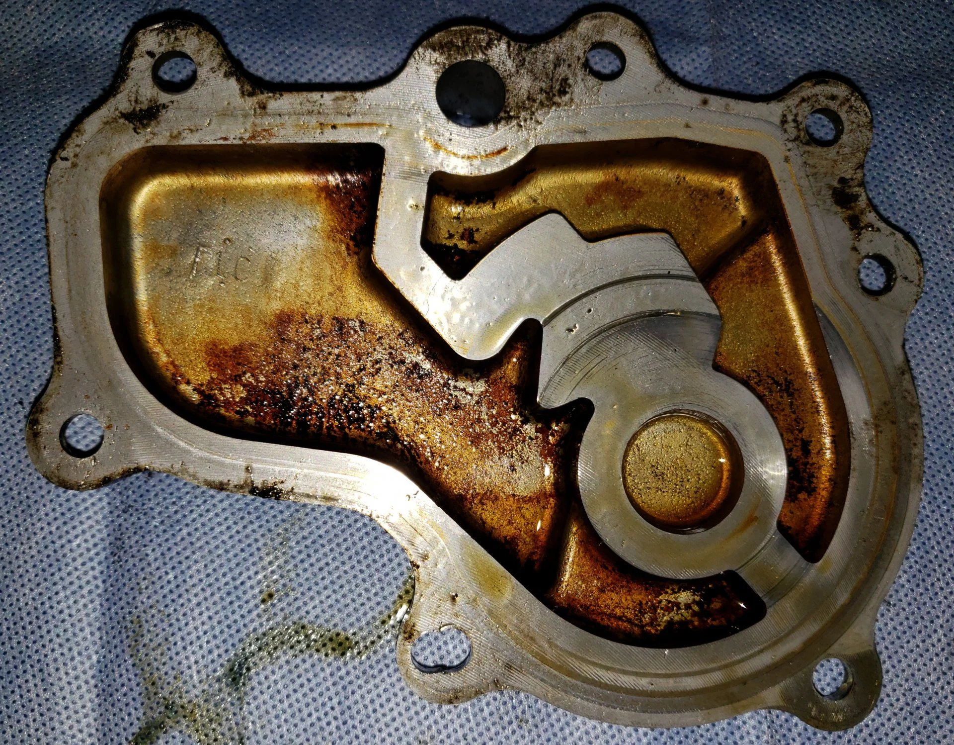

Any of you fellas ever been in this situation? I was drilling the head off a stripped screw and I ended up drilling straight thru the screw and stripping the bottom center screw hole on the oil pump & oil pump cover. My plan is to clean out the hole, fill it with JB Weld, redrill it, put the cover back on, then apply a bead of FIPG to the seam all the way around on the oil pump & oil pump cover, then call it good. Unless you guys have a better Macgyver trick up your sleeve.
I would just get a new one. The thrust surface for the pump drive gear is aluminum and wears out and lets the gear flop back and forth making a knocking noise, so you will be better off with a new one for $180 on Amazon.

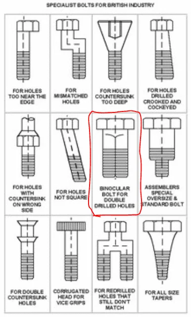

It would appear you need one of these.
And a pair of these: ;)

The offset holes are a real mother. Is that hole in a flange or in a solid portion? From the dirt showing in the hole it appears to be a flange.
It's part of the timing chain cover. The right fix is to replace the timing chain cover.

OP has two issues. Cover (because of what looks to be excessive wear in the thrust area) and partially drilled out threads. Replacing the cover solves the first issue. If it were me, to address the threads, I'd run a tap down the remaining/original threads insert the mounting screw with release agent on it, fill the void with JB Weld (or epoxy made for this) and then reassemble using minimal torque.
