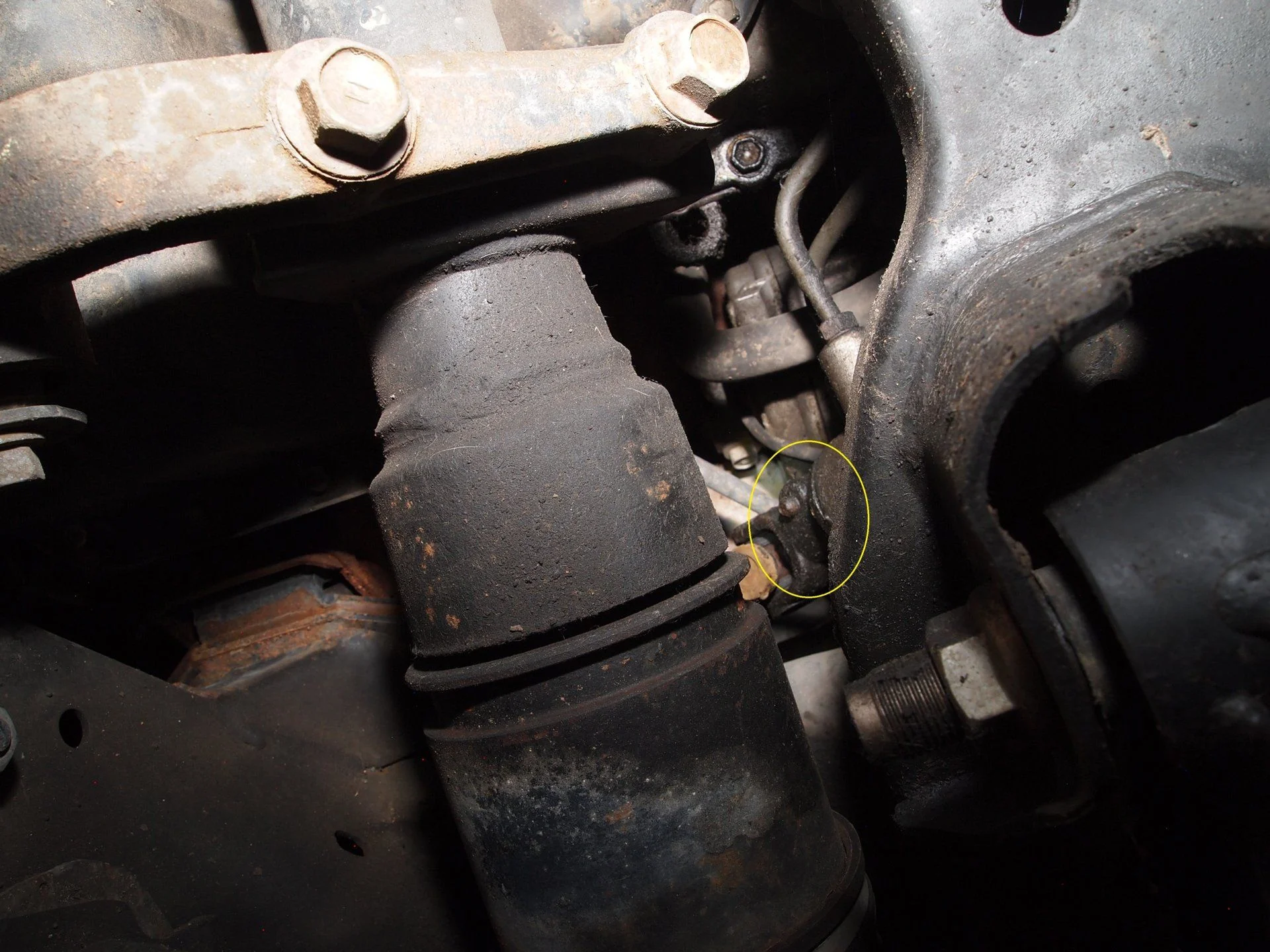

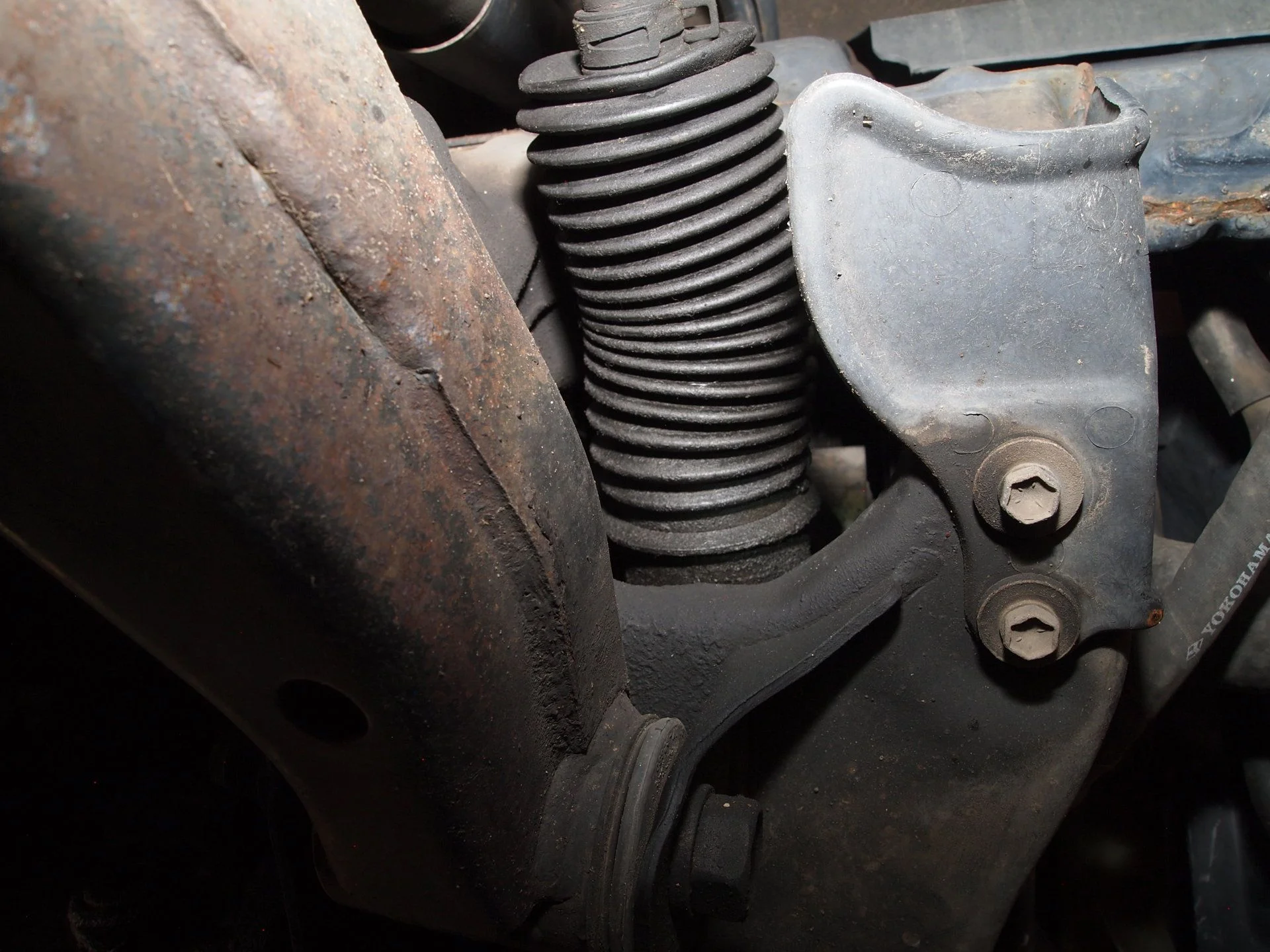

Pull your undershielding #1 (skid plate) and look up just in front of front differential side tube where front drive shaft (CV) butts in. You'll see steering wheel shaft u-joint just as it connect to steering rack box. It's common leak point. Also check rack boots, to see if filling with fluid. Flush and add ATP AT-205 reseal, you may get lucky. Steering Flush & Cleaning

If it looks like its coming from above oil filter area, it's probably leaking from the steering input shaft area. The steering rack in my 98 LX470 seeped from the boot areas for many years, and recently started dripping a bunch from the input shaft. I just replaced the rack with a factory unit, it was 20 years old, 180k miles. Not a hard repair, but will take a little bit of time if first time doing one.

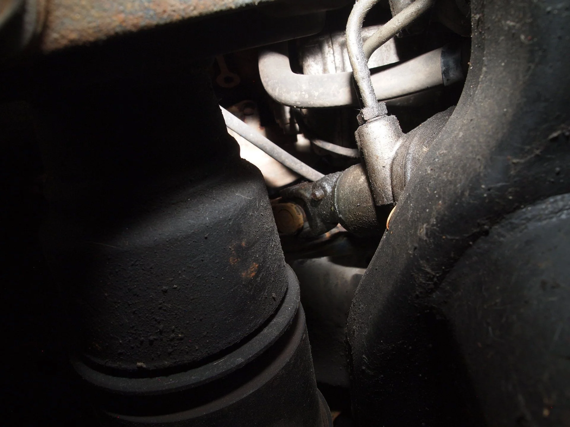

After a flush with Valvoline Maxlife ATF it is still leaking pretty good. I cleaned everything around the leak pretty good and waited to be sure exactly where its coming from Its just past the U joint where it connects to the Rack. I think its called the power steering control module. Attached is a photo.
I am wondering if there is a way to fix this, or should I replace the entire rack. Thanks for any help.

To repeat myself. I'd use AT-205 reseal. It's not a petroleum additive (I never use oil that say "HIGH Mileage" with those petroleum based seal additives), they swell and damages seals. AT-205 is the same stuff used to make rubber seals, that leaches out over the years. Many have added this Plasticizer (AT-205) with very good results when used a directed. If leak doesn't stop then you either rebuild the rack with a seal kit or replace the rack.
BTW: The rack I pictured above has over 350K miles on it, and as you can see, it is leaking. I cleaned outside leak area and added AT-205. I've only driven ~3 hours so far, but leak seems to have stopped.
I will flush system again to make sure all dirt is out and then add the AT-205. Thanks for all the help.
It takes longer than a day to swell the seals back up with the MaxLife or any seal conditioner I have ever used.
2001LC and everyone else. THANK YOU!!!! no more leak after using AT-205. Only took a few hours to take effect.

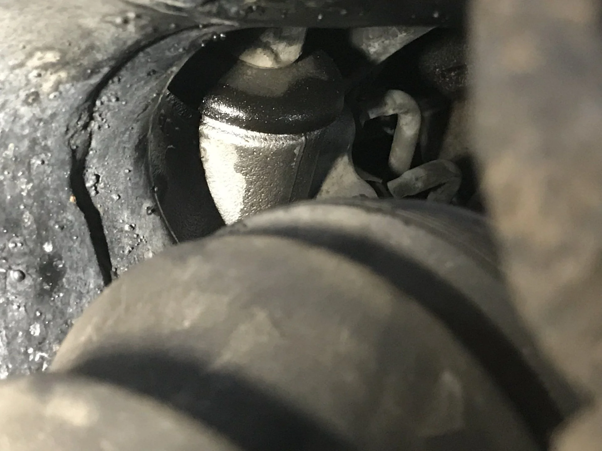

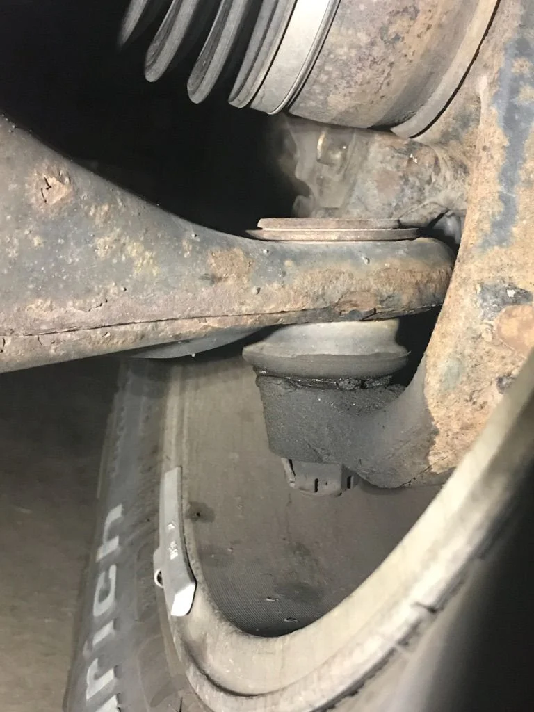

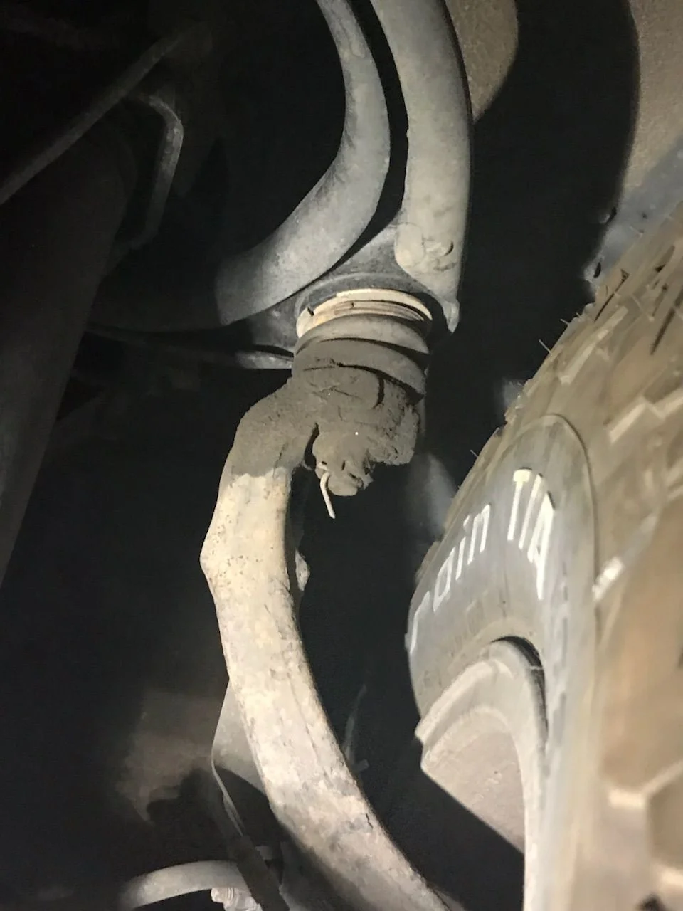

TRE ball joints look pretty good. Lower Ball on the drivers looks like it may have issues. See photo below.
Yes, the steering wonders left and right while on freeway. Seems to be getting worse. I feel like I'm driving a 1972 dodge pickup having to steer left and right just to go straight.
Doubt its alignment because it wanders both ways.
Let me know what you think of the joints. Cruiser has 196k miles on it and its all original accept Shocks. I replaced those a year and a half ago with stock.

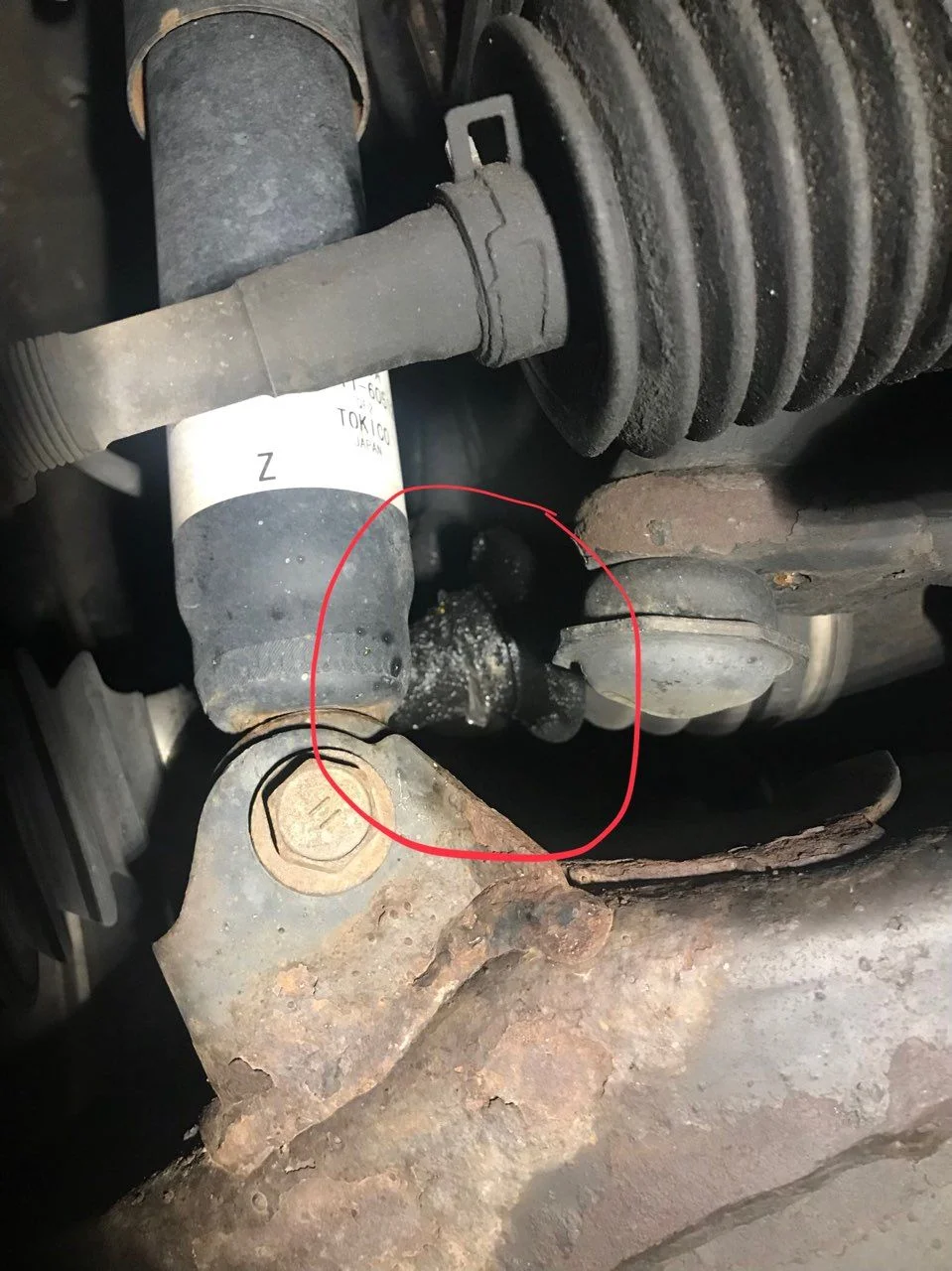

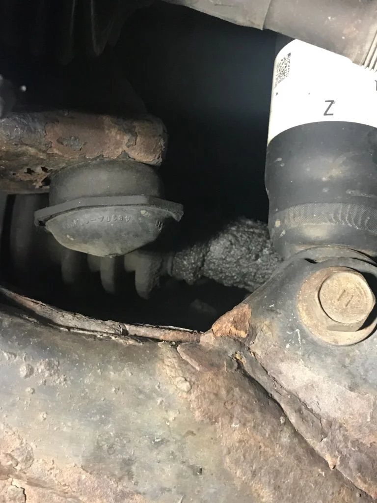

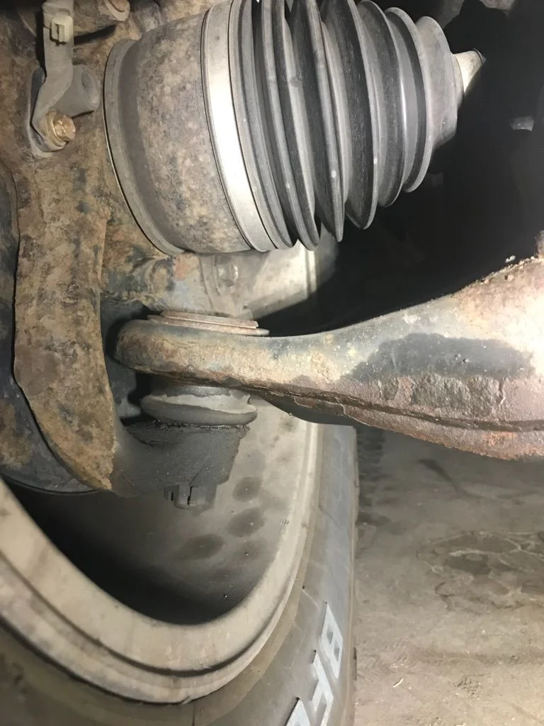

I also noticed leaking on the axles. Check out pics. One that is the worst I circled in red.
Thanks again for all the help.
