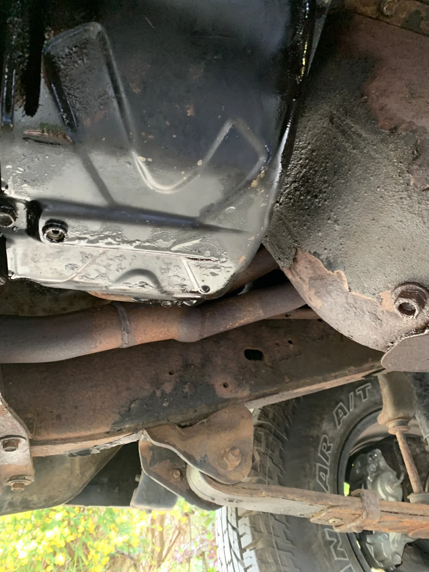

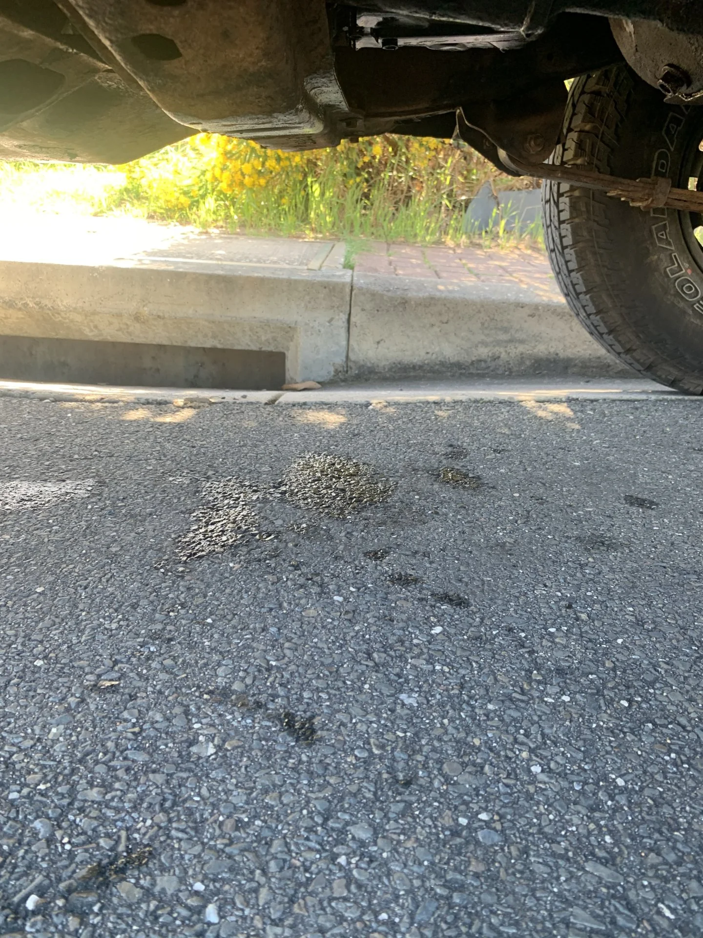

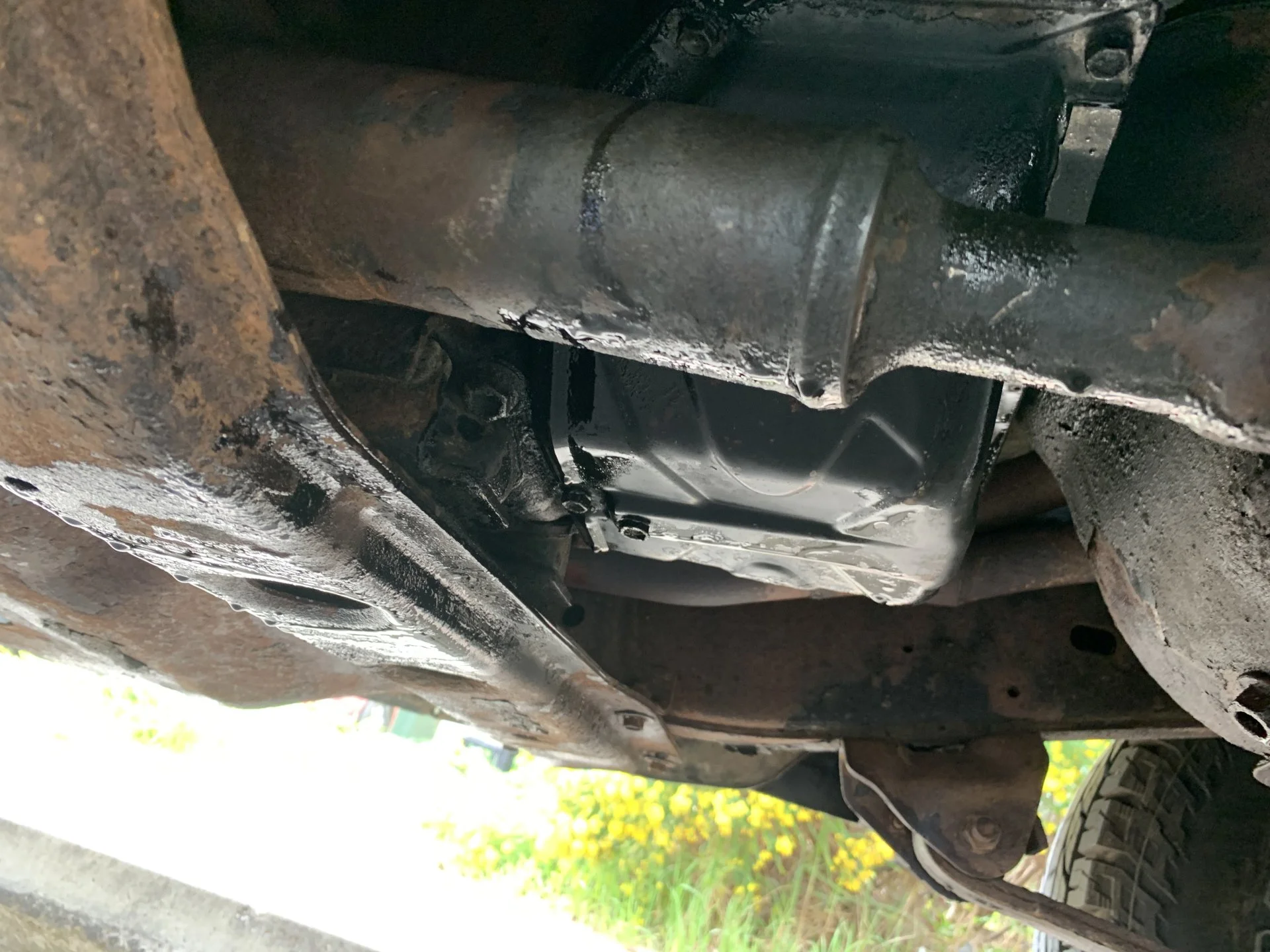

Hi everyone I am new to this forum so I hope I have posted in the right spot!
I have just had a brand new clutch put in and a rear main seal replacement. After driving for 1-2 days I have noticed oil leaking down from these areas ( see photos). As someone that regularly checks for leaks, this was not leaking prior to getting my clutch done. Oil level from dipstick has appeared to not have changed but I’m really not happy to find this after spending so much money.
Would really appreciate any advice/ suggestions for the cause
Background: FJ62 1985, done 180,000kms original motor.
Thanks! Jack

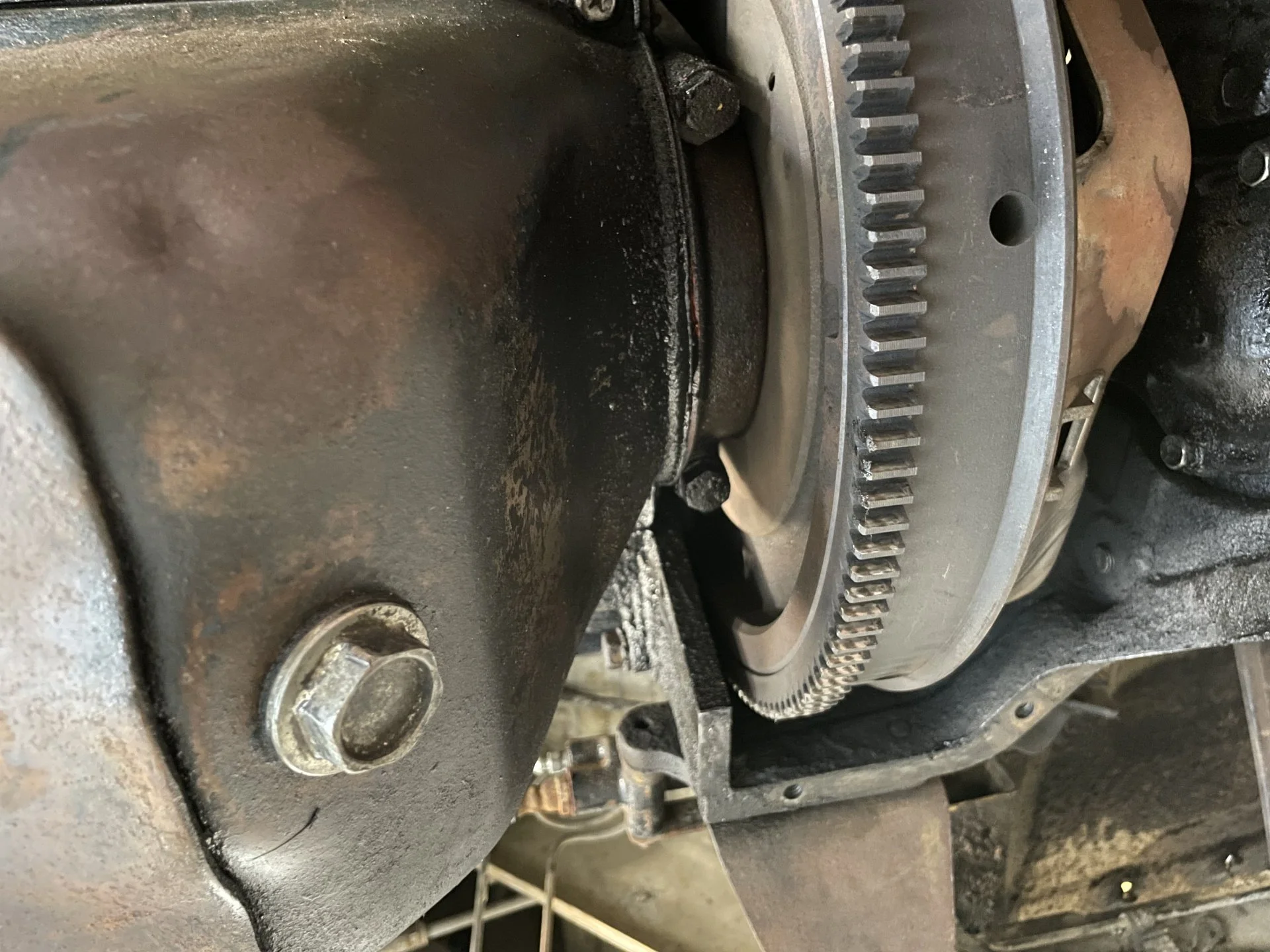

Easy DIY to pull that cover and see if you can tell what’s leaking. RMS seal leaks tend to be on the flywheel and radiate out toward the edges. Oil pan arch seal usually won’t do that.
Either way sounds like your mechanic will be getting a come-back…
Here’s mine, RMS was fine, oil pan arch seal was toast.

Have you determined yet whether it is gear or motor oil on the ground yet? Rear main leaks just put oil on the ground, input seals put oil on the clutch friction disc...they do not like to be "oil cooled".
This ^^^, if you want to find out for yourself. Since you are already into this with your own hard earned money, I wouldn't bother and would just let the mechanic who worked on it sort it out. Play whatever "I'll stand by my work" card exists and get this figured out with minimal effort. It doesn't really matter if there was a leak before. There is now and the only thing that has happened between when it didn't leak and when it did was the mechanic touching your truck. Issue is there so hold them accountable.
No offense to mechanics, but none of them love your cruiser like you love your cruiser. GL and HTH.
