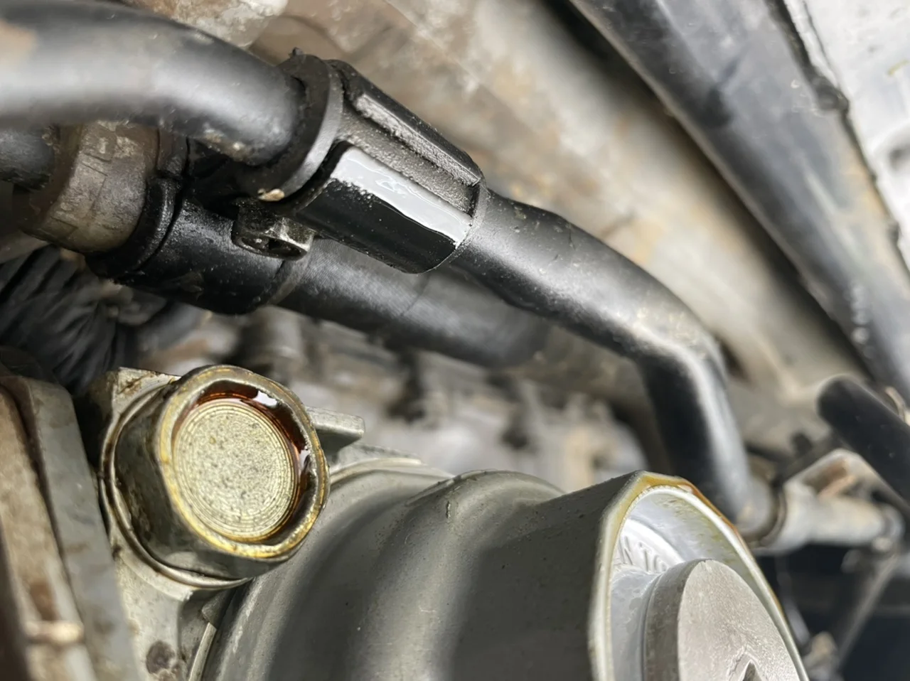

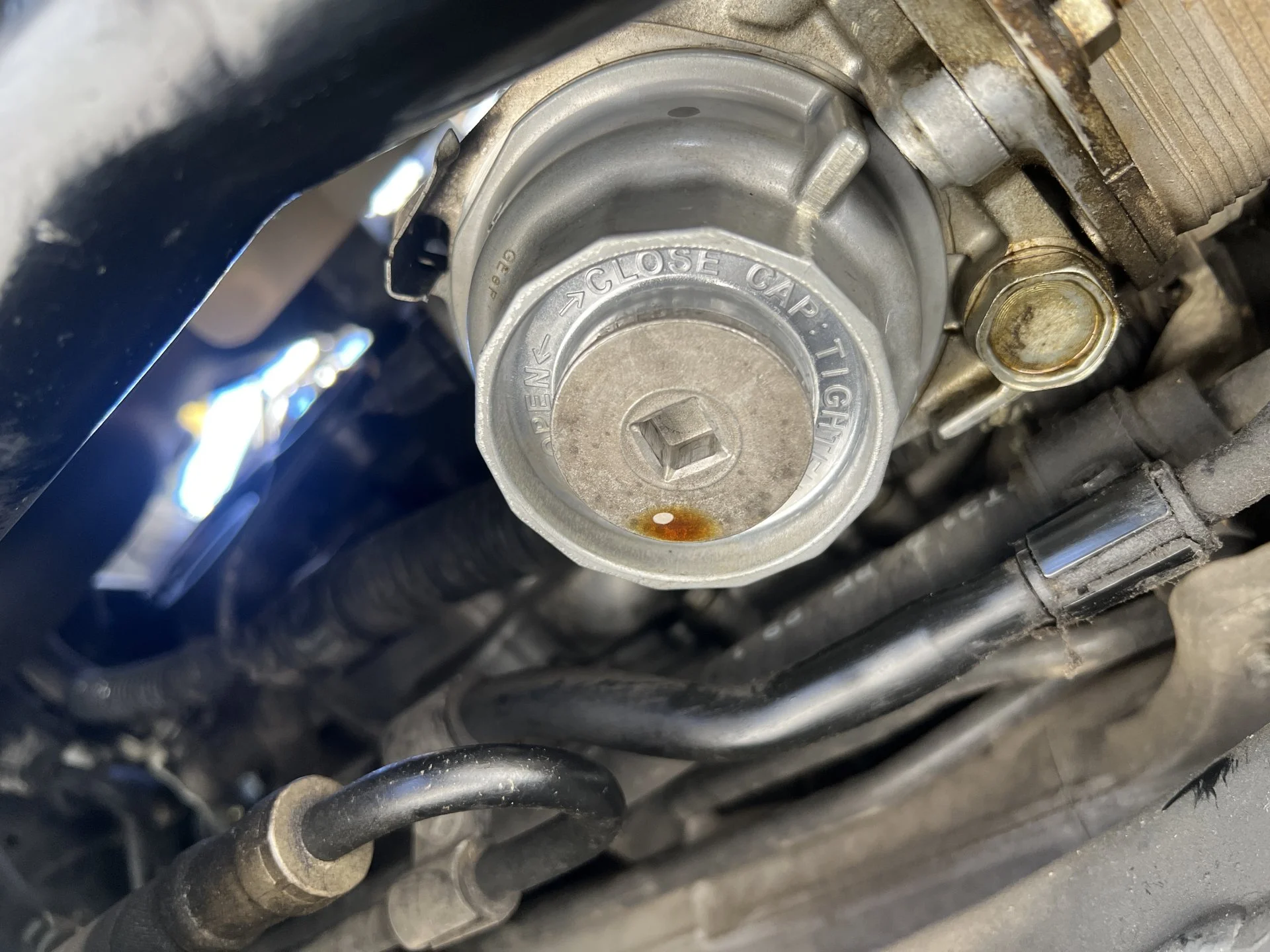

I changed the oil in my '13 LC a few days ago, and I swapped out the plastic housing cap with the metal one (15620-31060). I torqued the oil housing to 18lbs. I don't know how tight the plug is, but it seems tight. Now, I'm getting a slow leak. What did I do wrong??
Thanks!

Edit: the location of your drip looks like it may just be the small o-ring. I'd just try replacing it first. The first time I installed the metal housing, I just tried again replacing the the o-rings. The only thing I know I did different the second time was submerging the o-rings in a pool of oil.

I'm SUCH a moron. This is the first time doing the oil change, and I wrongly put the small o ring on the INSIDE of the housing at the base. I then put the filter on top of the o ring.
I had another small o ring on hand, so I removed the oil filter plug, put the o ring in the right spot, and then screwed the plug back in. It looks like that solved the problem. Is it ok that the small o ring is still inside the housing??

Well... probably not OK. I can only imagine that the presence of the small O-ring at the base of the perforated tube will allow oil to bypass the filter - certainly not ideal.
I would recommend chalking it up to a lesson learned and remove the filter housing and get that small O-ring out of there. This will also allow you to put that small O-ring where it belongs inside the bottom plug.
Anyway... glad you figured it out.
