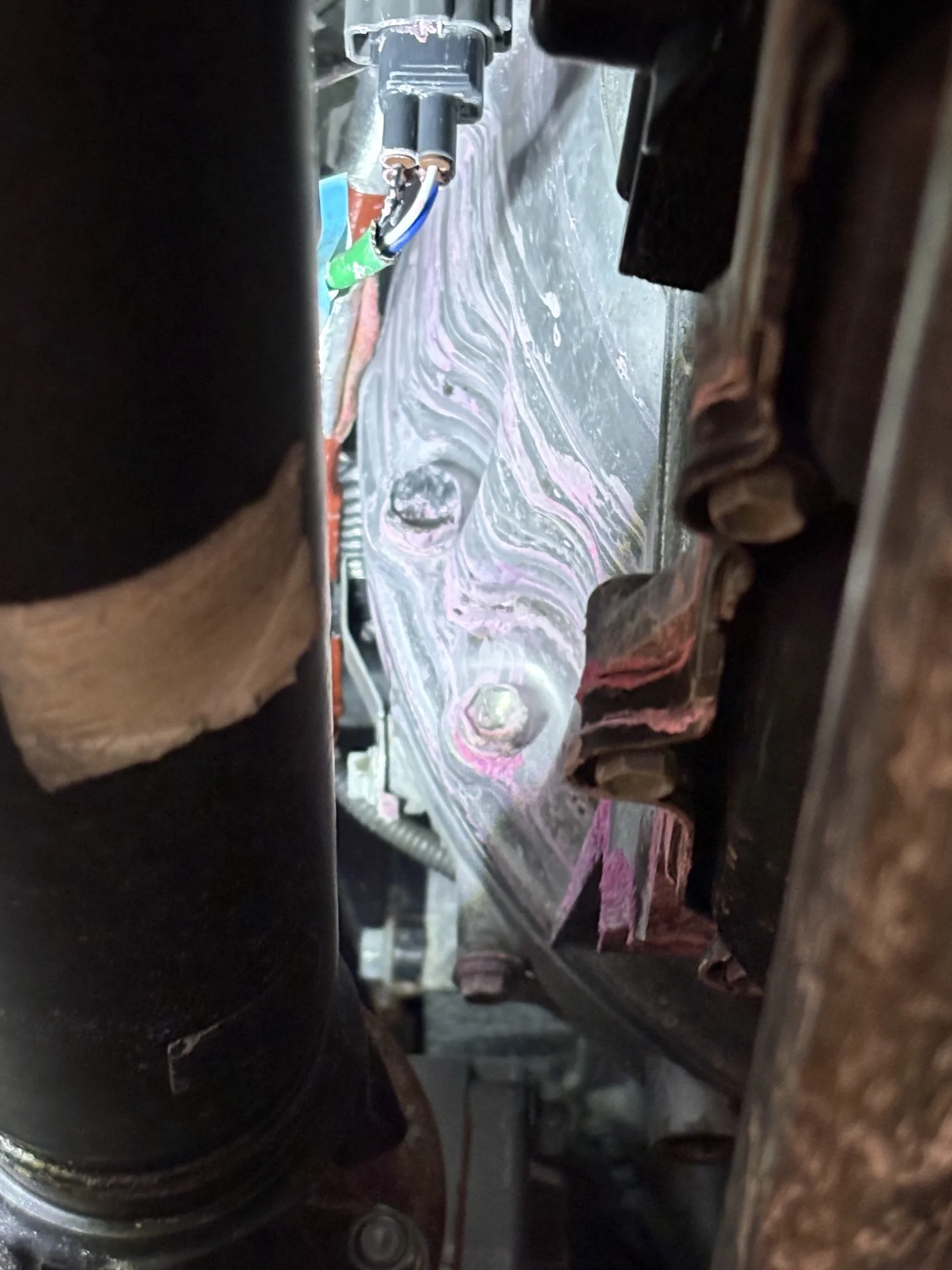

Took it in for suspension work today and they informed me of a coolant leak. Had not anything going on when I did an oil change a month back…although I wasn’t looking for problems.
Haven’t noticed anything dripping on the ground. I did notice the coolant was low a month back though, but a top off seemed to keep the level fine. 2021 with not even 30k miles yet.

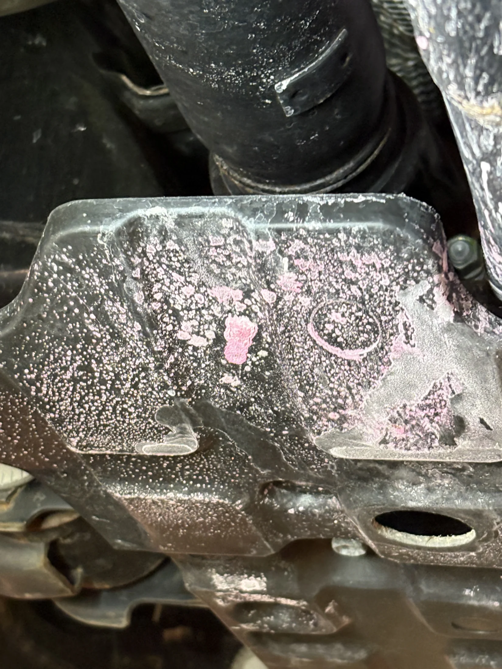

Pics from the mechanic.
Valley plate this soon?!?

Sheesh…..for sure not a lucky day. If it’s the valley plate leak, it will be powertrain warranty work at that age and miles.

seems like a lot of splatter for the valley plate, especially on the underside of the skid plate. I’d look for a cooling line (or heater hose) that was damaged

Well they certainly repaired the valley plate according to the invoice. $1305. They cleaned it all up and I can’t see anything now. I’m trying to get them to cover it on the power train warranty. Astounded this happened at 27k miles on a 4 yo truck. I’m assuming this is a mfg issue rather than the gasket being eaten away. But maybe time mattered.
