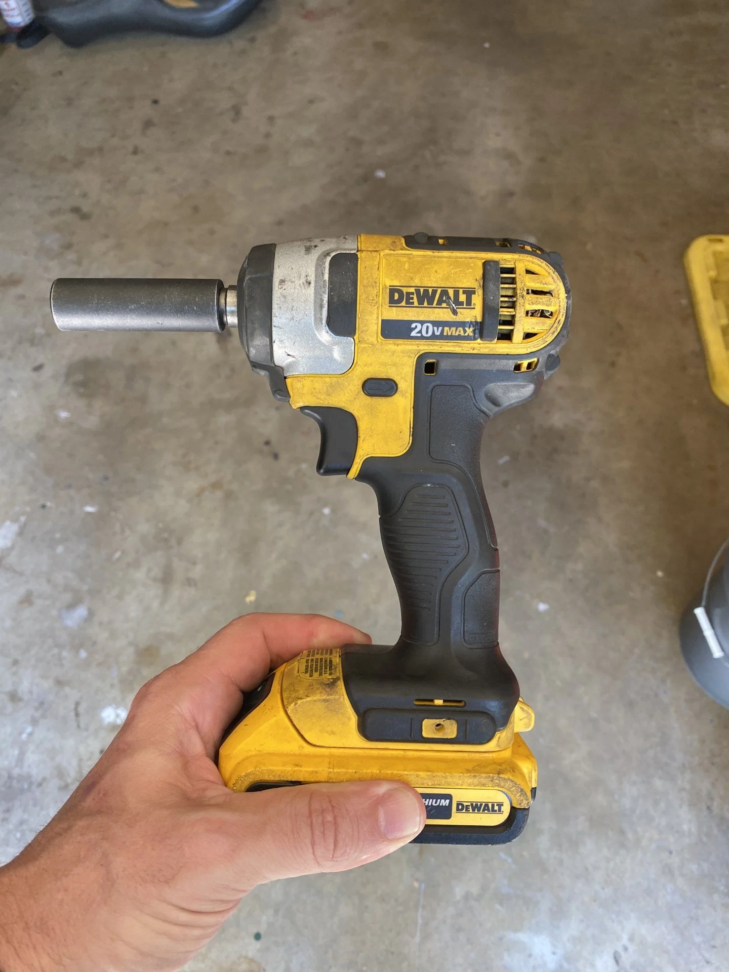

And as for skid plate bolts.. literally the most game-changing tool I’ve ever bought:
