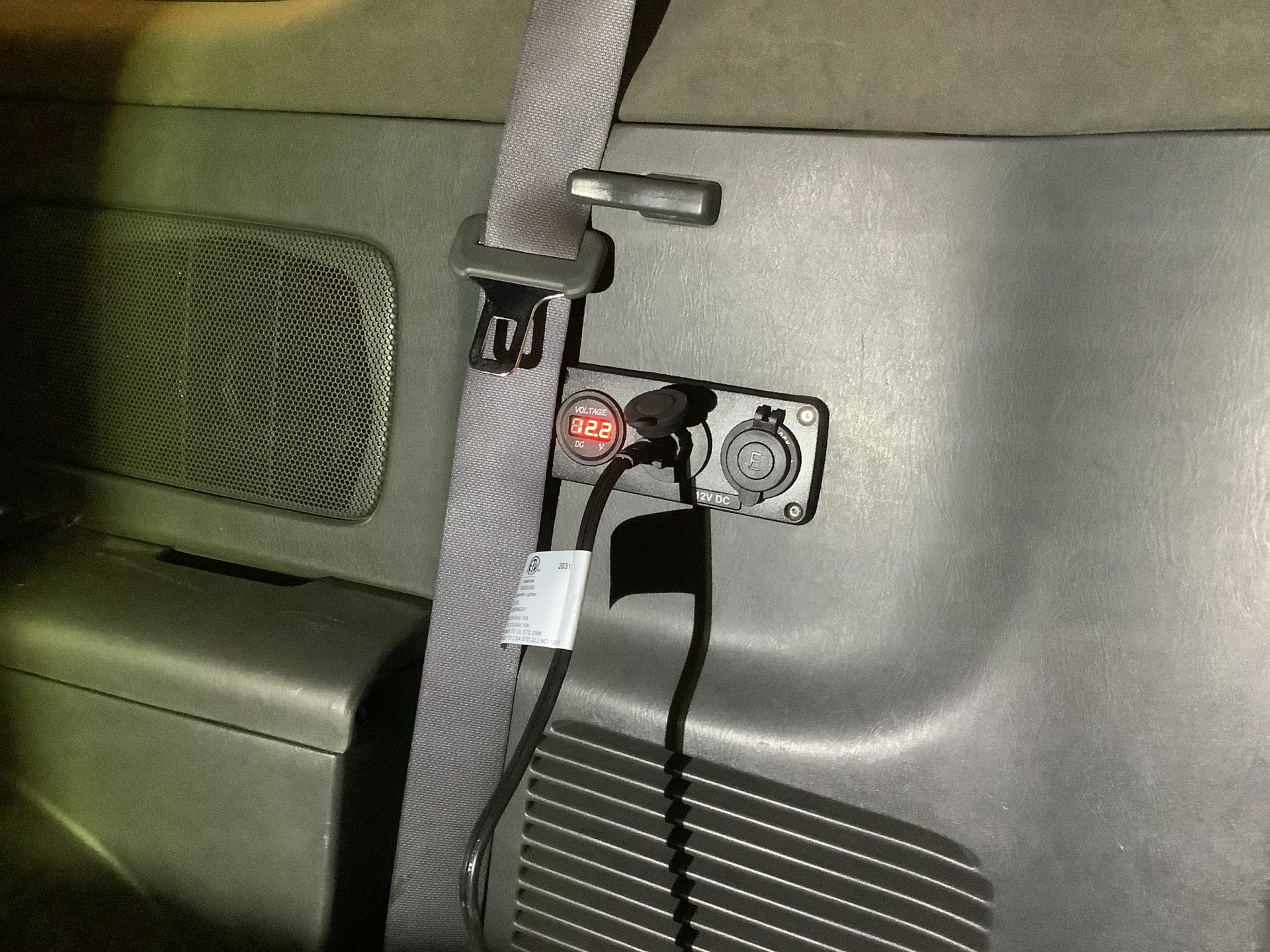

What did you use for a dedicated 12V port? Something already in place or from scratch?
Considering a similar approach as you, but would need a from scratch power supply with nothing currently in place in the 80.
Do you charge the Jackery from the truck while driving or only solar?
Why not go for the single 500? No option to charge up?
-I wired in a Blue Seas 12v port, fused off the engine start battery. It has a 12v cigarette-style port that I swapped out for the ARB 12v receptacle. Very easy and sturdy (ie it wont vibrate loose). It also has a USB port and volt meter.
-I can charge the Jackery from the truck, and can even use it as a “pass through”, where it simultaneously receives a charge and delivers power, but I try have them both charged fully (using house AC) before I leave on a trip.
-I decided I liked the redundancy and utility of 2 smaller charging stations. I can use one for other purposes elsewhere at camp, or loan one out, while still having power to my fridge. I like the portability also…in an ice storm last year, I set up a sister with one while we used the other. Packing is easy, as they’re quite small and fit in nooks well. And, at least when I bought them, they were the least expensive as far as $ per watt.

Something like a 10 AWG direct from battery to the cargo area? I see some Blue Sea panels include a 15A breaker, too.
Exactly.
Give some thought to which side of the cargo area you want to mount everything…for me, my fridge lives on the Passenger side, because the inputs and LED screen are then facing me and the lid opens to the outside of the truck.
So the Blue Seas port is also on the P side.

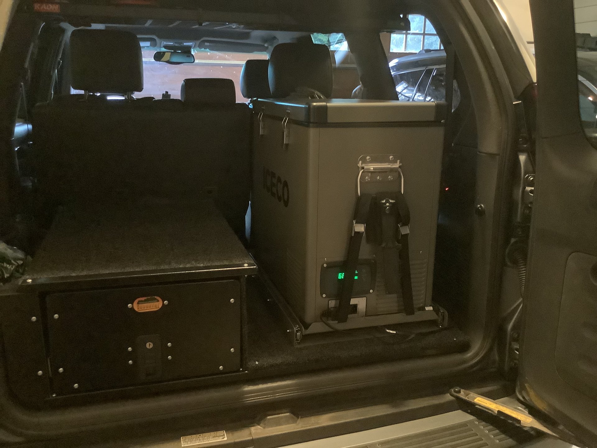

Looks clean! I also have the Rugged Bound drawers.
What have you done for cable management? Anything in place to facilitate the slide action? I'd hate for a cable to get caught.
Re: Rugged Bound, I’m very happy with them. Price and quality are both very good. The best part of the whole experience though was working with Theo…he takes customer service to a new level!
As for cable management, I just (try to) make sure I’m not pinching or snagging as I pull the tray out, or push back in.
If you find a nice solution, please post!

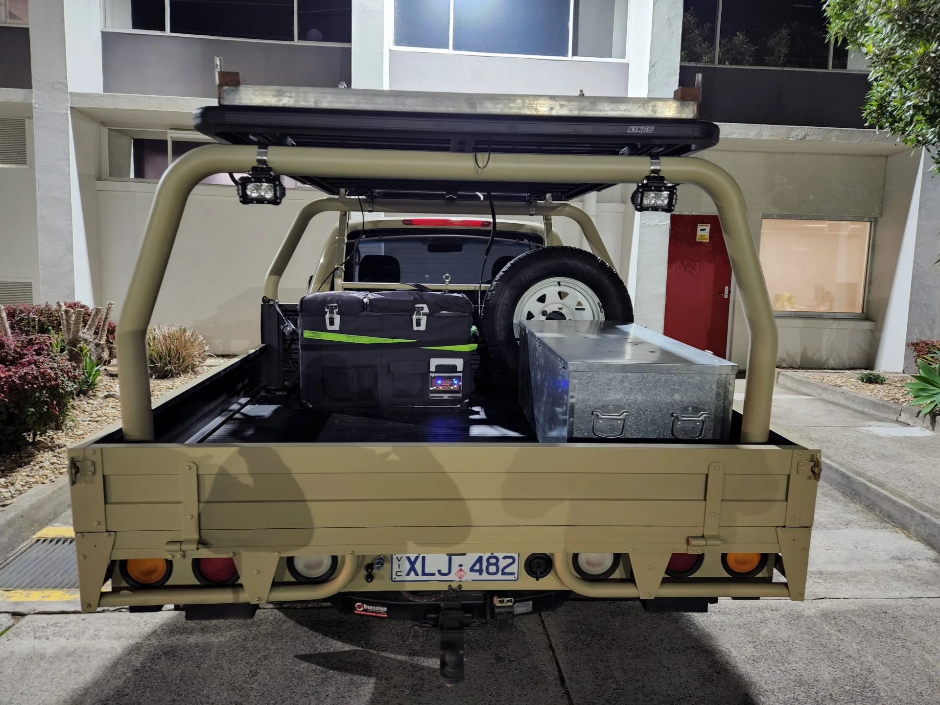

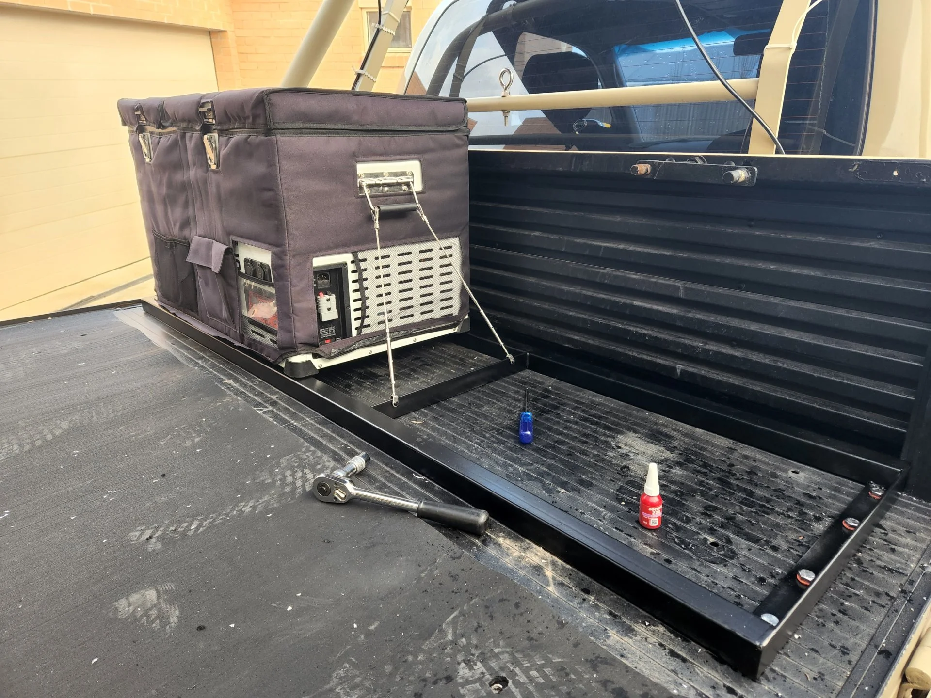

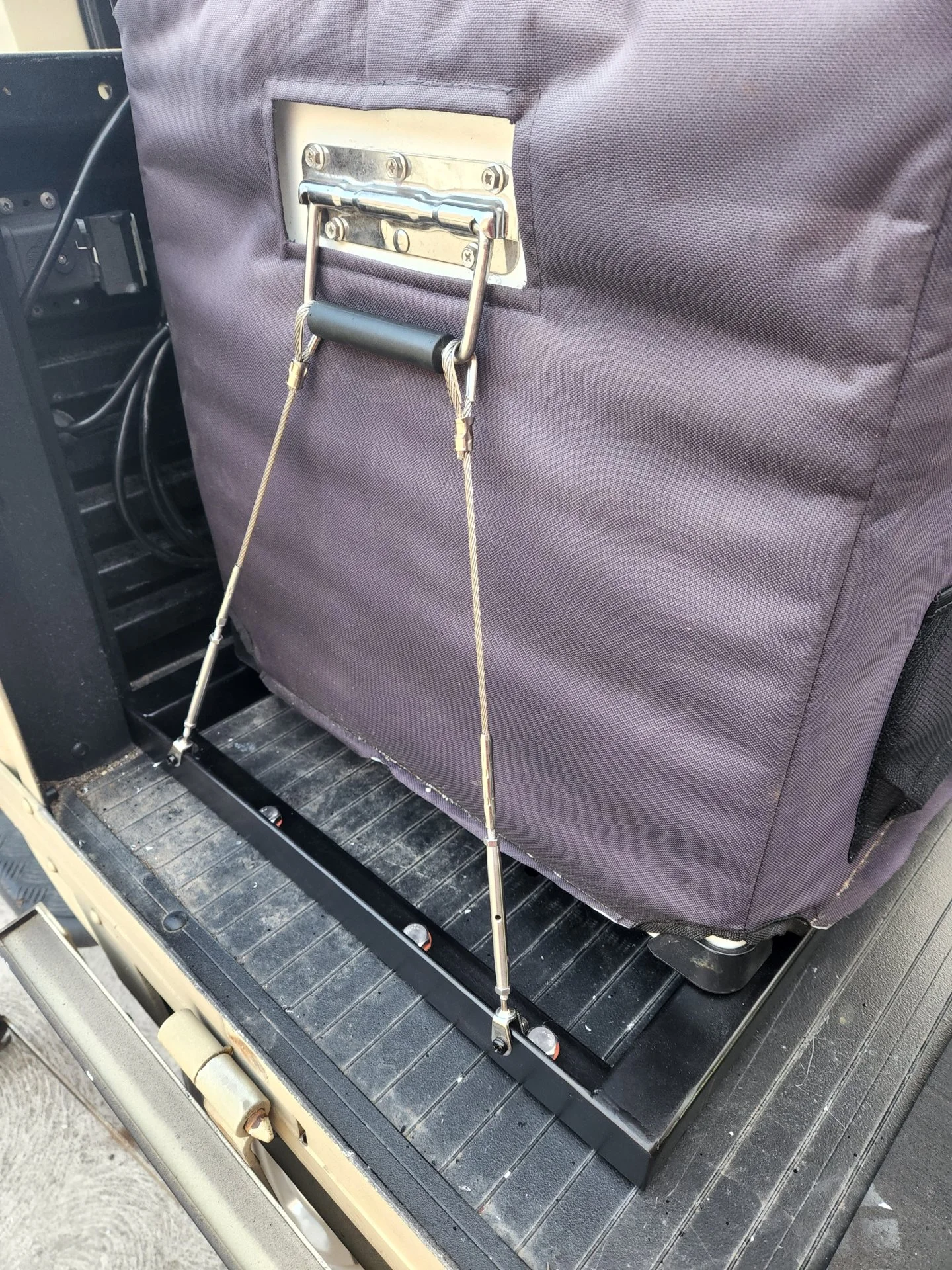

After reading this thread I got motivated to finally mount my fridge properly. Built a mounting frame to sit the fridge on that gets it out of any water that puddles in the tray.
Taking a but of a punt and chose to bolt the frame down using 11xM10 nutserts into the aluminium tray. Normally I would use a backing plate because I'm not convinced the ally tray is thick enough to bolt in to, but I was too lazy to pull off the wheels and mudguards just to mount backing plates. So I'm hoping 11 (one of the bolts didnt line up and I CBF taking it all off to re drill it!) will be enough to distribute all of the forces. Only time will tell.
Then to made up stainless wire rope tethers to tie it back down onto the frame. This allows me to get a nice snug hold of the fridge, and some adjustability to position the fridge to one side.
Its all locktite down, and tightened with tools. I figure if someone really wants to steal it they could, but my defence philosophy is just make it a little bit hard and most people will leave it alone. I just want to prevent oppotunistic thieves.
I might do something funky with the spare wheel side, and mount the spare in a cradle. I haven't decided about that yet.

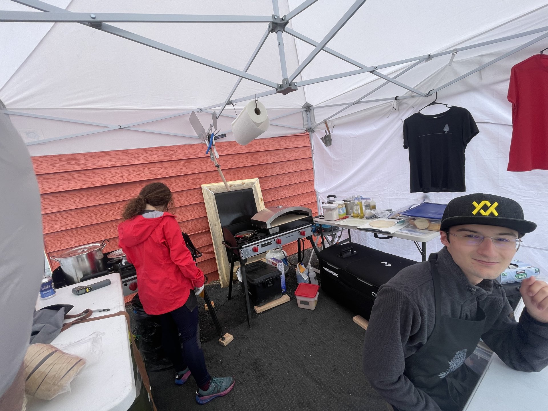

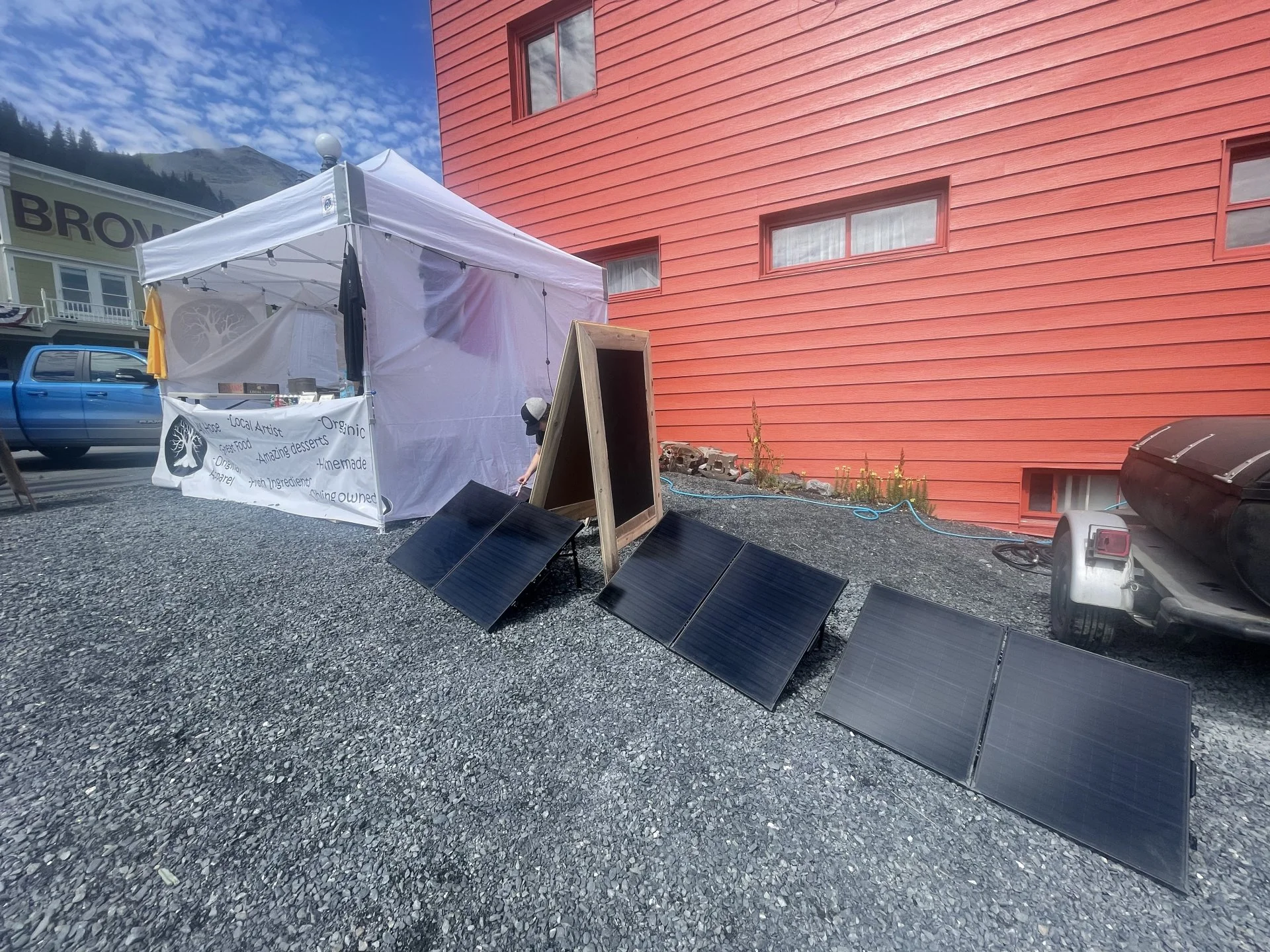

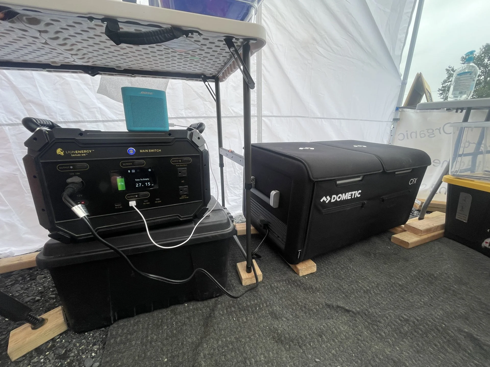

My teens started a business using our base camp set up as a starting point (and my 200). It is a “food truck” and art operating out of an eze-up. Dometic CFX3 95L DZ, 300 w of 24v solar, 1kwh battery w/ 3k inverter, on demand hot water, 4 burners, pizza over,…
I’ve had the fridge for 3 years, used it hard, now in a commercial capacity. Can run it for ~2-3 days with no solar on duel fridge mode. With solar even on an overcast day can make enough to run the fridge and not touch the battery. Under full sun can run the fridge and fully recharge the battery in ~3-4 hrs. Had a smaller ARB fridge before this and the Dometic is rock solid.
