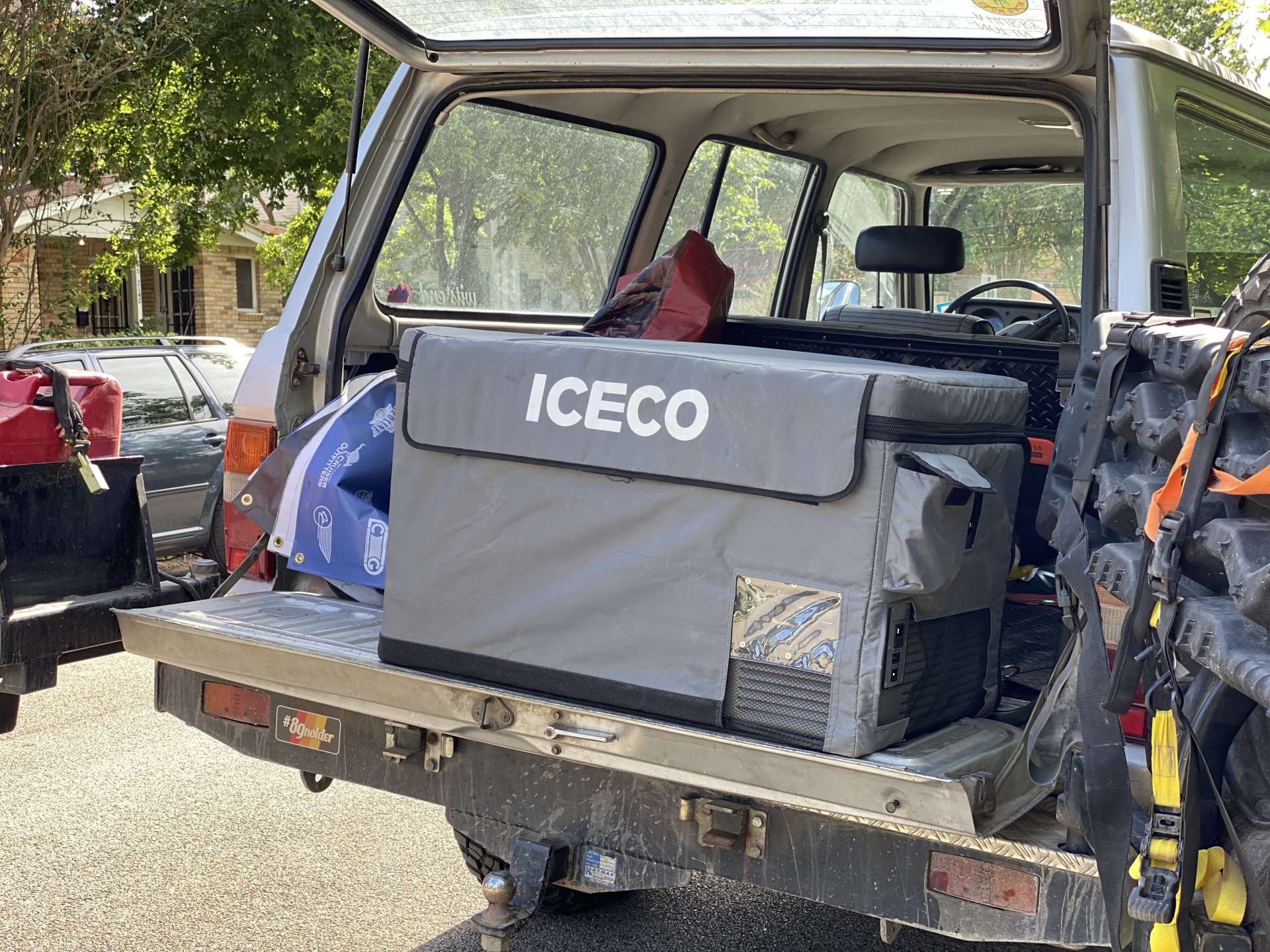

It did great. I camped with it on eco mode all week running of a single optima yellow top 34/78 and I was able to bring all my food back home.
I wheeled for 4 days with that thing in the back, zero issues

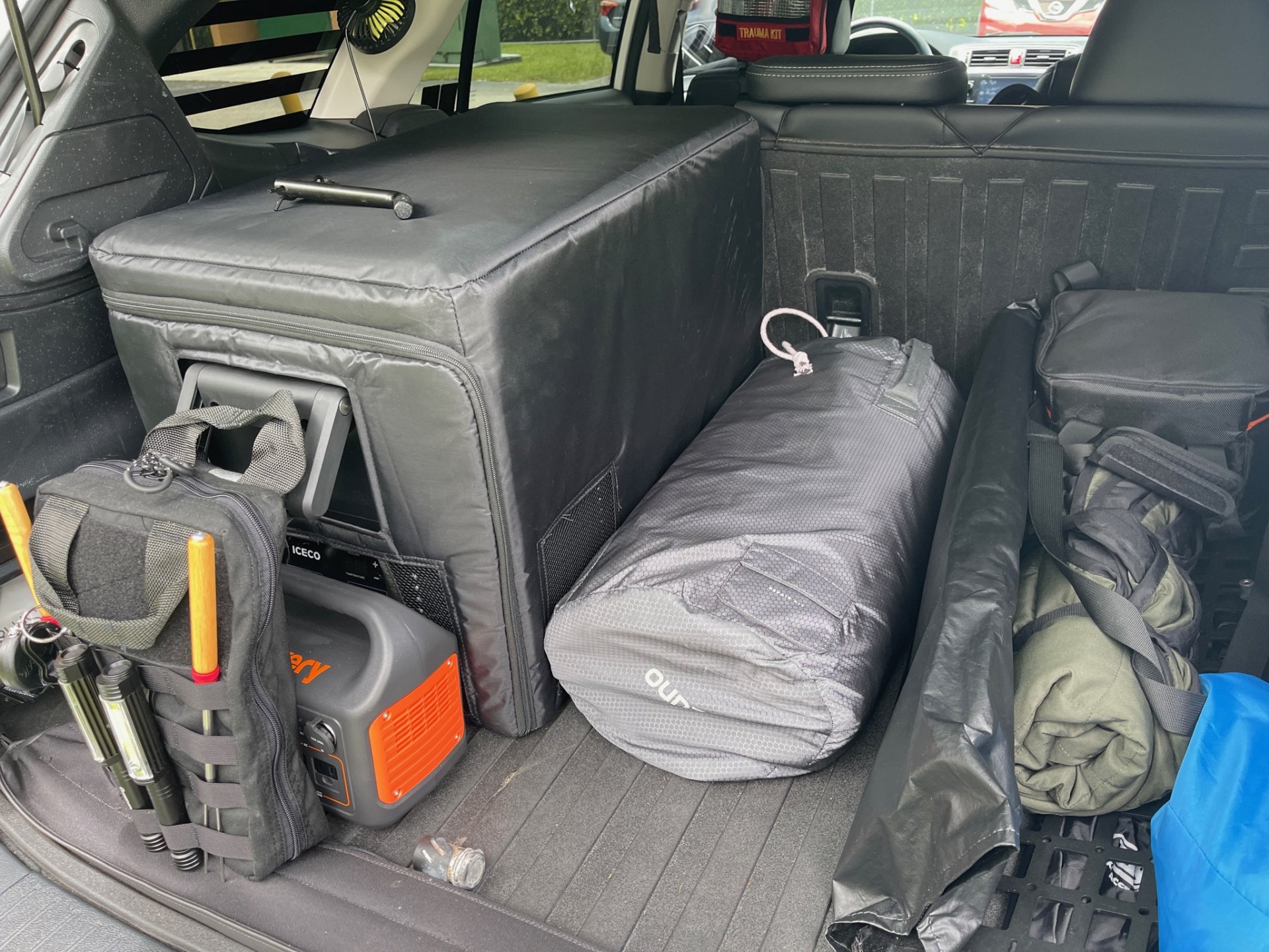

I have an ICECO VL 60 (single zone) and am extremely happy with it. I bought it off a group buy orchestrated by @SharpeCat .
Here‘s my routine…I pre-chill it at home, using 120VAC. Once cooled (36*), I load all my items (from my kitchen fridge) into it. Maintaining cold thermal mass is what you want.
While underway to my destination, I use a dedicated 12v port installed in the rear cargo area to keep the ICECO cold.
Once at camp, I connect the ICECO to a Jackery 240 . I have 2 of these, and I rotate them out, charging the depleted one with solar (Rockpals 60w), while the fresh Jackery is working.
This works beautifully (as long as I have sun for the solar panel), and I can get about 12-18 hours from each Jackery depending on ambient air temps.
And that’s the biggie…if it’s hot out, keep your fridge in the shade (and no insulated cover!). If it’s cool or dark, the Jackery will last much longer.

Why no insulated cover?
i have a Jackery 240 as well. How long does it take for the 60W solar panel to fully charge the Jackery 240?
When in full summer sun, I can go from 30% to 100% in 4-5 hours. The trick is to keep orienting the panels to get maximum sun exposure (IE as perpendicular to the sunlight as possible). Requires lots of moving…not hard, just needs to be done.
A 100watt panel would reduce that to about 3 hours.
My experience has been that the insulated cover keeps in more heat that it guards against.
As long as the metal skin isn’t in direct sun, it radiates heat that would otherwise be captured by the cover.
I have an ICECO cover for my fridge, but am running more efficiently now that I don’t use it.
YMMV…
YMMV…
Interesting. How did you determine that you are running more efficiently?
I was under the impression the heat is removed from the refrigeration thermodynamic cycle and is rejected from the vents on the back and sides, which is not blocked by the insulation cover. The cover simply increases the insulation R-Value of the fridge walls, and reduce heat conduction across the walls.
I was under the impression most of the heat rejection from the refrigeration thermodynamic cycle is from the vents on the back and sides, which is not blocked by the insulation cover. The insulation cover lowers heat transfer (in both directions) across the refrigerator walls.
Take this for exactly what you paid for it…
Not all vented hot air escapes from the vents…some rises immediately upon exiting the vent (its not propelled with much authority) and stays trapped against the metal box.
Additionally, once the insulated cover heats up, from either the inside (vented air) or the outside (sun exposure), it retains that heat because it’s, well… insulated.
I determined this pretty easily…my Jackery’s drain faster with the cover on than they do without.
Again, YMMV
