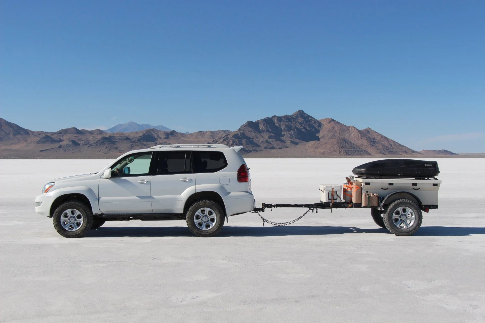

I have a home build trailer (copied off an M416 trailer) that can follow my truck anyplace, uses the same wheels and size tires. I did the trailer because I had a Jeep Unlimited Rubicon and going to Alaska with my sister and brother-in-law, the trailer let us be comfort and carry cloths and the trailer carried all the camping gear. With my GX, I have a little more room, but the same applies if I have 2-3 people with me. The trailer has a slide tongue so the length of the trailer can be changed if need. I have not yet run into a problem of finding a camping spot.
I also made my trailer so that I can pull off the box and use it as a stake bed or flat bed trailer, which has come in handy. The trailer is build with 3500lbs axles and the bearings get serviced every spring and lube/grease moveable parts. Thinking of adding a RTT to the trailer.
I am also setting up my GX to be used alone, encase it is just me and the dog. I can put a roof top carrier on to carry the tent and other stuff, and I can also sleep inside the GX if need, but I like my trailer.

I do not have a build list, but I can tell you I have about $1700-2100 into mine. A friend build the trailer, I purchased the metal, springs, axles and lights, etc. Another friend help me build the box, I purchased the wood, we did the work at his house. I found wheels on Craigslist and the tires came from my Jeep.
This is just beautiful to me! I'd love to have a small trailer and this looks just like I was picturing in my mind. I have pulled a trailer for 20+ years and drive most days like I am still pulling a trailer. I don't feel like I'd struggle on the trails and things I do with a trailer of this size. Now if it was much bigger I'd be less likely to feel as safe especially on steep climbs and steep downhill. I don't want to take the kitchen sink but with 3 people in the truck and a dog the room the trailer allows is appealing. Less wind drag on the trailer than on top of the roof too.
Pictures are just great because I like the visual... although my GX is a 2008 it looks a lot like yours. GOALS!

The roof top carrier creates some wind resistance and cause about 1.5mpg less than without it. I think it has something to do with the rear deflector on the GX and the way the wind comes from under the GX, but there is a lot of turbulence at the front of the carrier. Without it, the wind flows a lot easier over the trailer. Tested this with some tape and paper, put in different spots around the trailer and carrier. I will travel without the carrier as much as possible.
