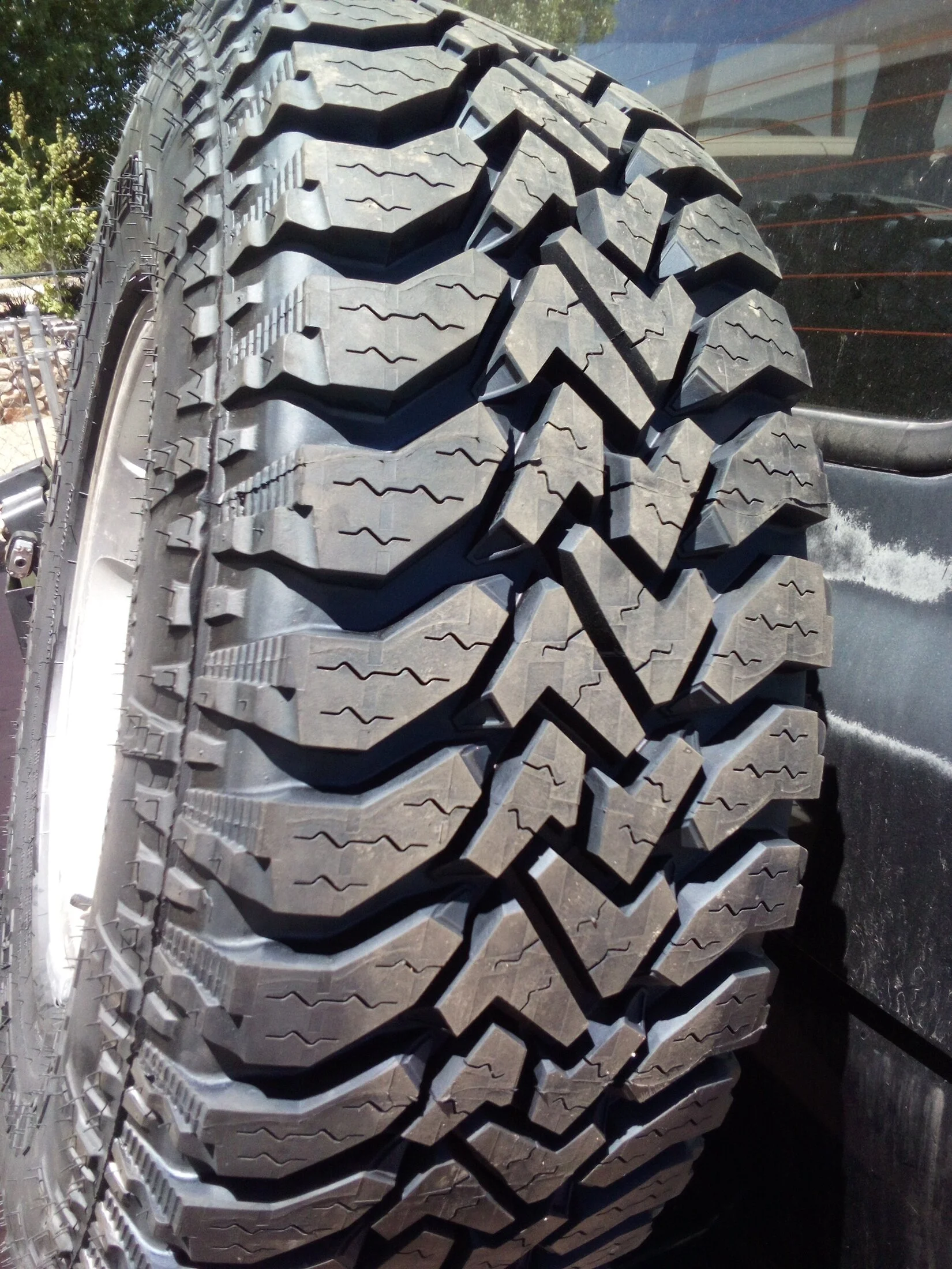

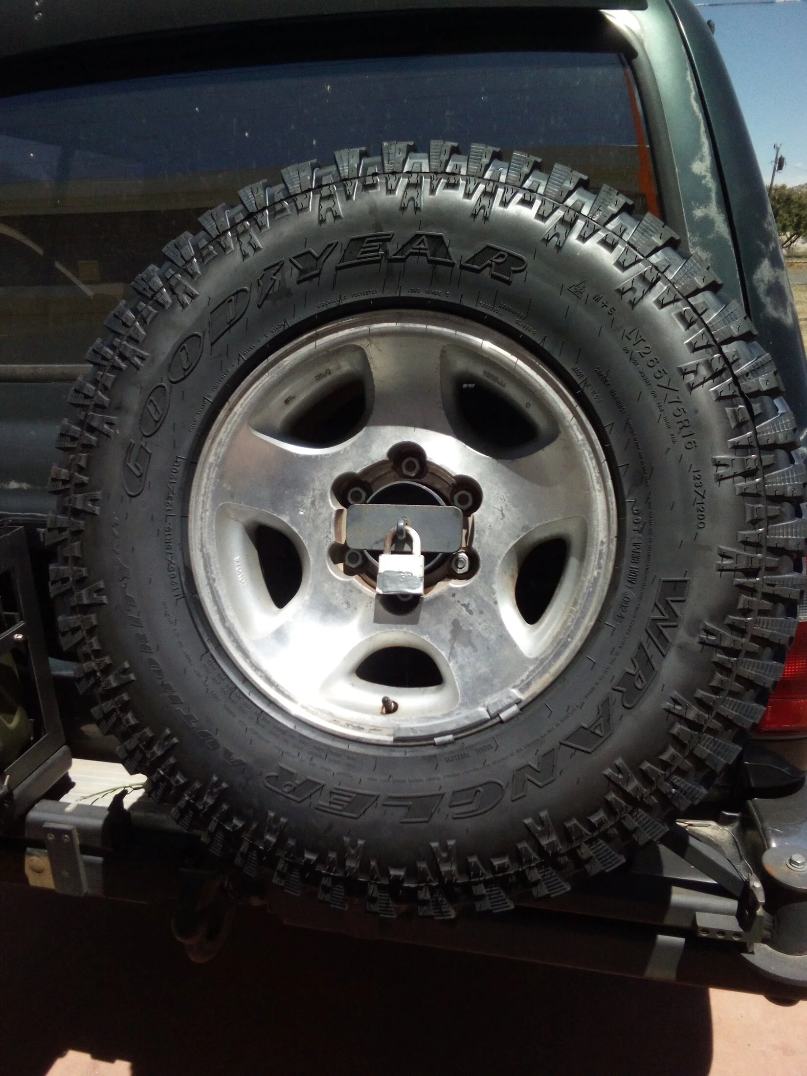

I ran Milestar Patagonia M/T tires for a little over 7 years, In the beginning i was happy with them, but as they got older, and the tread got hard, they became VERY loud at highway speeds, They all so have a VERY BAD habit of tread chunking, In the 7 years i owned them i had to replace 3 tires because of tread chunking, I just switched over to a set of M/S Goodyear wranglers size 265/75 R16 load range E,

No, Milestars are not made in China, in fact they are made in Indoesia, it says so right on the sidewall of the tire, But i still get your point about them being inexpensive tires

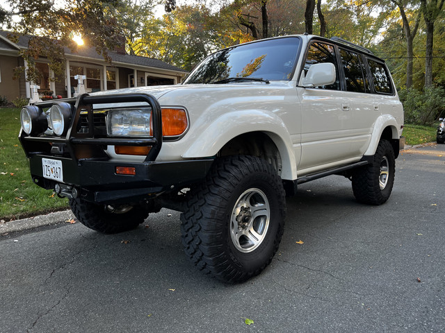

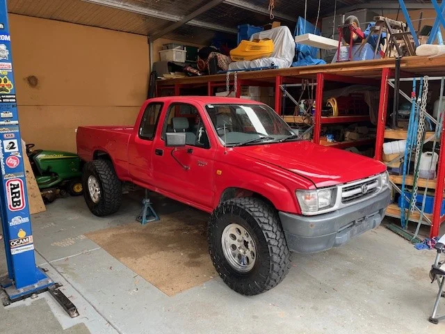

My '92 Hilux has Nitto Trail Grapplers for 5 years. So happy with 'em I've now got them on my 80. They look big posing on the 98 Hilux just for the pic but digging them so far on the 80 as well.
