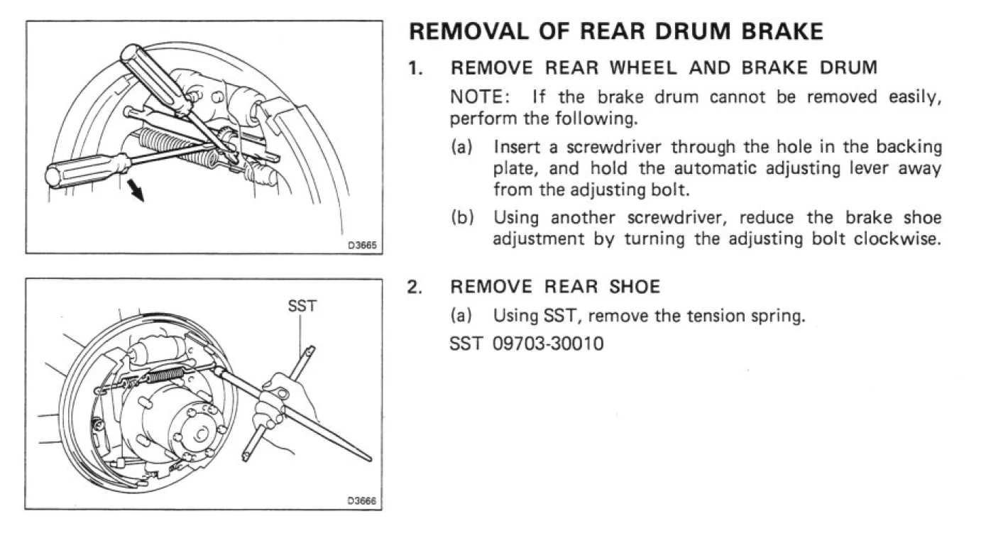

The drum adjusters are loosened by using a small screwdriver. Its a bit finicky.
Don’t drive around with a dragging brake. Fix it.
Yeah...you just turn the star wheel the other direction. I have hand written directions in my paper-based manual to help remember which way to turn. This always confuses me. I also find it is easier to back off the star wheel (loosen the brakes) if you use a second screwdriver and push the auto adjusting lever away from the star wheel.
Okay, so, use a second screwdriver to hold the spring-loaded plate off the star wheel, and rotate the opposite direction...(Push the bottom of the star-wheel away from the inside of the hub.) Dunno how easy it's gonna be to get two screwdrivers in there, in the snow, but hey....that's what it's all about, right?

Yes. You use one small screwdriver to push the plate off the star wheel while using a screwdriver or brake tool to turn it. It can be tricky and you'll have to get the right feel for it. When you find a good spot on the plate and push you'll be able to feel the resistance of the spring. I have a pick with a right angle tip that I use instead of a screwdriver for pushing on the plate.

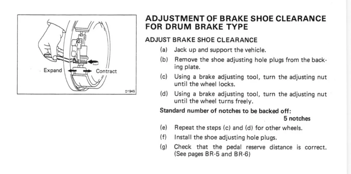

You didn't over tighten. The rear shoes auto adjust every time you pull the parking brake. EDIT: when you put new shoes on don't bother adjusting the shoe tension with the screwdriver in the slot in the backing plate. Once everything is in place simply work the parking lever several times and they turn the star drag to the right tension. They may be over-adjusting on their own. If they are they will again if you loosen them as soon as you pull up on the hand brake a few times. See my post above and read the linked thread about shimming the offending brake shoe.
