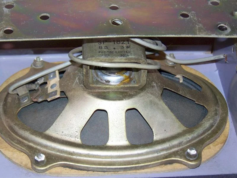

I think the speaker mounts to the glove box between the firewall and the glove box. If you look in the glove box on the PS you should see 3 holes. These are where the studs for the speaker mount come through.

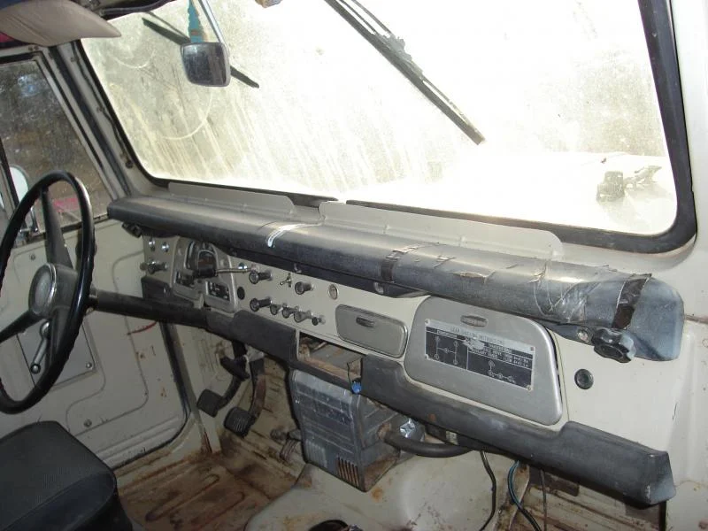

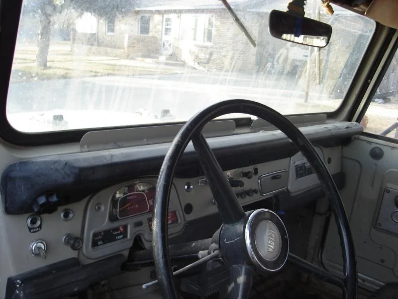

My 72 doesn't have a hole for a radio, the bottom dash pad runs all the way across.
My 74 had a AM only and a speaker in the glove box behind a perforated plate.

My 72 dash
another 12/71 FJ40 with no radio or place for one here..... I have never seen a 71, 72 with a place for radio and I have been around these rigs for over 20 years

somebody did a really clean job at cutting out the dash...thats all...the lower dash pad bumper looks like it was cut out also....later lower dash bumpers come in 3 pieces for the factory radio opening. yours looks like its 2 with the long side cut out for the radio.
I think you are correct after looking at it further, they just did a good job. Now I don't know whether i should order the AM/FM from cruiser parts or not - maybe they cut it for an aftermarket deck? Anyone know the opening for the OEM Am/Fm?
If there's pad under the radio hole then it's been cut. Looks like it's off center too.
