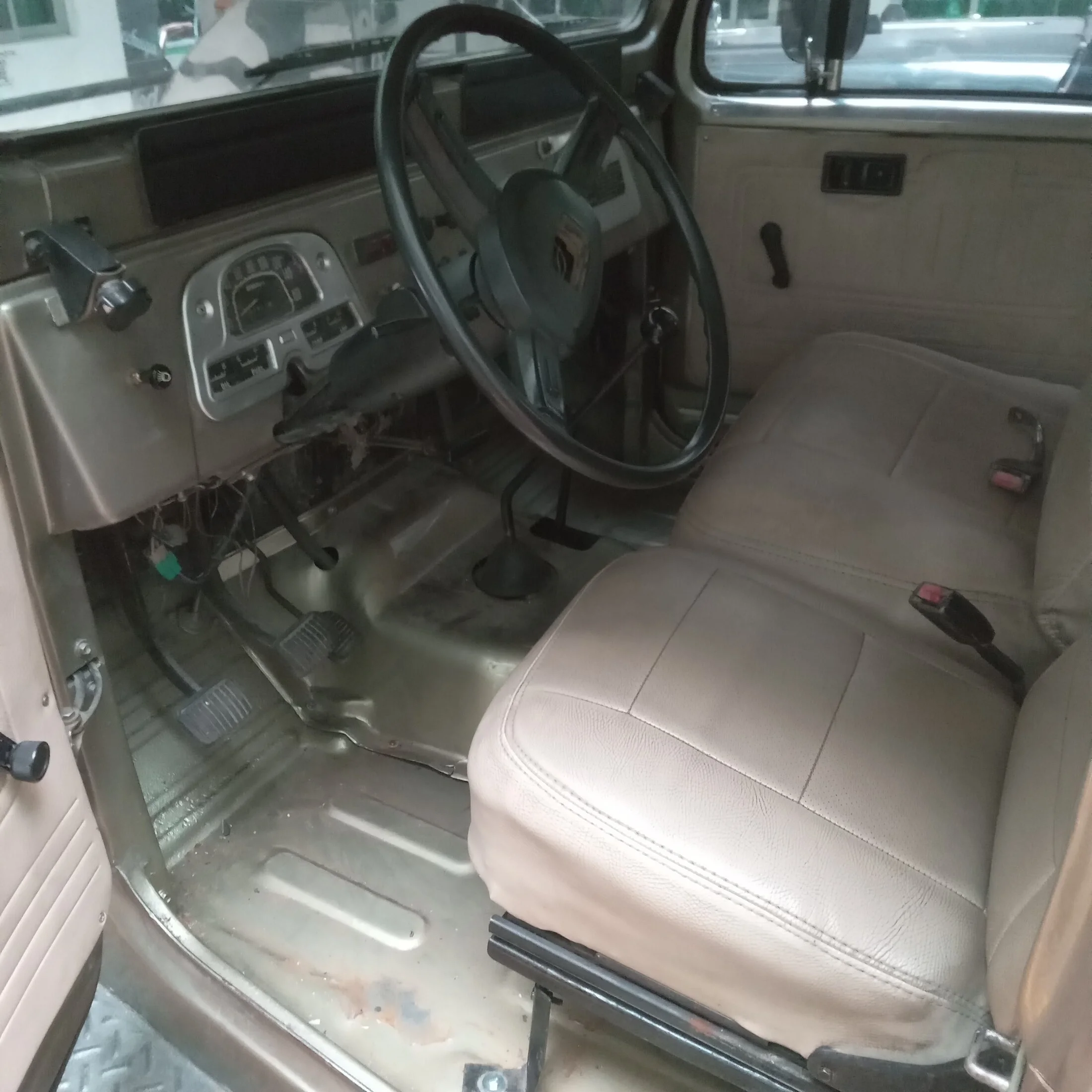

I am installing seat belts and I think I am using the wrong locations. I think the rear heater mounts to the locations that I am using. Does anyone have a picture of the locations where the seat belts mount to? Just the middle ones. I have the ones on the door sides.

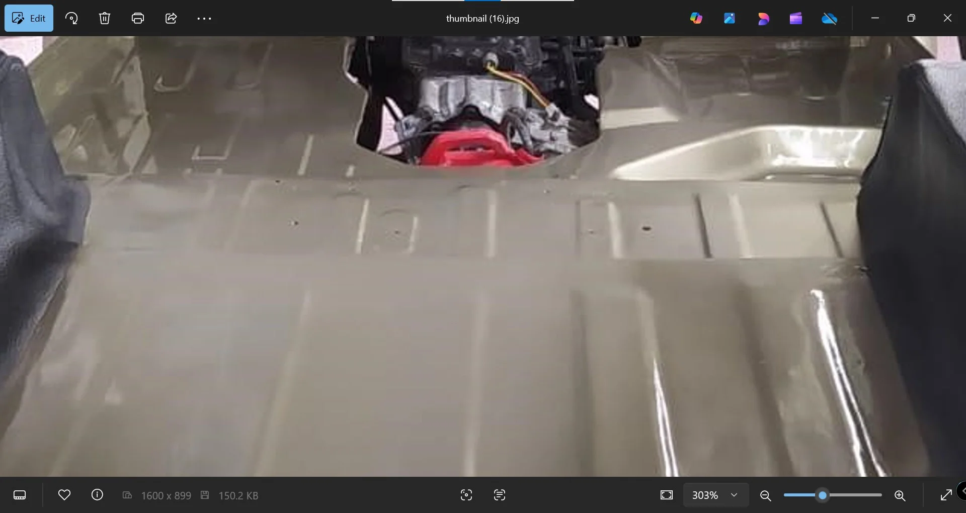

I've been trying to figure that out too...
[Edit: sorry, the link was bad. Should work now]

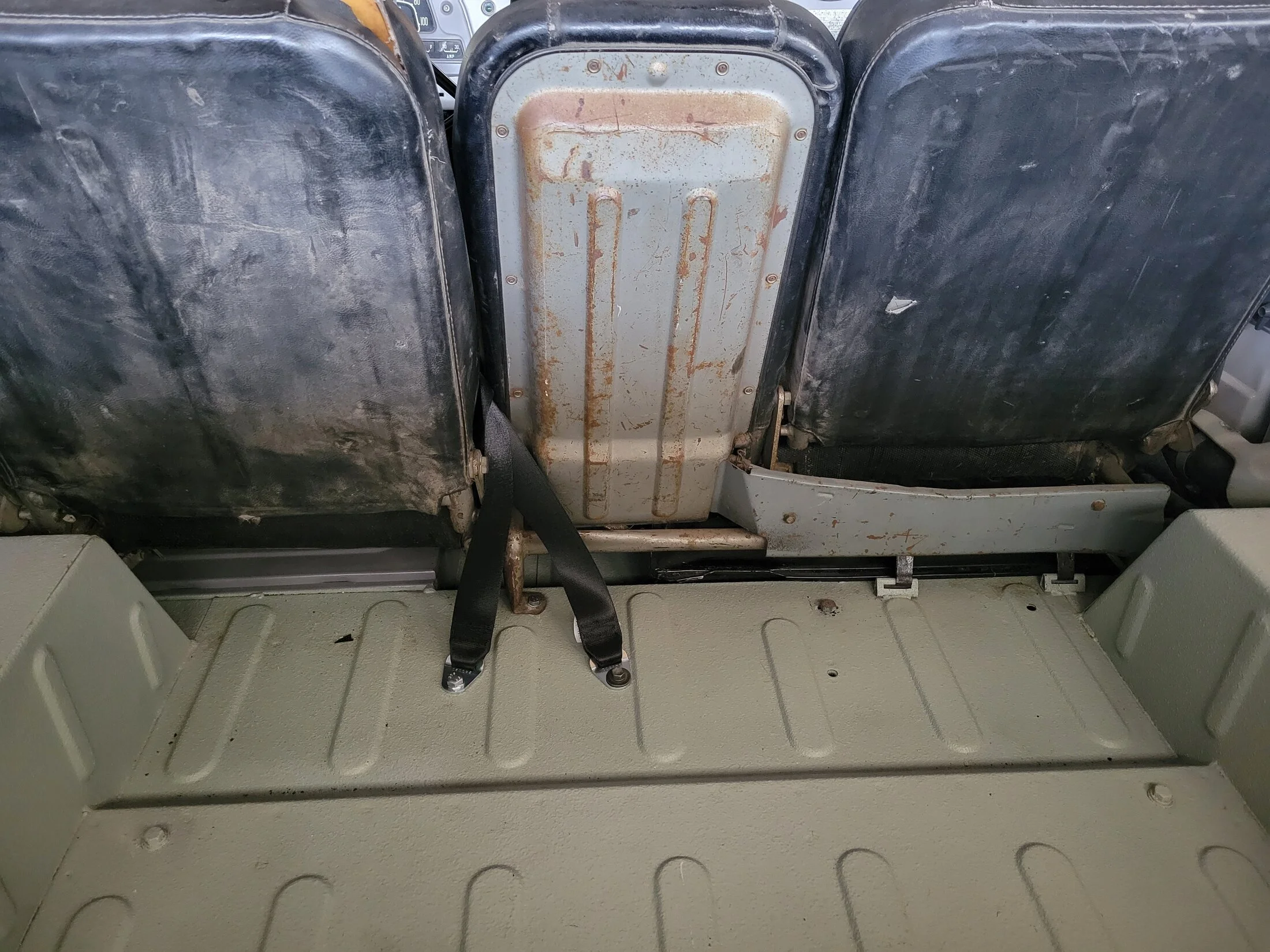

Check out this post on my build thread: 1972 FJ40 Seat Belt Anchor Locations
Driver's side is not correct. It would be in the bolt farther forward. Never owned a 72 that had the emissions tank in the passenger's seat back. Believe the anchor on those moved so the seat belt came between the two seat backs. Guessing I have some good pictures of my 70 model I took when I got a stated value insurance. But the passenger side would be different because it when all the way to the end of the seat.

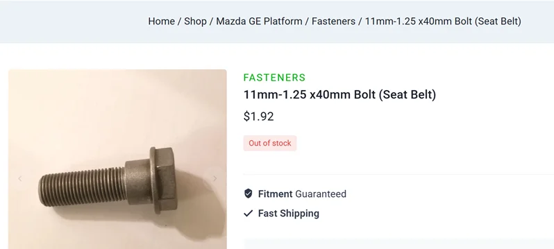

Standard pitch for M11 is 1.5mm, and M11 Fine pitches are 0.75mm and 1.0mm.
While you can find M11 x 1.25, they are like rocking horse droppings by comparison.
I only claimed the 7/16-20 and M11x1.25 were interchangeable.
Note that other OEMs uses the M11 for their seat belt fasteners. I speculate that the NHTSA rule requiring seat belt anchors to use 7/16-20 or 1/2-13 ("or equivalent") permitted the metric M11x1.25 specialty thread for metric OEM's.
Rocking Horse droppings spotted:
Yea they are out there. Just much less common.
Tbf, you'd be hard pressed to find any M11 fastener in a normal hardware shop in any pitch.
M10 and M12 on the other hand are everywhere.
