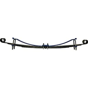

That's cool and a little funny that Toyota made them to fix the problem. I would probably got with the bolt on level helper spring on each side, since they are adjustable and you can keep it level if the amount of lean changes. I think the amount of pressure needed to level it would not effect the ride. Thanks for the post, I had no clue Toyota made them or seen them, looks easy to make if needed for the amount of lean a rig has.
Can you give more info on that level helper? Where to buy, etc? Haven't seen that before, just the block.
Most people aren't going to want to look at bolt-on, adjustable helper springs. It'll scream out that something is wrong. A block between the spring and axle is a little more work, but nobody will know it's there.

Very funny. I was referring to the spring in the picture in post #2. I had only seen the block before, never that method. Was just curious about it.
I was trying to be. You can find them a searching under helper springs. I couldnt find a model that fits a '40.

I have seen those helper spring on many fj40 pictures, I doubt any are listed for fj40, just need to find them that are the same width as your springs. Yeah they standout like a sore thumb as not stock, with two on there they do not indicate any problems, many vehicles use them to help a sagging rear, or if you load the rear of a truck up with stuff, or a heavy tongue trailer.
