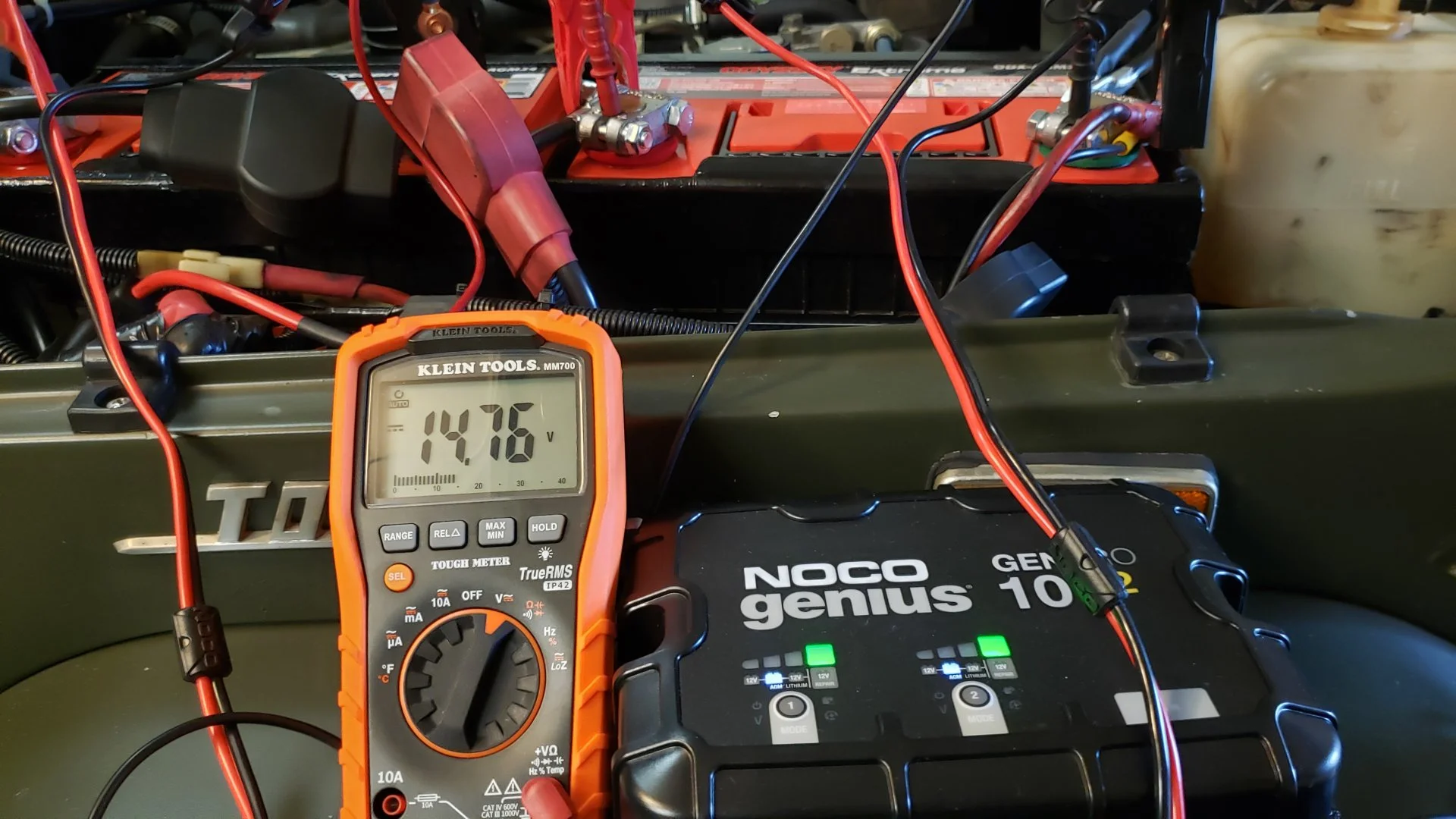

i pulled my truck into the garage for some maintenance and checked the battery voltage at the terminals. 12.6V. i've been daily driving it for the last week off the charger
connected a Noco 10Amp charger in AGM mode. within a few minutes the Green light was lit and pulsing slowly, which means something i'm sure. the voltage kept climbing over the next few hours. i saw it peak at out at 14.8V before i went to bed

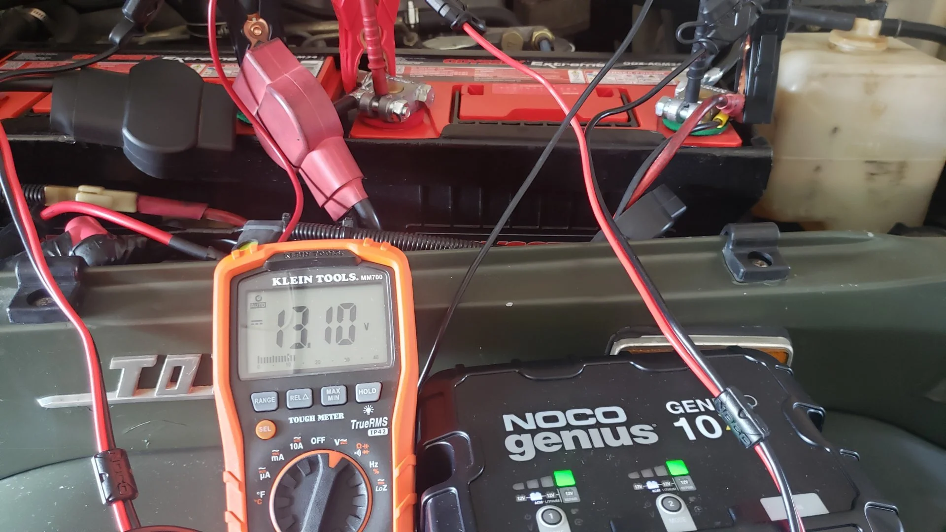

this morning the battery is sitting at 12.7V and the Green light is solid, no more pulsing.
my takeaway is that all this is fine. Odyssey recommends a 2A trickle charger but says one can't be used for a deep recharge. They actually recommend 40A for deep recharging. For my purposes 10A is more than enough to take a battery up to ~14.7V like they recommend but maintain a battery at the near 100% State of Charge of 12.8V. i didn't see it written down, but i can't imagine you'd want to hold the battery above 14V for days/weeks/months. it does say you can store a battery for 2 years off a charger if charged up to 100% before disconnected. when i don't drive my truck for a few days, i'll connect to the Noco and leave it.

Did the exact same thing last night with my Noco 10. Within a few minutes the green light was pulsing after having gone up to 14.7 volts. It then went down to 12.86 and slowly worked its way up to 13.30 by the time I went to bed. This morning I checked it and the green light was solid and at 12.98 volts. I'm sure its fine but I don't get why it can't hold it at 13.5 volts.
I've been monitoring my Noco dual-10A charger also. Since my batteries are brand new, it goes from bulk to absorption and then to float mode very quickly. Along the way, the voltage goes up to 15V for a second then back down to 14.76V and drops to around 13.10V hanging there for a few days. Last night before bed I saw it dropped to around 12.9V, then this morning I caught it back up at 13.10V. It could have went up even higher but I might have missed it. The program is certainly doing something. To really tell the whole story, of course, an inline amp meter must be used and record the whole process.
Note that the recommended 13.5V from Odyssey (and 13.3V from Lifeline) are for float charging state at 77F. If it doesn't need charging during the float mode, it doesn't have to be hanging at 13.5V all of the time. The Odyssey charger does the same thing, based on its manual, leaving the battery at around 13V most of the time.

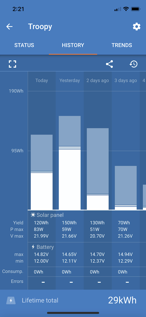

I'm running an Odyssey Extreme 34/78 PC1500. I have a Victron MPPT 75|15 and a 100W solar panel. I run an Engel 45 before/during/after camping trips but generally disconnect it for longer periods of non-camping use.
The battery lists the following charging voltages:
Cyclic Charge Voltage: 14.4-14.8V at 25-degrees C
Float Charge Voltage: 13.5-13.8V at 25-degrees C
The Charge voltages in the Victron are as follows:
Absorption Voltage: 14.70V
Float Voltage: 13.80V
Equalization Voltage: 16.50V (but I have automatic equalization shut off)
As I understand it, the controller will bulk charge the battery to 14.7V at which point it goes into absorption mode... and when the voltage drops to around 13.80V it will go into float mode to roughly maintain that voltage.
But perhaps I should be disconnecting the solar during my periods of non-camping use when the fridge is off. Would you all recommend NOT having the solar constantly hooked up and keeping the battery topped off?

Thanks for the feedback gents. My setup has been running like this since May 2020... coming up on two years. I've not observed any issues with it. Being an older truck there isn't too much parasitic load (the digital clock, the MPPT controller, a USB port with LED indicator). But essentially being on a constant trickle charger during the day hasn't seemed to be detrimental. I'll leave it as is. It's proven to be quite robust on several remote trips here in AZ.
