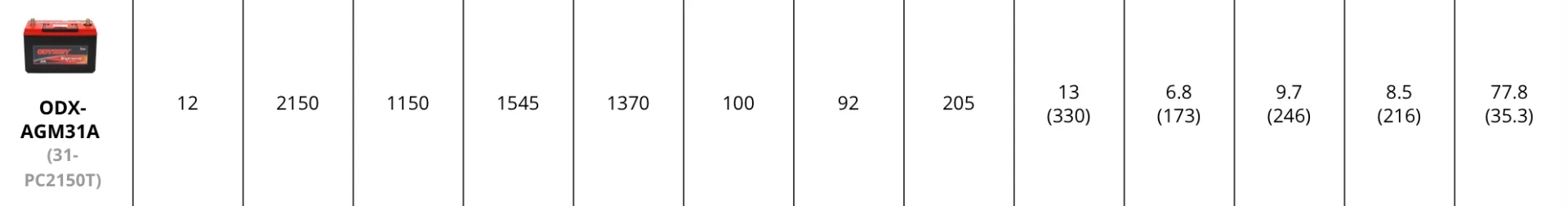

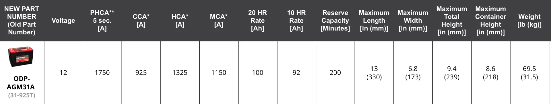

Anyone with head-to-head experience? I am needing to replace my main group 31 in my 100 series and am struggling with the trade offs. I have solar so shouldn’t deeply discharge the battery too often, but given I’m running a single battery system want to have all the insurance I can get. The Extreme series PC1250 is $534 out the door with a 4 year warranty at my local Autozone, but the Performance series 31M925 is $420 with a 3 year warranty. See spec comparison below, main difference seems to be the cranking amps. Odyssey rates the Extreme batteries to 400 deep discharges, but doesn’t say anything about the Performance series.

Honestly the extreme probably just comes with more cranking amps. The specs clearly state that. I'd guess based on the weight that they achieve that with more lead plates packed into the case. Since it weighs about 8 pounds more. At that point you would have to decide if the 4 year over the 3 year warranty is worth it to you.

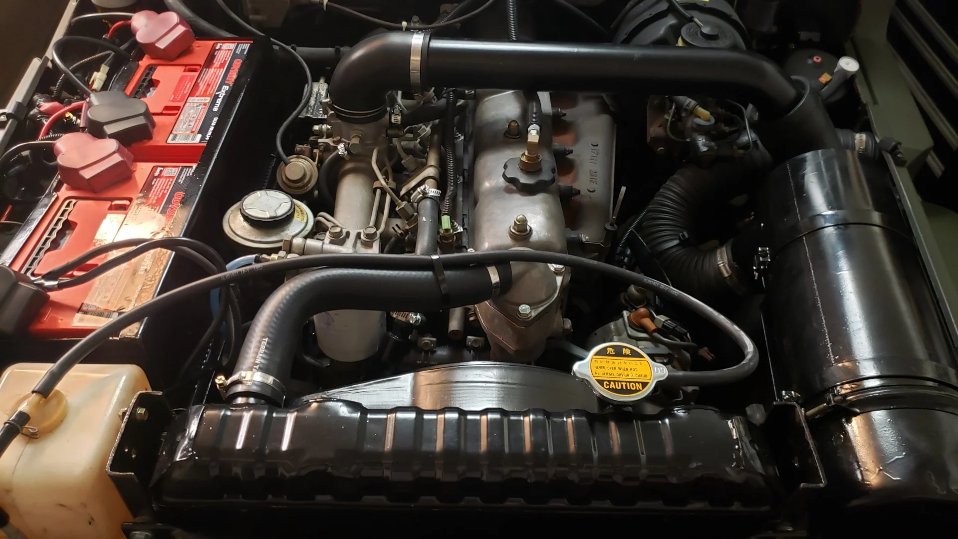

Knocking on wood...my Odyssey G31 Extreme is now 8+ years old and keeping the starting position happy on the spressoWAGON.

As you probably know, keeping them on a battery charger/conditioner when the rig is sitting for more than a few days is key to AGM longevity. And dual bank charger for...dual batteries.

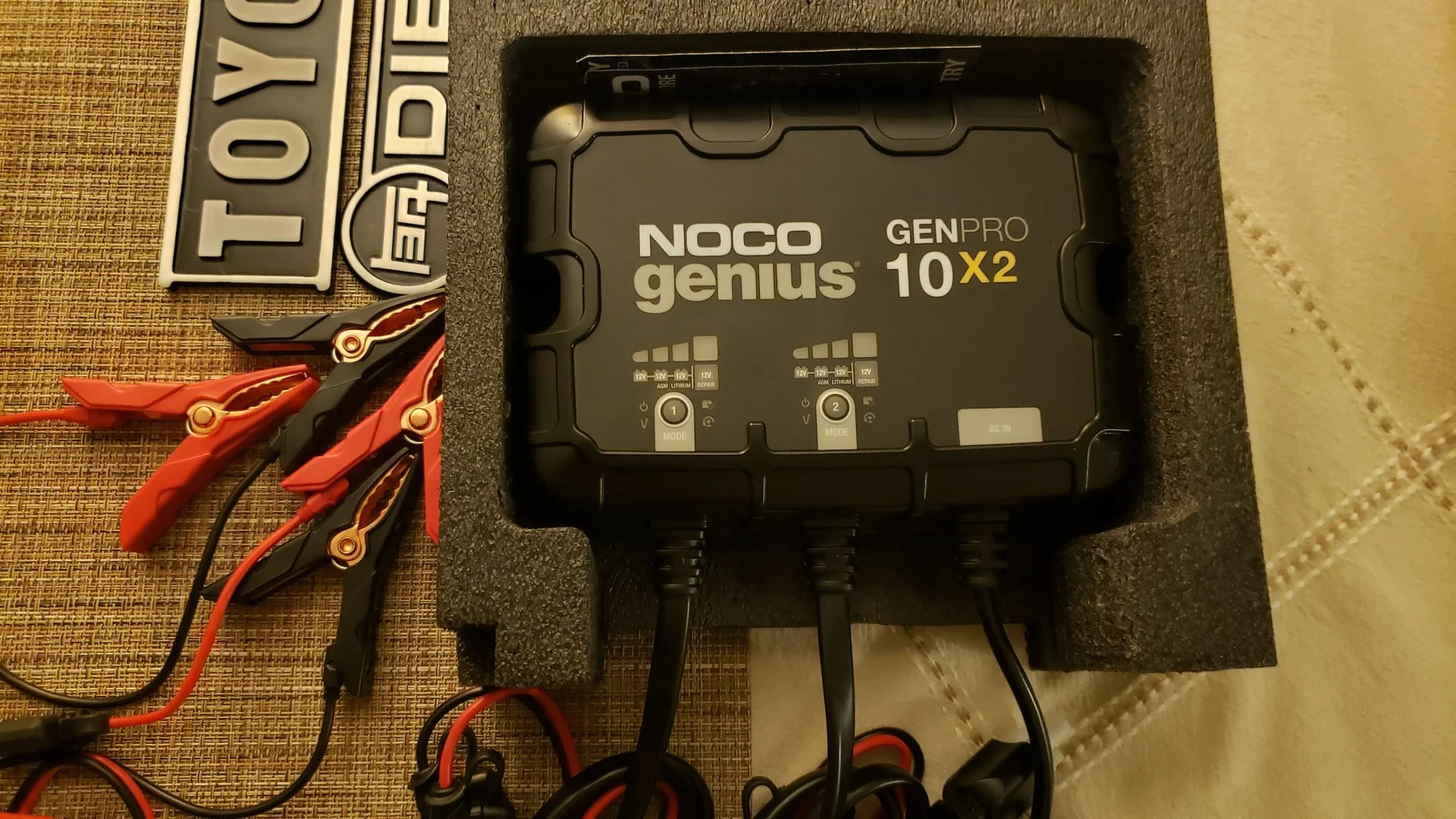

I have not been impressed with my Noco genius charger when it comes to maintaining by Odyssey batteries. The odyssey batteries say they want between 13.5 and 13.8 volts for a float charge. I'd found the Noco even in the AGM mode doesn't even hold them that high. I've also noticed that when it gets to its "maintenance" mode that its really not providing anything to the battery and the voltage actually has to drop to some lower voltage for the charger to turn back on. It never seemed like it held the battery at a higher voltage than the resting voltage. I think this is a main reason why Noco is not an approved charger for Odysseys.
As far as just charging a battery the Noco does fine.

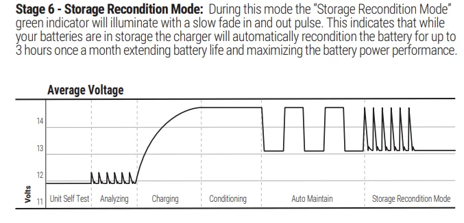

I read the Odyssey/Enersys charger manual, and in the 'storage recondition mode' they raise the voltage up 14.7V for 3 hours per month, and the rest of the time they left it at around 13.05V.

wonderful. i have a new-ish Odyssey AGM and a new NOCO 10-amp charger dedicated to the cruiser. a vintage car sits on a Battery Tender 1.25A. i spent too many brain cycles trying to pick a new charger and sounds like i didn't pick the optimal charger. dang.
what's a recommended charger for these batteries?
I've got a noco 5 and 10 and I'm hating it too. They do a great job at charging the battery and getting it to 100% but the maintaining part is where I'm disappointed.

What exactly are you noticing regarding the float charge? After how long do you see the voltage drop, and to what? I haven't actually put a volt meter on my battery during maintenance mode and I certainly don't have one fancy enough to plot me a chart.

I don't know a ton about all these proper voltages. I just know that on the top of the Odyssey batteries it says a float voltage between 13.5 and 13.8 volts. When my noco is in its last mode I was noticing that the voltage would get down to between 12.9 and 12.8. Almost as if the charger was doing nothing but watching for the voltage to drop to a certain amount before it goes through its steps again. I'll have to hook it all up again and take some photos.

As stated previously, Odyssey charger itself does NOT even hold the battery above 13.5V in its 'storage recondition mode', leaving it barely above 13V (contrary to what it recommended elsewhere.) Furthermore, it only upped the battery to 14.7V for 3 hours per month trying to dump some amp into it, yet it is debatable if that is even necessary because the battery is already fully charged. Read page 9/14 below:
https://www.odysseybattery.com/wp-content/uploads/2020/05/ODYSSEY_battery_charger_manual.pdf
