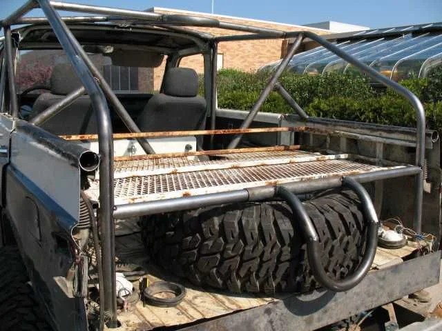

I had a roof rack that came with my swamp cruiser 40 sitting behind the shop. I was gonna cut up the expanded metal for trailer ramps. I measured it up and it was 1/8 narrower than the back of the pig. I had to lay the spare down because it won't fit along the side with the back seat up anymore. The rack looked like a good solution for bed space. I'll pull it back out and clean it up and weld another rail across the back.

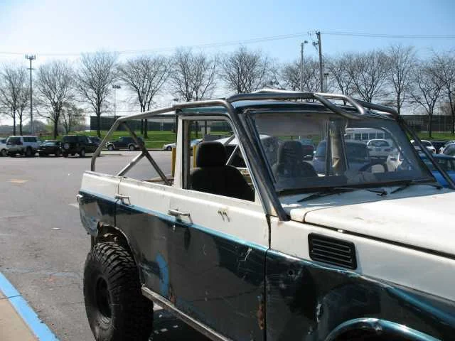

I need to bob the frame about 8-10 inches, put in the cage supports from the frame, finish weld and maybe a couple more supports from the rear up to the halo. The halo needs some inner bars still as well
I was going to ask why you didn't bob the back end. It only makes sense. Keep the pics coming! Chopped Pigs are the kewlest!
I thought about bobbing it a lot more, but I want to be able to carry a spare and other junk with the back seat intact. I don't think departure angle is going to be much of a problem. These pics are with the rear sitting on the bump stops. It lost so much weight the 80 springs are way too tall and stiff.

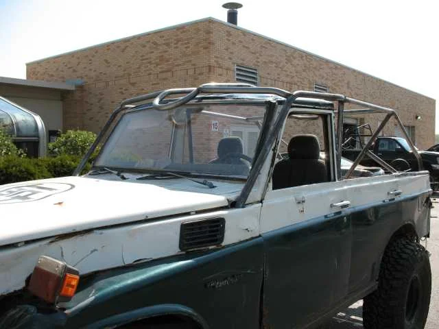

Just wondering what the purpose of the F & R "halo" is? To break up the span of the tube or :confused:
Keep the pics & progress coming!
WORD, especially the front. I can picture catching a low hanging branch there; watching it slide up the windshield, get caught in the halo, then pull and crack your windshield; without the halo that branch would just slide over the top...
The halo was going to be big enough to circle the cab originally. It kind of evolved into what it is now. It is a central locating point for the tubes to tie into.
There's no way the front loop is going to crack any glass, because there is no glass. The roof is way too crooked to get a windshield back in there. It's lexan. I can easily make a cowl cross bar and tie a bar from the apex of the curve down. In the back I might bring a tube up from either corner to tie into the apex in the rear.
I will definitely be running some tube across the middle of the 'halo' to strengthen it at the points where the crosstubes tie in.
Exactly what I was going to suggest. Then you can ram big, low branches and they'll just flip up over the top! :cool:
Dont you worry your pretty little head about sticks, Todd and the war pig laughs at sticks.
I made the halo, the idea (dont tell todd) is when he is leading he will tear out all the low hangers for me:flipoff2:

What do the tubes tie into that go along the A-pillars. I see that they go through the top of the fenders. Where do they go from there? I like that concept, because it does not take up any room in the interior near the dash.
Thanks,
Chuck
