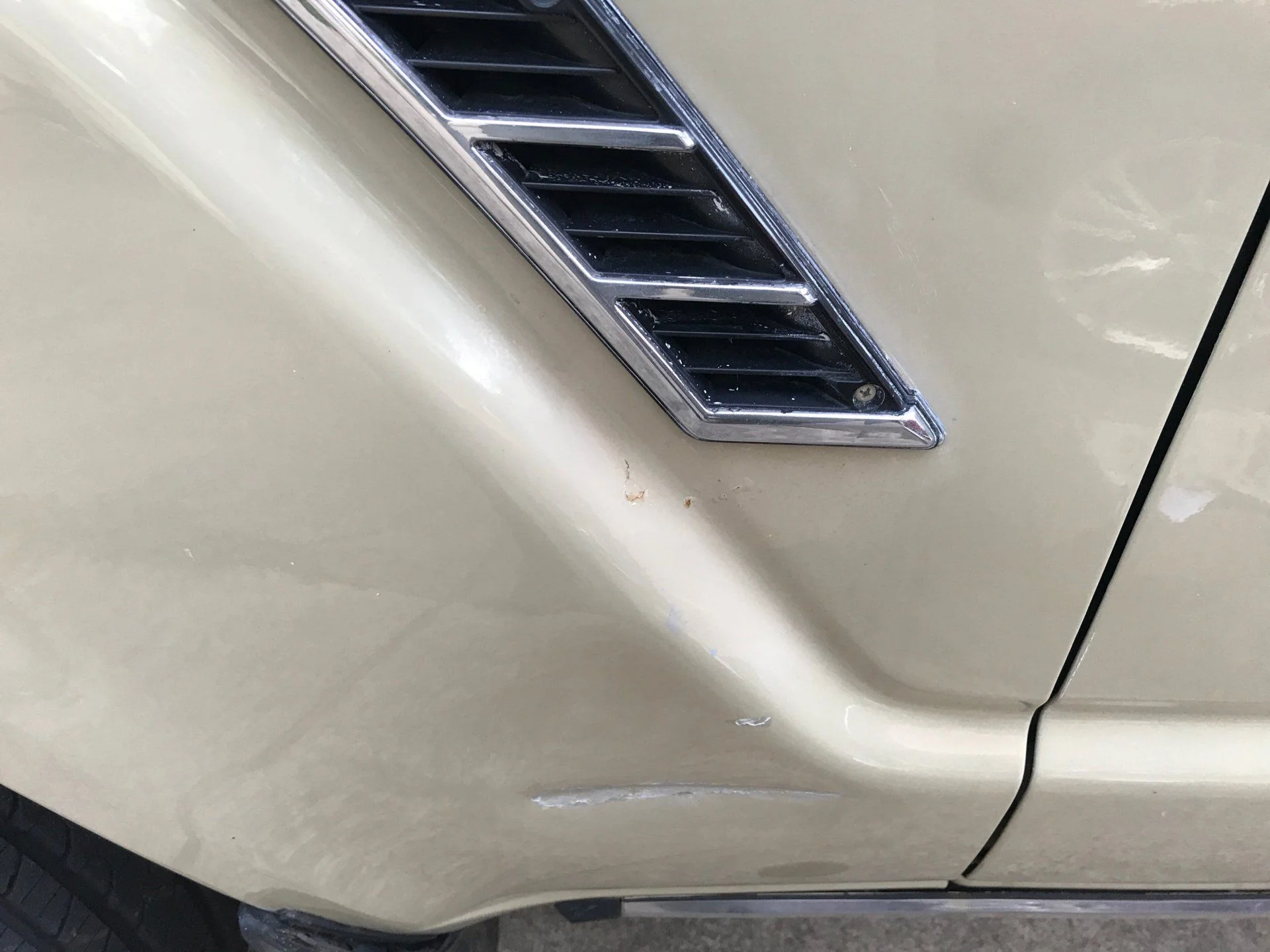

Additional photos I got from the seller.
In my mind its better to see the dents, faded paint, and rust spots because then at least you know what you have or at least an idea. When they have fresh paint I get really nervous and actually look a lot closer and harder. Even consider having a decent body shop look it over. I saw the ad for this one and I would want to crawl around the underside before i made any decisions. If the frame is clean and solid and the floors look clean and solid then it might be a good buy. I've seen lots of FJ's for sale int the $3500-$5500 range (in my search for one for myself) that look ok on the top and are gone underneath.
the spots shown are classic rust spots on a 60. The area to be most aware of is the roof gutter area. They rot from the inside out due to condensation. It looks like that has had body work, resprayed, and is coming back through. In person inspection is required.
