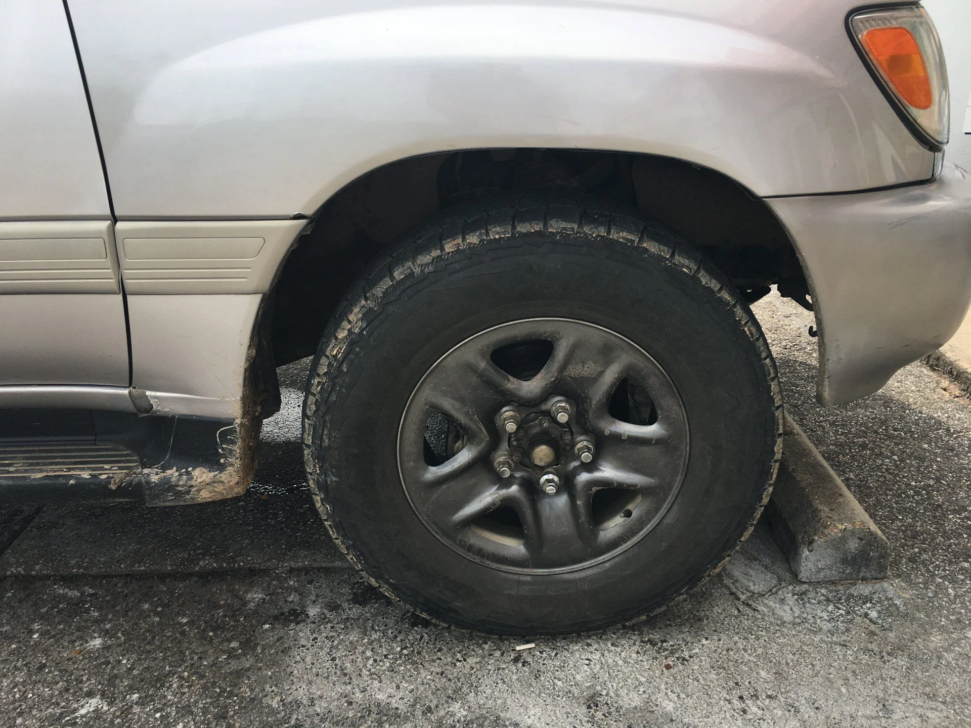

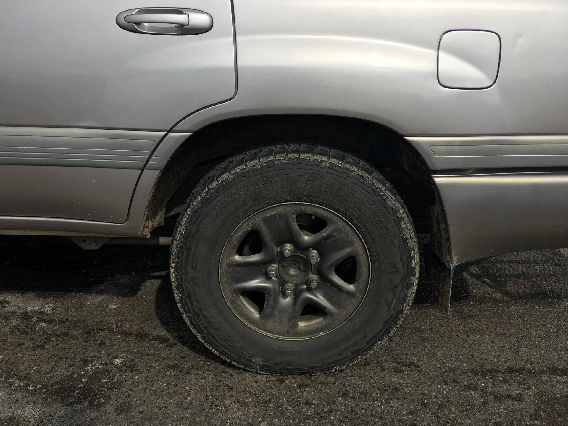

For $90 Airlift 1000 air bags and cranked torsion bars, it looks result in about a 2-2.5” lift.
I didn’t even think about it and get measurements before but the after measurements are: from the top of wheel to fender is 11.25” in front and 12” in rear.
And it rides superbly.

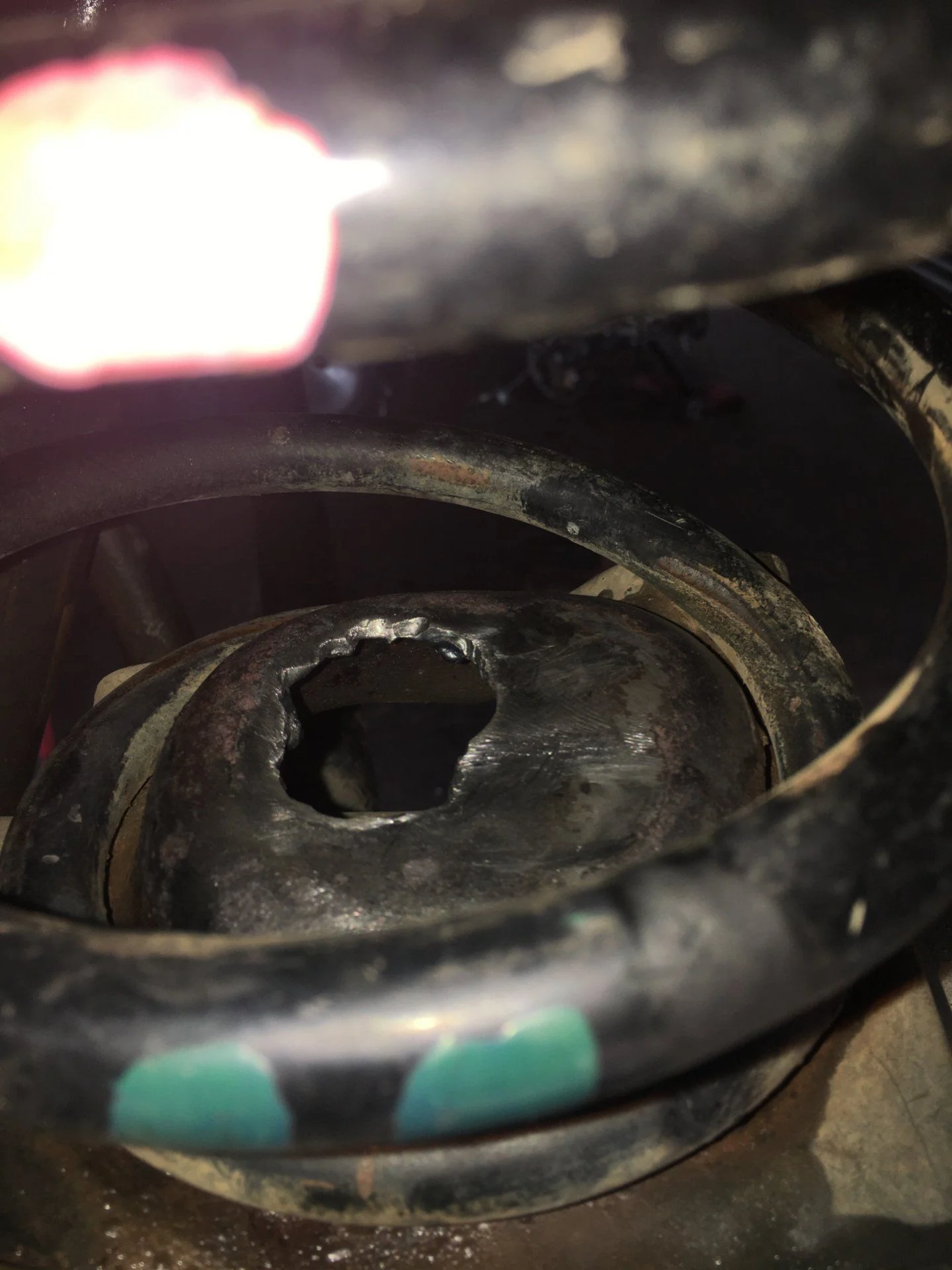

I have the HD compressor and bags ready to install, just haven’t done it yet. It is specifically for towing our camper. Off road, it will limit up travel, and what happens if they get pinched or punctured? I’m just saying, that if lift is achieved solely from the bags, if you lose the air to the bags, you lose the lift. And installing airbags, is harder than a spacer. You have to drill out the hole in the lower spring perch, and that sucks. If yours was already drilled, then you can just deflate and swap it out. But it is a great way, to progressively handle weight. I’m putting them on in a few weeks 👍🏼
Try it. You may find out that if you don't drill out the hole larger than the recommended hole size on the bottom of the spring perch that whatever clip/clamp you use too connect the air line, the clip/clamp may cause issues over time. Also, the ride DOES firm up in the back with inflated bags. The back may get jumpy/hoppy.
Definitely have to increase the hole size on the driver side perch. Took about 10 minutes with a cutting torch with spring in place.
Yeah, I don’t have a plasma cutter yet. Bottom line, “suspension” lift is just handling weight, right? So I’m down with lift from bags, I just would be concerned about durability on the trail.

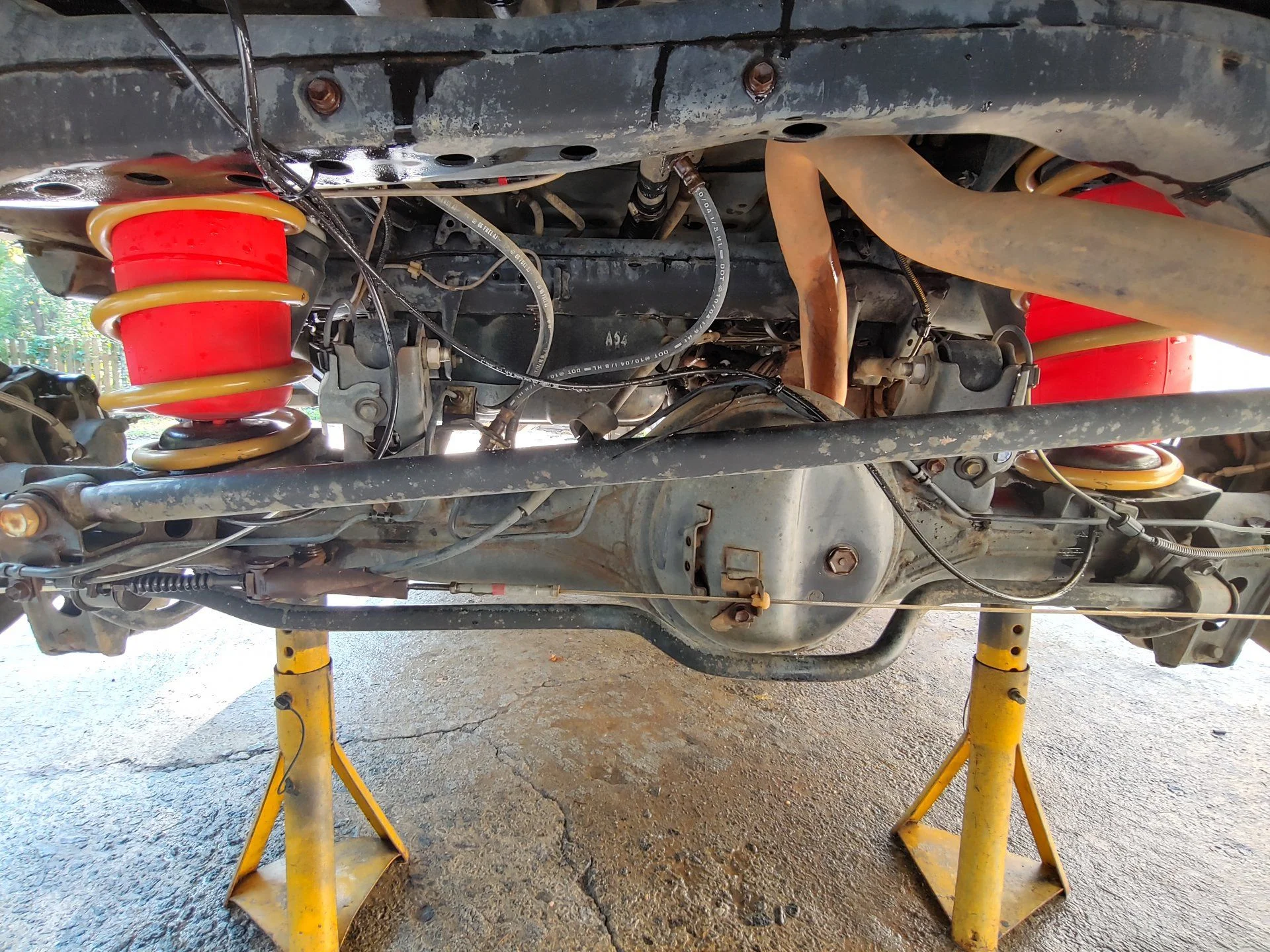

I use mine for towing, only. And I empty them all the way when they're not in use. Yeah, they say leave 5lbs in, but here's what happens when you do that and then go wheeling: they hold the inside edges of the springs, and both prevent the spring from full compression and will eventually be rubbed 'upward' to the point you will pull out the air line. Even with a widened hole in the perch. Ask me how I know. It's possible my bags are wider than others, but it's been my own experience that keeping air in them while stretching and compressing the springs is a bad idea.
If I only ever drove my truck on pavement, I guess I'd consider leaving them inflated? I just bought the right springs so no need to. They have a purpose (for me) and they defeat that purpose when used outside of that purpose.

Your experience is different, that's fantastic. Mine is what it is. My perch was widened out beyond the general recommendation here and there's more than enough slack to account for suspension flex. What there isn't slack for, is the bag 'gripping' the inside of the springs and moving 'up' inside of them. That's an extra idk 6" or so? And as I mentioned, it's possible my own bags are wider than others. My bags are also sealed all around, there's no anything getting into them short of a puncture.
Regardless of your or my own experiences, I can't see any way that having them inflated (to the point of lift) while on a trail is beneficial. Even if they don't pull the line out, they're still going to restrict the compression of the springs.

All I could account for would be different sized bags or springs with different inner dimensions. Maybe different rear droop between your suspension and mine, but I don't imagine that's significant. My bags are just snug inside my gold coils, and will often hold toward the top of the spring depending on how the spring has been cycled. Our experiences are not mutually exclusive.
Yep looks like your aftermarket coils are coned shaped whereas my oem ones are not. That definitely would force them upward. You can see in my photo that my bags are sitting nicely at the bottom of the perch. That was with a light load of tools and coolers and recovery gear and 5psi. The Air Lift 1000s are absolutely perfect for my application. I got mine as open-box on Amazon for $40 and I intend to use it in its current config for a very long time. https://amzn.to/3gzLiMx
