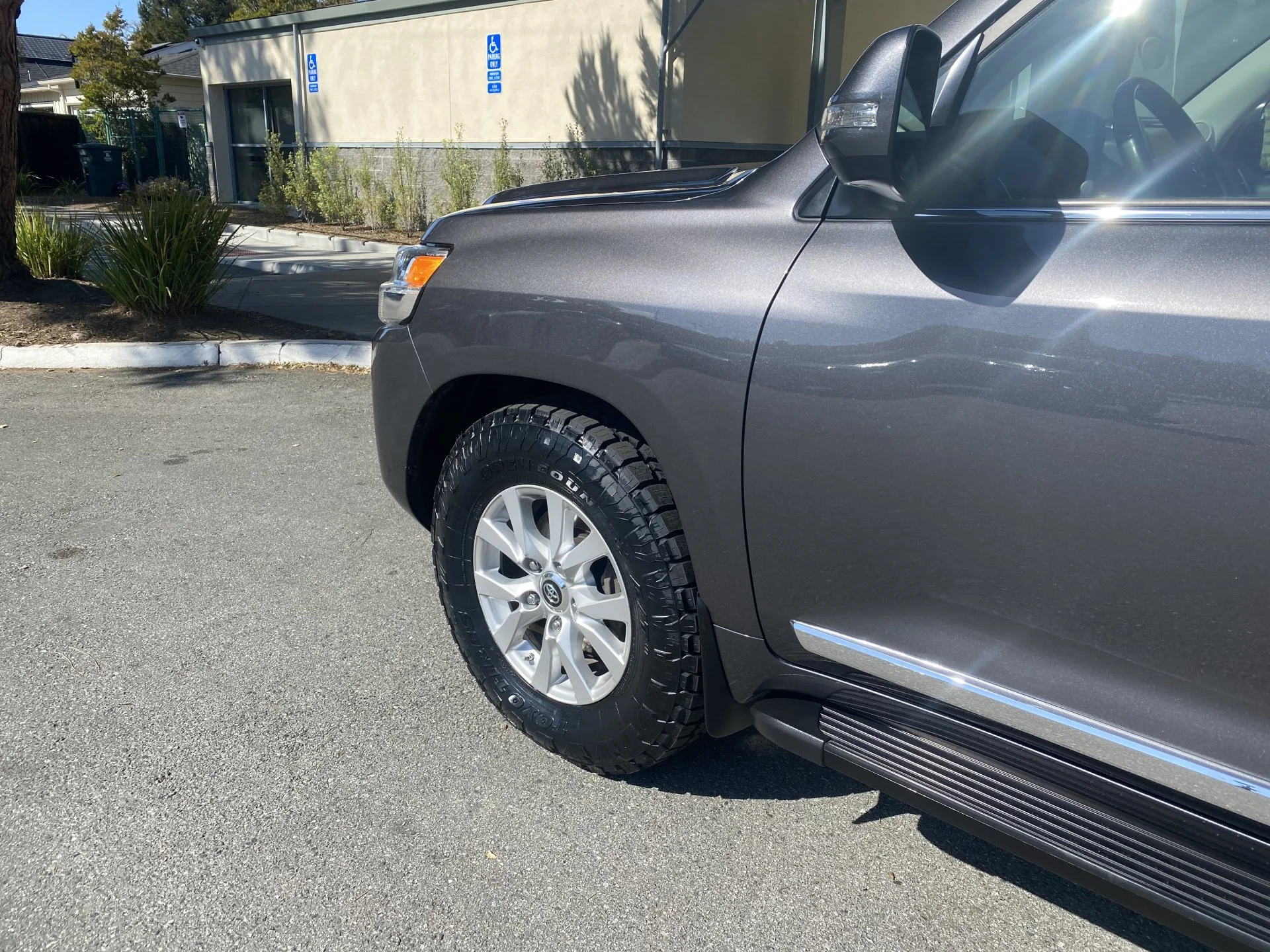

First up, tires. I went with the Toyo Open Country AT3 275/70/18 (E rated) on stock wheels, running at 41 PSI for daily driving. I also considered the KO2s, but I was concerned about some comments about road noise after the tread had worn down a bit.
I was also interested in moving down to 17s, but I was already over budget on the build and figured I could run with the Toyos for a few years, then swap out the wheels later if desired. One disadvantage with sticking with the 18s was that Toyo didn't offer a C rated tire in a large size. I was concerned that going to an E rated tire would be overkill for my use case, and introduce unnecessary stiffness in the ride.
There are two different models:
  • 355510 - Black Side Wall - these are 33.2" and manufactured in the USA. These are what I went with, go 🇺🇸!
  • 355520 - Outlined White Letters - these are 33.4” and manufactured in Japan.
Observations using stock suspension:
  • The ride is definitely stiffer, but not too much. I wouldn’t want it any stiffer, however.
  • The truck corners better, most likely due to the stronger sidewall.
  • The tires DO rub when in reverse at full lock. The fit is very tight, and I’m glad I didn’t get the slightly larger version.
  • No problems fitting in the spare location.
  • There is some slight hum on the road, but you really have to listen for it. I was expecting much worse and was pleasantly surprised. With the stereo on, no problems at all.
  • The truck feels a bit more sluggish, but that’s understandable given the added rotational weight.
  • Some have commented that 275 tires on a Land Cruiser look too skinny, but I don’t feel that way at all. That said, I wouldn’t want to go below 275.
  • I’ve lost around 1-2 MPG, but this is using the Land Cruiser's electronics and I haven’t calculated for the larger diameter or done a manual milage test.
  • I’m traveling around 2 MPH faster than what the speedometer says at around 65 MPH, clocked using the Waze app and using roadside radar speed signs.
  • Tires look great.
Based on the tread wear to date (around 10K miles), I don't think I'm getting 50K out of these tires. 30K to 40K is more likely.
Here are some pics before lifting the truck, with the stock suspension at 35 PSI (what Discount Tire set it to initially):

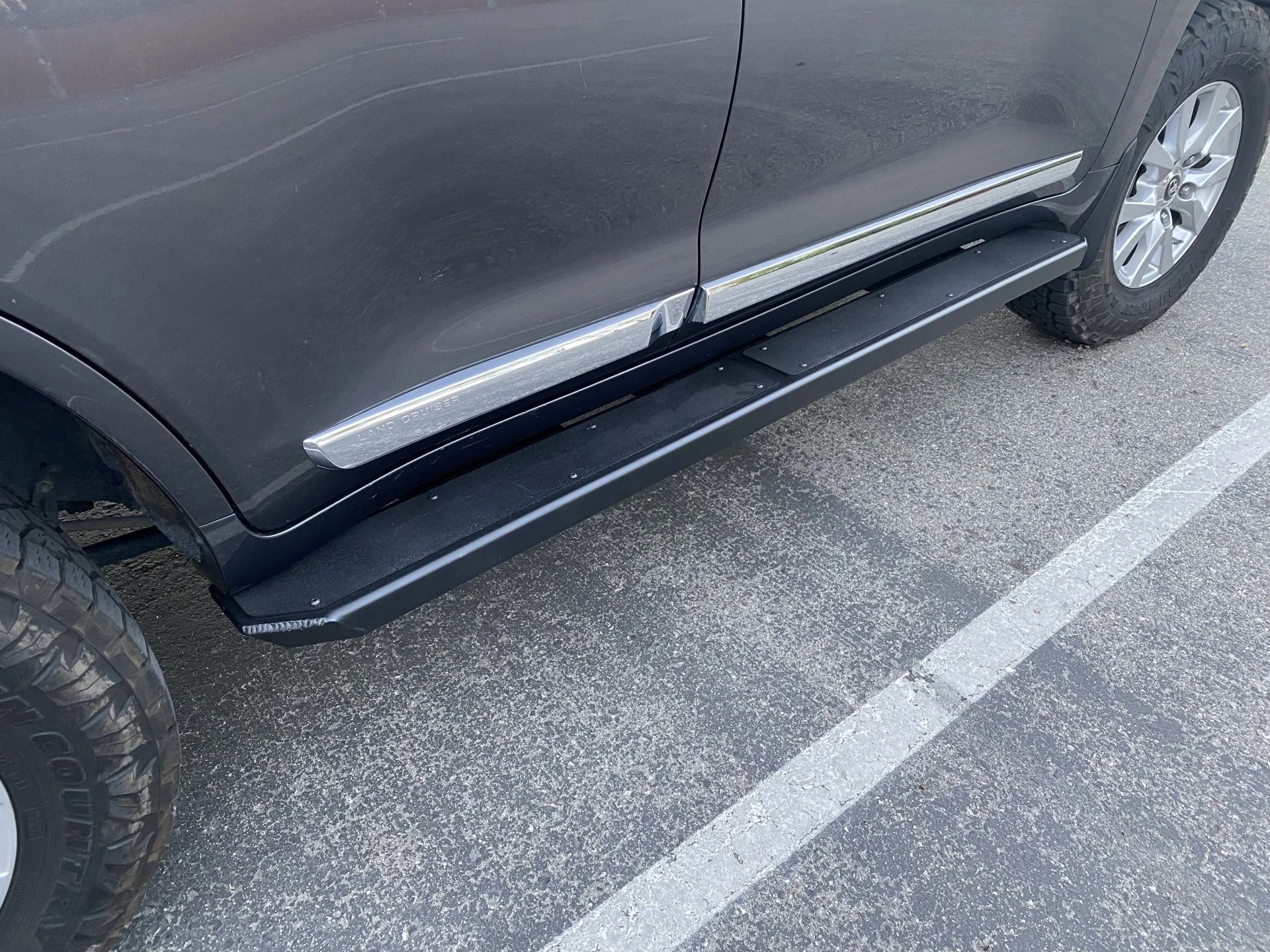

I do not anticipate needing full armor for the next five years or so, as I won't be doing anything technical with the wife and kids. But in the odd chance that I go rock high, I did want a bit more protection, so I went with Dissent sliders.
I also looked at BudBuilt, SLEE, and a few others, but in the end, I went with Dissent for the following reasons:
  • They're in NorCal, so it was easy to pick up.
  • They have a solid reputation and product line.
  • They had the most "OEM" look, and I didn't care for details such as diamond plates, bars, steps with holes in them, etc. Also, I'm in the snow a lot and didn't want slippery rounded bars on the steps as I'm always grabbing skis/boards from the top of the car. The Dissents are relatively square.
  • Most importantly, Ben was super helpful on the phone and even offered advice on other areas of my build. SOLD!
It did take 4 or 5 months for the order to be ready, so order early if you want them by summer.
Two great things happened when I picked up the sliders... First, several guys jumped into action and brought me extra cardboard to protect the inside of my LC, and they were also gracious enough to give me a quick tour of the shop and some of the vehicles they were working on. While I'm not in a big hurry to add metal bumpers, I sure wanted them by the time I left - they make great stuff.
I had the shop install these, so I don't have many insights there, but happy to answer any questions, send more photos, etc.
One final note... I was surprised by how flimsy the OEM sliders were once I took them off. They weighed almost nothing.

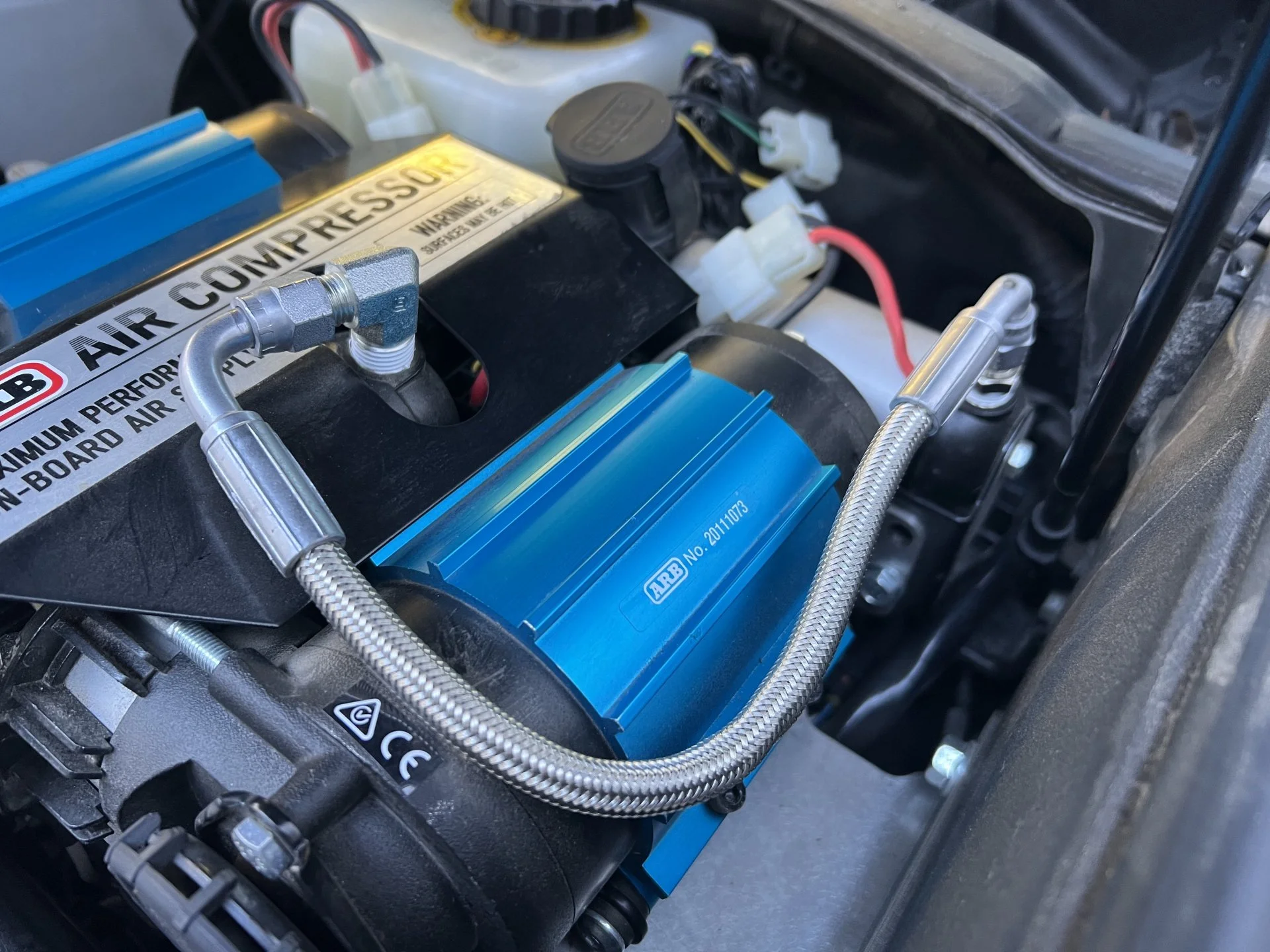

To air down/up I added an ARB Twin Compressor under the hood using the SLEE tray. I also installed the Manifold Kit, as the guys from SLEE stated that the coiled air hose could overheat without it. I also added a dust cover. Installation of this was pretty straightforward, but there were a few lessons learned from experience and posts in this forum:
  • No matter what I tried, I couldn't keep the compressor from colliding with the fuse box latches, so I had to use a Dremel tool to cut some of the plastic off.
  • There was no way to make the air hose bend like the images that SLEE provided until I saw this video that explains how to modify the hose.
  • I couldn't find a post that described a good way to mount the switch under the hood, so I had the shop run the wires through the firewall and mount the switch on the interior. A post that occurred after my installation covers some options. If you are not running lockers, I would place the switch under the hood to avoid wiring hassles.
  • ARB's switch doesn't fit in the interior switch panel without cutting. If you mount the switch internally, here's an OEM-style switch.
The compressor works great, and I use it to air up/down, keep the PSI constant in the tires, and air up and set tubeless mountain biking tires at the trailhead.

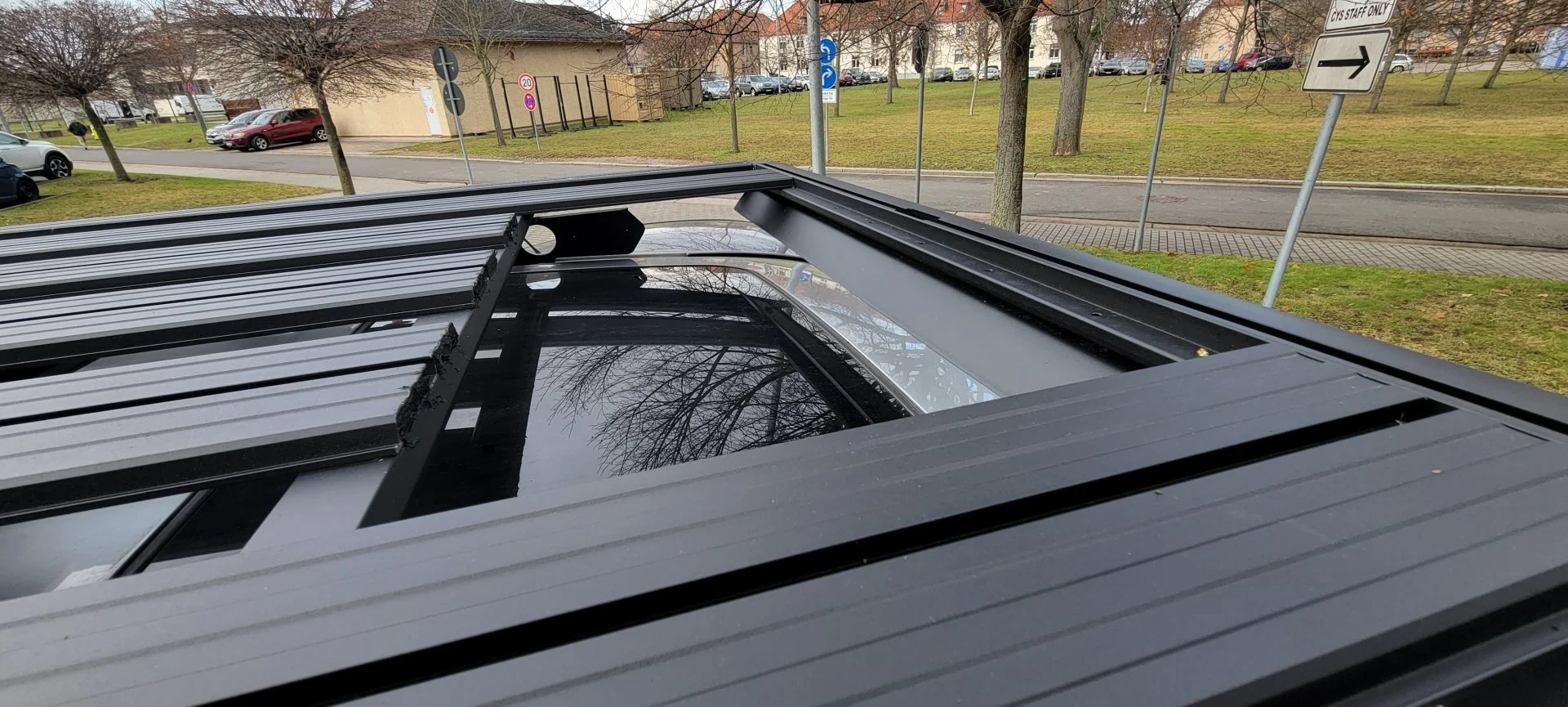

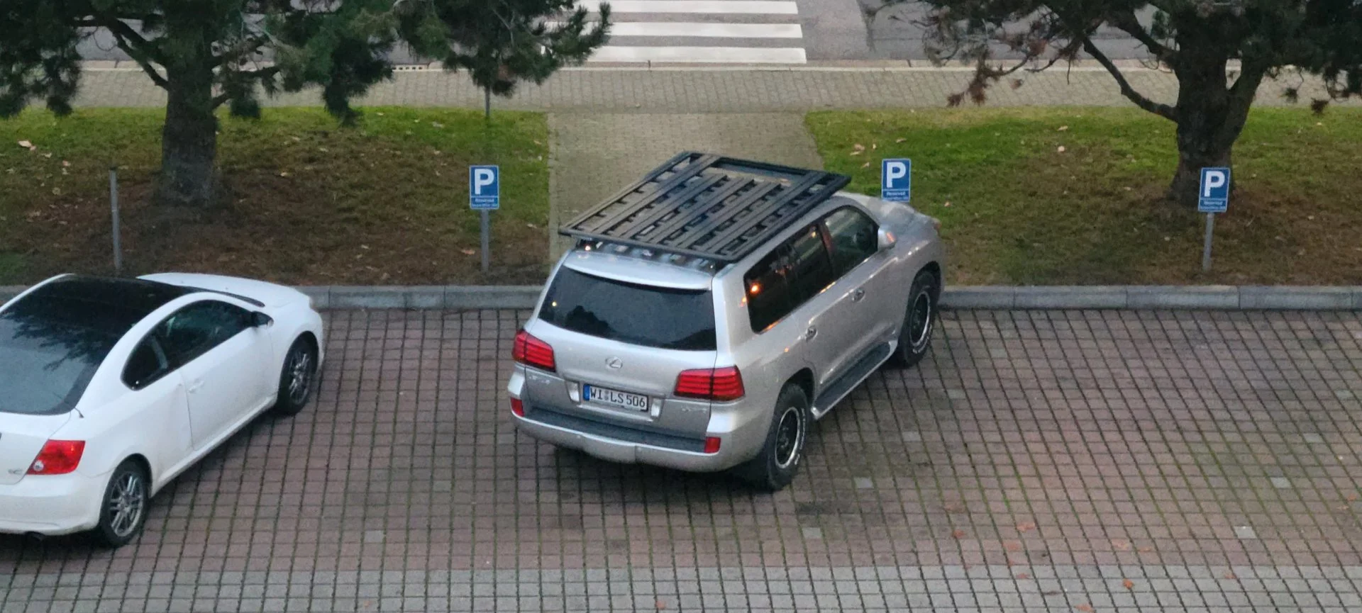

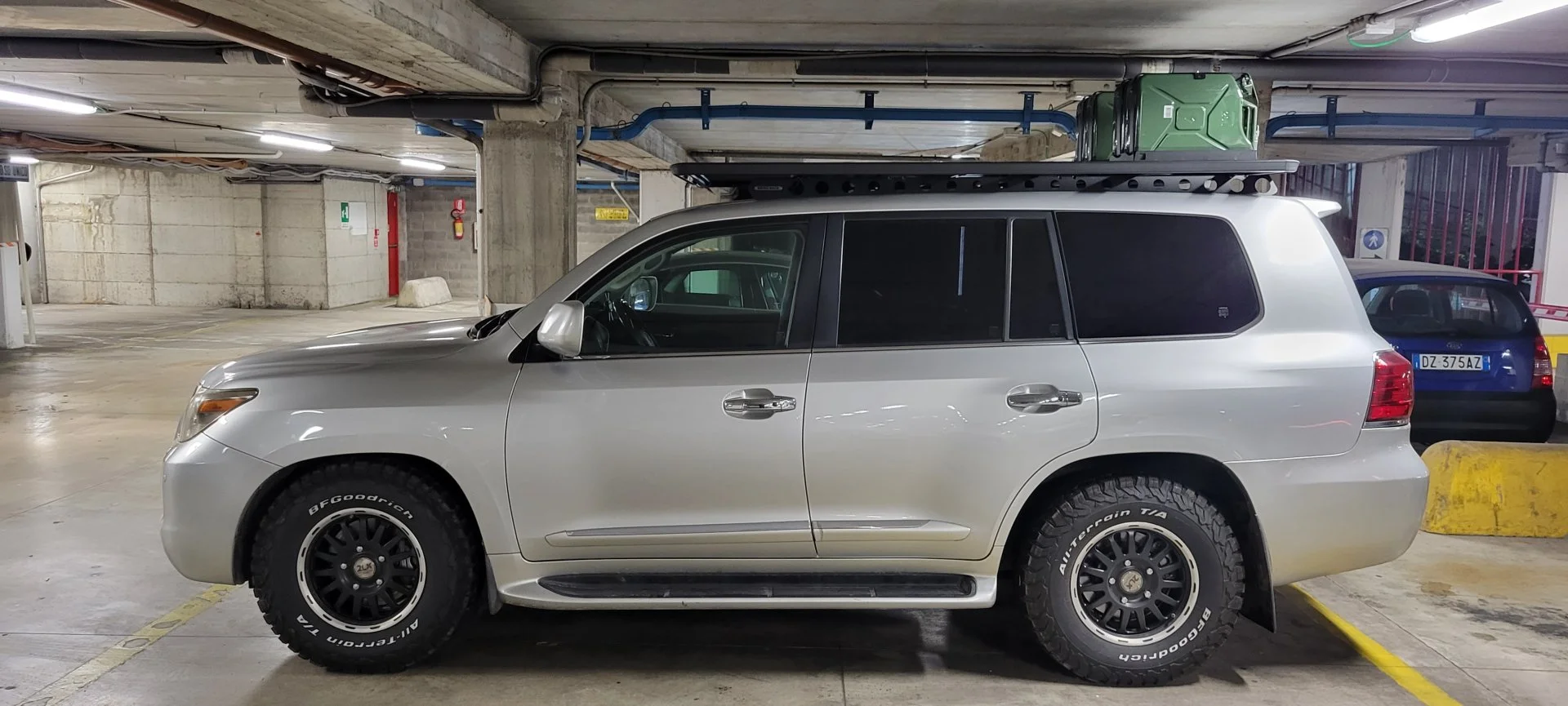

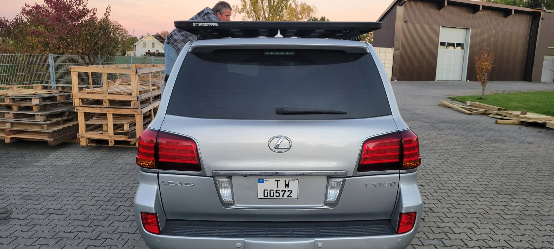

So take this with a grain of salt as I am still waiting to have my explorer installed, but you can solve a lot of those problems with the James Baroud if you run a larger platform. I bought the backbone supports for the LX570 but a Defender 110 platform which is much larger. I am having the Explorer RTT, the Falcon 270, and the shower awning installed on mine with a few other accessories on the 25th of this month so I can let you know how that goes if your interested. I am also going go to run the tent backwards on my roof rack, which I know sounds strange, but with the latches where they are and where the doors are, it just made more sense that way for me.
A couple thoughts, you will run into the same issues with the front runner as the rhino rack unless you run a larger platform. IMHO, the front runner is less than ideal anyway because the floor of the James Baroud is completely flat and the edges are raised on the side of the front runner requiring you to raise the tent off the surface of the platform anyway if you wanted to run the front runner.
Here are some pictures to show you where I am headed with mine. Let me know if you have any questions.

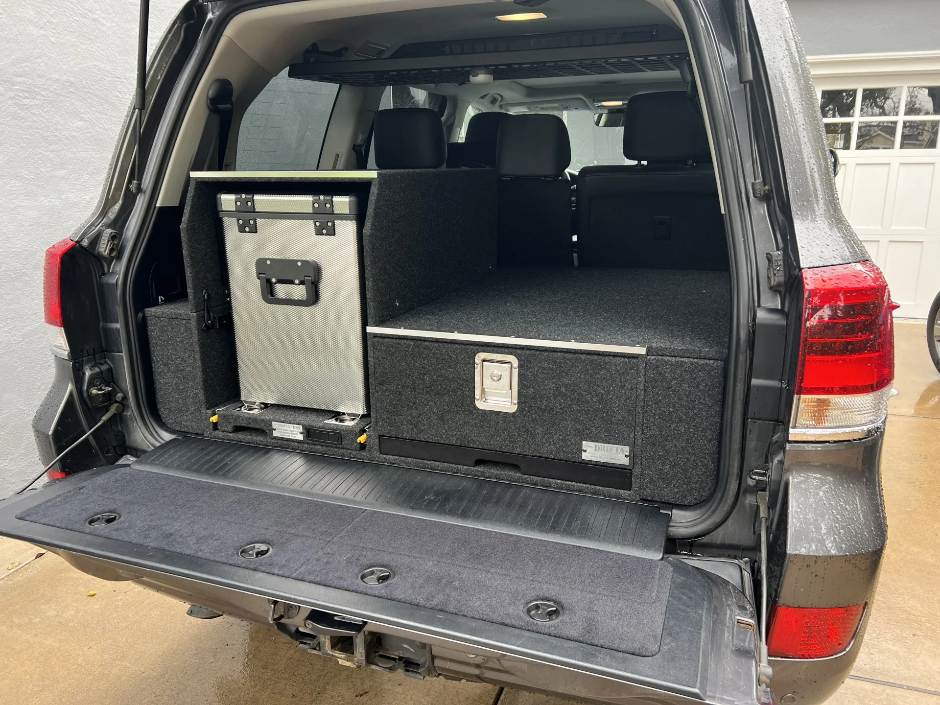

One of the build items I was most excited about was the drawer system. The requirements were:
  • A low slide fridge, as my wife is only 5'4" and she needs to peer into and access the fridge
  • The flexibility to quickly convert from a camping configuration to a daily driving configuration
  • Efficient use of space
  • Affordable
  • Good design and aesthetics
I looked at:
  • ARB Outback
  • Landshark
  • Goose Gear
  • Air Down Gear Up
  • Trekboxx
  • Drifta
My top choice was the Trekboxx, and having seen it in person, I can attest that it is a kick-ass system. But, unfortunately, it was more than I could afford.

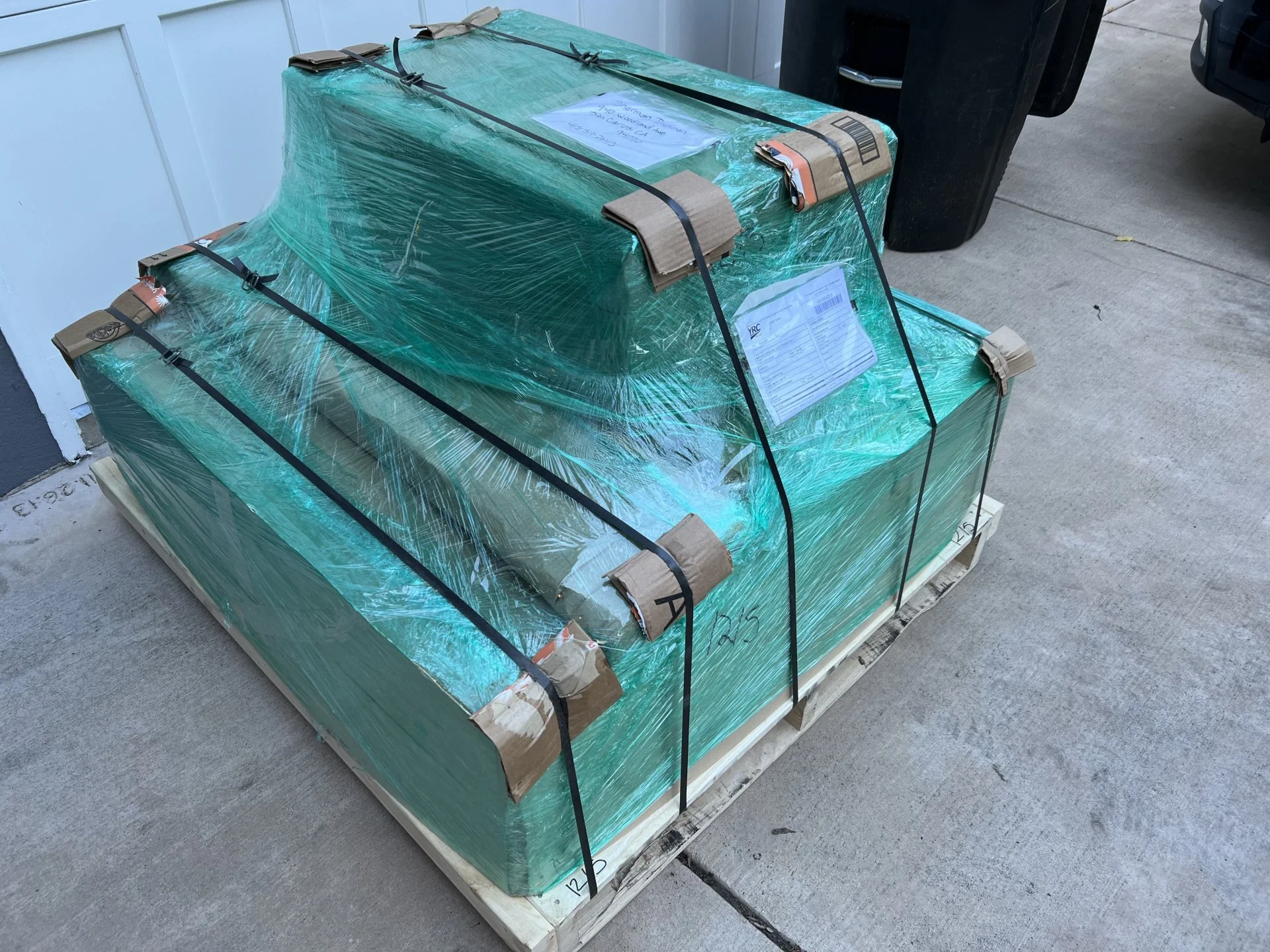

So I went with the Drifta Drawer System, as it appeared to check the most boxes for me. The systems are built in Australia, custom-made for your vehicle and fridge size. Mine took about ten months to arrive, and while the prices on the website are in Australian dollars, you'll end up paying about that same amount in USD. I ordered the Drifta Wagon #2 design with a few customizations. They also have a 3-in-1 design if an additional drawer is desired.
The system arrived very well packaged with no damage at all.
Here is the camping configuration:
The fridge slide locks closed and fully extended, and I installed custom flush-mount tie-downs. The fridge surround is a custom fit to your fridge, and it has several round ports in the back for ventilation and power cables. A National Luna Legacy 50's lid will clear the hatch and open fully, which allows you to use two hands to get items out of the fridge.
The drawer is roomy, and the interior dimensions are 39.25 x 20.5 x 7.25h. Instead of using traditional slide hardware that takes up 3/4" on each side, the Drifta drawer slides on Teflon strips, providing more overall storage room. I decided to wait on installing flush tie-downs on top of the drawer until I have some time to put the cases in and measure everything.
Beneath the drawer is a slide-out table that can be used as a small workspace (as shown), or it can be removed entirely and set up as a camp table using the folding legs beneath it. I requested a customization to have the table located below the drawer instead of above it, as this is a more comfortable height for my wife, who is 5'4".
The side compartments can be accessed by pulling off the top panels. They rest on three removable shelf brackets, which is not the best design, and I think the style of hinges that Trexboxx uses works better.
For the daily driver configuration, the fridge surround can be removed, and you can order an additional drawer box (secured with bolts) and a top panel to create a flat platform.
I'm very impressed with the system. It's exceptionally well built, there are no squeaks or rattles as you drive, and it looks great.
If you have any questions, feel free to reach out.

  • National Luna 52L
  • National Luna 50L Dual Zone
I checked out the Dometic at REI, and I wasn't impressed with the build quality; it felt somewhat cheap, and I wouldn't say I liked how the lid latched. The ARB Elements was a strong contender and had great reviews.
In the end, I went with the National Luna (from Equipt Expedition Outfitters) due to their reputation and the fact that the lid could open from the side or front. Since I didn't have the drawer system before ordering, I wanted the flexibility to mount the lid both ways to make sure it wouldn't collide with the hatch. Also, the National Luna was about $200 cheaper than the ARB Elements.
The 52L and the 50L are both the same size, but the 50L is dual-zone, with a 40L main and a 10L freezer (which can also be used as a fridge). The 2L loss is due to the separator between the two compartments. The freezer stores ice cream bars for the kids and ice for "Daddy's Juice."
Both models have less insulation than the larger 55L and up models, hence the "Weekender" branding. While the fridge will need to run longer to keep things cool, it has one of the smallest volume/external size ratios of all the fridges I looked at (the worst was the Dometic 55IM).
Build quality is excellent, and the fridge is very quiet when running. It doesn't have the tech found in other fridges (like an iOS app, Bluetooth, etc.), but it's solid and gets the job done.
For power, the initial plan was to implement a dual battery system with hookups mounted in the 3rd-row seat release panels, like the following picture:
I never thought about running a larger rack, that's a great idea!
If only solving for the rack covering the satellite fin, I could possibly remove the center slat or terminate it at the last cross beams, similar to how you've done this for your sunroof.
