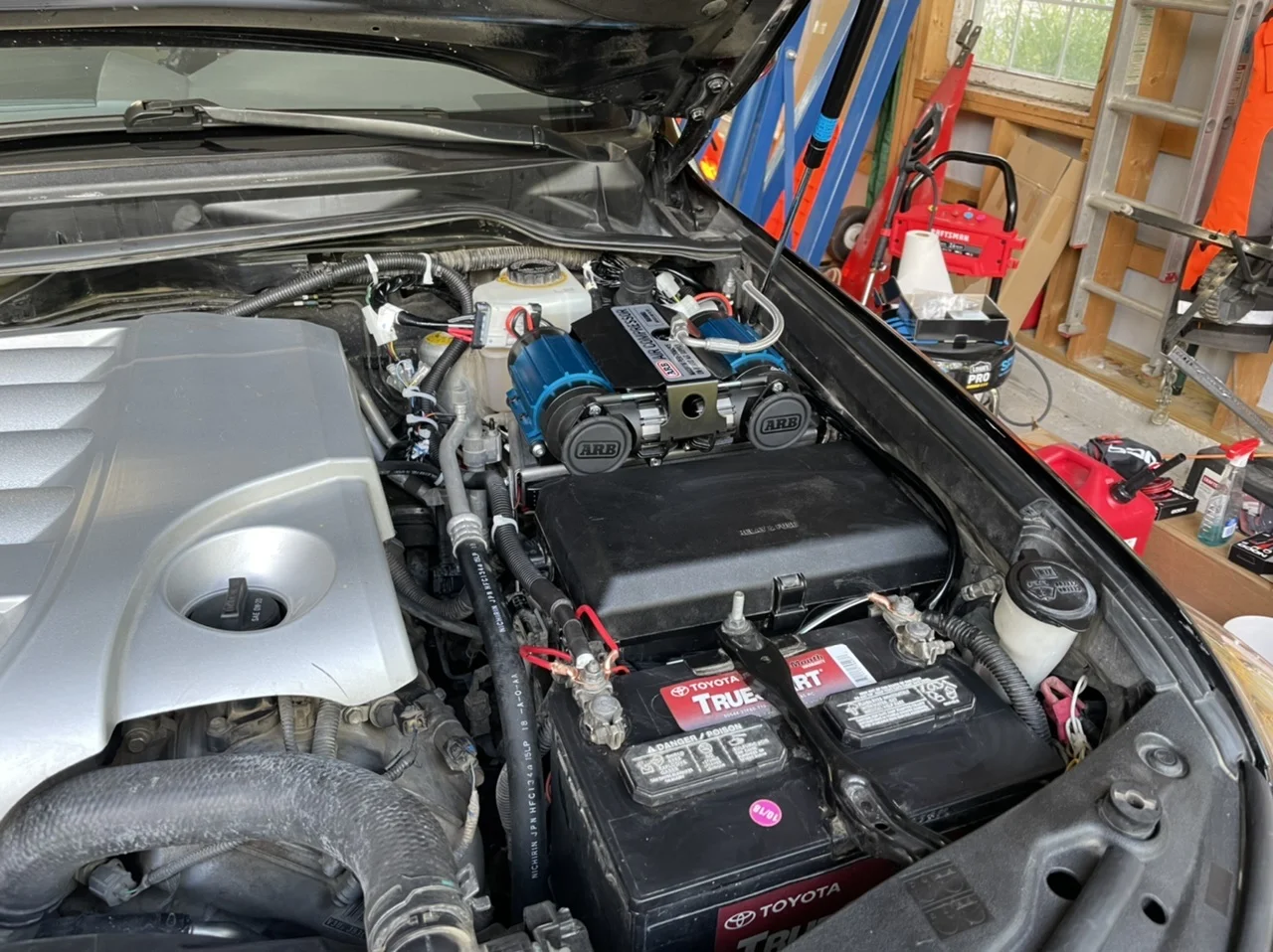

Will reach out to SLEE tomorrow but having clearance issues. I’ve tried sliding the compressor around and tried different mounting holes. But can’t seem to clear the fuse box latch
picture on line seem to show the mount and bracket mount higher almost hover above latch. But if you look to the right the hole where it mounts to the body are lined up in my picture so can’t make the bracket move higher….
I just did this install two days ago and I had the same issue as yourself. My solution was to clip off the top part of the fuse box latch/hinge to give the filter housing the clearance it needed. The second issue I had was the routing of the braided hose to the manifold, I ended up pushing the manifold connection towards the firewall and then ran the hose around the backside of the quick connect inboard to the compressor. When I routed the house as shown in the Slee pics it would kink the hose more than I would like it to. I am wiring up the switch in the cab tomorrow when it arrives, I'll check for leaks and other issues at that time.
Also, make sure you wrap the wires coming off of the air pump connectors in electrical tape as well as the support strap for the compressor where it makes contact as to avoid it rubbing a hole into the wires and causing it to ground out.
Yep, same here on 2018. It's a tight fit. Had to grind down latch a bit.
What year 200s are your trucks? I installed the ARB twin and Slee bracket a couple weeks ago and got it all to fit. The filters just barley clear. I had to rotate on the ends if the braided hose to make it work. There is a thread on here that has a video. Just need a bench vice and channel locks or vice grips. See post #30.

2021, mine definitely has a different style fuse box and latch. My solution was easy and works well.
I took some snips and took the top 1/4-1/2" of it off. Easy peasy.

I heated up the hose ends and got the fitting's to slip in the vice, I won't know if it still holds air until later the evening when I can get the switch wired in and do a leak down test. See last pic for how I altered the fuse box hinge to provide clearance for the filter housing.
I installed some small spacers between the compressor and the mount. That’s worked pretty well. It’s still a tight fit but there’s just enough clearance.
It tweaks my OCD a little but if you just set the air pump bracket crooked the wires clear with plenty of room. Keep everything square and lined up and it will just be a matter of time before it rubs through.
Here is a link to the video on how to alter the braided hose line to change the 90 degree bend. As you can see from the photo, I also have the same fuse box tab issue. The way that I get into the fuse box if needed it taking off the front of the filter, then the filter then the plastic shroud that screws into the compressor housing. I'd rather not modify the fuse tab, but if I have to, I will.

Please excuse the poor lighting, I had to take these in our poorly lit garage assisted with a head lamp lol. I ran the fuses between the battery and fuse box, the harness will lay in there nicely. I wrapped the rest of the harness around the fuse box between it and the fender, it wedges in there perfectly and the remaining excess is in a loop resting underneath the compressor between the air pump relays and the firewall secured with a zip tie to the fuse box leg.
Switch is in, everything works, no leaks, all is well.
