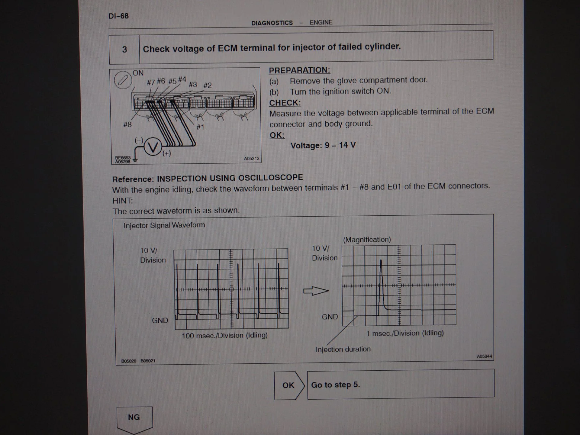

Adding more stuff to your check list. Someone sent this to me today.

I understand you found your problem already.
No need to remove camshaft sensor for checking. Simply disconnect the connector and measure resistance. Resistance specs is in the diagnostic section of the FSM.
