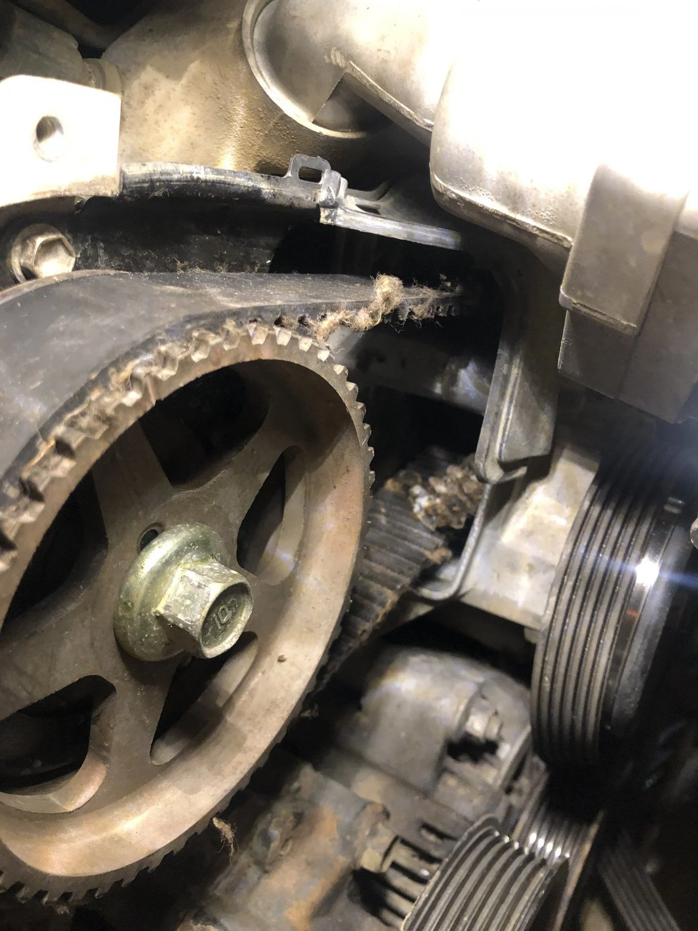

So, as some may know the 500K mile Tiki Cruiser would not start this weekend. Or rather, it started up and almost immediately shut off and then would only crank/no-start. After multiple tests and rabbits holes chased after 6+ hours of reading threads on my mud. I took the off the passenger side timing belt cover and this is what I found....
Yes, that a mouse... or used to be. We had a very cold night Friday into Saturday and I had been driving the car all day. Almost exactly a year ago I did the timing belt and water pump and found that the truck was missing the smaller dust cover. I had heard stories about stuff like this, and thought what are the odds of that happening. I ordered the dust cover but it took forever to ship and I needed the car so I buttoned it up and moved on. I recently kicked the mice out of my garage and now I where they moved too.
Anyways, so here's the question: what should be replaced (or what should I have on hand to replace) in this scenario?
I feel likes there a good chance the belt is fine, but probably best to replace it. Waterpump should be fine right? Could crank/cam position sensor have gotten damaged in this process?
I'm considering ordering just a timing belt from Toyota and to have crank/cam position sensors on hand in case they're damaged and I'll return them if they're un scathed. I think the water pump should be just fine....but maybe I should grab the Aisin kit just in case and really take of advantage of free returns.
isn't that a piece of the belt showing in the middle of the picture? I certainly wouldn't gamble on reusing it even if it isn't snapped. Have you found other damage (chewed wires, etc)?
No lol that a mouse that has been pancaked flat and has a perfect impression of the ribs of the belt on him. Not finished going through everything so I haven't looked at all the wires yet.
Yeah that 'treadmill' is a little too fast for a mouse.
Cam position sensor wire might have been 'gnawed on' too, so you won't really know that until you get the front cover off on the Driver's side to inspect. That would cause a no start condition.

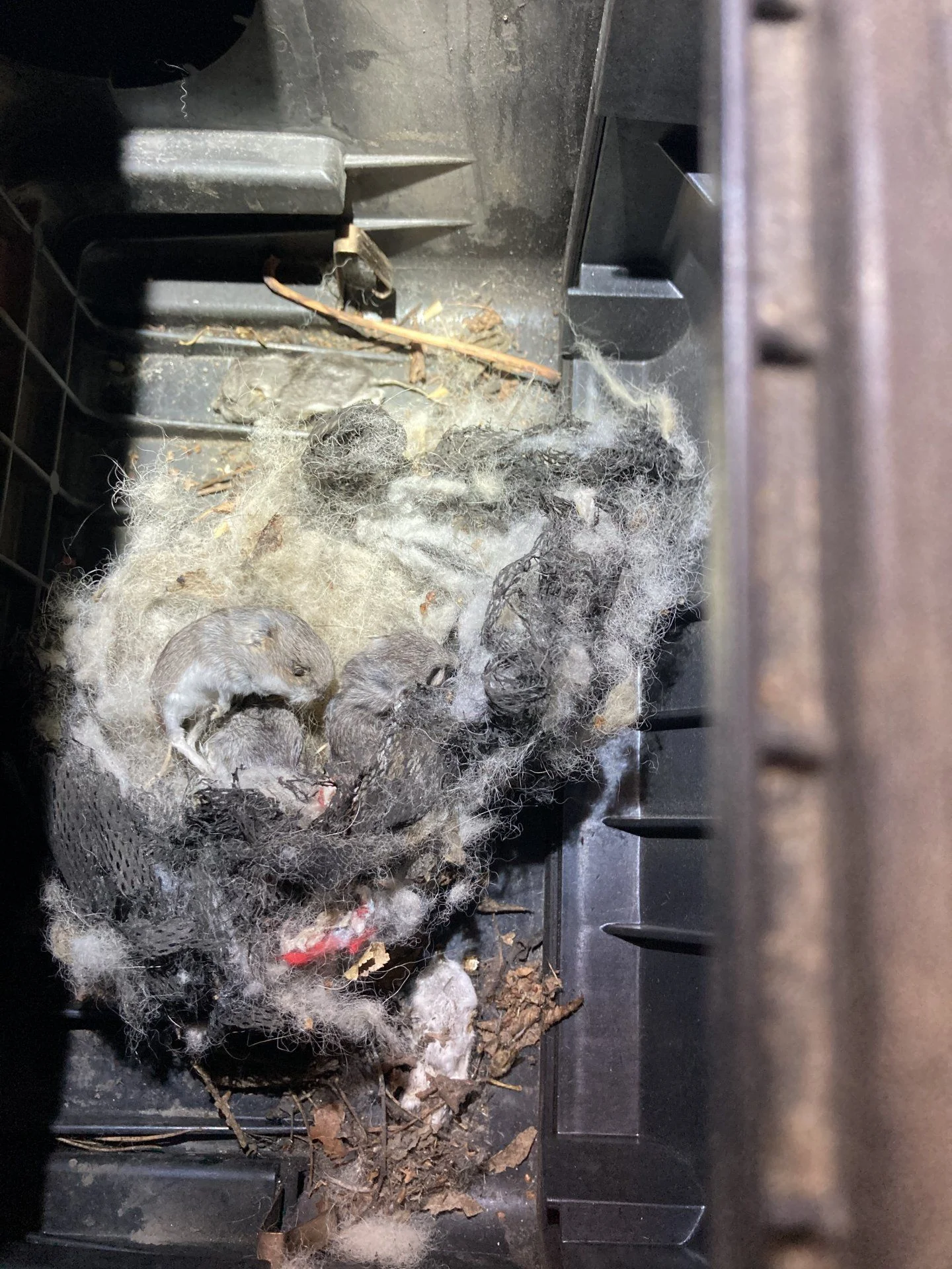

This is what I found in a friend’s Tacoma air box last week. There’s a family of six in there.
Not for long

Spent last night picking mouse bones out the area...very gross. Timing was incredibly messed up, camshaft sensor looks good but the wires is frayed so I'm thinking I'll replace the pigtail.

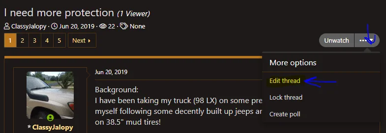

And yes, I totally botched the thread title, it was supposed to say DO NOT and now I can figure out how to change it.
Just use the drop down menu on the top right corner (example below):
