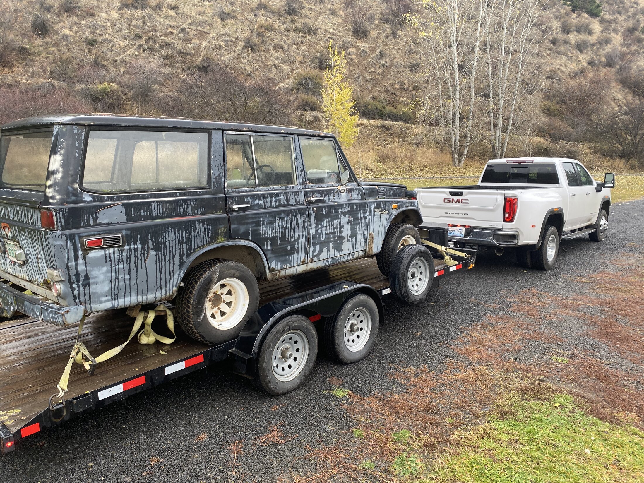

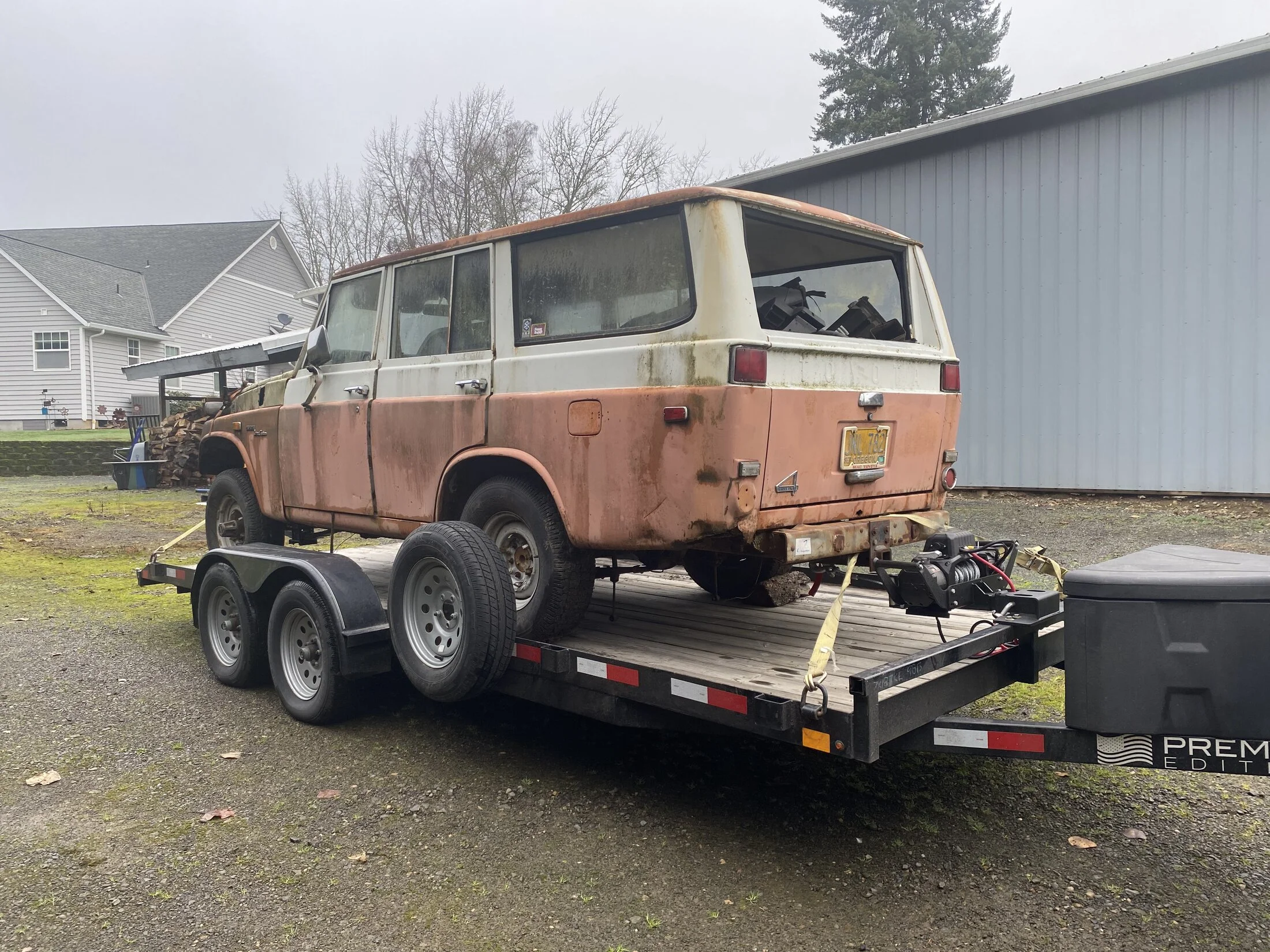

Found this gem in the Nile Valley outside Yakima and there was no question it was coming home. Its a 73 with original F paired to the 3 spd, rust in the usual places and of course we couldn't get it started. Seller towed it out of its hole it had lived in for years and had great faith the brakes still worked bc he towed it down the hill in the background with his pickup.

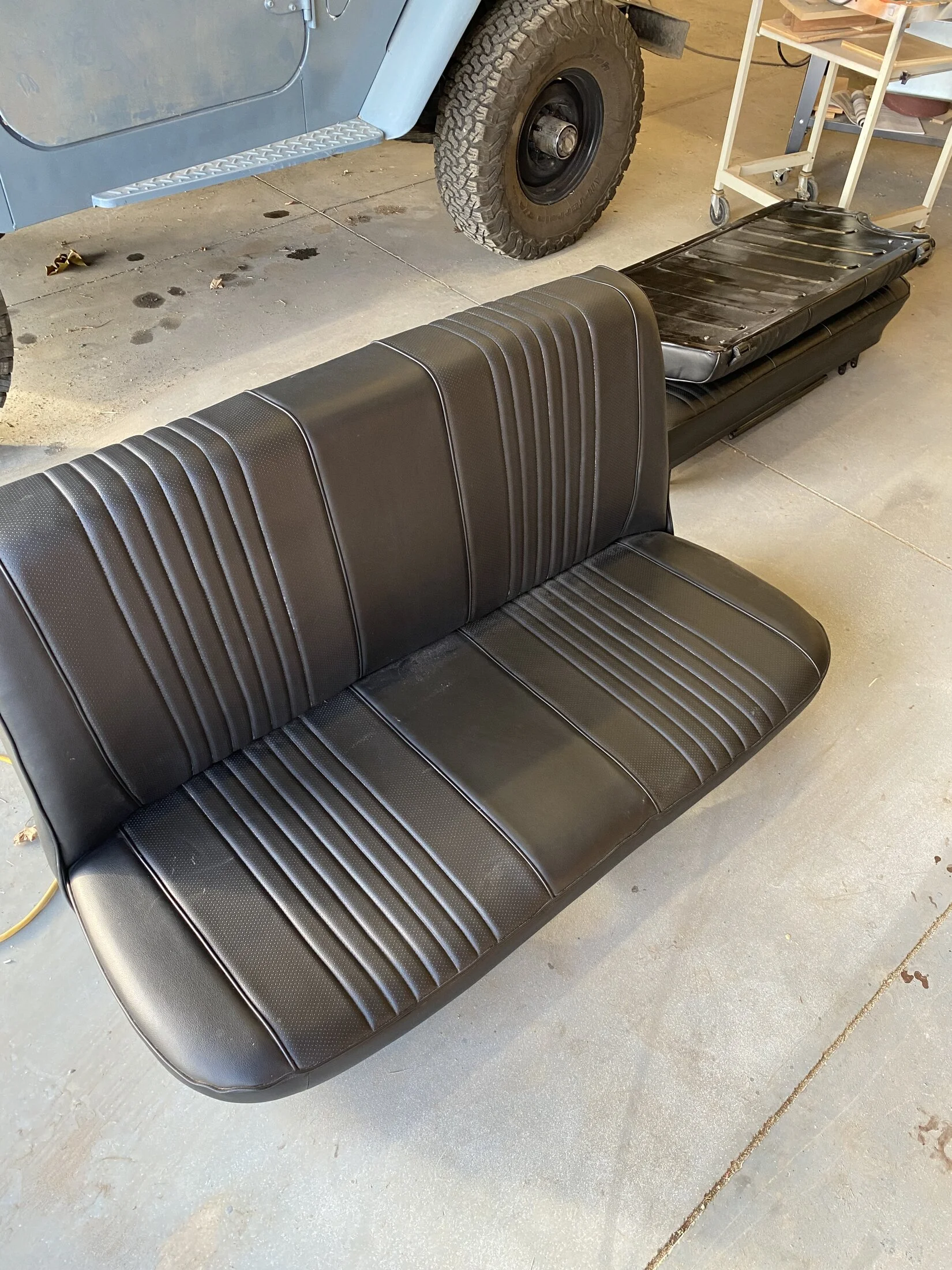

PO had the seats redone and they look great, feel like i have to use the bench now. Milk crate is a solid plan C.

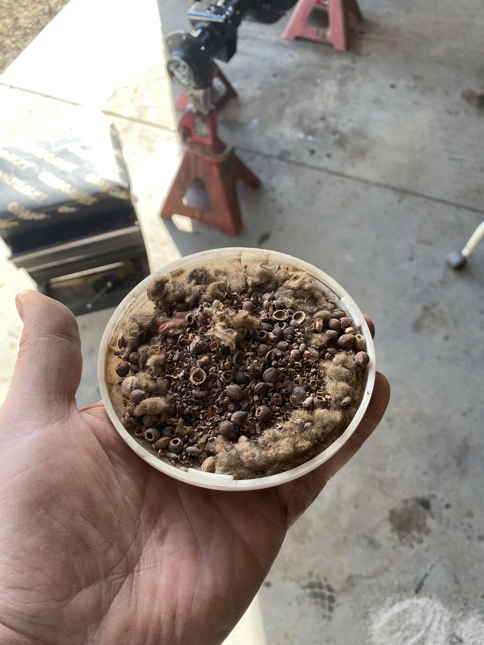

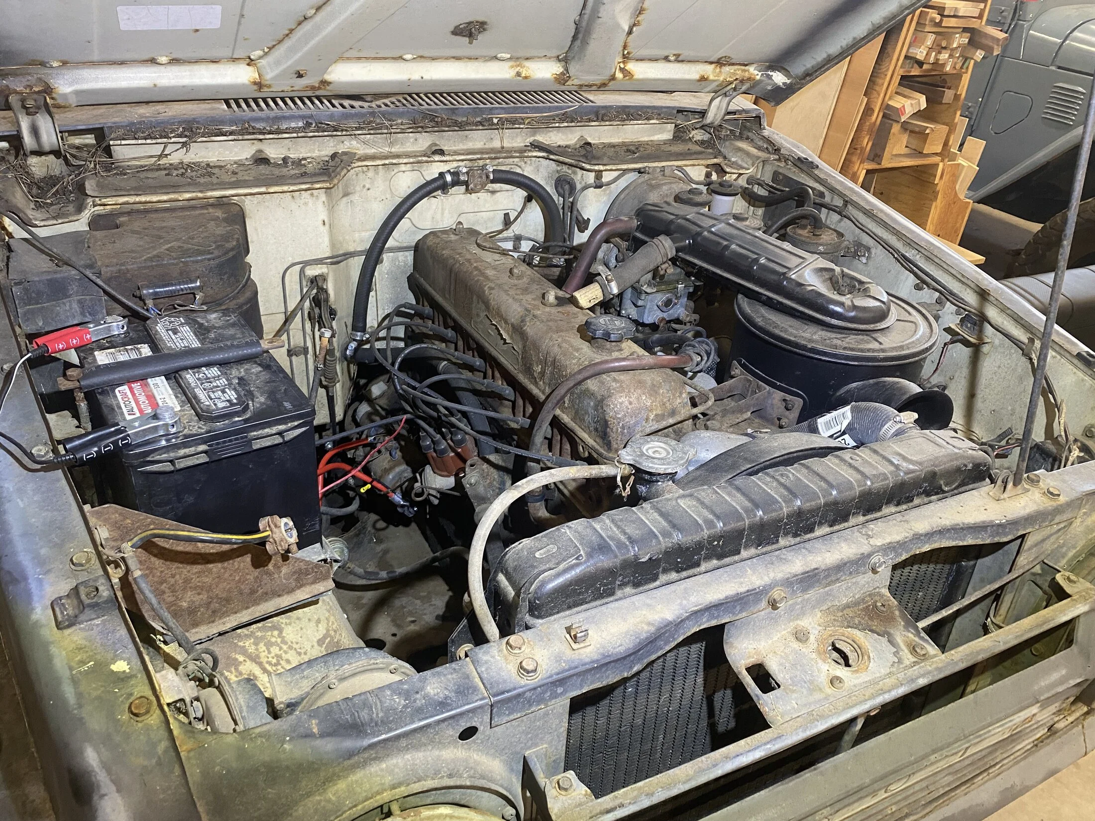

After charging the battery checking the oil etc, we got the 73 running. Blew out a mouse Hilton from the exhaust upon start, drove it a mile or so to pave spun around and made it home, that was about all she had. Sputtering pretty bad. Ran a compression test.

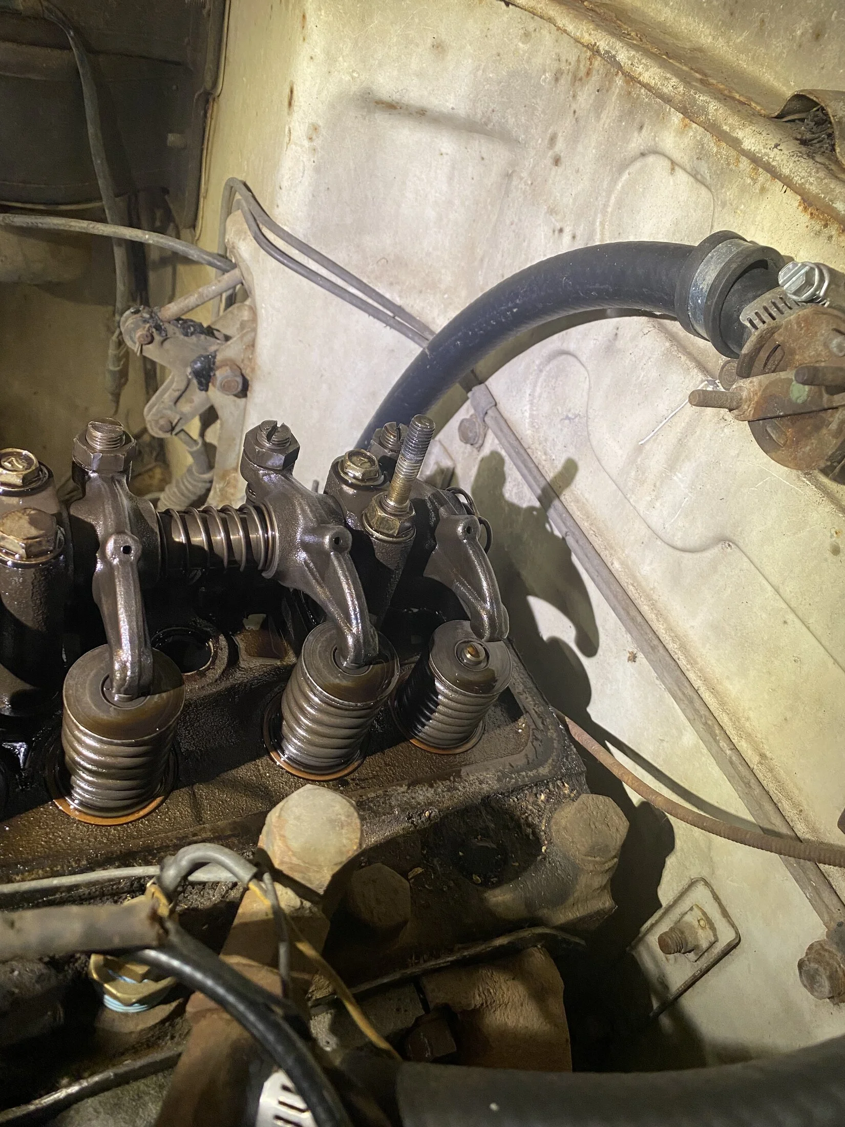

Pulled the valve cover.

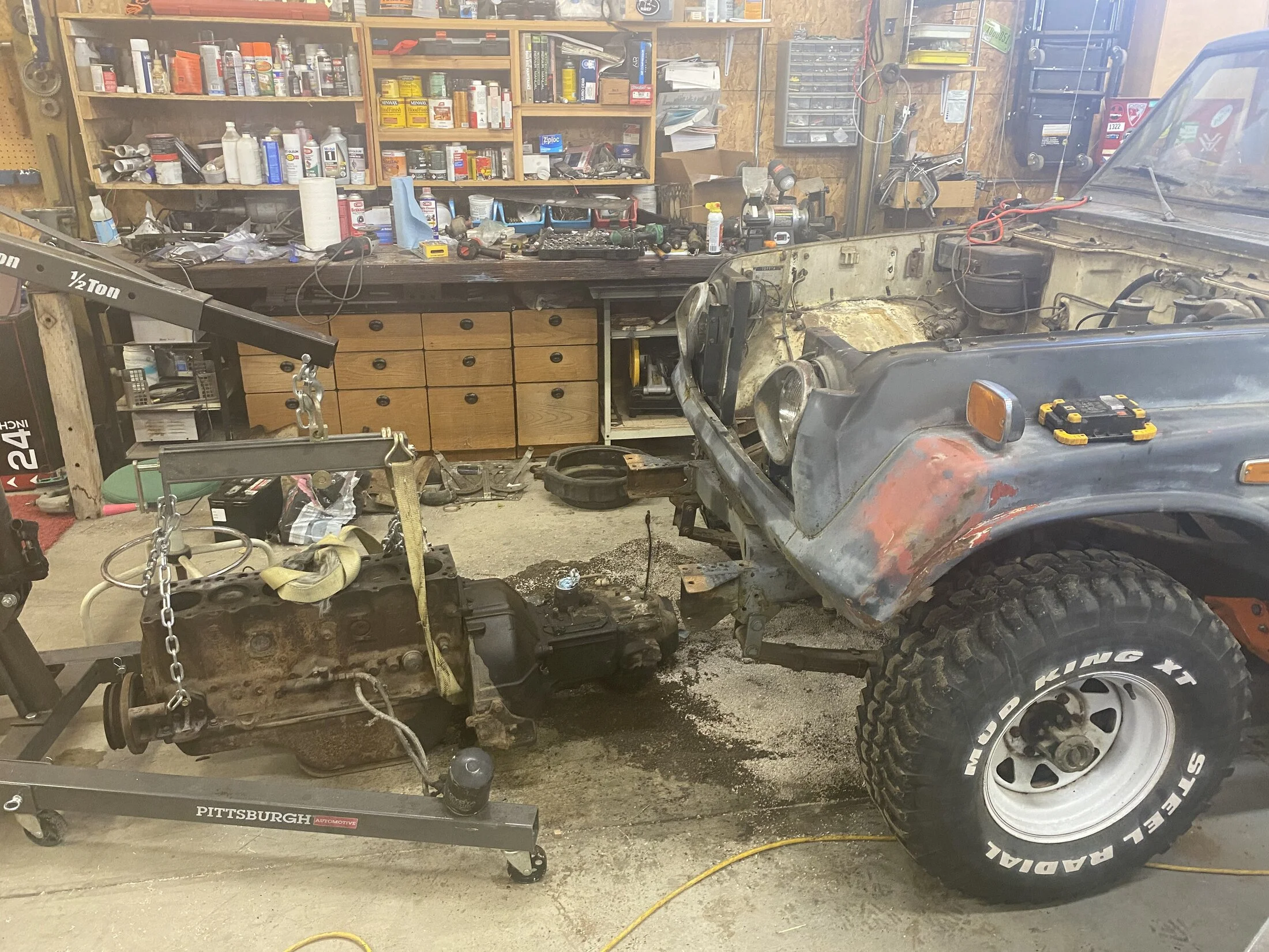

With the motor out of the way, a new axel to go in, and a questionable existing suspension I tore the front apart. Cleaned the frame, and went through the POR15 system to coat as far back as the rear bell housing mount.

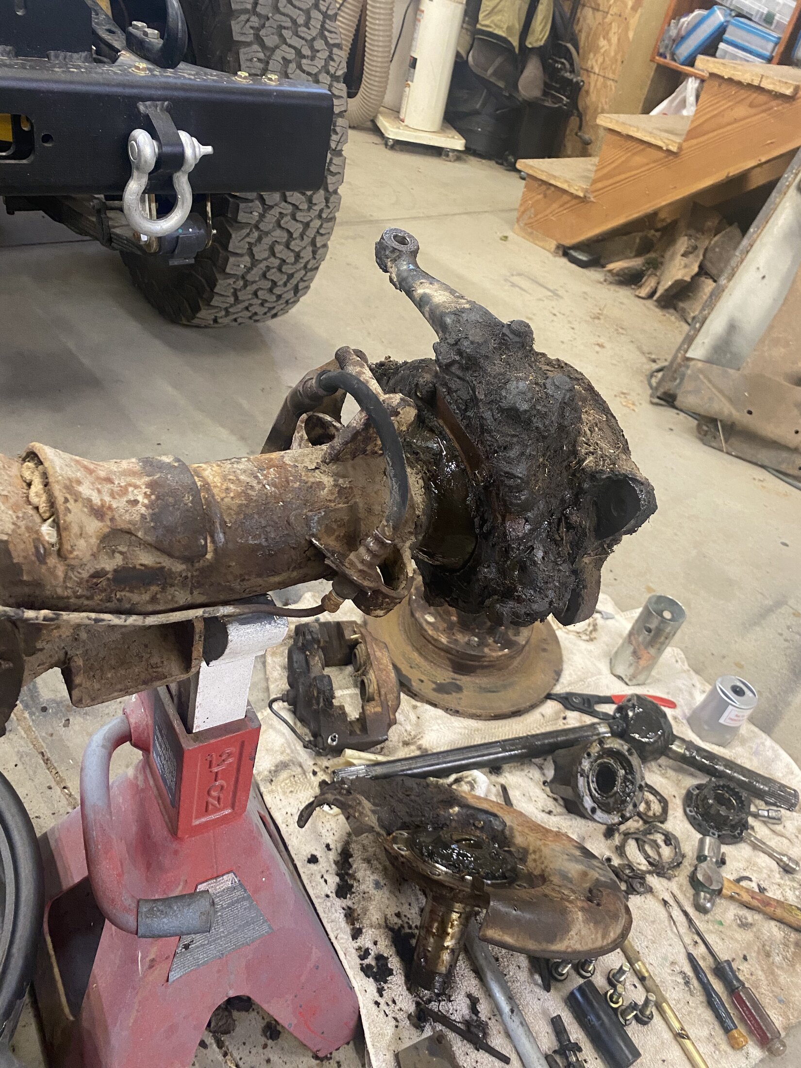

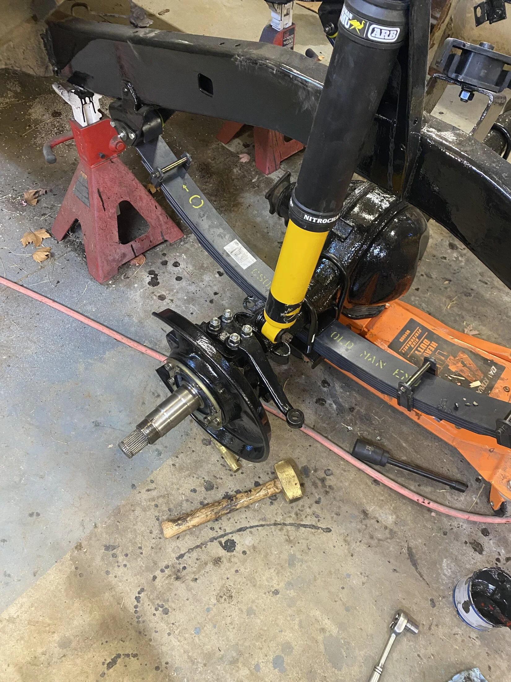

Went through the front knuckles, bearings, seals, etc. just in case, pretty sure they weren't leaking. POR 15, new discs, calipers, suspension, tie rods/ends. Went through the steering box and resealed it. Oil that came out was pretty bad. Seems like I got it back together ok, it turns lock to lock. I'm thinking of the electric power steering, but the price barrier is there. I added a hydraulic kit to the 40 and it works well, maybe I'll go that route. I haven't cracked open the front diff yet, the rear you'll see in the pictures that follow needs a pinion seal at a minimum. My 40 was making a mean sqeak/whine when under acceleration, I'll post those pictures here as I'm currently figuring out how to slap that back together and since they are the same as 55 I'll post them and let you know how I did.

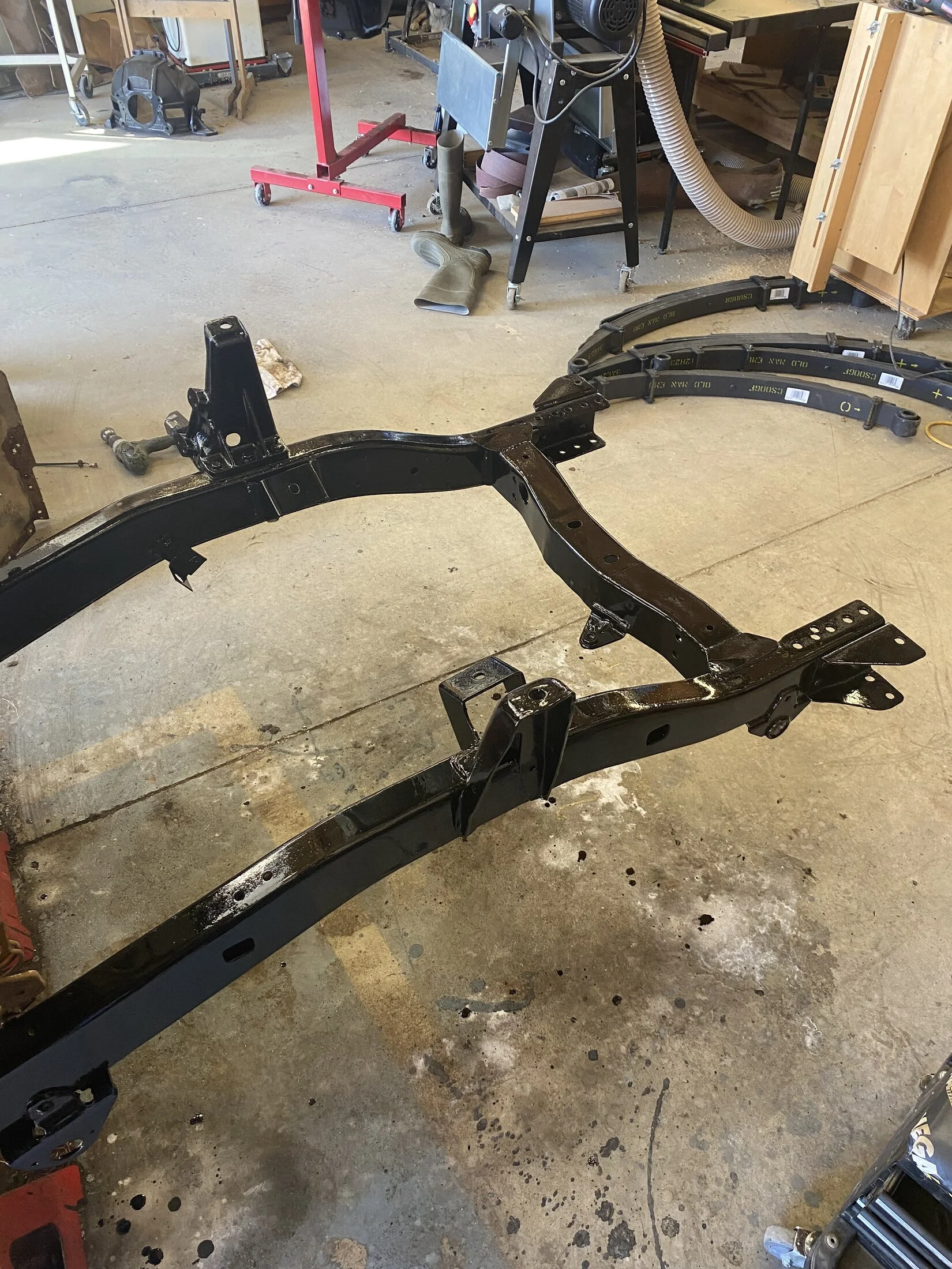

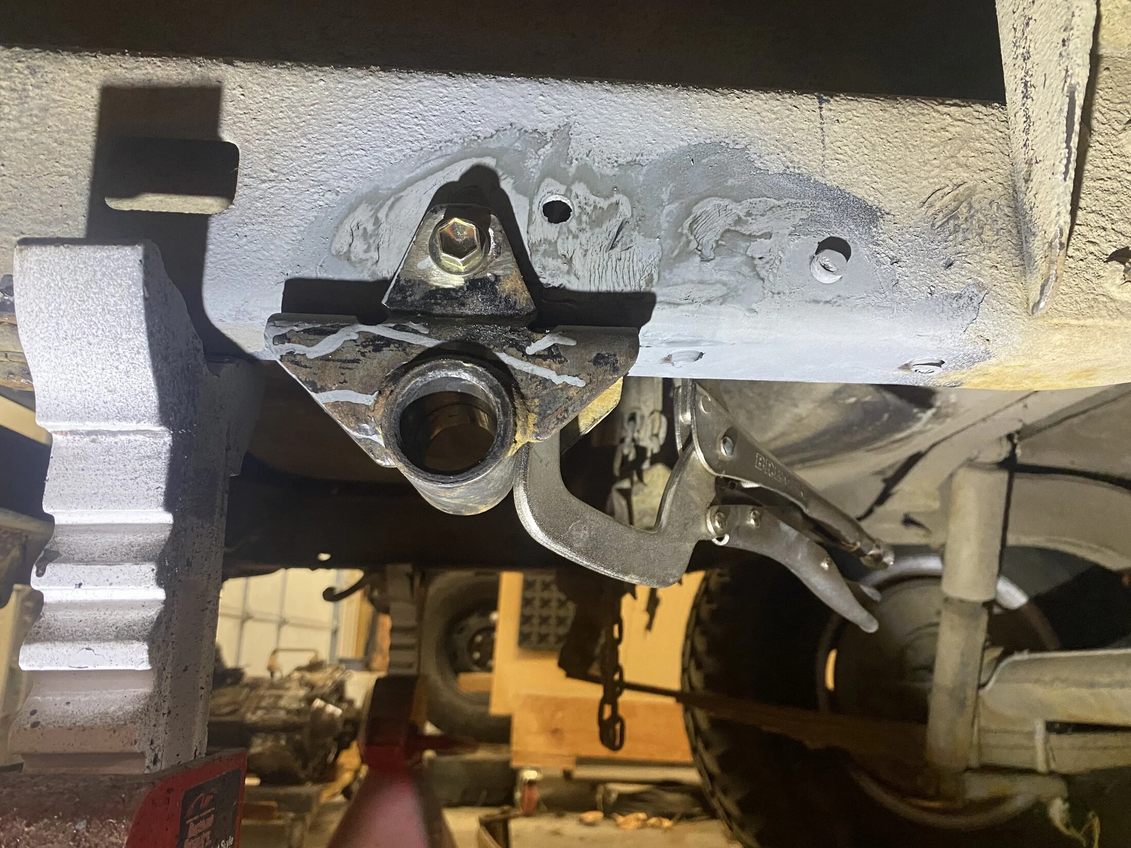

On to the rear suspension. The kit from Cruiser Outfitters gave me pause as I wanted to think through the rear hanger move. Turns out I was overthinking, it was pretty straight forward. I guess I'll see what the feedback is, but I thought it went well. I left the rivet stubs on the frame for reference of where they were for now. The rear hanger is just bolted on with Overland Metric hardware. I'd like to gusset the frame and run a bead of weld around it. I guess I just left it bolted until I made sure it was correct. Weld through primer is sealing it up for now.

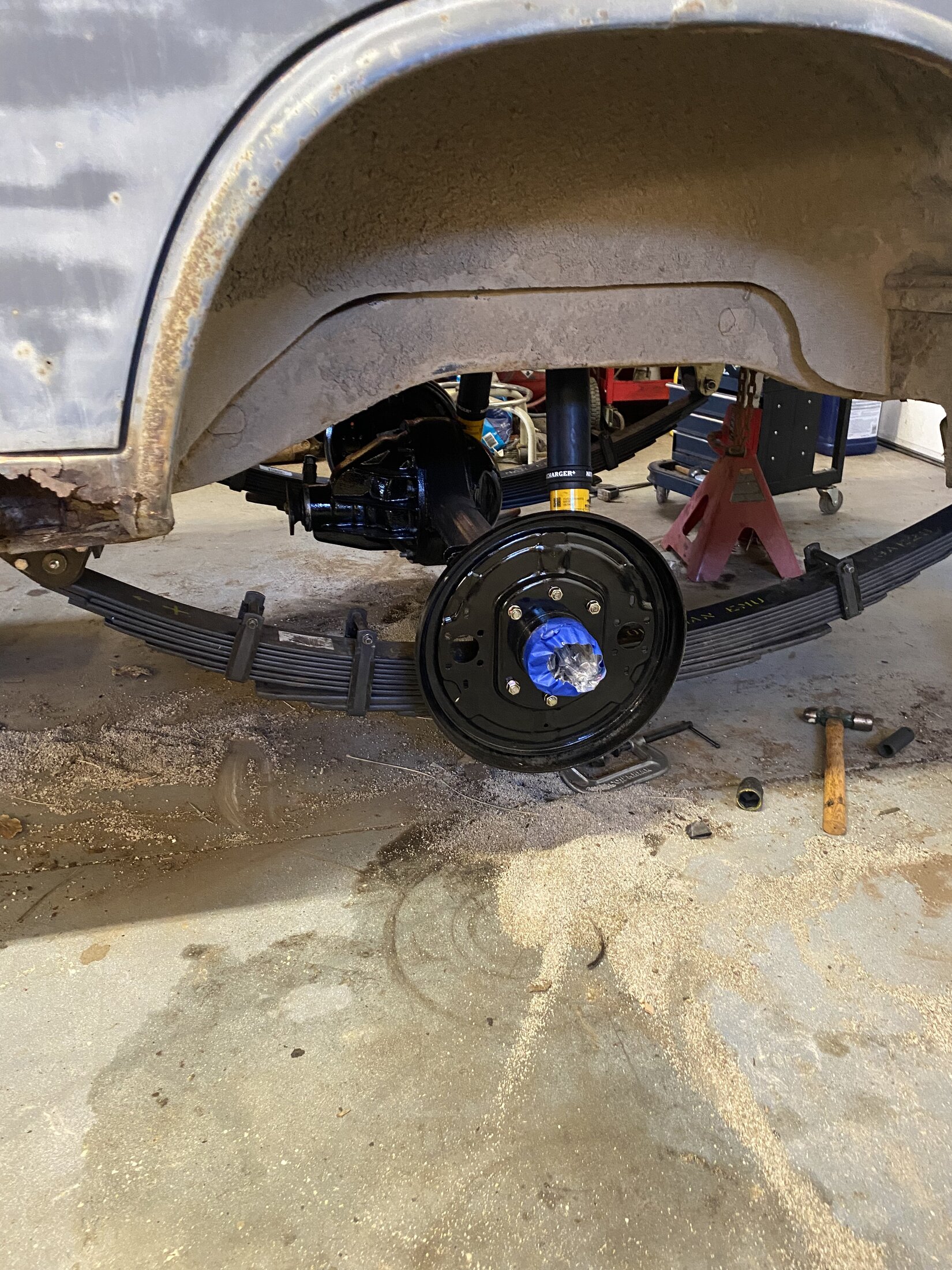

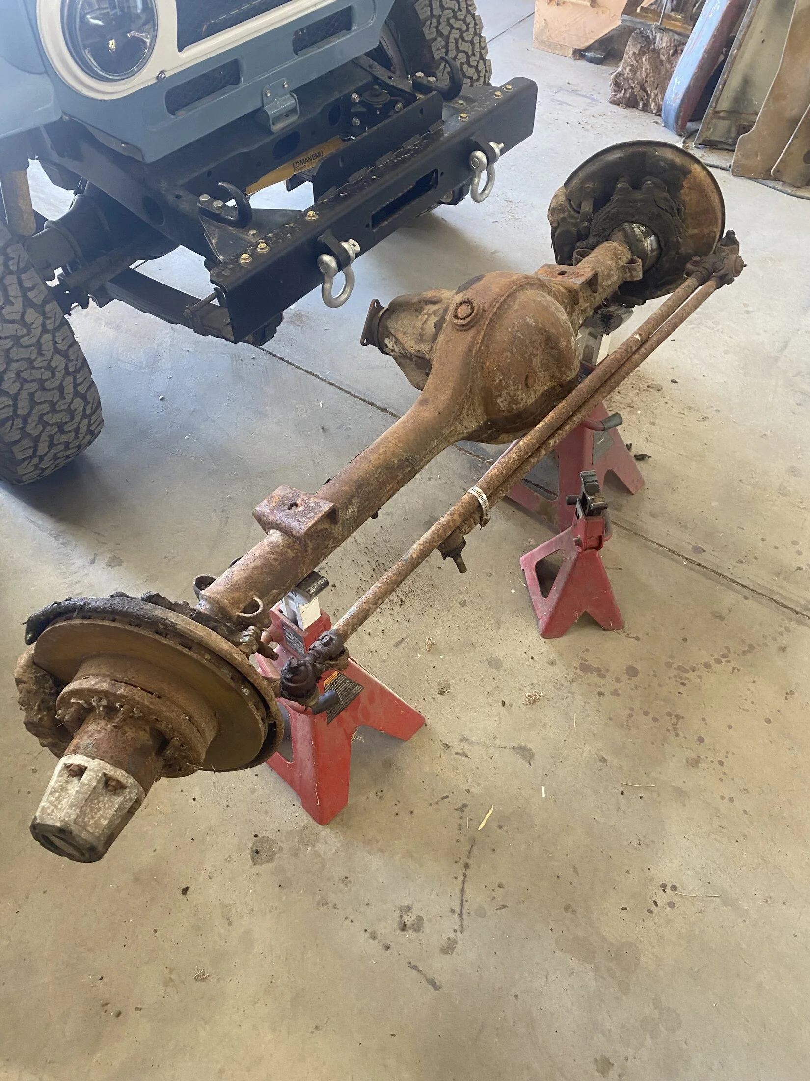

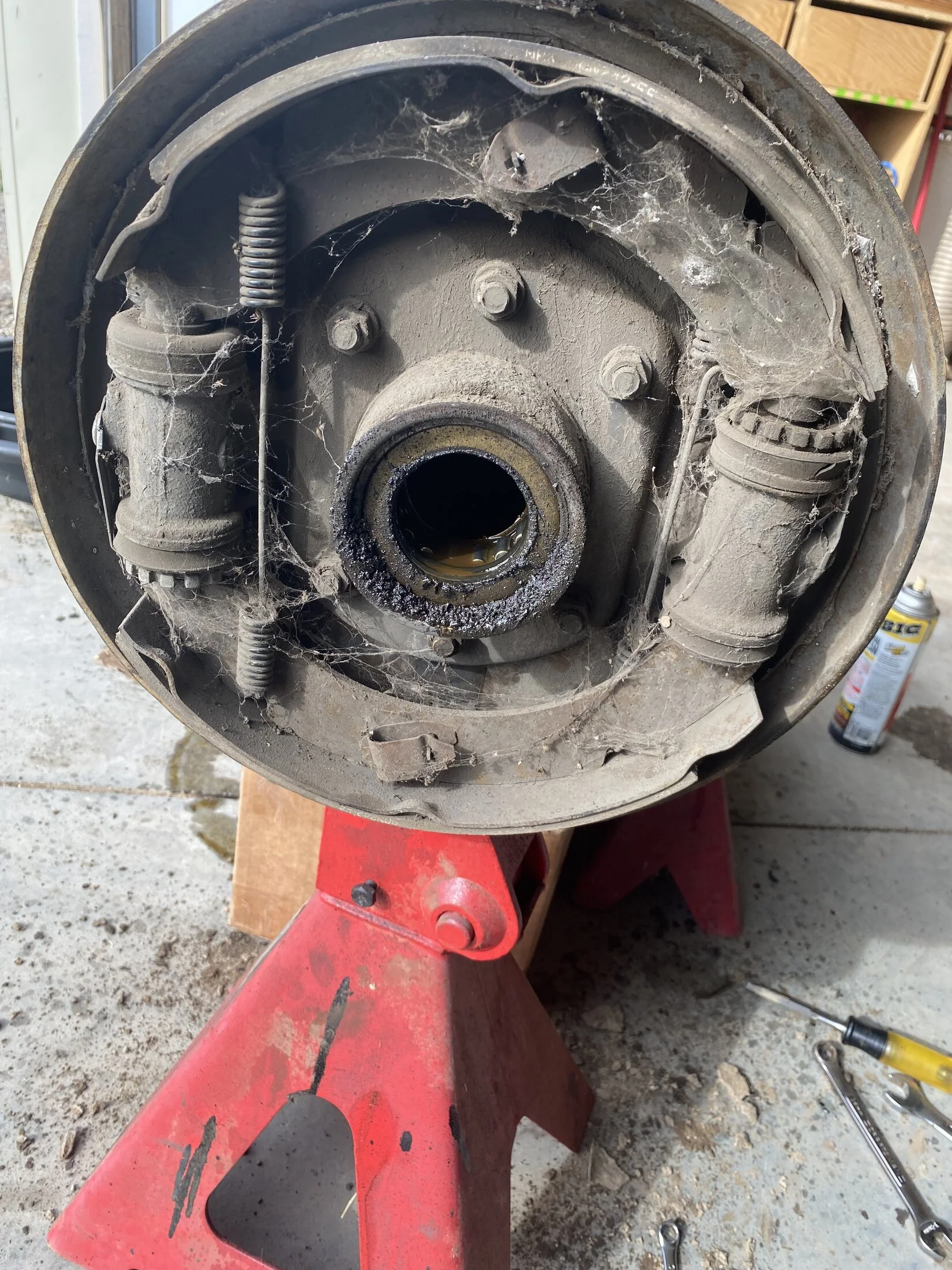

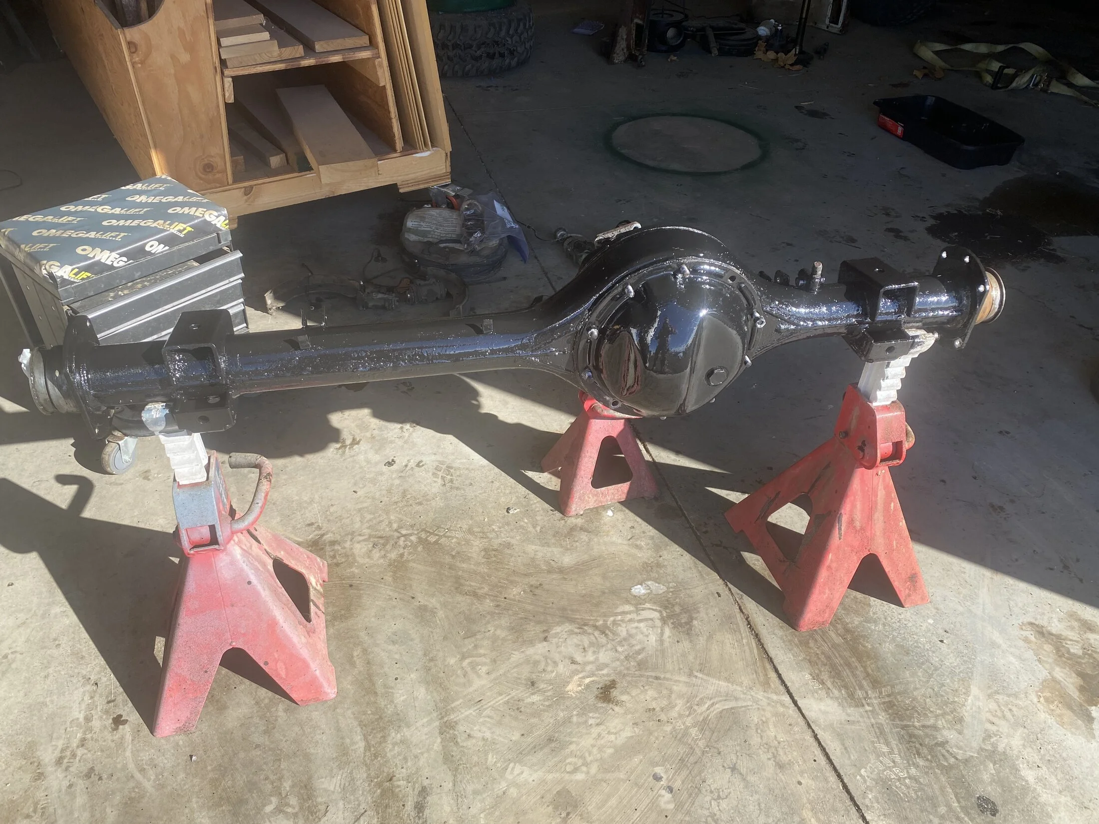

Attention turned to the rear axel. Seals, axel bearings, wheel cylinders. When I opened the diff inspection cover it had sucked in some water so there is minor surface rust, and PO had hammered a mushroom on the pin. A little trickier to remove. I just put it back together as is for now so I can roll it around. I knew the 40 needed more attention on the rear diff and I want to get that rolling before summer is over. Start with one and see how I do. I really want to lock it up, but I'm unsure of what I want. I was thinking of doing a Lock Right by Powertrax. Any feedback?
One issue I've had is that both the inspection cover and the diff studs come out when removing the nut. I was looking for new hardware, and haven't found much on a quick search. If not easy to find I'll just work through the crust and clean them up to reinstall.

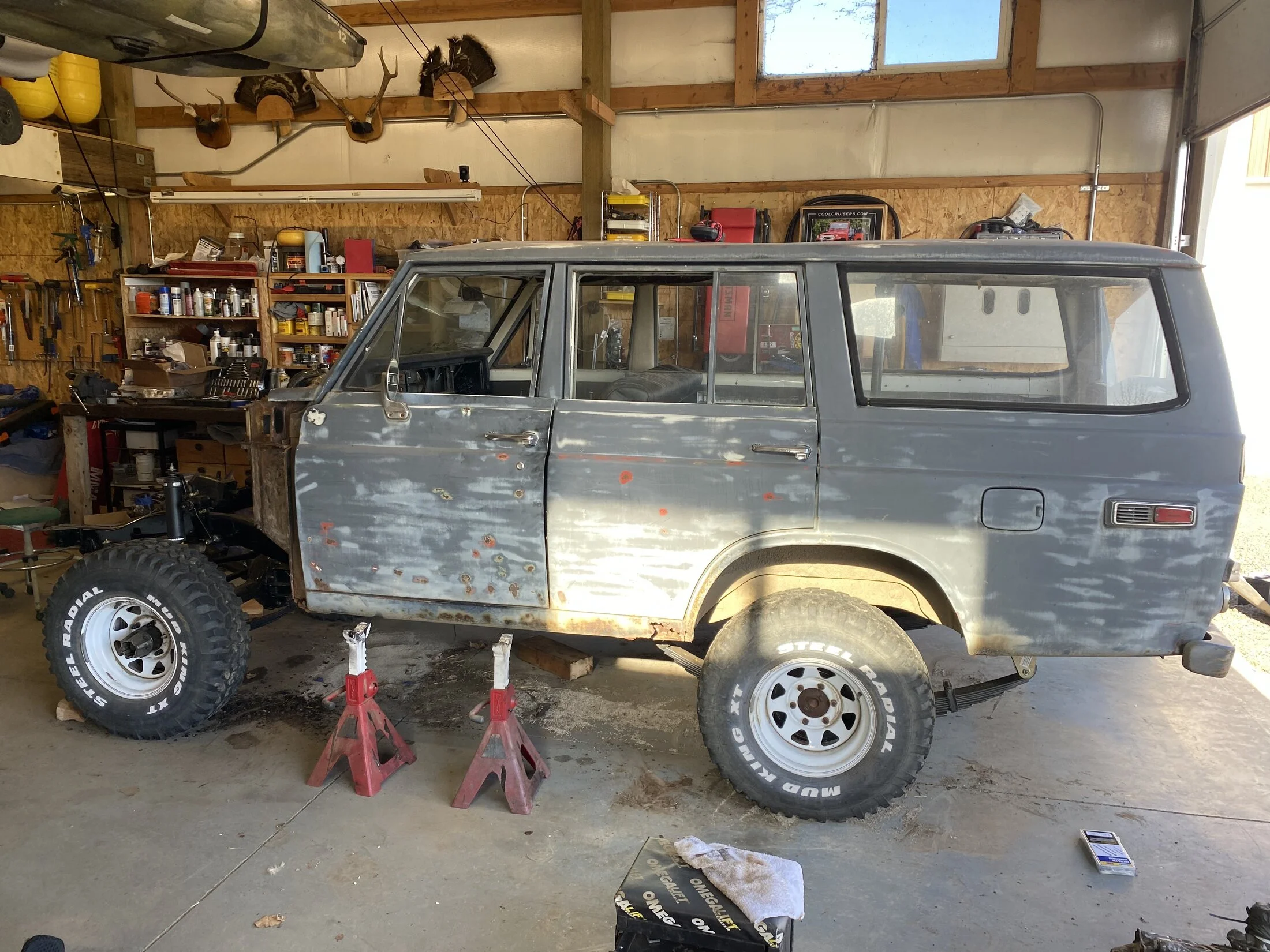

Here is the stance right now.

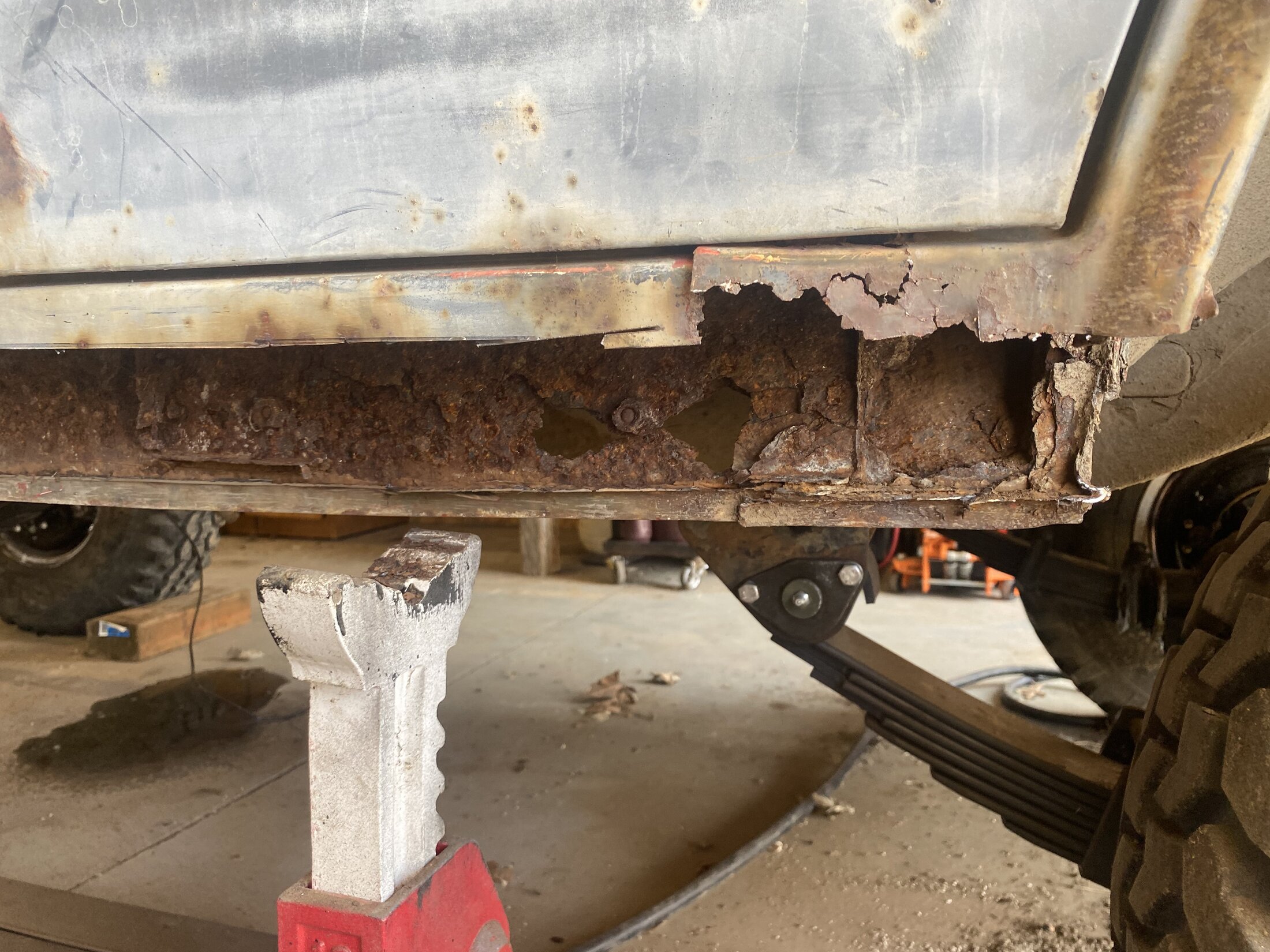

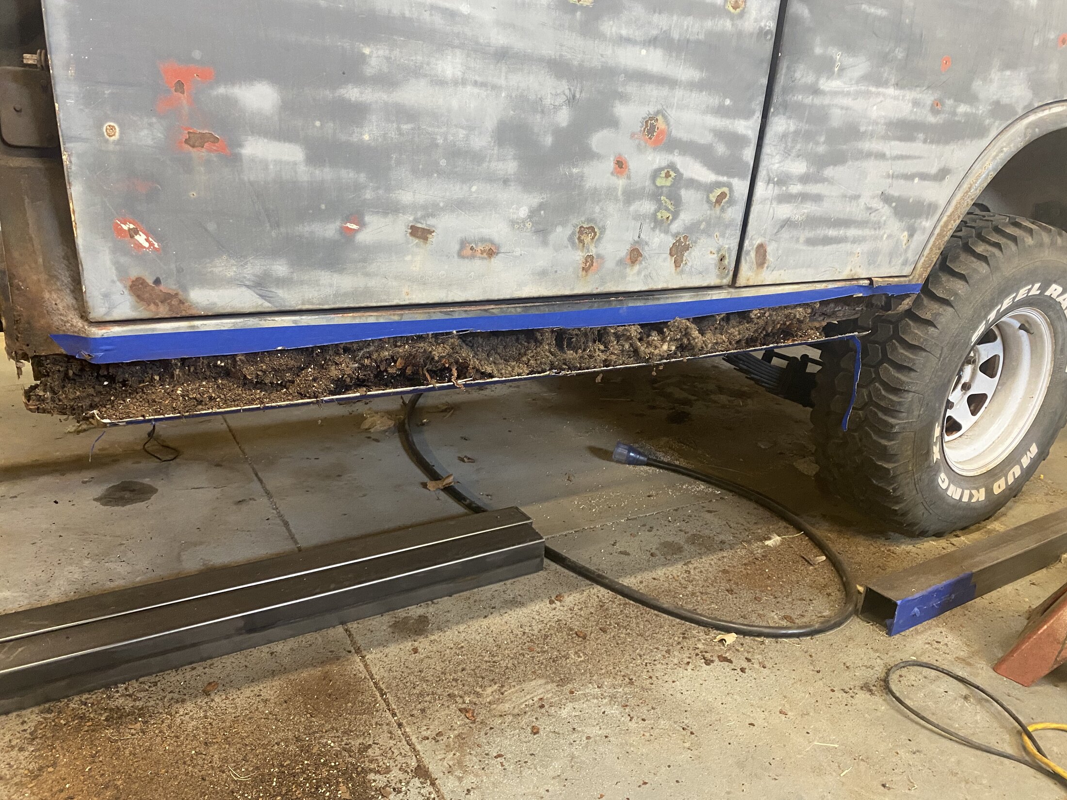

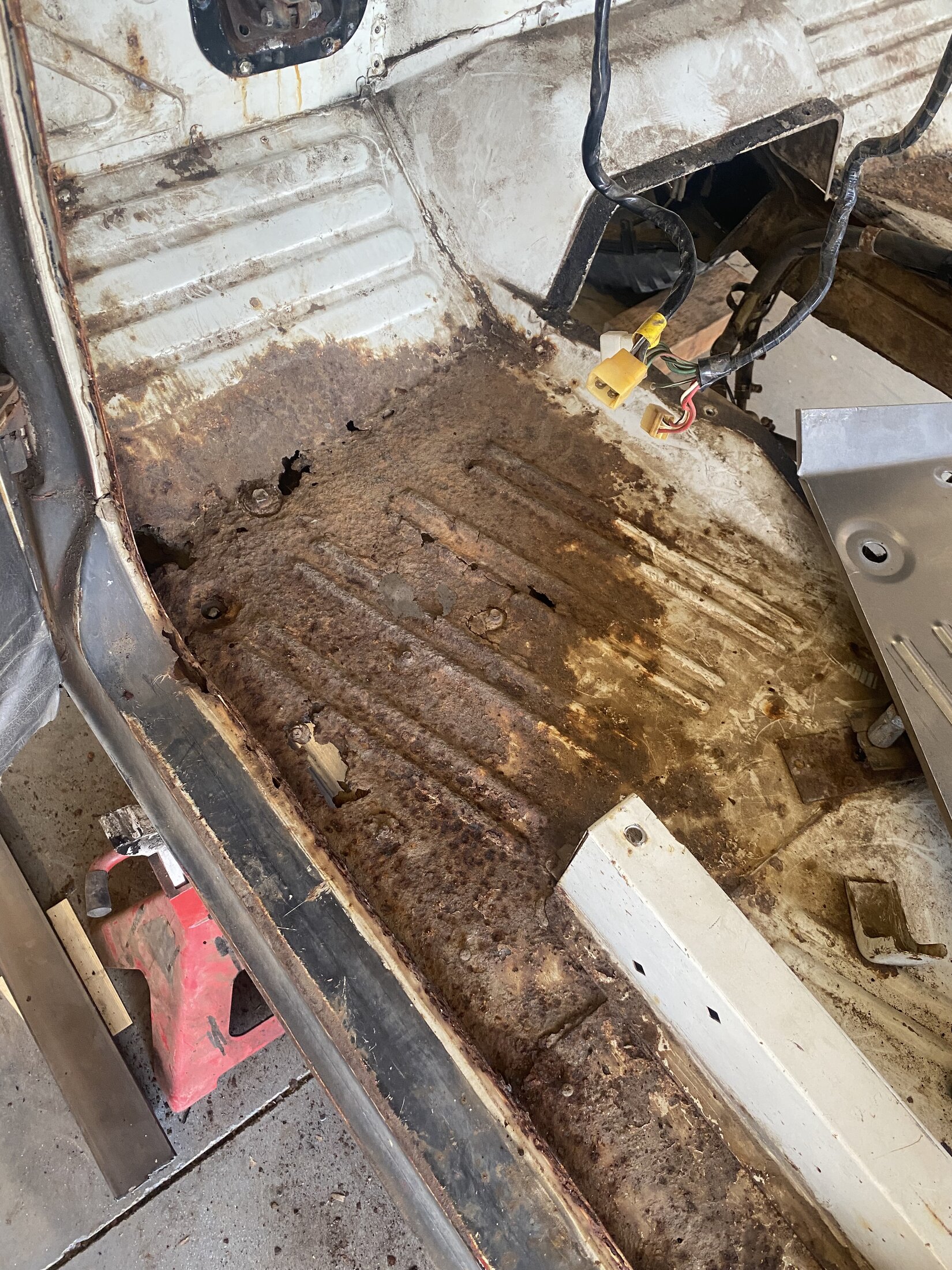

I want to get the firewall and inner fender coated with Lizard skin before I install the motor, but that means I need to get the cancer surgery done. Finding clean margins is tough. I'm going with 3x3 steel .125 wall tube for the lower. I've cut a 45 deg bevel on each end to give a little more tire space.

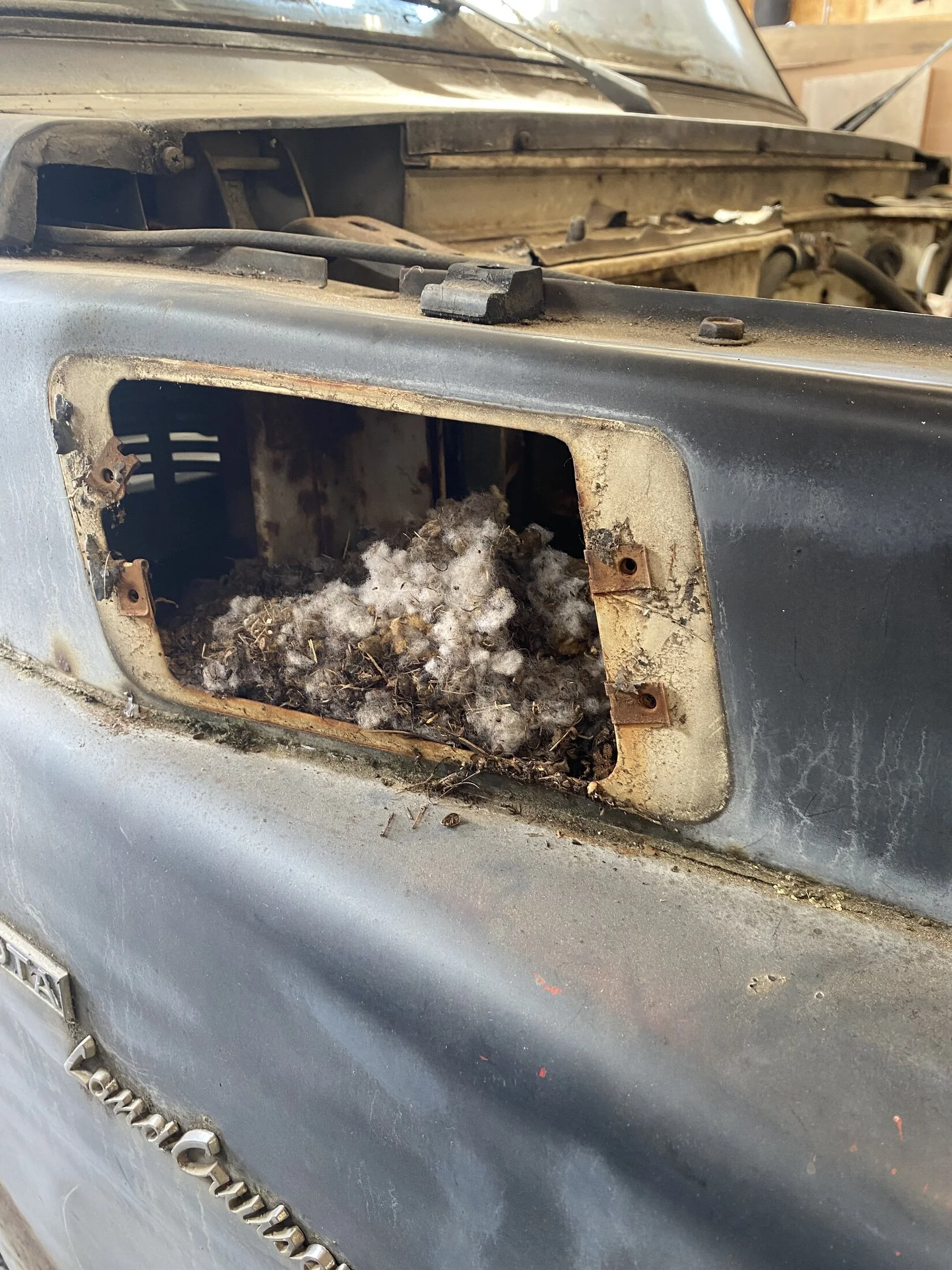

The critters went crazy in this thing, and left the place a wreck.
When I weld in the 3x3 tubing I was thinking of getting all the way back to the body support and weld to that? Not much left there anyway. The plates that are bolted in the picture above serve what purpose? Seems like they were there for assembly purposes but don't provide much function after that?
Here is the top side of the rust. I've got a rough cut out done of the floor pan, no pic, and the bobm pan ready to go. Just need to get the spot welds off the rear support piece. The body mount bolt is pretty thin from rust. Whats everyone doing? buying a whole kit from Cruiser Outfitters?

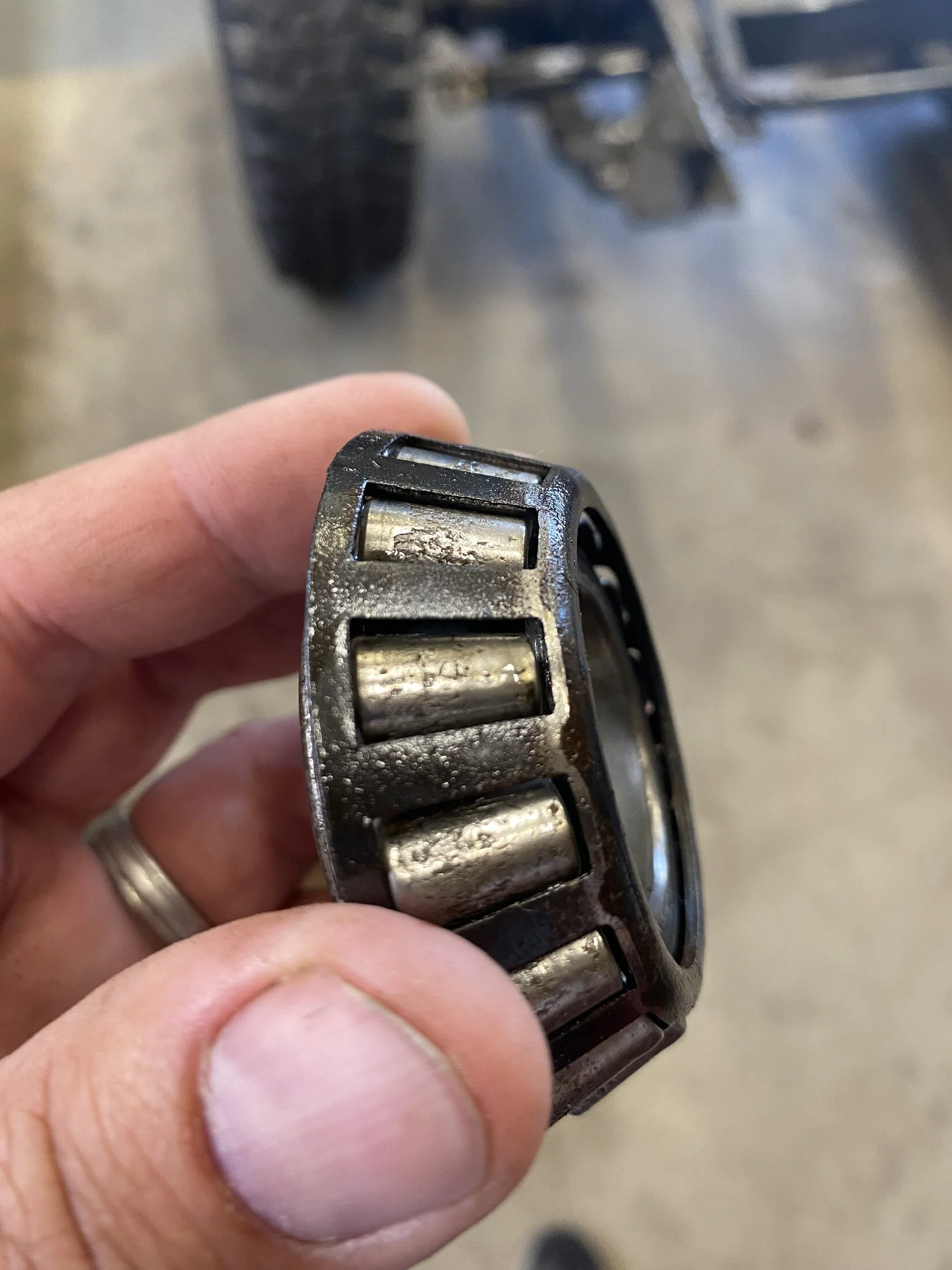

Small pinion bearing out of the 40, loose as hell. Nut was not very tight.

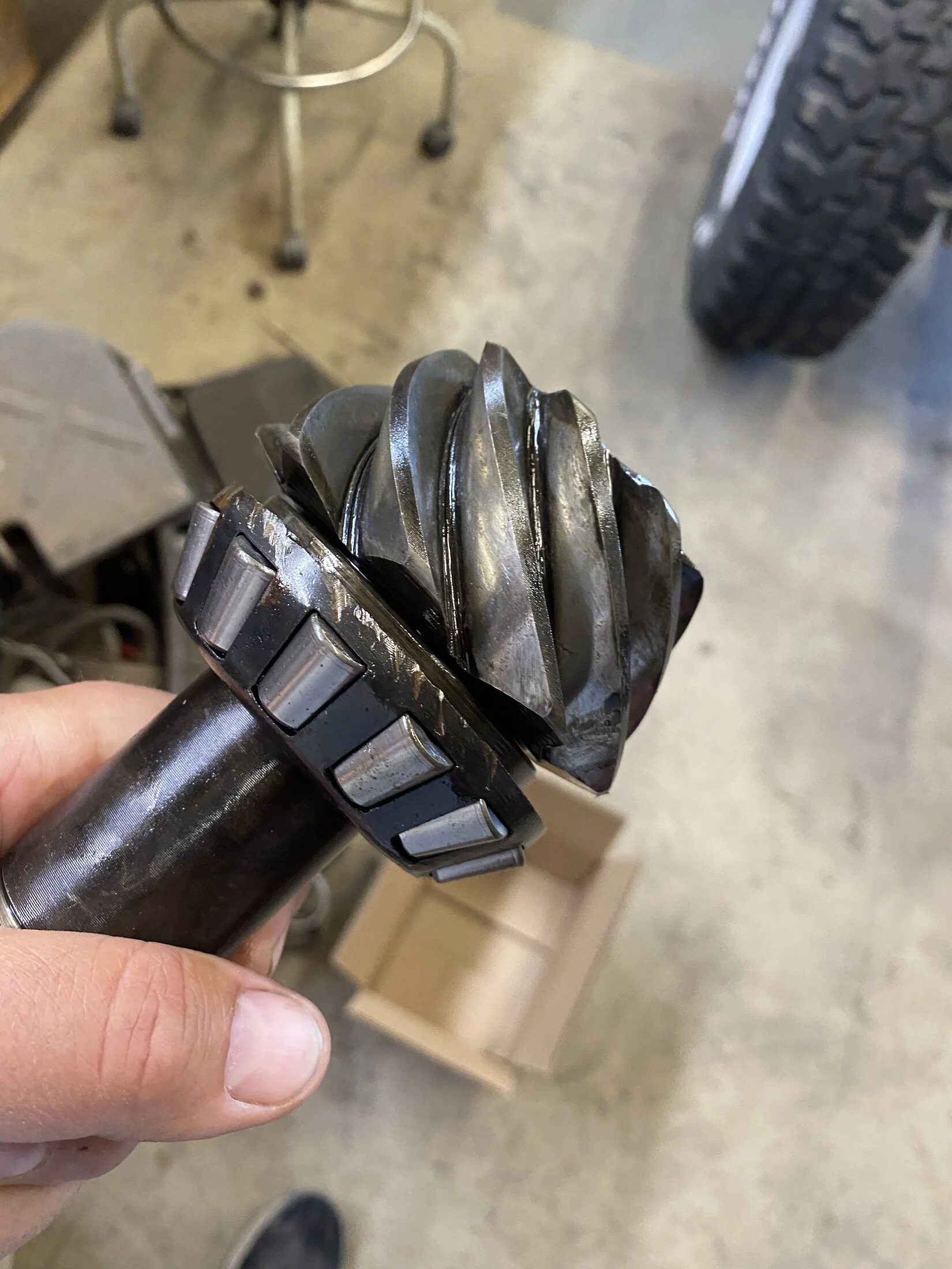

Pinion and inner bearing
I took the pinion and the carrier to the machine shop and they pressed bearings for me. I need to finish fabbing the tool to hold the flange in place and see what the preload is.
