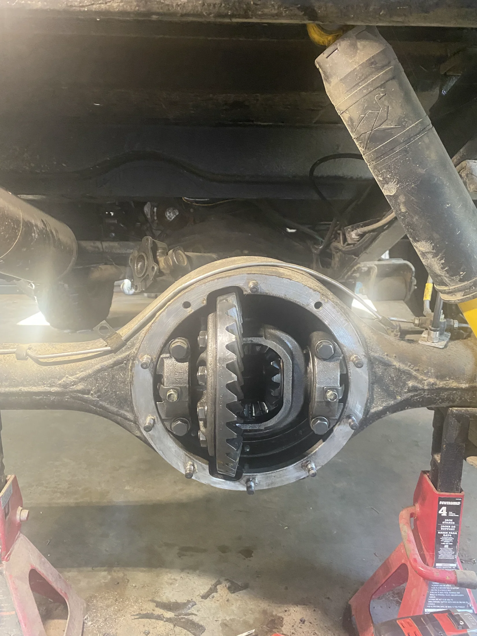

No problem. Those are for the rear housing. The front housing uses the same parts and quantity for the diff housing:
43600ABOLT, STUD (FOR FRONT AXLE DIFFERENTIAL CARRIER SETTING)
90116-10103L=37, S=12 & 25, L=37, S=12&258
90116-10104L=50, S=12 & 18, L=50, S=12&182

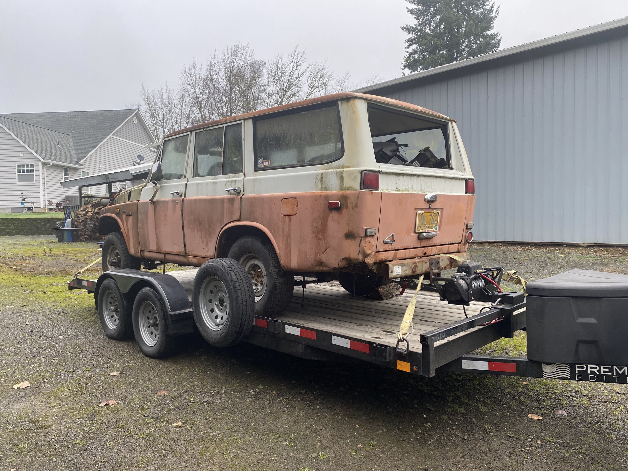

In for a penny in for a pound, found a 72 parts rig a few hours away. My 16 yo son at the time drove me and the flatbed over to the west side through I5 traffic and got this home in a day. It has 5 factory rims, a disc brake front axel, the whole rig was full of 4x, 5x,and 6x parts, and most importantly it has the tailgate handle. From what I have read what I paid for the parts car would have been equal to the rear handle. The guy who sold it to me is a LC guy through and through. Used to race 40s in some fashion and has a show quality 45 in his shop. That was a fun tour.

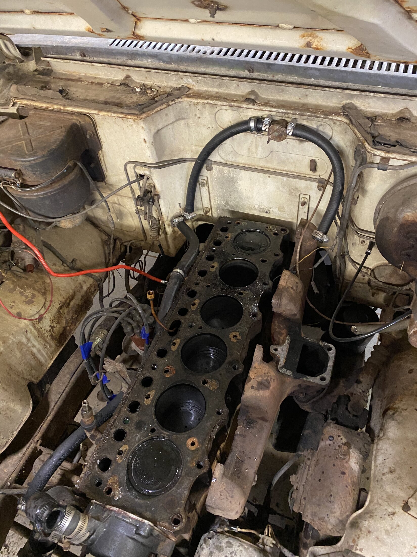

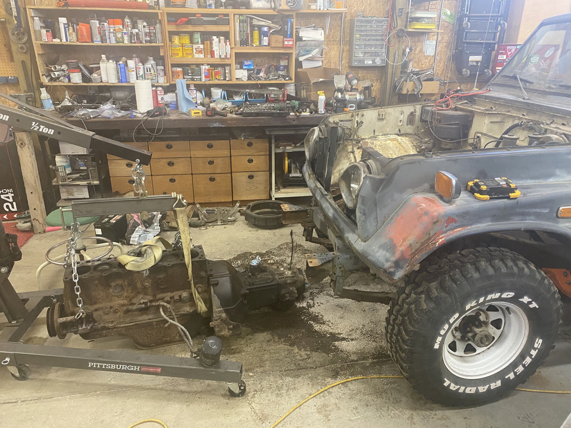

After charging the battery checking the oil etc, we got the 73 running. Blew out a mouse Hilton from the exhaust upon start, drove it a mile or so to pave spun around and made it home, that was about all she had. Sputtering pretty bad. Ran a compression test.
Pulled the valve cover.
Head to the machine shop. I'm lucky to have a legend of a machinist here in town. When I did my 40 I found him, and he has owned several himself. This guy is amazing.
Every seal on this thing was wet, so it was an easy call at this point to yard the rest out, patch it closed with gaskets and see how far she goes.

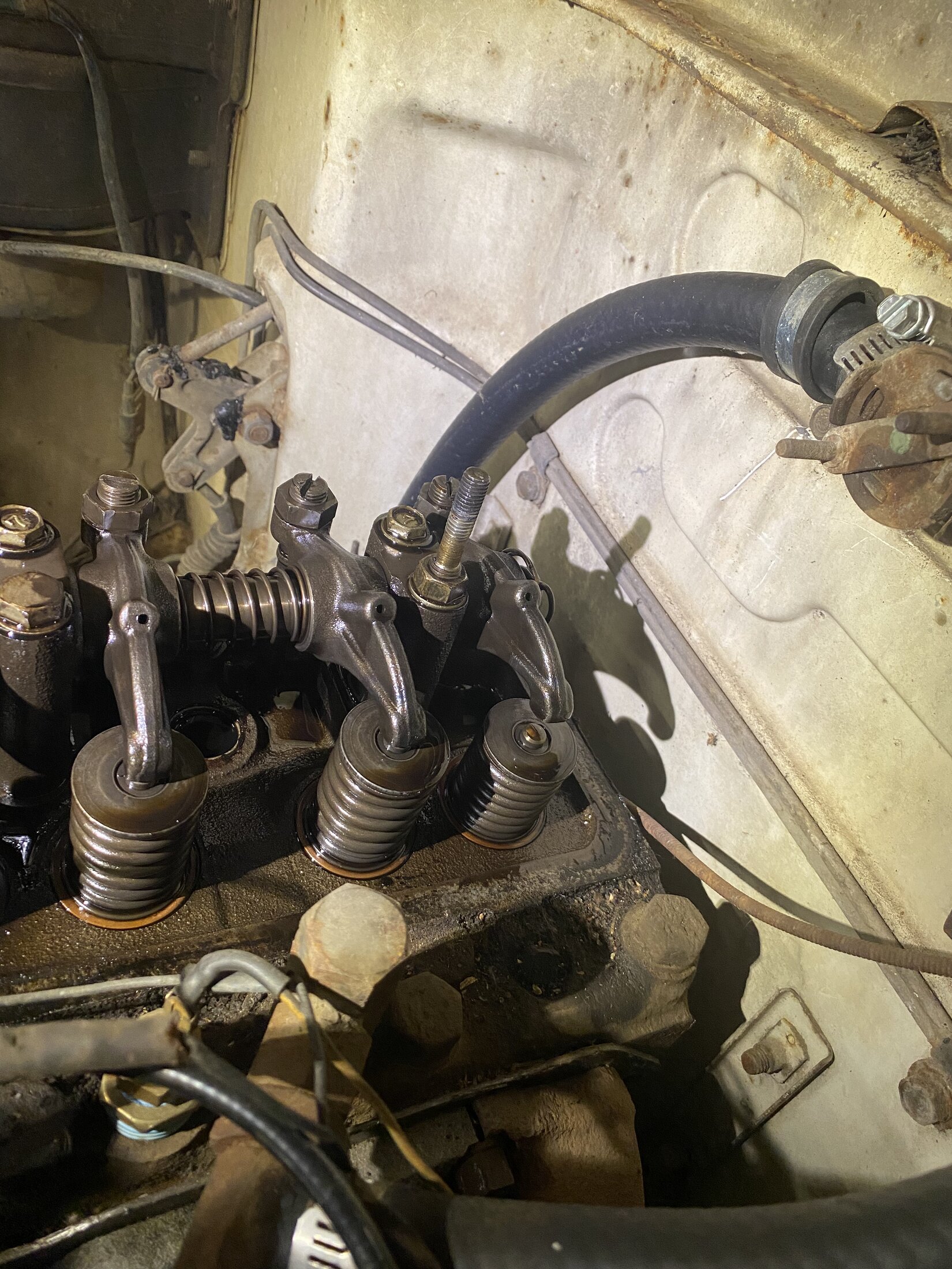

What is up with that exhaust valve on #6?
Machine shop redid all valves and springs. When I popped off the lifter cover the corresponding lifter was more resistant to movement than the rest. I bought one off maybe Rock Auto, and tried it in, and it slid freely. My thought was it got too much heat back there? Machinist thought that was a good plan. I'll let you know when it fires back up.

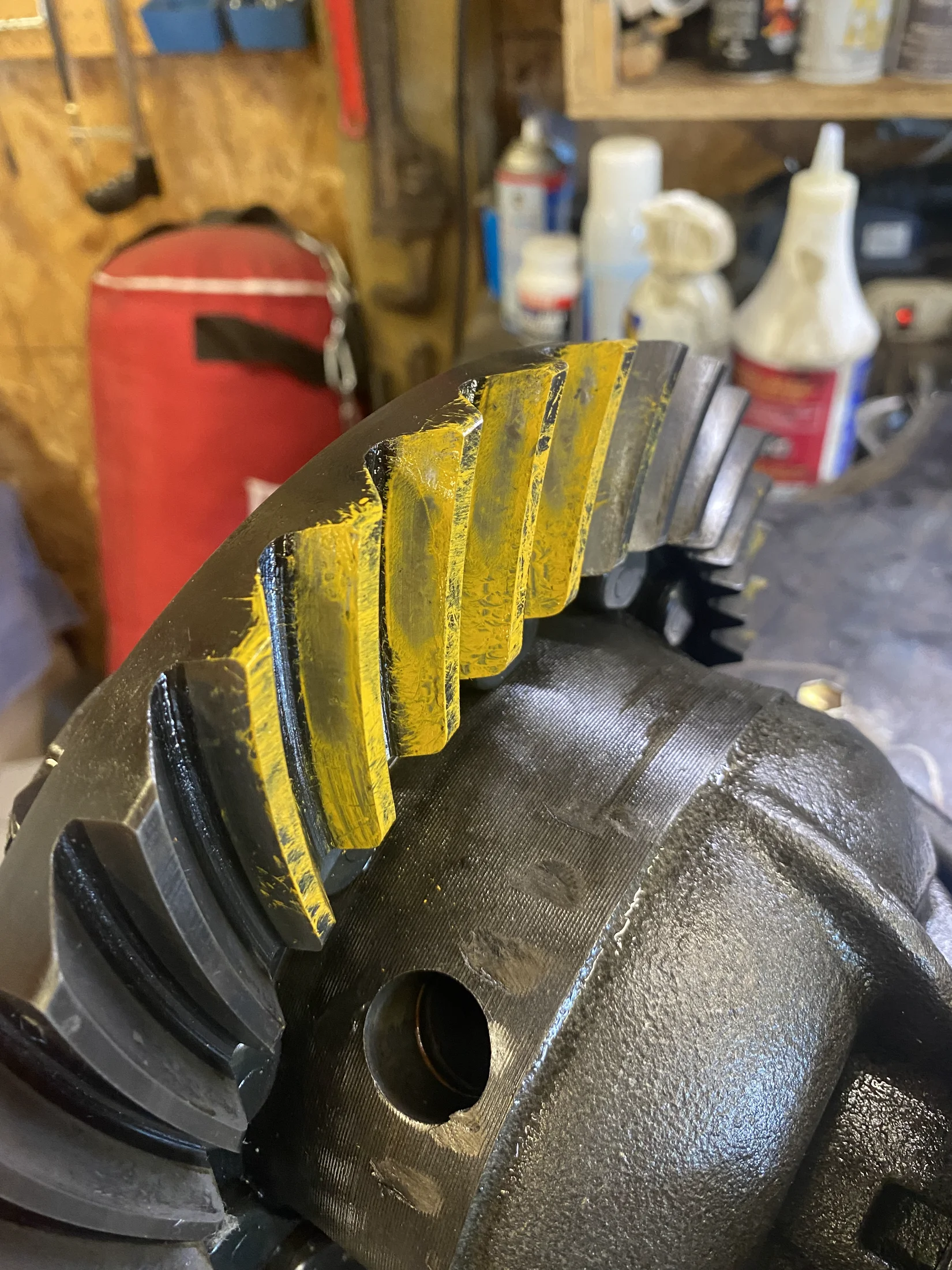

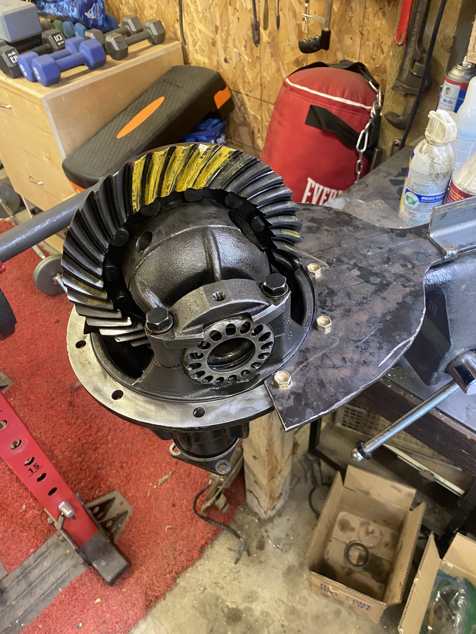

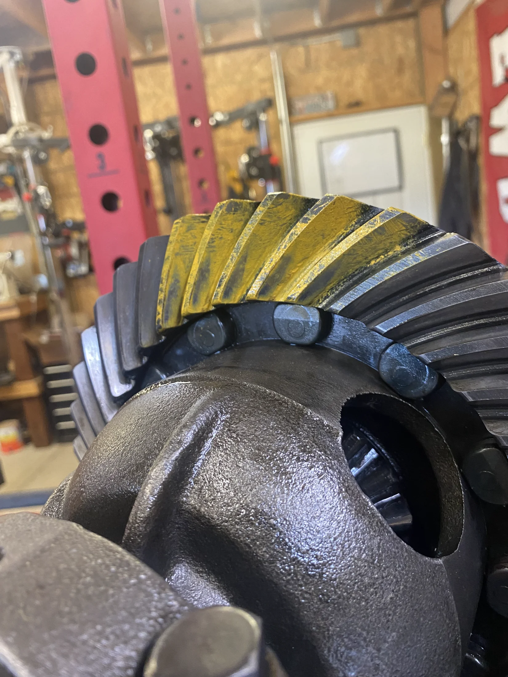

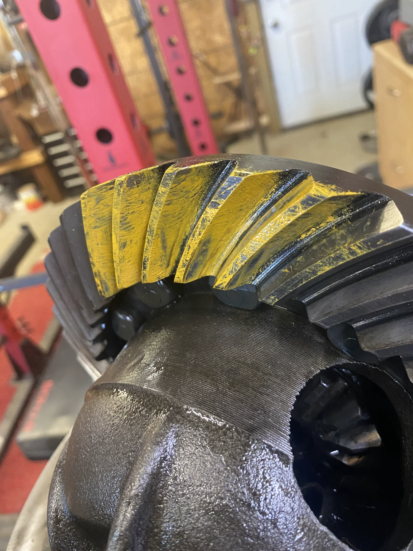

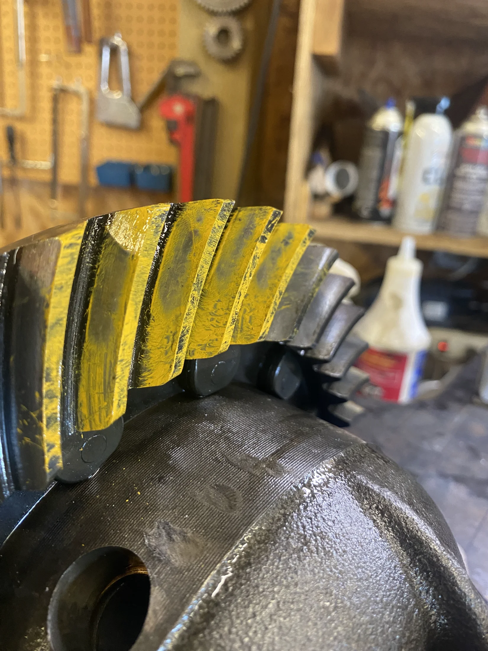

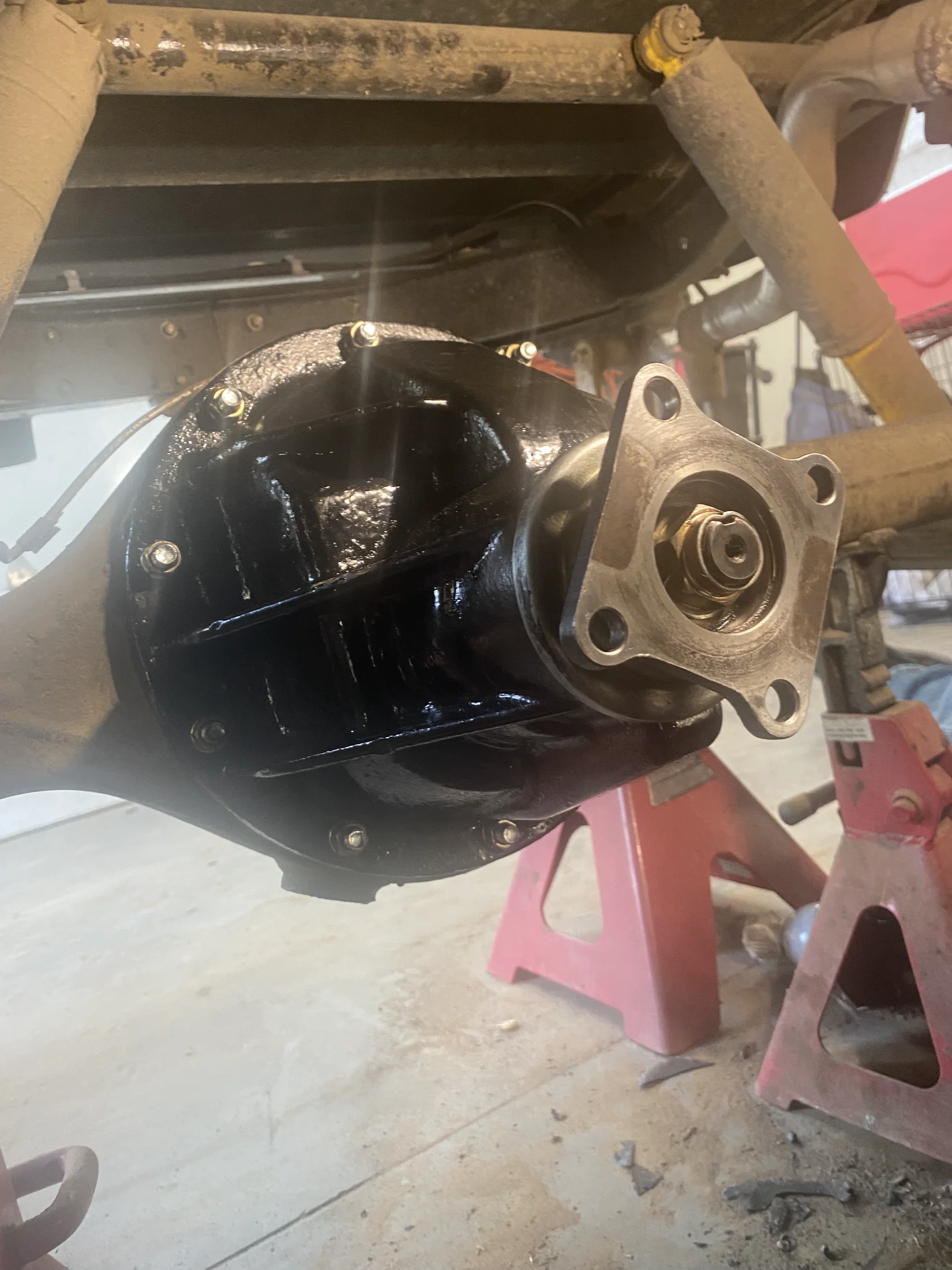

First time running through a diff, took several attempts to dial it in but I think I'm there. 20 in/lb on the rotation of pinion, 16-22 per OTRAM on YouTube is the goal, 0.007" backlash, and the pattern looked ok to me. I used a Sierra bearing kit and it came with examples of acceptable patterns and I think this will ride. Thoughts?
Keepers were put in after the pic.

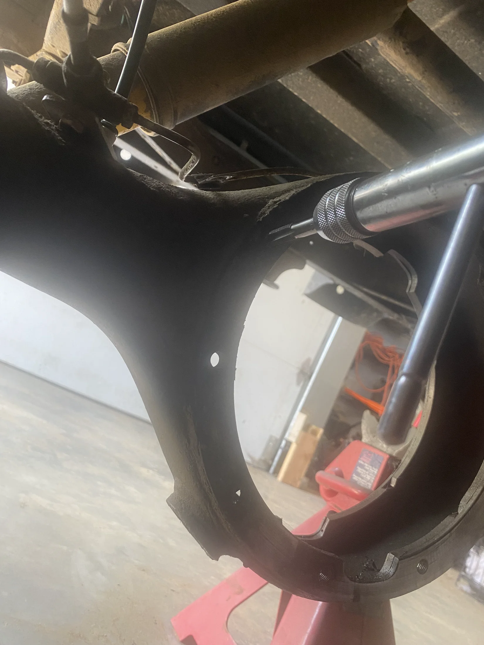

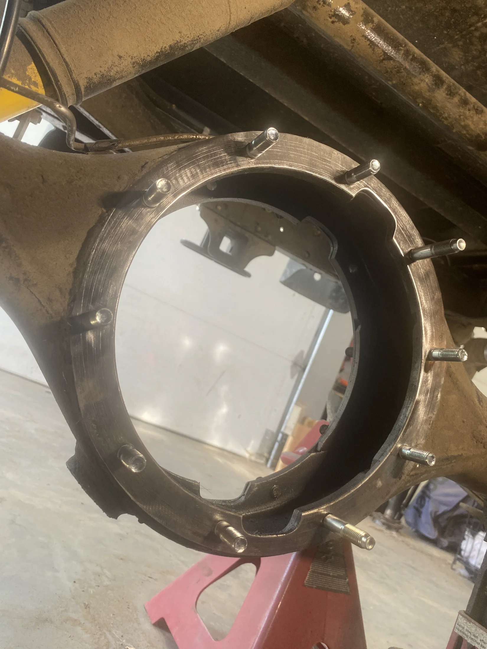

I pulled all the studs and replaced. Three came out on removal, several threads were messed up and one was mushroomed so I replaced them thanks to the part number @WarDamnEagle gave me. I chased the threads before placing the new ones, and there was a lot more resistance than I was expecting.
Cones of shame on puppies that want to help make things interesting. I'm hoping dog hair proves to be some sort of benefit to diffs bc its everywhere.
This is the 40 but I'll do the exact same thing on the 55 when the time comes.
I used a gasket scraper followed by a stiff nylon pad on the side grinder to clean the flange surface. I then ran a hex head bolt through all the holes to clean them out followed by some brake cleaner before installing the studs. I also noticed considerable variability between the torque required to install the studs. I think there is some variability in the amount of sealant used on the threads which may contribute to the difference between studs. Still, there's nothing better than new parts when you're putting something back together.
